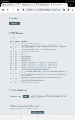

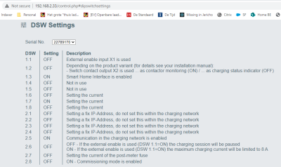

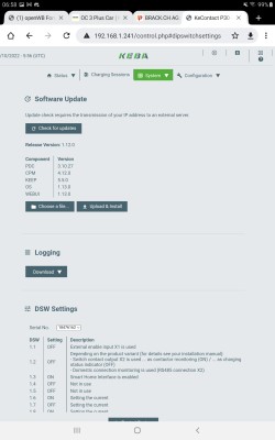

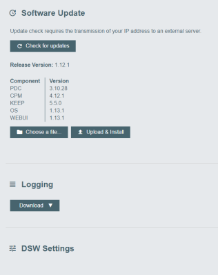

Well the keba seems not to open port 502, atrached you see my dip switches setting and my installed softwareversion. I have one keba -x
Please check this against your installation, in case you still have problems, please show me all parameters. Which openWb version do you have ? Is it self installed ?

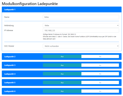

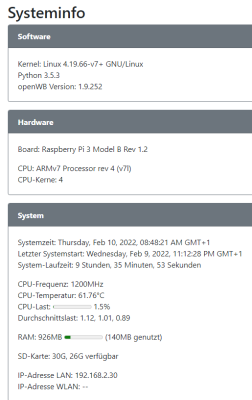

Thanks for your quick reply. See screenshots below for my openwb and Keba configuration.
I'm running Openwb on a RPI 3B+. I re-installed my pi just before installing openWB and am running Raspbian Stretch on it. I followed the installation steps on github for the installation.
