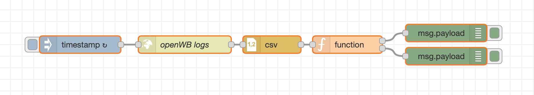

Mit nodeRED ist das recht einfach:
Damit wird jede Nacht um 0:02 die Datei abgeholt. Statt Debug-Nodes am Ende bräuchtest Du jetzt nur noch jeweils eine MQTT-Node, die das entsprechend im Broker published. (ja, statt zweier MQTT-Nodes geht's wohl auch mit einer, das hab' ich auf die Schnelle aber nicht herausgefunden)
[{"id":"bb3cbb35bb475d23","type":"debug","z":"8464e9a1f0b14075","name":"","active":true,"tosidebar":true,"console":false,"tostatus":false,"complete":"false","statusVal":"","statusType":"auto","x":790,"y":280,"wires":[]},{"id":"ec9709bbe058bea3","type":"http request","z":"8464e9a1f0b14075","name":"openWB logs","method":"GET","ret":"txt","paytoqs":"ignore","url":"http://wallbox.fritz.box/openWB/ramdisk/logaktmonthonl.csv","tls":"","persist":false,"proxy":"","authType":"","senderr":false,"x":340,"y":300,"wires":[["f2900240d5868968"]]},{"id":"206633efba59c0c2","type":"inject","z":"8464e9a1f0b14075","name":"","props":[{"p":"payload"},{"p":"topic","vt":"str"}],"repeat":"","crontab":"02 00 * * *","once":false,"onceDelay":0.1,"topic":"","payload":"","payloadType":"date","x":160,"y":300,"wires":[["ec9709bbe058bea3"]]},{"id":"f2900240d5868968","type":"csv","z":"8464e9a1f0b14075","name":"","sep":",","hdrin":true,"hdrout":"none","multi":"mult","ret":"\\n","temp":"","skip":"0","strings":true,"include_empty_strings":"","include_null_values":"","x":490,"y":300,"wires":[["a79c4d3ed28d3f4d"]]},{"id":"a79c4d3ed28d3f4d","type":"function","z":"8464e9a1f0b14075","name":"","func":"msg.payload = msg.payload[msg.payload.length - 1];\nvar m1 = {};\nvar m2 = {};\n\nm1.payload = msg.payload[ 'Lpalle Pv' ];\nm1.topic = \"PVChargeKwh\";\n\nm2.payload = msg.payload[ 'Lpalle EVU' ];\nm2.topic = \"ChargeKwh\";\n\nreturn [m1, m2];","outputs":2,"noerr":0,"initialize":"","finalize":"","libs":[],"x":620,"y":300,"wires":[["bb3cbb35bb475d23"],["31d5e1dc3646b30f"]]},{"id":"31d5e1dc3646b30f","type":"debug","z":"8464e9a1f0b14075","name":"","active":true,"tosidebar":true,"console":false,"tostatus":false,"complete":"false","statusVal":"","statusType":"auto","x":790,"y":320,"wires":[]}]

Vielen Dank
Ich bin tatsächlich noch nicht dazu gekommen, mir das in NodeRed näher anzuschauen - aber nachdem du jetzt die Vorlage geliefert hast, habe ich das mal zum testen bei mir Implementiert...
Das schöne ist, ich brauche mir gar keinen MQTT Knoten in NodeRed anzulegen, da ich auch direkt mit HomeAssistant "sprechen" kann - und die notwendigen Sensoren direkt in NodeRed anlegen kann.
Jetzt mal im Auge behalten, ob das so funktioniert wie ich es mir denke / wünsche.
