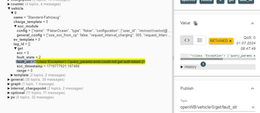

Mit dem MQTT Explorer komme ich ebenfalls drauf und sehe folgende Fehlermeldung: "<class 'Exception'> ('query_params error:could not get auth token',)"
Kann mir hier jemand weiterhelfen? Die Auth-URL https://auth.fiskerdps.com/auth/login sollte passen. EDIT: Es gibt noch eine zweite URL: https://www.fiskerapi.io/fisker-api/authentication

                    if handler == CAR_SETTINGS:
                        self.data[CAR_SETTINGS] = response
                    if handler == responseToReturn:
                        try:
                            await ws.close()
                        except Exception as e:
                            _LOGGER.debug(
                                f"Error occurred while closing WebSocket: {e}"
                        return response
                    if HasAUTH is not True:
                        if handler == "verify":
                            HasAUTH = (
                                json.loads(response)["data"]["authenticated"] is True
                            # Send a message
                            # _LOGGER.debug(f"Sending 'GenerateProfilesRequest'")
                            await ws.send_str(
                                json.dumps(self.GenerateProfilesRequest())
                    if HasAUTH is True and HasVIN is not True:
                        if handler == PROFILES:
                            self.vin = self.ParseProfilesResponse(response)
                            # print (f"vin = {vin}")
                            if self.vin != "":
                                self.HasVIN = True
                                # Send a message
                                _LOGGER.debug(
                                    f"Auth & VIN ok - Sending 'DigitalTwinRequest' to vin={self.vin}"
                                await ws.send_str(
                                    json.dumps(self.DigitalTwinRequest(self.vin))
                    if HasAUTH is True and HasVIN is True:
                        # _LOGGER.debug(f"Received message: {message}")
                            _LOGGER.error(response)
                            try:
                                await ws.close()
                                _LOGGER.error(
                            return response
    async def __SendWebsocketRequest(self, commandToSend: str):
        HasAUTH = False
        wssUrl = self.__GetRegionURL()
        async with aiohttp.ClientSession() as session:
            async with session.ws_connect(wssUrl, headers=headers) as ws:
                await ws.send_str(json.dumps(self.GenerateVerifyRequest()))
                while True:
                    response = await ws.receive_str()
                    handler = json.loads(response)["handler"]
                    if handler in (DIGITAL_TWIN, CAR_SETTINGS):
                        try:
                            await ws.close()
                            _LOGGER.debug(
                        return response
                            HasAUTH = (
                            # Send a message
                            await ws.send_str(json.dumps(commandToSend))
    def flatten_json(self, jsonIn):
        out = {}
        def flatten(x, name=""):
            if type(x) is dict:
                for a in x:
                    flatten(x[a], name + a + "_")
            elif type(x) is list:
                i = 0
                for a in x:
                    flatten(a, name + str(i) + "_")
                    i += 1
            else:
                out[name[:-1]] = x
        flatten(jsonIn)
        return out
    def get_battery_data(self) -> dict or None:
        # get Vehicle Data (example from Polestar Config), NOCH ANPASSEN
        params = {
            "query": "query GetBatteryData($vin: String!) { getBatteryData(vin: $vin) { "
            + "battery_percent  battery_max_miles } }",
            "operationName": "GetBatteryData",
            "variables": "{\"vin\":\"" + self.vin + "\"}"
        result = self.query_params(params)
        return result['data']['getBatteryData']
def fetch_soc(username: str, password: str, region: str, vehicle: int) -> CarState:
    # example from Polestar Config, NOCH ANPASSEN
    api = FiskerApi(username, password, region)
    bat_data = api.data_battery()
    soc = bat_data['battery_percent']
    est_range = bat_data['battery_max_miles"']
    return CarState(soc, est_range, time.strftime("%m/%d/%Y, %H:%M:%S"))
class FiskerApiError(Exception):
    """Base exception for all MyFisker API errors"""
class AuthenticationError(FiskerApiError):
    """Authenatication failed"""
class RequestError(FiskerApiError):
    """Failed to get the results from the API"""
    def __init__(self, message, error_code):
        super().__init__(message)
        self.error_code = error_code
class RequestConnectionError(FiskerApiError):
    """Failed to make the request to the API"""
class RequestTimeoutError(FiskerApiError):
class RequestRetryError(FiskerApiError):
    """Retries too many times"""
class RequestDataError(FiskerApiError):
    """Data is not valid"""

rleidner
Beiträge: 1540
Has thanked: 104 times
Been thanked: 203 times
Re: SoC Fisker OCEAN
Beitrag von rleidner »
Ich kann meinen Tipp nur wiederholen: :
Wenn ich mit einem SOC-Abruf für ein ein neues Fahrzeug beginne und kein funktionierendes Muster habe, baue ich erst mal ein einfaches python script, das den gesamten Abruf erfolgreich durchführt.
Erst wenn das sauber funktioniert, baue ich das in die openwb-Umgebung ein.
und in dem python script JEDEN einzelnen Schritt protokollieren bis es funktioniert!
openWB-2 Standard+ | openWB EVU Kit v2 MID| 9,9kWp mit Kostal Plenticore 8.5 plus | Zendure Solarflow 2400 AC+ 8,2kWh | VW ID.3, Kia EV6, Smart EQ forfour
