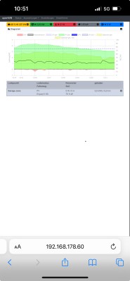

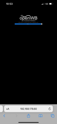

Update auf heutiges Master. OpenWB wird alle 5 sec. neugestartet (Safari)
Firefox gleichfalls refrech alle 5sec.

Jens hat geschrieben: Fr Okt 06, 2023 7:34 am Update auf heutiges Master. OpenWB wird alle 5 sec. neugestartet (Safari)
Kann ich hier bei mehreren openWB nicht reproduzieren (Chrome und Firefox unter Ubuntu LTS).
Was steht in der Konsole des Browsers an Fehelrmeldungen?
Hier ebenso: Safari und Chrome auf MacOS.

Wechselt alle 5 sec.

Falls es hilft, hier ist ein Ausschnitt der JavaScript-Konsole vom Safari:
[Warning] old data detected: – 1696584623000 – "11:30:23" (livechart.js, line 643)
[Warning] last timestamp: – 1696584623000 – "11:30:23" (livechart.js, line 644)
[Debug] graph updated, last dataset: – 1696584623000 – "11:30:23" (livechart.js, line 650)
[Debug] checking url: – "themes/standard_legacy/" (processAllMqttMsg.js, line 57, x2)
[Debug] connecting to broker on openwb:80 as client "vfguv" (setupMqttServices.js, line 269)
[Error] Failed to load resource: the server responded with a status of 404 (Not Found) (chartjs-adapter-luxon.min.js.map, line 0)
[Debug] connecting to broker on openwb:80 as client "ukaoe" (setupMqttServices.js, line 269)
[Debug] EVU counter index: 0 (processAllMqttMsg.js, line 383)
[Debug] creating charge-point 3 (processAllMqttMsg.js, line 32)
[Warning] no vehicle soc data found for index – 1 (processAllMqttMsg.js, line 339)
[Debug] update vehicle soc config – "0" – {type: null, configuration: {}} (processAllMqttMsg.js, line 1039)
[Debug] update vehicle soc config – "1" – {name: "Manueller SoC", type: "manual", configuration: {efficiency: 0.93, soc_start: 70}} (processAllMqttMsg.js, line 1039)
[Debug] update vehicle soc config – "2" – {name: "BMW", type: "bmw", configuration: {}} (processAllMqttMsg.js, line 1039)
[Debug] no charge points with charge template "0" found (processAllMqttMsg.js, line 307)
[Debug] no charge points with charge template "2" found (processAllMqttMsg.js, line 307)
[Debug] evu counter message received (processAllMqttMsg.js, line 483, x3)
[Debug] update vehicle soc config – "2" – {name: "BMW", type: "bmw", configuration: {} (processAllMqttMsg.js, line 1039)
[Debug] graph duration: 120 minutes (processAllMqttMsg.js, line 1227)
[Debug] line too short: – "-" (livechart.js, line 110, x7)
[Debug] index for dataset "grid": 0 (livechart.js, line 549)
[Debug] index for dataset "house-power": 1 (livechart.js, line 549)
[Debug] index for dataset "charging-all": 2 (livechart.js, line 549)
[Debug] no index found for "pv-all" (livechart.js, line 552)
[Debug] template name: pv-all index: undefined (livechart.js, line 562)
[Debug] no index found for "cp3-power" (livechart.js, line 552)
[Debug] template name: cp-power index: 3 (livechart.js, line 562)
[Debug] no index found for "ev1-soc" (livechart.js, line 552)
[Debug] template name: ev-soc index: 1 (livechart.js, line 562)
[Debug] no index found for "ev2-soc" (livechart.js, line 552)
[Debug] template name: ev-soc index: 2 (livechart.js, line 562)
[Debug] unsubscribing from graph topics (livechart.js, line 738)
[Debug] evu counter message received (processAllMqttMsg.js, line 483)
[Debug] graph updated, last dataset: – 1696584643000 – "11:30:43" (livechart.js, line 650)
[Debug] subscribing to graph topics (livechart.js, line 730)
[Debug] index for dataset "pv-all": 3 (livechart.js, line 549)
[Debug] index for dataset "cp3-power": 4 (livechart.js, line 549)
[Debug] index for dataset "ev1-soc": 5 (livechart.js, line 549)
[Debug] index for dataset "ev2-soc": 6 (livechart.js, line 549)
