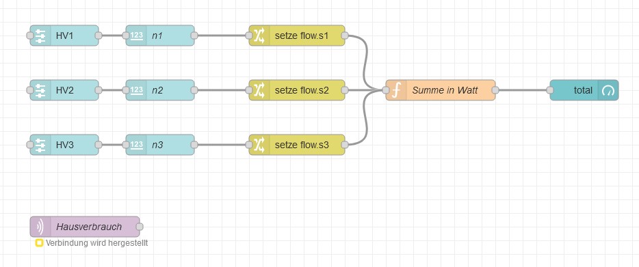

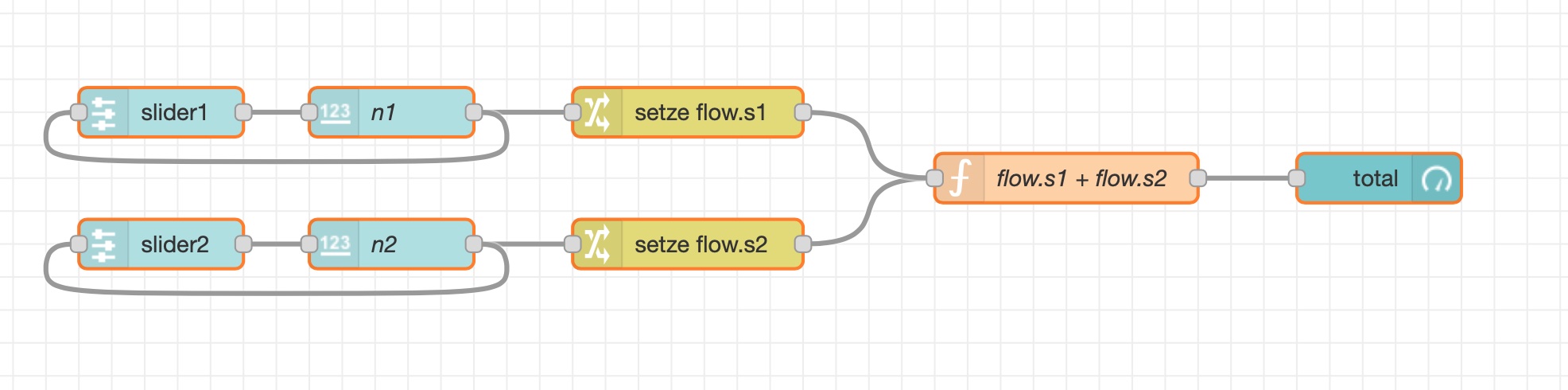

So, nun hab' ich's. Mit der Change-Node wird der aktuelle Wert des jeweiligen Sliders in den context des Flows geschrieben. Ist quasi eine Flow-globale Variable. Auf die greife ich dann in der Function Node zu um die Summe zu bilden.
Interessanterweise scheint nodeRED Endlosschleifen zu erkennen und stoppt die. Anders ist es ja nicht zu erklären, dass die Verbindung vom Ausgang n1 mit dem Eingang von s1 nicht zu einem Absturz führt, sondern zum gewünschten Verhalten "Mit dem Klicker verändert sich der Schieberwert"

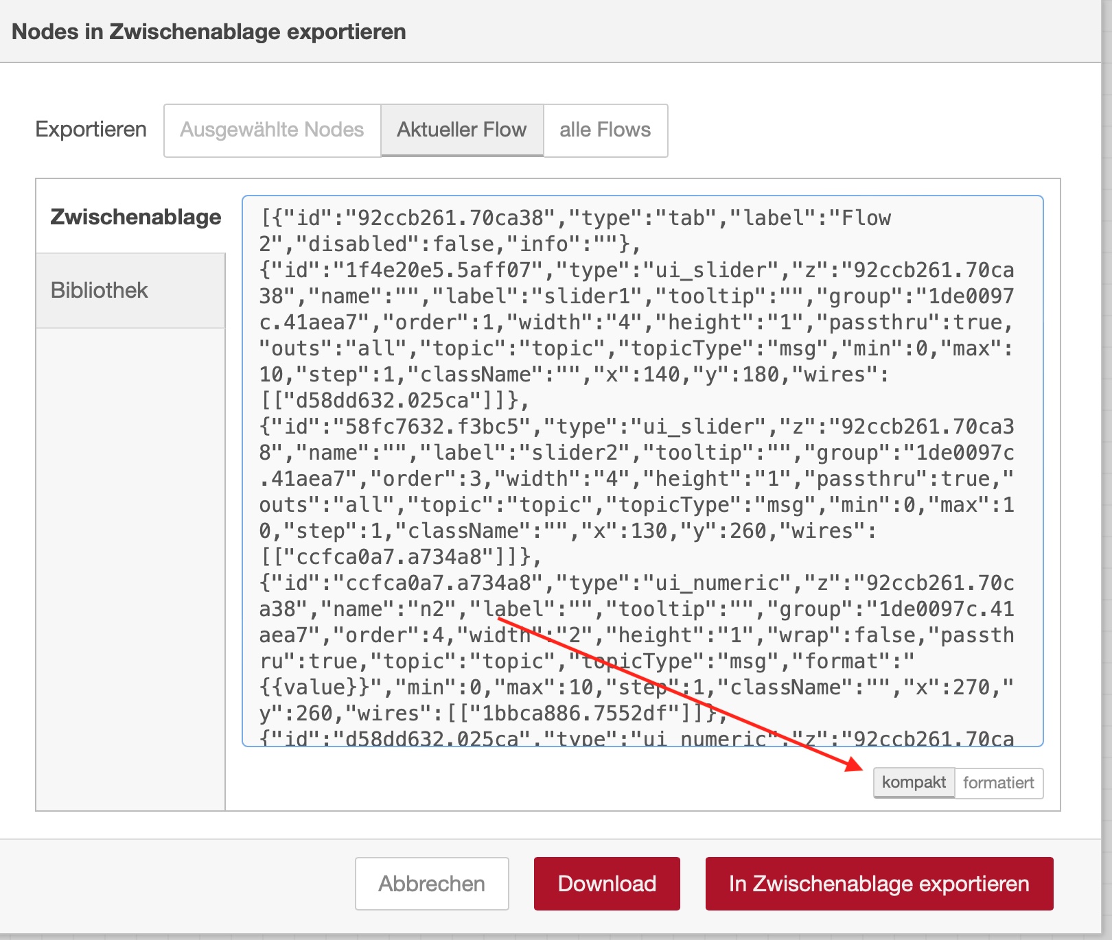

Den Code bekommt man beim Export in die Zwischenablage mit dieser Option klein:
[{"id":"92ccb261.70ca38","type":"tab","label":"Flow 2","disabled":false,"info":""},{"id":"1f4e20e5.5aff07","type":"ui_slider","z":"92ccb261.70ca38","name":"","label":"slider1","tooltip":"","group":"1de0097c.41aea7","order":1,"width":"4","height":"1","passthru":true,"outs":"all","topic":"topic","topicType":"msg","min":0,"max":10,"step":1,"className":"","x":110,"y":100,"wires":[["d58dd632.025ca"]]},{"id":"58fc7632.f3bc5","type":"ui_slider","z":"92ccb261.70ca38","name":"","label":"slider2","tooltip":"","group":"1de0097c.41aea7","order":3,"width":"4","height":"1","passthru":true,"outs":"all","topic":"topic","topicType":"msg","min":0,"max":10,"step":1,"className":"","x":110,"y":180,"wires":[["ccfca0a7.a734a8"]]},{"id":"ccfca0a7.a734a8","type":"ui_numeric","z":"92ccb261.70ca38","name":"n2","label":"","tooltip":"","group":"1de0097c.41aea7","order":4,"width":"2","height":"1","wrap":false,"passthru":true,"topic":"topic","topicType":"msg","format":"{{value}}","min":0,"max":10,"step":1,"className":"","x":250,"y":180,"wires":[["1bbca886.7552df","58fc7632.f3bc5"]]},{"id":"d58dd632.025ca","type":"ui_numeric","z":"92ccb261.70ca38","name":"n1","label":"","tooltip":"","group":"1de0097c.41aea7","order":2,"width":"2","height":"1","wrap":false,"passthru":true,"topic":"topic","topicType":"msg","format":"{{value}}","min":0,"max":10,"step":1,"className":"","x":250,"y":100,"wires":[["4d57d866.cb8268","1f4e20e5.5aff07"]]},{"id":"4d57d866.cb8268","type":"change","z":"92ccb261.70ca38","name":"","rules":[{"t":"set","p":"s1","pt":"flow","to":"payload","tot":"msg"}],"action":"","property":"","from":"","to":"","reg":false,"x":430,"y":100,"wires":[["e57b46bf.250cd"]]},{"id":"1bbca886.7552df","type":"change","z":"92ccb261.70ca38","name":"","rules":[{"t":"set","p":"s2","pt":"flow","to":"payload","tot":"msg"}],"action":"","property":"","from":"","to":"","reg":false,"x":430,"y":180,"wires":[["e57b46bf.250cd"]]},{"id":"e57b46bf.250cd","type":"function","z":"92ccb261.70ca38","name":"flow.s1 + flow.s2","func":"msg.payload = flow.get(\"s1\")+flow.get(\"s2\");\nreturn msg;","outputs":1,"noerr":0,"initialize":"","finalize":"","x":660,"y":140,"wires":[["9930485d.b1aca"]]},{"id":"9930485d.b1aca","type":"ui_gauge","z":"92ccb261.70ca38","name":"","group":"1de0097c.41aea7","order":4,"width":0,"height":0,"gtype":"gage","title":"total","label":"units","format":"{{value}}","min":0,"max":"20","colors":["#00b500","#e6e600","#ca3838"],"seg1":"","seg2":"","className":"","x":850,"y":140,"wires":[]},{"id":"1de0097c.41aea7","type":"ui_group","name":"Simulation","tab":"744b5117.d18b28","order":1,"disp":true,"width":"6","collapse":false,"className":""},{"id":"744b5117.d18b28","type":"ui_tab","name":"Haussimulation","icon":"dashboard","disabled":false,"hidden":false}]openWB-pro+, openWB-Buchse, E3/DC S10pro+19.5kWh, 30kWp Ost-Süd, Model 3 und Ion

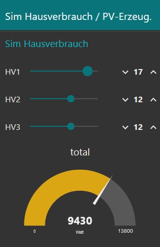

Kannst Du mal diesen flow bei Dir probieren:
Ich musste die Schleifen der Sliderkopplung wieder rausnehmen, weil es bei mir an zu Flattern anfängt.
[{"id":"9c914c19df595675","type":"tab","label":"Gero","disabled":false,"info":"","env":[]},{"id":"97ce6c56cb2baf03","type":"ui_slider","z":"9c914c19df595675","name":"","label":"HV1","tooltip":"","group":"0268d1212c203718","order":1,"width":"4","height":"1","passthru":true,"outs":"all","topic":"topic","topicType":"msg","min":0,"max":"20","step":1,"className":"","x":110,"y":100,"wires":[["f975d815e97a181b"]]},{"id":"1024d77b919acba0","type":"ui_slider","z":"9c914c19df595675","name":"","label":"HV2","tooltip":"","group":"0268d1212c203718","order":3,"width":"4","height":"1","passthru":true,"outs":"all","topic":"topic","topicType":"msg","min":0,"max":"20","step":1,"className":"","x":110,"y":180,"wires":[["9bd96c0b53581396"]]},{"id":"9bd96c0b53581396","type":"ui_numeric","z":"9c914c19df595675","name":"n2","label":"","tooltip":"","group":"0268d1212c203718","order":4,"width":"2","height":"1","wrap":false,"passthru":true,"topic":"topic","topicType":"msg","format":"{{value}}","min":0,"max":"20","step":1,"className":"","x":250,"y":180,"wires":[["9b8b60bb10225244"]]},{"id":"f975d815e97a181b","type":"ui_numeric","z":"9c914c19df595675","name":"n1","label":"","tooltip":"","group":"0268d1212c203718","order":2,"width":"2","height":"1","wrap":false,"passthru":true,"topic":"topic","topicType":"msg","format":"{{value}}","min":0,"max":"20","step":1,"className":"","x":250,"y":100,"wires":[["f76fd4277af673dc"]]},{"id":"f76fd4277af673dc","type":"change","z":"9c914c19df595675","name":"","rules":[{"t":"set","p":"s1","pt":"flow","to":"payload","tot":"msg"}],"action":"","property":"","from":"","to":"","reg":false,"x":450,"y":100,"wires":[["a410097e0fee0c91"]]},{"id":"9b8b60bb10225244","type":"change","z":"9c914c19df595675","name":"","rules":[{"t":"set","p":"s2","pt":"flow","to":"payload","tot":"msg"}],"action":"","property":"","from":"","to":"","reg":false,"x":450,"y":180,"wires":[["a410097e0fee0c91"]]},{"id":"a410097e0fee0c91","type":"function","z":"9c914c19df595675","name":"Summe in Watt","func":"msg.payload = flow.get(\"s1\")+flow.get(\"s2\")+flow.get(\"s3\");\nmsg.payload = 230*msg.payload;\nreturn msg;","outputs":1,"noerr":0,"initialize":"","finalize":"","libs":[],"x":660,"y":180,"wires":[["366353fbdc4e66b1"]]},{"id":"366353fbdc4e66b1","type":"ui_gauge","z":"9c914c19df595675","name":"","group":"0268d1212c203718","order":7,"width":0,"height":0,"gtype":"gage","title":"total","label":"Watt","format":"{{value}}","min":0,"max":"13800","colors":["#00b500","#e6e600","#ca3838"],"seg1":"","seg2":"","className":"","x":870,"y":180,"wires":[]},{"id":"37302d1de942153d","type":"mqtt in","z":"9c914c19df595675","name":"Hausverbrauch","topic":"openWB/global/WHouseConsumption","qos":"2","datatype":"auto","broker":"c4cb83c8.1bd0c","nl":false,"rap":true,"rh":0,"inputs":0,"x":140,"y":380,"wires":[[]]},{"id":"f60e38b81463bb64","type":"ui_slider","z":"9c914c19df595675","name":"","label":"HV3","tooltip":"","group":"0268d1212c203718","order":5,"width":"4","height":"1","passthru":true,"outs":"all","topic":"topic","topicType":"msg","min":0,"max":"20","step":1,"className":"","x":110,"y":260,"wires":[["77a398ae8b4481ab"]]},{"id":"77a398ae8b4481ab","type":"ui_numeric","z":"9c914c19df595675","name":"n3","label":"","tooltip":"","group":"0268d1212c203718","order":6,"width":"2","height":"1","wrap":false,"passthru":true,"topic":"topic","topicType":"msg","format":"{{value}}","min":0,"max":"20","step":1,"className":"","x":250,"y":260,"wires":[["4778cf914b1668f2"]]},{"id":"4778cf914b1668f2","type":"change","z":"9c914c19df595675","name":"","rules":[{"t":"set","p":"s3","pt":"flow","to":"payload","tot":"msg"}],"action":"","property":"","from":"","to":"","reg":false,"x":450,"y":260,"wires":[["a410097e0fee0c91"]]},{"id":"0268d1212c203718","type":"ui_group","name":"Sim Hausverbrauch","tab":"744b5117.d18b28","order":1,"disp":true,"width":"6","collapse":false,"className":""},{"id":"c4cb83c8.1bd0c","type":"mqtt-broker","name":"OpenWB","broker":"192.168.8.11","port":"1883","clientid":"","usetls":false,"compatmode":false,"keepalive":"30","cleansession":true,"birthTopic":"","birthQos":"0","birthRetain":"false","birthPayload":"","closeTopic":"","closeQos":"0","closeRetain":"false","closePayload":"","willTopic":"","willQos":"0","willRetain":"false","willPayload":""},{"id":"744b5117.d18b28","type":"ui_tab","name":"Sim Hausverbrauch / PV-Erzeug.","icon":"dashboard","disabled":false,"hidden":false}]-

Re: Beispiele: openWB Integration an Node-Red
Das Problem ist, dass die context-Variablen nicht ordentlich initialisiert sind. Da kommt dann aus der Summierfunktion ein NaN heraus (hab' ich mit der debug-node rausgefunden) und damit kann die Gauge nix anfangen. Die Inject-Node übernimmt nun das initialisieren. Alternativ halt auf allen drei Slidern rumklickern beim letzten kommt dann ein Wert in der Gauge an. Aber es gibt bestimmt auch einen anderen Weg das ordentlich zu machen: Entweder alle drei Variablen beim Deploy auf 0 initialisieren oder in der Summenfunktion nur die addieren, die auch gesetzt sind.
Die Rückwärtsschleifen funktionieren bei mir aber. Sowohl auf dem Raspi als auf der CCU.
