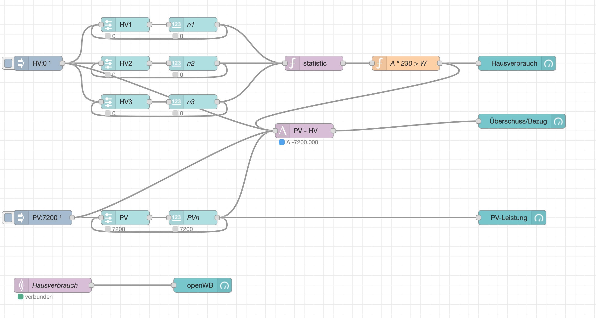

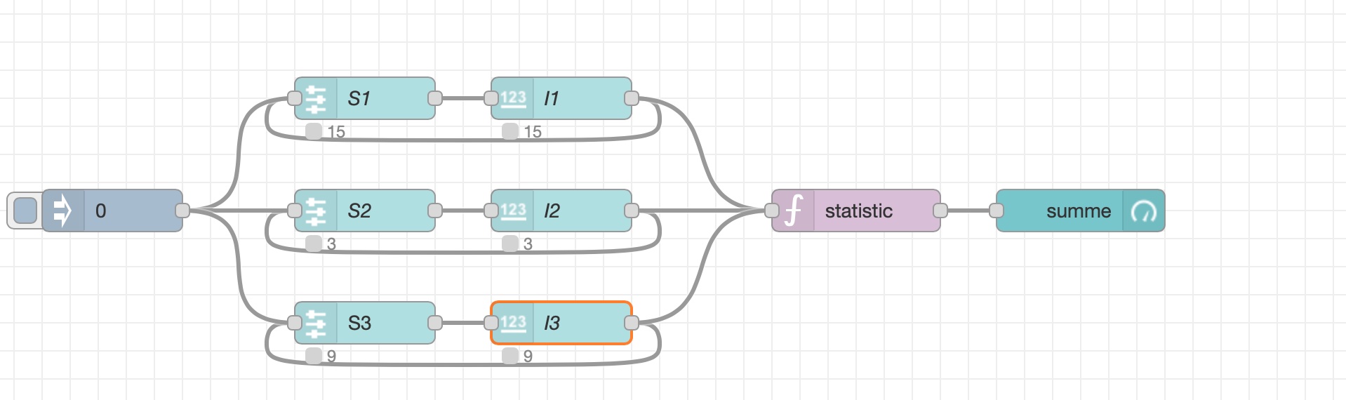

So hier ein mehr node-reddiger Lösungsvorschlag:
Nun habe ich verstanden, wie die statistic-node aus node-red-contrib-combine funktioniert. Sie summiert alle Werte unterschiedlicher Topics. D.h. Sie merkt sich den Wert jedes Topics und gibt dann die Summe aller Topics aus. Dementsprechend muss jede Slider/Numeric-Gruppe ein eigenes Topic bekommen, dann klappt's auch mit der Summierung.
[{"id":"6eac542e.5dabf4","type":"tab","label":"Flow 1","disabled":false,"info":""},{"id":"e56b20c5.ce2a78","type":"ui_slider","z":"6eac542e.5dabf4","name":"S1","label":"S1","tooltip":"","group":"1de0097c.41aea7","order":3,"width":"4","height":"1","passthru":true,"outs":"all","topic":"SI1","topicType":"str","min":0,"max":"20","step":1,"className":"","x":270,"y":100,"wires":[["e2dd636a.e87488"]]},{"id":"39d9e634.6f9e2a","type":"ui_slider","z":"6eac542e.5dabf4","name":"S2","label":"S2","tooltip":"","group":"1de0097c.41aea7","order":5,"width":"4","height":"1","passthru":true,"outs":"all","topic":"SI2","topicType":"str","min":0,"max":"20","step":1,"className":"","x":270,"y":180,"wires":[["ffb1249.b156ad8"]]},{"id":"ffb1249.b156ad8","type":"ui_numeric","z":"6eac542e.5dabf4","name":"I2","label":"","tooltip":"","group":"1de0097c.41aea7","order":6,"width":"2","height":"1","wrap":false,"passthru":true,"topic":"SI2","topicType":"str","format":"{{value}}","min":0,"max":"20","step":1,"className":"","x":410,"y":180,"wires":[["39d9e634.6f9e2a","9c07867f.be1bb"]]},{"id":"e2dd636a.e87488","type":"ui_numeric","z":"6eac542e.5dabf4","name":"I1","label":"","tooltip":"","group":"1de0097c.41aea7","order":4,"width":"2","height":"1","wrap":false,"passthru":true,"topic":"SI1","topicType":"str","format":"{{value}}","min":0,"max":"20","step":1,"className":"","x":410,"y":100,"wires":[["e56b20c5.ce2a78","9c07867f.be1bb"]]},{"id":"22f39c88.e11c04","type":"ui_slider","z":"6eac542e.5dabf4","name":"","label":"S3","tooltip":"","group":"1de0097c.41aea7","order":7,"width":"4","height":"1","passthru":true,"outs":"all","topic":"SI3","topicType":"str","min":0,"max":"20","step":1,"className":"","x":270,"y":260,"wires":[["a5d3a640.8a69b8"]]},{"id":"9c07867f.be1bb","type":"combine-statistic","z":"6eac542e.5dabf4","name":"","topic":"HV","operator":"sum","falsy":"include","defer":250,"timeout":"0","distinction":"topic","x":620,"y":180,"wires":[["3fbf70b5.4a3ec"]]},{"id":"3fbf70b5.4a3ec","type":"ui_gauge","z":"6eac542e.5dabf4","name":"","group":"1de0097c.41aea7","order":9,"width":0,"height":0,"gtype":"gage","title":"summe","label":"Watt","format":"{{value}}","min":0,"max":"13800","colors":["#00b500","#e6e600","#ca3838"],"seg1":"","seg2":"","className":"","x":780,"y":180,"wires":[]},{"id":"3485204b.a1ab68","type":"inject","z":"6eac542e.5dabf4","name":"","props":[{"p":"payload"}],"repeat":"","crontab":"","once":false,"onceDelay":0.1,"topic":"","payload":"0","payloadType":"num","x":90,"y":180,"wires":[["e56b20c5.ce2a78","39d9e634.6f9e2a","22f39c88.e11c04"]]},{"id":"a5d3a640.8a69b8","type":"ui_numeric","z":"6eac542e.5dabf4","name":"I3","label":"","tooltip":"","group":"1de0097c.41aea7","order":8,"width":"2","height":"1","wrap":false,"passthru":true,"topic":"SI3","topicType":"str","format":"{{value}}","min":0,"max":"20","step":1,"className":"","x":410,"y":260,"wires":[["22f39c88.e11c04","9c07867f.be1bb"]]},{"id":"1de0097c.41aea7","type":"ui_group","name":"Simulation","tab":"744b5117.d18b28","order":1,"disp":true,"width":"6","collapse":false,"className":""},{"id":"744b5117.d18b28","type":"ui_tab","name":"Haussimulation","icon":"dashboard","disabled":false,"hidden":false}]

Re: Beispiele: openWB Integration an Node-Red
und ich dachte schon, ich muss jetzt auf Python umschwenken
. Na mal sehen, ob wir den Sim zum Laufen bekommen. Danach geb' ich einen aus.
Den statistic-node bekomme ich bei mir immer noch als unknown. Auch die Schleifen flattern heftigst.
Kannst Du mal den Inhalt des function-node posten?
Du musst das noch das node-red-contrib-combine installieren. Da ist die statistic-node drin. Das mit dem Flattern habe ich bei mir nicht. Das kommt dann vielleicht von den unterschiedlichen Versionen?

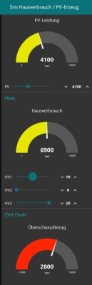

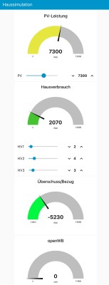

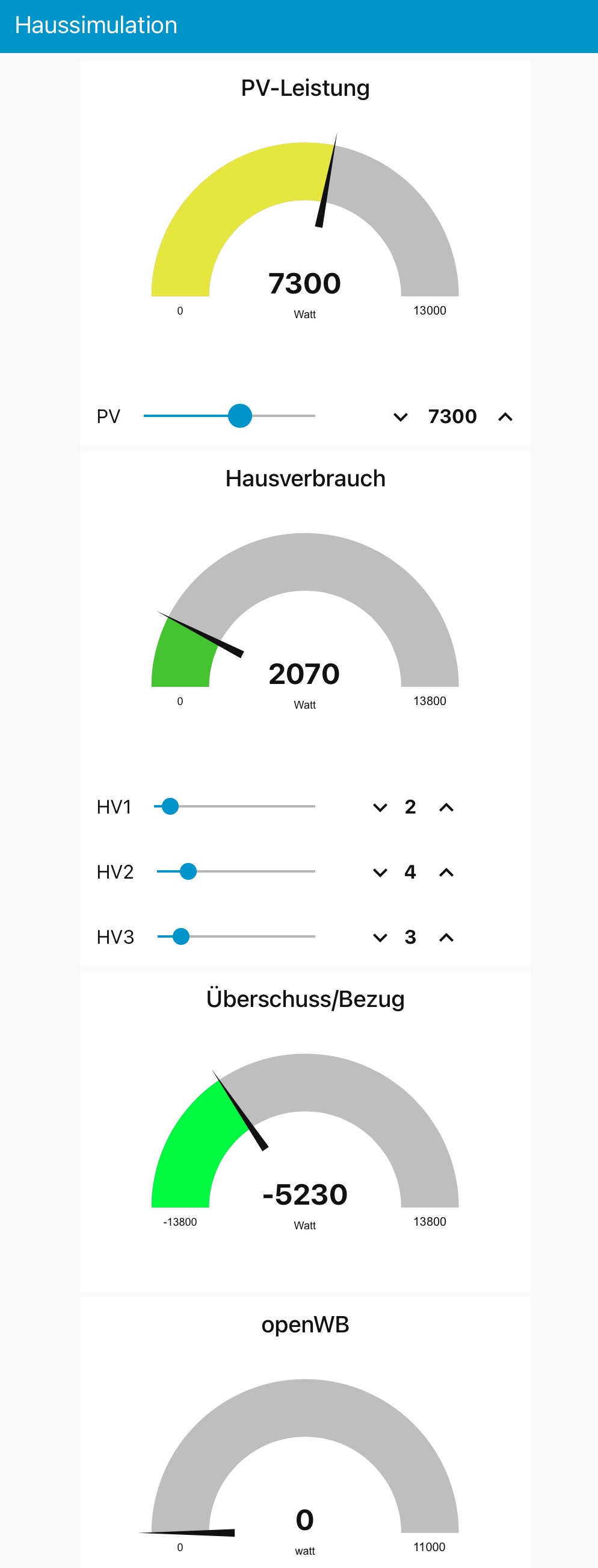

Ich hab' mal weitergebaut: Ich kann nun die PV-Leistung verdrehen und den Hausverbrauch einstellen. Raus kommt wenig überraschend die Leistung am EVU-Punkt. Und ganz unten schon mal die Geamt-Ladeleistung der openWB.
Hier ist der Flow dazu:
Auf die Spannung und die Frequenz habe ich erst mal verzichtet, Als Demonstrator reicht das ja vielleicht auch nur mit den Leistungen.
Du müsstest also nur noch die einzelnen Werte in die richtigen MQTT-Topics der openWB schreiben.
[{"id":"cf354afd.9bc818","type":"tab","label":"Haussimulation","disabled":false,"info":""},{"id":"5719608c.cb6d5","type":"ui_slider","z":"cf354afd.9bc818","name":"","label":"HV1","tooltip":"","group":"e4b1e54c.678138","order":2,"width":"4","height":"1","passthru":true,"outs":"all","topic":"HV1","topicType":"str","min":0,"max":"20","step":1,"className":"","x":270,"y":100,"wires":[["bbecace6.cf6118"]]},{"id":"4c4decd7.181c64","type":"ui_slider","z":"cf354afd.9bc818","name":"","label":"HV2","tooltip":"","group":"e4b1e54c.678138","order":4,"width":"4","height":"1","passthru":true,"outs":"all","topic":"HV2","topicType":"str","min":0,"max":"20","step":1,"className":"","x":270,"y":180,"wires":[["73c7b491.eca484"]]},{"id":"73c7b491.eca484","type":"ui_numeric","z":"cf354afd.9bc818","name":"n2","label":"","tooltip":"","group":"e4b1e54c.678138","order":5,"width":"2","height":"1","wrap":false,"passthru":true,"topic":"HV2","topicType":"str","format":"{{value}}","min":0,"max":"20","step":1,"className":"","x":410,"y":180,"wires":[["4c4decd7.181c64","61f39718.4707a"]]},{"id":"bbecace6.cf6118","type":"ui_numeric","z":"cf354afd.9bc818","name":"n1","label":"","tooltip":"","group":"e4b1e54c.678138","order":3,"width":"2","height":"1","wrap":false,"passthru":true,"topic":"HV1","topicType":"str","format":"{{value}}","min":0,"max":"20","step":1,"className":"","x":410,"y":100,"wires":[["5719608c.cb6d5","61f39718.4707a"]]},{"id":"73d4ae7a.9e5378","type":"ui_gauge","z":"cf354afd.9bc818","name":"","group":"e4b1e54c.678138","order":1,"width":0,"height":0,"gtype":"gage","title":"Hausverbrauch","label":"Watt","format":"{{value}}","min":0,"max":"13800","colors":["#00b500","#e6e600","#ca3838"],"seg1":"","seg2":"","className":"","x":1080,"y":180,"wires":[]},{"id":"33e16f4f.c097e8","type":"ui_slider","z":"cf354afd.9bc818","name":"","label":"HV3","tooltip":"","group":"e4b1e54c.678138","order":6,"width":"4","height":"1","passthru":true,"outs":"all","topic":"HV3","topicType":"str","min":0,"max":"20","step":1,"className":"","x":270,"y":260,"wires":[["c46e3ffe.11dc18"]]},{"id":"c46e3ffe.11dc18","type":"ui_numeric","z":"cf354afd.9bc818","name":"n3","label":"","tooltip":"","group":"e4b1e54c.678138","order":7,"width":"2","height":"1","wrap":false,"passthru":true,"topic":"HV3","topicType":"str","format":"{{value}}","min":0,"max":"20","step":1,"className":"","x":410,"y":260,"wires":[["33e16f4f.c097e8","61f39718.4707a"]]},{"id":"3b68517d.870aae","type":"inject","z":"cf354afd.9bc818","name":"","props":[{"p":"payload"},{"p":"topic","vt":"str"}],"repeat":"","crontab":"","once":true,"onceDelay":0.1,"topic":"HV","payload":"0","payloadType":"num","x":90,"y":180,"wires":[["5719608c.cb6d5","4c4decd7.181c64","33e16f4f.c097e8","5fca2631.32d338"]]},{"id":"967fc91e.c1e34","type":"ui_slider","z":"cf354afd.9bc818","name":"","label":"PV","tooltip":"","group":"1de0097c.41aea7","order":2,"width":"4","height":"1","passthru":true,"outs":"all","topic":"PV","topicType":"str","min":0,"max":"13000","step":"100","className":"","x":270,"y":500,"wires":[["7ed00085.af4438"]]},{"id":"7ed00085.af4438","type":"ui_numeric","z":"cf354afd.9bc818","name":"PVn","label":"","tooltip":"","group":"1de0097c.41aea7","order":3,"width":"3","height":"1","wrap":false,"passthru":true,"topic":"PV","topicType":"str","format":"{{value}}","min":0,"max":"13000","step":"100","className":"","x":410,"y":500,"wires":[["967fc91e.c1e34","5fca2631.32d338","49e4bb93.e612c4"]]},{"id":"49e4bb93.e612c4","type":"ui_gauge","z":"cf354afd.9bc818","name":"","group":"1de0097c.41aea7","order":1,"width":0,"height":0,"gtype":"gage","title":"PV-Leistung","label":"Watt","format":"{{value}}","min":0,"max":"13000","colors":["#e6e600","#e6e600","#e6e600"],"seg1":"","seg2":"","className":"","x":1070,"y":500,"wires":[]},{"id":"a28ea702.28953","type":"ui_gauge","z":"cf354afd.9bc818","name":"","group":"5dcc2e5f.f76a9","order":8,"width":0,"height":0,"gtype":"gage","title":"Überschuss/Bezug","label":"Watt","format":"{{value}}","min":"-13800","max":"13800","colors":["#00f900","#00f900","#ff2600"],"seg1":"100","seg2":"100","className":"","x":1090,"y":300,"wires":[]},{"id":"61f39718.4707a","type":"combine-statistic","z":"cf354afd.9bc818","name":"","topic":"HV","operator":"sum","falsy":"include","defer":250,"timeout":0,"distinction":"topic","x":660,"y":180,"wires":[["1ac0d787.7324c8"]]},{"id":"5fca2631.32d338","type":"combine-delta","z":"cf354afd.9bc818","topic":"","topicA":"HV","topicB":"PV","name":"PV - HV","x":640,"y":320,"wires":[["a28ea702.28953"]]},{"id":"1ac0d787.7324c8","type":"function","z":"cf354afd.9bc818","name":"A * 230 > W","func":"msg.payload = msg.payload * 230;\nreturn msg;","outputs":1,"noerr":0,"initialize":"","finalize":"","x":850,"y":180,"wires":[["73d4ae7a.9e5378","5fca2631.32d338"]]},{"id":"e1fc2a5a.4cf05","type":"inject","z":"cf354afd.9bc818","name":"","props":[{"p":"payload"},{"p":"topic","vt":"str"}],"repeat":"","crontab":"","once":true,"onceDelay":0.1,"topic":"PV","payload":"7200","payloadType":"num","x":100,"y":500,"wires":[["967fc91e.c1e34","5fca2631.32d338"]]},{"id":"ed5b83b7.d1883","type":"mqtt in","z":"cf354afd.9bc818","name":"Hausverbrauch","topic":"openWB/global/WAllChargePoints","qos":"2","datatype":"auto","broker":"978968c8.7b5238","x":120,"y":640,"wires":[["77fdf7a5.1417b"]]},{"id":"77fdf7a5.1417b","type":"ui_gauge","z":"cf354afd.9bc818","name":"","group":"9545499f.a61ca8","order":0,"width":0,"height":0,"gtype":"gage","title":"openWB","label":"watt","format":"{{value}}","min":0,"max":"11000","colors":["#00b500","#00b500","#00b500"],"seg1":"","seg2":"","className":"","x":430,"y":640,"wires":[]},{"id":"e4b1e54c.678138","type":"ui_group","name":"Hausverbrauch","tab":"744b5117.d18b28","order":2,"disp":false,"width":"7","collapse":false,"className":""},{"id":"1de0097c.41aea7","type":"ui_group","name":"PV Produkion","tab":"744b5117.d18b28","order":1,"disp":false,"width":"7","collapse":false,"className":""},{"id":"5dcc2e5f.f76a9","type":"ui_group","name":"Überschuss","tab":"744b5117.d18b28","order":3,"disp":false,"width":"7","collapse":false,"className":""},{"id":"978968c8.7b5238","type":"mqtt-broker","name":"OpenWB","broker":"192.168.8.11","port":"1883","clientid":"","usetls":false,"compatmode":false,"keepalive":"30","cleansession":true,"birthTopic":"","birthQos":"0","birthRetain":"false","birthPayload":"","closeTopic":"","closeQos":"0","closeRetain":"false","closePayload":"","willTopic":"","willQos":"0","willRetain":"false","willPayload":""},{"id":"9545499f.a61ca8","type":"ui_group","name":"Wallbox","tab":"744b5117.d18b28","order":4,"disp":false,"width":"7","collapse":false,"className":""},{"id":"744b5117.d18b28","type":"ui_tab","name":"Haussimulation","icon":"dashboard","disabled":false,"hidden":false}]
mächtig gewaltig!
Der combine-node ist sehr hilfreich. Bis auf die Schleifen läuft alles sauber. Ich habe sie erst einmal entfernt. Ich tippe auch auf die unterschiedlichen node-Versionen.

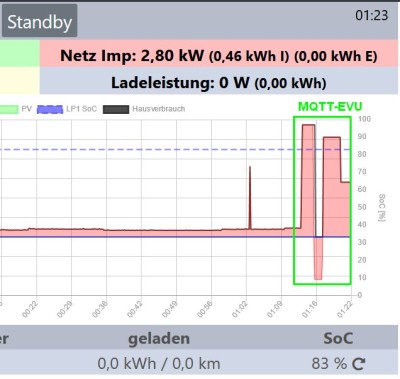

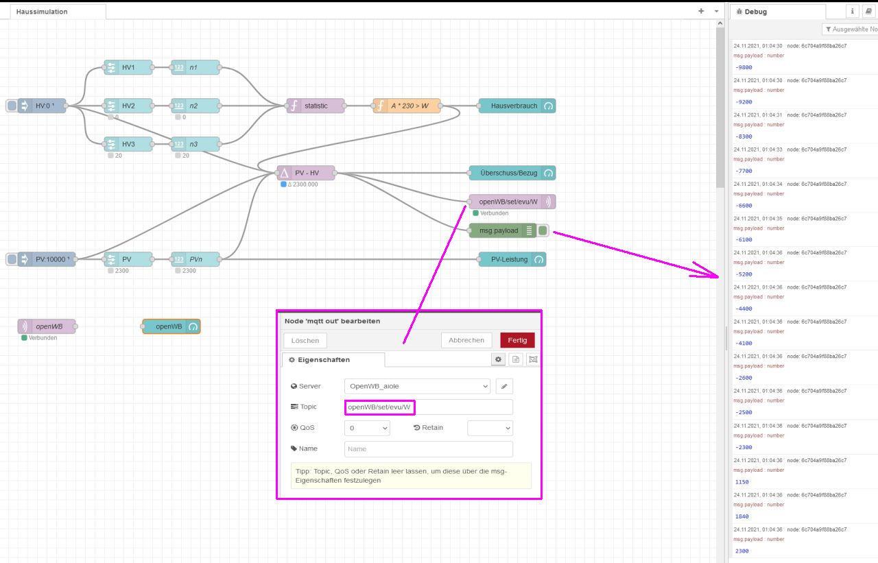

Eine oWB-MQTT-Auslesung der oWB nach Deinem Bsp. viewtopic.php?p=49177#p49177 habe ich gut hinbekommen. So langsam kommt Licht ins Dunkel, wobei ich noch ein paar Fragen habe:
1. Muss man jeden Wert einzeln mit einem extra MQTT-out-node an oWB senden oder kann man z.B. alle Werte-Ausgaben über einen node laufen lassen?
2. Im Gegensatz zum lesenden chargepoint-Bsp. muss ich MQTT-out für SET nutzen; cool = > Nach EVU-Umstellung auf MQTT in oWB kommen dort die Werte.
3. Gibt es noch eine Option die verschiedenen Dashboard-Fenstergruppen nach Wunsch anzuordnen? Innerhalb der Fenster habe ich gefunden, aber nicht untereinander. Aktuell liegen die bei mir alle untereinander.
Das war ein Mega-Schritt (für mich). Hier mal visulle Ergebnisse:

Da man in der Node ja nur ein Topic angeben kann, würde ich erst mal sagen ja. Kannst ja mal suchen, ob es sowas wie einen Multi-MQTT node gibt, dem man ein Array als Payload gibt. Oder dass das MQTT-Topic aus dem NodeRED-Topic genommen wird. Ich vermute aber eher mal nicht.aiole hat geschrieben: Mi Nov 24, 2021 12:27 am 1. Muss man jeden Wert einzeln mit einem extra MQTT-out-node an oWB senden oder kann man z.B. alle Werte-Ausgaben über einen node laufen lassen?
Genau so war es ja gedacht. Man dreht an PV und HV rum und schaut was die openWB daraus macht. Wäre ja auch zum Debugging hilfreich. Ich denke da an den noch offenen PR mit der Ladeleistung und den 1p3-Umschalten. viewtopic.php?f=9&t=4063aiole hat geschrieben: Mi Nov 24, 2021 12:27 am 2. Im Gegensatz zum lesenden chargepoint-Bsp. muss ich MQTT-out für SET nutzen; cool = > Nach EVU-Umstellung auf MQTT in oWB kommen dort die Werte.

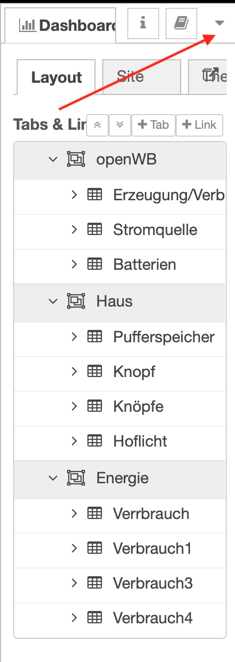

Klick mal dieses Menü hier und wähle Dashboard - das hier sind bei mir drei Screens, zwischen denen ich auf dem Handy hin- und herwischen kann.aiole hat geschrieben: Mi Nov 24, 2021 12:27 am 3. Gibt es noch eine Option die verschiedenen Dashboard-Fenstergruppen nach Wunsch anzuordnen? Innerhalb der Fenster habe ich gefunden, aber nicht untereinander. Aktuell liegen die bei mir alle untereinander.

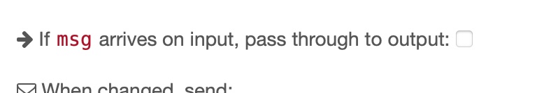

Wegen des Flatterns hätte ich noch einen Tip: Probier' mal im Slider diese Option auszuschalten - wir brauchen den ja nur zu schieben und nicht nochmal den Wert:
