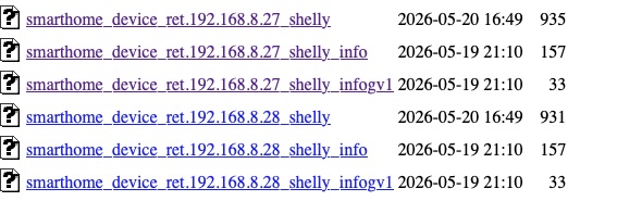

In der RAMDisk finde ich bei der betreffenden IP folgendes:
{'ble': {}, 'bthome': {'errors': ['bluetooth_disabled']}, 'cloud': {'connected': False}, 'em1:0': {'id': 0, 'voltage': 228.5, 'current': 0.177, 'act_power': 4.4, 'aprt_power': 40.6, 'pf': 0.53, 'freq': 50.0, 'calibration': 'factory'}, 'em1:1': {'id': 1, 'voltage': 228.4, 'current': 0.0, 'act_power': 0.0, 'aprt_power': 4.6, 'pf': 0.0, 'freq': 50.0, 'calibration': 'factory'}, 'em1data:0': {'id': 0, 'total_act_energy': 59765.78, 'total_act_ret_energy': 0.0}, 'em1data:1': {'id': 1, 'total_act_energy': 0.03, 'total_act_ret_energy': 0.01}, 'mqtt': {'connected': True}, 'switch:0': {'id': 0, 'source': 'init', 'output': False, 'temperature': {'tC': 47.7, 'tF': 117.8}}, 'sys': {'mac': 'B08184E9A9C4', 'restart_required': False, 'time': '17:16', 'unixtime': 1779290183, 'last_sync_ts': 1779289981, 'uptime': 7338, 'ram_size': 266504, 'ram_free': 145316, 'ram_min_free': 125096, 'fs_size': 786432, 'fs_free': 323584, 'cfg_rev': 15, 'kvs_rev': 0, 'schedule_rev': 0, 'webhook_rev': 0, 'btrelay_rev': 0, 'available_updates': {'beta': {'version': '2.0.0-beta1'}}, 'reset_reason': 3, 'utc_offset': 7200}, 'wifi': {'sta_ip': '192.168.3.150', 'status': 'got ip', 'ssid': 'DataNET', 'bssid': 'cc:ce:1e:ad:ca:98', 'rssi': -70}, 'ws': {'connected': False}}
Es sind also Werte für z.B. 'act_power' vorhanden. Anscheinend werden die nicht richtig zugeordnet ???
