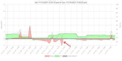

My PV inverter is from Solis (Ginlong), which is not natively supported. I can read out values using MQTT, however this is only updated every 2-4 mins, so no instant feedback.

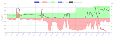

This leads to situations where - in case of clouds - my "Bezug" suddenly drops or increases, but the PV remains constant. Please see the graphs in the example. It looks as if my "Hausverbrauch" is going up and down, but in fact it is the PV which is fluctuating (but not shown for ony short spikes).
You can see the spikes at the middle and also at the end, if clouds suddenly pass in front or if the sun suddenly shines more.
How will this affect the PV charging? My smart meter still registers network import & export correctly and immediately. Only the PV is not always responding immediately.

the PV Data is only needed for a nice visualisation, if have live data from the grid point, the crontrol if the charging current is absolutely fine
