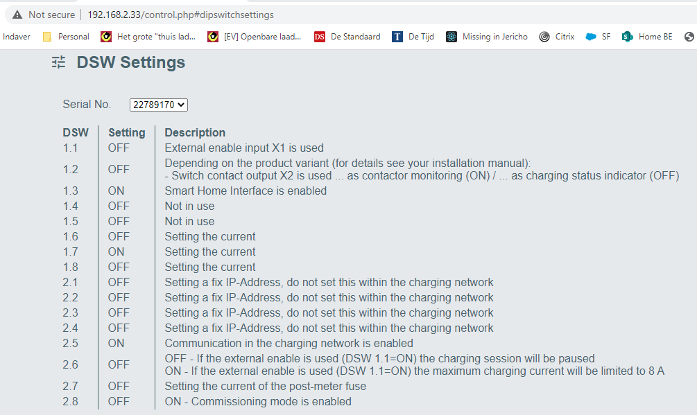

- Dip switches are correctly configured as far as I can tell. i.e: 1.3 is ON (smart home interface), as well as 2.5 (Communication in the charging network is enabled)

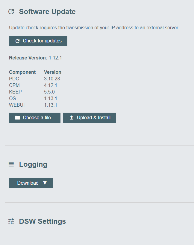

- Upgraded my firmware to the latest version (1.12.1)
- I can reach and control the wallbox though the web interface

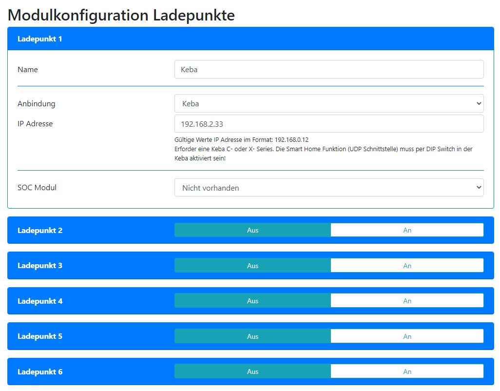

- Modulkonfiguration Ladepunkte: Keba, with IP address pointing to the Keba wallbox

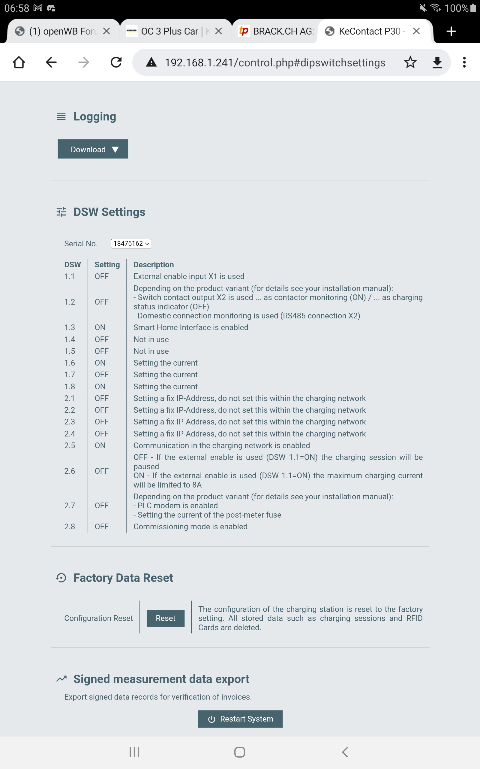

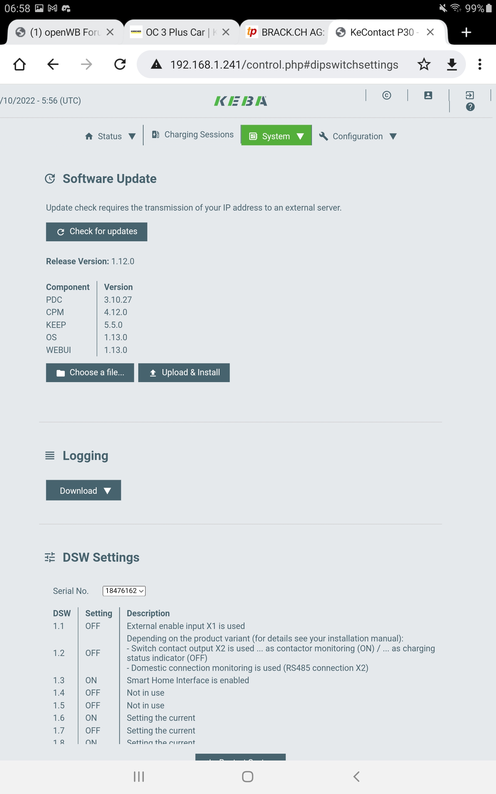

Well the keba seems not to open port 502, atrached you see my dip switches setting and my installed softwareversion. I have one keba -x
Please check this against your installation, in case you still have problems, please show me all parameters. Which openWb version do you have ? Is it self installed ?

Thanks for your quick reply. See screenshots below for my openwb and Keba configuration.
