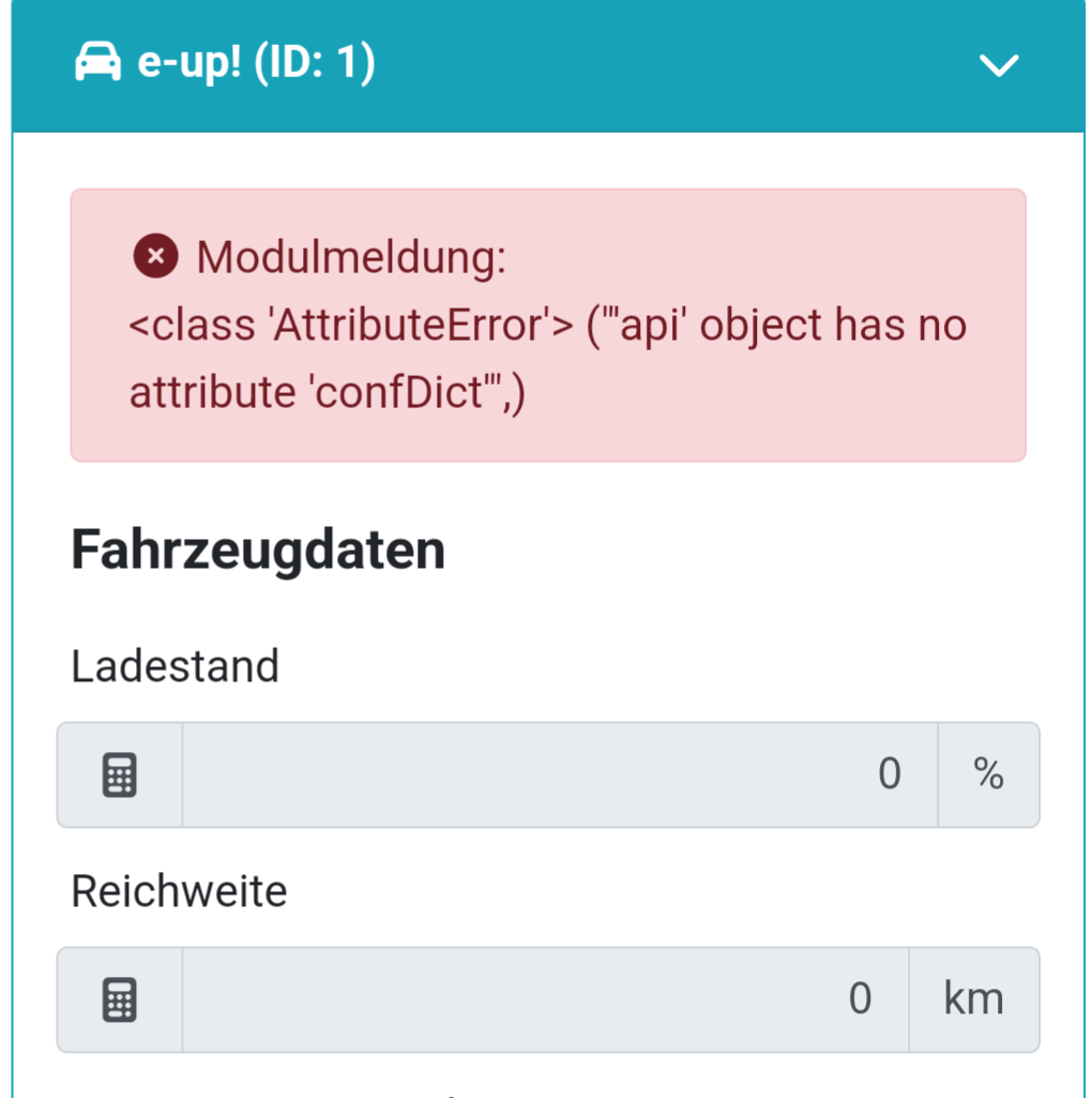

Mit dem Update 2.1.6 kam das OVMS-Modul hinzu, welches ich gleich nutzen wollte. Leider erhalte ich eine Fehlermeldung und habe keinen Plan was falsch sein soll.

Hmm, ich nehme an Du hast in der Konfiguration des Moduls alles richtig eingetragen.
Was steht im SOC-Log? (Einstellungen - System - Fehlersuche - SoC-Log), evtl. den Debug Level mal auf Info stellen und den SoC im Desktop manuell abrufen (Kreispfeil).
Log eines Abrufs hier als Code Block posten (Button </>)

von hengsti
https://paste.openwb.de/Sy3B0IdtD9X4iyv
2024-12-01 12:41:42,687 - {modules.common.configurable_vehicle:56} - {DEBUG:fetch soc_ev1} - Vehicle Instance <class 'modules.vehicles.ovms.config.OVMS'>
2024-12-01 12:41:42,688 - {modules.common.configurable_vehicle:57} - {DEBUG:fetch soc_ev1} - Calculated SoC-State CalculatedSocState(imported_start=None, manual_soc=None, soc_start=80)
2024-12-01 12:41:42,688 - {modules.common.configurable_vehicle:58} - {DEBUG:fetch soc_ev1} - Vehicle Update Data VehicleUpdateData(plug_state=False, charge_state=False, imported=None, battery_capacity=32000, efficiency=92, soc_from_cp=None, timestamp_soc_from_cp=None)
2024-12-01 12:41:42,688 - {modules.common.configurable_vehicle:59} - {DEBUG:fetch soc_ev1} - General Config GeneralVehicleConfig(use_soc_from_cp=False, request_interval_charging=180, request_interval_not_charging=1800, request_only_plugged=False)
2024-12-01 12:41:42,689 - {modules.common.component_context:26} - {DEBUG:fetch soc_ev1} - Update Komponente ['OVMS']
2024-12-01 12:41:42,689 - {asyncio:59} - {DEBUG:fetch soc_ev1} - Using selector: EpollSelector
2024-12-01 12:41:42,697 - {urllib3.connectionpool:973} - {DEBUG:fetch soc_ev1} - Starting new HTTPS connection (1): dexters-web.de:6869
2024-12-01 12:41:42,858 - {urllib3.connectionpool:452} - {DEBUG:fetch soc_ev1} - https://dexters-web.de:6869 "POST /api/token?username=xxx&password=0F%26t5w8PRE HTTP/1.1" 201 165
2024-12-01 12:41:42,861 - {modules.common.req:32} - {DEBUG:fetch soc_ev1} - Get-Response: {"application":"owb-ovms-2.x-vh1","owner":"xxx","permit":"auth","purpose":"get soc","token":"c824e9bef323e8566c4b2a0b7f9a0ea2cb166ef996ee79063ce8e579602b42cd"}
2024-12-01 12:41:42,862 - {modules.vehicles.ovms.api:52} - {DEBUG:fetch soc_ev1} - create_token status_code=201
2024-12-01 12:41:42,863 - {modules.vehicles.ovms.api:54} - {DEBUG:fetch soc_ev1} - create_token response={
    "application": "owb-ovms-2.x-vh1",
    "owner": "xxx",
    "permit": "auth",
    "purpose": "get soc",
    "token": "c824e9bef323e8566c4b2a0b7f9a0ea2cb166ef996ee79063ce8e579602b42cd"
2024-12-01 12:41:42,865 - {modules.common.fault_state:49} - {ERROR:fetch soc_ev1} - OVMS: FaultState FaultStateLevel.ERROR, FaultStr <class 'AttributeError'> ("'api' object has no attribute 'confDict'",), Traceback:
  File "/var/www/html/openWB/packages/modules/common/configurable_vehicle.py", line 66, in update
  File "/var/www/html/openWB/packages/modules/common/configurable_vehicle.py", line 110, in _get_carstate_by_source
  File "/var/www/html/openWB/packages/modules/vehicles/ovms/soc.py", line 24, in updater
    return fetch(vehicle_update_data, vehicle_config, vehicle)
  File "/var/www/html/openWB/packages/modules/vehicles/ovms/soc.py", line 18, in fetch
    soc, range, soc_ts = api.fetch_soc(config, vehicle)
  File "/var/www/html/openWB/packages/modules/vehicles/ovms/api.py", line 190, in fetch_soc
    soc, range, soc_ts = loop.run_until_complete(a._fetch_soc(conf, vehicle))
  File "/usr/lib/python3.9/asyncio/base_events.py", line 642, in run_until_complete
    return future.result()
  File "/var/www/html/openWB/packages/modules/vehicles/ovms/api.py", line 143, in _fetch_soc
    self.token = self.create_token()
  File "/var/www/html/openWB/packages/modules/vehicles/ovms/api.py", line 56, in create_token
    log.debug("create_token confDict=" + dumps(self.confDict, indent=4))
AttributeError: 'api' object has no attribute 'confDict'

von rleidner
Danke für die Rückmeldung.
Da ist noch ein Fehler wenn das Modul neu konfiguriert wird.
Das hatte ich leider bei mir lange nicht mehr getestet.
Ich behebe das und melde mich, wenn es ein PR gibt (dann aber erst mal im Zweig master).
