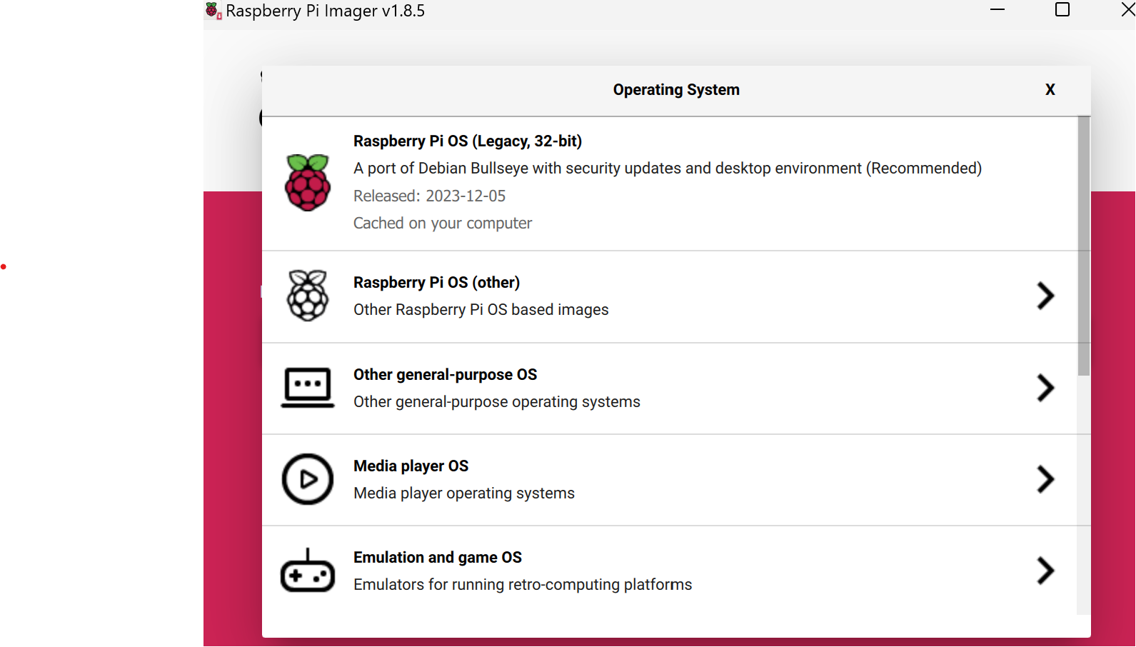

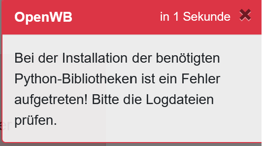

Wenn ich die Konfiguration öffne kommt immer wieder die Fehlermeldung das ein Python Modul nicht installiert werden konnte.
Das Basis System ist ein normal mit dem Raspian Imager auf die SD-Karte geflashstes aktuelles Bullseye vom 5.12.2023.
  File "/usr/bin/pip3", line 33, in <module>
    sys.exit(load_entry_point('pip==20.3.4', 'console_scripts', 'pip3')())
  File "/usr/bin/pip3", line 25, in importlib_load_entry_point
    return next(matches).load()
  File "/usr/lib/python3.9/importlib/metadata.py", line 77, in load
    module = import_module(match.group('module'))
  File "/usr/lib/python3.9/importlib/__init__.py", line 127, in import_module
    return _bootstrap._gcd_import(name[level:], package, level)
  File "<frozen importlib._bootstrap>", line 1030, in _gcd_import
  File "<frozen importlib._bootstrap>", line 1007, in _find_and_load
  File "<frozen importlib._bootstrap>", line 986, in _find_and_load_unlocked
  File "<frozen importlib._bootstrap>", line 680, in _load_unlocked
  File "<frozen importlib._bootstrap_external>", line 790, in exec_module
  File "<frozen importlib._bootstrap>", line 228, in _call_with_frames_removed
  File "/usr/lib/python3/dist-packages/pip/_internal/cli/main.py", line 10, in <module>
    from pip._internal.cli.autocompletion import autocomplete
  File "/usr/lib/python3/dist-packages/pip/_internal/cli/autocompletion.py", line 9, in <module>
    from pip._internal.cli.main_parser import create_main_parser
  File "/usr/lib/python3/dist-packages/pip/_internal/cli/main_parser.py", line 7, in <module>
    from pip._internal.cli import cmdoptions
  File "/usr/lib/python3/dist-packages/pip/_internal/cli/cmdoptions.py", line 23, in <module>
    from pip._vendor.packaging.utils import canonicalize_name
  File "/usr/lib/python3/dist-packages/pip/_vendor/__init__.py", line 94, in <module>
    vendored("requests.packages.urllib3.contrib.pyopenssl")
  File "/usr/lib/python3/dist-packages/pip/_vendor/__init__.py", line 36, in vendored
    __import__(modulename, globals(), locals(), level=0)
  File "<frozen importlib._bootstrap>", line 664, in _load_unlocked
  File "<frozen importlib._bootstrap>", line 627, in _load_backward_compatible
  File "<frozen zipimport>", line 259, in load_module
  File "/usr/share/python-wheels/urllib3-1.26.5-py2.py3-none-any.whl/urllib3/contrib/pyopenssl.py", line 50, in <module>
  File "/usr/lib/python3/dist-packages/OpenSSL/__init__.py", line 8, in <module>
    from OpenSSL import crypto, SSL
  File "/usr/lib/python3/dist-packages/OpenSSL/crypto.py", line 1556, in <module>
    class X509StoreFlags(object):
  File "/usr/lib/python3/dist-packages/OpenSSL/crypto.py", line 1577, in X509StoreFlags
    CB_ISSUER_CHECK = _lib.X509_V_FLAG_CB_ISSUER_CHECK
AttributeError: module 'lib' has no attribute 'X509_V_FLAG_CB_ISSUER_CHECK'
failed!

Du bist auf sw2?
Wenn ja, warum nimmst Du nicht das fertige Image aus den Ankündigungen?
failed!
64 Bit OS mal probiert?
