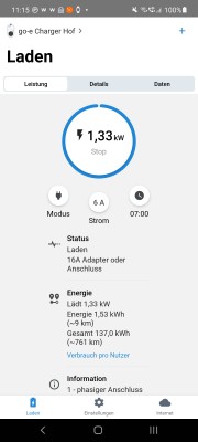

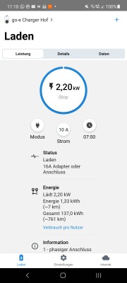

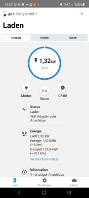

Im nicht ladenden Zustand:
Ladung gestartet:
Nach 10 Minuten laden:
Nach 20 Minuten laden:
11 Uhr:
11:05 Uhr:
11:10 Uhr:
11:15 Uhr:
{"version":"B","tme":"0109211021","rbc":"27","rbt":"59699531","car":"4","amp":"6","err":"0","ast":"0","alw":"0","stp":"0","cbl":"20","pha":"8","tmp":"10","tma":[18.50,18.00,17.63,18.50],"amt":"32","dws":"99754","dwo":"0","adi":"1","uby":"0","eto":"1360","wst":"3","txi":"0","nrg":[220,0,0,1,0,0,0,0,0,0,0,0,0,0,0,0],"fwv":"040.0","sse":"026504","wss":"UPCE2C8383","wke":"************","wen":"1","cdi":"0","tof":"101","tds":"1","lbr":"4","aho":"3","afi":"7","azo":"1","ama":"16","al1":"6","al2":"8","al3":"10","al4":"12","al5":"14","cid":"255","cch":"65535","cfi":"65280","lse":"1","ust":"2","wak":"42d9c638e2","r1x":"2","dto":"0","nmo":"0","sch":"AAAAAAAAAAAAAAAA","sdp":"0","eca":"0","ecr":"0","ecd":"0","ec4":"0","ec5":"0","ec6":"0","ec7":"0","ec8":"0","ec9":"0","ec1":"0","rca":"04553F7A","rcr":"","rcd":"","rc4":"","rc5":"","rc6":"","rc7":"","rc8":"","rc9":"","rc1":"","rna":"","rnm":"","rne":"","rn4":"","rn5":"","rn6":"","rn7":"","rn8":"","rn9":"","rn1":"","loe":0,"lot":0,"lom":0,"lop":0,"log":"","lon":0,"lof":0,"loa":0,"lch":58918,"mce":0,"mcs":"test.mosquitto.org","mcp":1883,"mcu":"","mck":"","mcc":0}
{"version":"B","tme":"0109211030","rbc":"27","rbt":"60220210","car":"2","amp":"6","err":"0","ast":"0","alw":"1","stp":"0","cbl":"20","pha":"9","tmp":"10","tma":[18.63,18.13,17.75,18.75],"amt":"32","dws":"108741","dwo":"0","adi":"1","uby":"0","eto":"1360","wst":"3","txi":"0","nrg":[220,0,0,1,59,0,0,13,0,0,0,132,100,0,0,32],"fwv":"040.0","sse":"026504","wss":"UPCE2C8383","wke":"************","wen":"1","cdi":"0","tof":"101","tds":"1","lbr":"4","aho":"3","afi":"7","azo":"1","ama":"16","al1":"6","al2":"8","al3":"10","al4":"12","al5":"14","cid":"255","cch":"65535","cfi":"65280","lse":"1","ust":"2","wak":"42d9c638e2","r1x":"2","dto":"0","nmo":"0","sch":"AAAAAAAAAAAAAAAA","sdp":"0","eca":"0","ecr":"0","ecd":"0","ec4":"0","ec5":"0","ec6":"0","ec7":"0","ec8":"0","ec9":"0","ec1":"0","rca":"04553F7A","rcr":"","rcd":"","rc4":"","rc5":"","rc6":"","rc7":"","rc8":"","rc9":"","rc1":"","rna":"","rnm":"","rne":"","rn4":"","rn5":"","rn6":"","rn7":"","rn8":"","rn9":"","rn1":"","loe":0,"lot":0,"lom":0,"lop":0,"log":"","lon":0,"lof":0,"loa":0,"lch":0,"mce":0,"mcs":"test.mosquitto.org","mcp":1883,"mcu":"","mck":"","mcc":0}
{"version":"B","tme":"0109211040","rbc":"27","rbt":"60845093","car":"2","amp":"8","err":"0","ast":"0","alw":"1","stp":"0","cbl":"20","pha":"9","tmp":"11","tma":[19.63,18.88,18.75,20.13],"amt":"32","dws":"199796","dwo":"0","adi":"1","uby":"0","eto":"1360","wst":"3","txi":"0","nrg":[219,0,0,1,77,0,0,17,0,0,0,173,100,0,0,42],"fwv":"040.0","sse":"026504","wss":"UPCE2C8383","wke":"************","wen":"1","cdi":"0","tof":"101","tds":"1","lbr":"4","aho":"3","afi":"7","azo":"1","ama":"16","al1":"6","al2":"8","al3":"10","al4":"12","al5":"14","cid":"255","cch":"65535","cfi":"65280","lse":"1","ust":"2","wak":"42d9c638e2","r1x":"2","dto":"0","nmo":"0","sch":"AAAAAAAAAAAAAAAA","sdp":"0","eca":"0","ecr":"0","ecd":"0","ec4":"0","ec5":"0","ec6":"0","ec7":"0","ec8":"0","ec9":"0","ec1":"0","rca":"04553F7A","rcr":"","rcd":"","rc4":"","rc5":"","rc6":"","rc7":"","rc8":"","rc9":"","rc1":"","rna":"","rnm":"","rne":"","rn4":"","rn5":"","rn6":"","rn7":"","rn8":"","rn9":"","rn1":"","loe":0,"lot":0,"lom":0,"lop":0,"log":"","lon":0,"lof":0,"loa":0,"lch":0,"mce":0,"mcs":"test.mosquitto.org","mcp":1883,"mcu":"","mck":"","mcc":0}
{"version":"B","tme":"0109211050","rbc":"27","rbt":"61408118","car":"2","amp":"6","err":"0","ast":"0","alw":"1","stp":"0","cbl":"20","pha":"9","tmp":"12","tma":[20.38,19.88,19.75,21.25],"amt":"32","dws":"279114","dwo":"0","adi":"1","uby":"0","eto":"1360","wst":"3","txi":"0","nrg":[220,0,0,1,59,0,0,13,0,0,0,132,100,0,0,38],"fwv":"040.0","sse":"026504","wss":"UPCE2C8383","wke":"************","wen":"1","cdi":"0","tof":"101","tds":"1","lbr":"4","aho":"3","afi":"7","azo":"1","ama":"16","al1":"6","al2":"8","al3":"10","al4":"12","al5":"14","cid":"255","cch":"65535","cfi":"65280","lse":"1","ust":"2","wak":"42d9c638e2","r1x":"2","dto":"0","nmo":"0","sch":"AAAAAAAAAAAAAAAA","sdp":"0","eca":"0","ecr":"0","ecd":"0","ec4":"0","ec5":"0","ec6":"0","ec7":"0","ec8":"0","ec9":"0","ec1":"0","rca":"04553F7A","rcr":"","rcd":"","rc4":"","rc5":"","rc6":"","rc7":"","rc8":"","rc9":"","rc1":"","rna":"","rnm":"","rne":"","rn4":"","rn5":"","rn6":"","rn7":"","rn8":"","rn9":"","rn1":"","loe":0,"lot":0,"lom":0,"lop":0,"log":"","lon":0,"lof":0,"loa":0,"lch":0,"mce":0,"mcs":"test.mosquitto.org","mcp":1883,"mcu":"","mck":"","mcc":0}
{"version":"B","tme":"0109211100","rbc":"27","rbt":"61990556","car":"2","amp":"6","err":"0","ast":"0","alw":"1","stp":"0","cbl":"20","pha":"9","tmp":"12","tma":[21.50,20.63,20.88,22.75],"amt":"32","dws":"367330","dwo":"0","adi":"1","uby":"0","eto":"1370","wst":"3","txi":"0","nrg":[221,0,0,1,59,0,0,13,0,0,0,134,100,0,0,26],"fwv":"040.0","sse":"026504","wss":"UPCE2C8383","wke":"************","wen":"1","cdi":"0","tof":"101","tds":"1","lbr":"4","aho":"3","afi":"7","azo":"1","ama":"16","al1":"6","al2":"8","al3":"10","al4":"12","al5":"14","cid":"255","cch":"65535","cfi":"65280","lse":"1","ust":"2","wak":"42d9c638e2","r1x":"2","dto":"0","nmo":"0","sch":"AAAAAAAAAAAAAAAA","sdp":"0","eca":"0","ecr":"0","ecd":"0","ec4":"0","ec5":"0","ec6":"0","ec7":"0","ec8":"0","ec9":"0","ec1":"0","rca":"04553F7A","rcr":"","rcd":"","rc4":"","rc5":"","rc6":"","rc7":"","rc8":"","rc9":"","rc1":"","rna":"","rnm":"","rne":"","rn4":"","rn5":"","rn6":"","rn7":"","rn8":"","rn9":"","rn1":"","loe":0,"lot":0,"lom":0,"lop":0,"log":"","lon":0,"lof":0,"loa":0,"lch":0,"mce":0,"mcs":"test.mosquitto.org","mcp":1883,"mcu":"","mck":"","mcc":0}
{"version":"B","tme":"0109211105","rbc":"27","rbt":"62326859","car":"2","amp":"12","err":"0","ast":"0","alw":"1","stp":"0","cbl":"20","pha":"9","tmp":"16","tma":[21.75,21.13,21.25,23.25],"amt":"32","dws":"412196","dwo":"0","adi":"1","uby":"0","eto":"1370","wst":"3","txi":"0","nrg":[218,0,0,1,113,0,0,25,0,0,0,251,100,0,0,62],"fwv":"040.0","sse":"026504","wss":"UPCE2C8383","wke":"************","wen":"1","cdi":"0","tof":"101","tds":"1","lbr":"4","aho":"3","afi":"7","azo":"1","ama":"16","al1":"6","al2":"8","al3":"10","al4":"12","al5":"14","cid":"255","cch":"65535","cfi":"65280","lse":"1","ust":"2","wak":"42d9c638e2","r1x":"2","dto":"0","nmo":"0","sch":"AAAAAAAAAAAAAAAA","sdp":"0","eca":"0","ecr":"0","ecd":"0","ec4":"0","ec5":"0","ec6":"0","ec7":"0","ec8":"0","ec9":"0","ec1":"0","rca":"04553F7A","rcr":"","rcd":"","rc4":"","rc5":"","rc6":"","rc7":"","rc8":"","rc9":"","rc1":"","rna":"","rnm":"","rne":"","rn4":"","rn5":"","rn6":"","rn7":"","rn8":"","rn9":"","rn1":"","loe":0,"lot":0,"lom":0,"lop":0,"log":"","lon":0,"lof":0,"loa":0,"lch":0,"mce":0,"mcs":"test.mosquitto.org","mcp":1883,"mcu":"","mck":"","mcc":0}
{"version":"B","tme":"0109211110","rbc":"27","rbt":"62593295","car":"2","amp":"10","err":"0","ast":"0","alw":"1","stp":"0","cbl":"20","pha":"9","tmp":"16","tma":[23.13,21.75,22.00,24.38],"amt":"32","dws":"480222","dwo":"0","adi":"1","uby":"0","eto":"1370","wst":"3","txi":"0","nrg":[220,0,0,1,98,0,0,21,0,0,0,220,100,0,0,45],"fwv":"040.0","sse":"026504","wss":"UPCE2C8383","wke":"************","wen":"1","cdi":"0","tof":"101","tds":"1","lbr":"4","aho":"3","afi":"7","azo":"1","ama":"16","al1":"6","al2":"8","al3":"10","al4":"12","al5":"14","cid":"255","cch":"65535","cfi":"65280","lse":"1","ust":"2","wak":"42d9c638e2","r1x":"2","dto":"0","nmo":"0","sch":"AAAAAAAAAAAAAAAA","sdp":"0","eca":"0","ecr":"0","ecd":"0","ec4":"0","ec5":"0","ec6":"0","ec7":"0","ec8":"0","ec9":"0","ec1":"0","rca":"04553F7A","rcr":"","rcd":"","rc4":"","rc5":"","rc6":"","rc7":"","rc8":"","rc9":"","rc1":"","rna":"","rnm":"","rne":"","rn4":"","rn5":"","rn6":"","rn7":"","rn8":"","rn9":"","rn1":"","loe":0,"lot":0,"lom":0,"lop":0,"log":"","lon":0,"lof":0,"loa":0,"lch":0,"mce":0,"mcs":"test.mosquitto.org","mcp":1883,"mcu":"","mck":"","mcc":0}
{"version":"B","tme":"0109211115","rbc":"27","rbt":"62901760","car":"2","amp":"6","err":"0","ast":"0","alw":"1","stp":"0","cbl":"20","pha":"9","tmp":"16","tma":[24.00,23.00,22.88,25.88],"amt":"32","dws":"552477","dwo":"0","adi":"1","uby":"0","eto":"1370","wst":"3","txi":"0","nrg":[221,0,0,1,59,0,0,13,0,0,0,133,100,0,0,19],"fwv":"040.0","sse":"026504","wss":"UPCE2C8383","wke":"************","wen":"1","cdi":"0","tof":"101","tds":"1","lbr":"4","aho":"3","afi":"7","azo":"1","ama":"16","al1":"6","al2":"8","al3":"10","al4":"12","al5":"14","cid":"255","cch":"65535","cfi":"65280","lse":"1","ust":"2","wak":"42d9c638e2","r1x":"2","dto":"0","nmo":"0","sch":"AAAAAAAAAAAAAAAA","sdp":"0","eca":"0","ecr":"0","ecd":"0","ec4":"0","ec5":"0","ec6":"0","ec7":"0","ec8":"0","ec9":"0","ec1":"0","rca":"04553F7A","rcr":"","rcd":"","rc4":"","rc5":"","rc6":"","rc7":"","rc8":"","rc9":"","rc1":"","rna":"","rnm":"","rne":"","rn4":"","rn5":"","rn6":"","rn7":"","rn8":"","rn9":"","rn1":"","loe":0,"lot":0,"lom":0,"lop":0,"log":"","lon":0,"lof":0,"loa":0,"lch":0,"mce":0,"mcs":"test.mosquitto.org","mcp":1883,"mcu":"","mck":"","mcc":0}

Also der Parameter dws wird im Modul nicht verwendet.
Werte sind in den 3 (4
) übertragenen Fällen:
99754
108741
199796
279114
11:00 : 367330 dWs --> 1,02 kWh (eto: 1370)
11:05 : 412196 dWs --> 1,14 kWh (eto: 1370)
11:10 : 480222 dWs --> 1,33 kWh (eto: 1370)
11:15 : 552477 dWs --> 1,53 kWh (eto: 1370)
Wenn ich das normale Modul mit dem gepimpten Modul vergleiche, geht es um das Ramdisk File / Wert llkwh, der aktuell über den API Wert eto gefüllt wird und in allen Fällen 1360 enthält. Das wird dann noch in einen Wert 136.000 umgerechnet im Modul.
Kannst du die Werte aus dws mit Hilfe der App in einen Bezug bringen?

Ich habe jetzt mal im obigen Beitrag die Werte noch mal ergänzt. Aber in Bezug bringen kann ich das irgendwie nicht.
Ah, halt sind Watt Sekunden, also /3600 muss noch rein.
Edit: DekaWs, damit /360
habe es oben auch noch mal korrigiert und eingetragen.

- Beiträge: 1034
- Registriert: Mi Jul 21, 2021 3:00 pm
Re: go-e charger Modulverbesserung
Passt super, wenn ich richtig denke
Edit: Ok, haben wir beide wohl gleichzeitig gerechnet![Wink ;-)](./images/smilies/icon_e_wink.gif)
