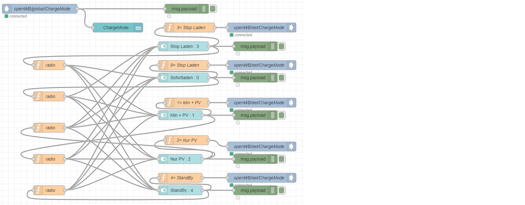

[Ich habe mir auch mal in NodeRed was programmiert.
Den ChargeMode habe ich mal anders modelliert s.Bild.
Auf einem Handy kann man die OpenWB so einfach bedienen.
NodeRed Code:

Re: Beispiele: openWB Integration an Node-Red
Beitrag von Werner2000x »
hominidae hat geschrieben: Sa Nov 09, 2019 10:45 am Hallo Gemeinde,
dank MQTT (mit der REST-API geht es auch, ist aber mehr Arbeit) kann man nun ab 1.64beta die openWB in Node-Red (www.nodered.org) einbinden und so zum Beispiel eigene Dashboards oder komplexere Regeln abbilden.
Hier ein Beispiel, für die Darstellung der EVU Werte und ein Dashboard zur Einstellung für den manuellen Zielladiungsmodus (kWh) inkl. Startverzögerung, gezielt für einen LP.
..der Flow für die EVU Werte im Node-Red Dashboard:
und als Export zum Import in Node-Red:
[{"id":"90f78b.543da878","type":"tab","label":"OpenWB-EVU","disabled":false,"info":""},{"id":"1920f887.874e27","type":"switch","z":"90f78b.543da878","name":"OPENWB EVU","property":"topic","propertyType":"msg","rules":[{"t":"cont","v":"evu/VPhase1","vt":"str"},{"t":"cont","v":"evu/VPhase2","vt":"str"},{"t":"cont","v":"evu/VPhase3","vt":"str"},{"t":"cont","v":"evu/APhase1","vt":"str"},{"t":"cont","v":"evu/APhase2","vt":"str"},{"t":"cont","v":"evu/APhase3","vt":"str"},{"t":"eq","v":"openWB/evu/W","vt":"str"},{"t":"else"}],"checkall":"false","repair":false,"outputs":8,"x":500,"y":300,"wires":[["58db8671.2eb288"],["278d750c.2e9caa"],["673ac631.70db08"],["7f8dd076.58719","429ddc96.4a0a14"],["4a55f8d5.8da4a8","1232b57f.b5dcab"],["aa1dff4e.07cc4","2420f6ae.b6fb0a"],["c86d07fe.98be38"],["48703c49.cf7214"]]},{"id":"58db8671.2eb288","type":"ui_text","z":"90f78b.543da878","group":"910cd9b8.54f308","order":3,"width":"3","height":"1","name":"EVU V1","label":"V1:","format":"{{msg.payload}}V","layout":"row-center","x":1020,"y":180,"wires":[]},{"id":"278d750c.2e9caa","type":"ui_text","z":"90f78b.543da878","group":"910cd9b8.54f308","order":4,"width":"3","height":"1","name":"EVU V2","label":"V2:","format":"{{msg.payload}}V","layout":"row-center","x":1020,"y":220,"wires":[]},{"id":"673ac631.70db08","type":"ui_text","z":"90f78b.543da878","group":"910cd9b8.54f308","order":5,"width":"3","height":"1","name":"EVU V3","label":"V3:","format":"{{msg.payload}}V","layout":"row-center","x":1020,"y":260,"wires":[]},{"id":"7f8dd076.58719","type":"ui_gauge","z":"90f78b.543da878","name":"","group":"910cd9b8.54f308","order":6,"width":"3","height":"2","gtype":"gage","title":"EVU A1","label":"A","format":"{{value}}","min":0,"max":"64","colors":["#00b500","#e6e600","#ca3838"],"seg1":"16","seg2":"32","x":1020,"y":300,"wires":[]},{"id":"4a55f8d5.8da4a8","type":"ui_gauge","z":"90f78b.543da878","name":"","group":"910cd9b8.54f308","order":7,"width":"3","height":"2","gtype":"gage","title":"EVU A2","label":"A","format":"{{value}}","min":0,"max":"64","colors":["#00b500","#e6e600","#ca3838"],"seg1":"16","seg2":"32","x":1020,"y":340,"wires":[]},{"id":"aa1dff4e.07cc4","type":"ui_gauge","z":"90f78b.543da878","name":"","group":"910cd9b8.54f308","order":8,"width":"3","height":"2","gtype":"gage","title":"EVU A3","label":"A","format":"{{value}}","min":0,"max":"64","colors":["#00b500","#e6e600","#ca3838"],"seg1":"16","seg2":"32","x":1020,"y":380,"wires":[]},{"id":"c3cbc362.ce125","type":"ui_text","z":"90f78b.543da878","group":"910cd9b8.54f308","order":1,"width":"6","height":"1","name":"Datum","label":"Datum","format":"{{msg.payload}}","layout":"col-center","x":1010,"y":460,"wires":[]},{"id":"c86d07fe.98be38","type":"ui_text","z":"90f78b.543da878","group":"910cd9b8.54f308","order":2,"width":"3","height":"1","name":"","label":"Leistung","format":"{{msg.payload}}W","layout":"col-center","x":1020,"y":420,"wires":[]},{"id":"429ddc96.4a0a14","type":"change","z":"90f78b.543da878","name":"L1","rules":[{"t":"set","p":"topic","pt":"msg","to":"L1","tot":"str"}],"action":"","property":"","from":"","to":"","reg":false,"x":690,"y":40,"wires":[["12d1cd38.d956a3"]]},{"id":"1232b57f.b5dcab","type":"change","z":"90f78b.543da878","name":"L2","rules":[{"t":"set","p":"topic","pt":"msg","to":"L2","tot":"str"}],"action":"","property":"","from":"","to":"","reg":false,"x":690,"y":80,"wires":[["12d1cd38.d956a3"]]},{"id":"2420f6ae.b6fb0a","type":"change","z":"90f78b.543da878","name":"L3","rules":[{"t":"set","p":"topic","pt":"msg","to":"L3","tot":"str"}],"action":"","property":"","from":"","to":"","reg":false,"x":690,"y":120,"wires":[["12d1cd38.d956a3"]]},{"id":"12d1cd38.d956a3","type":"ui_chart","z":"90f78b.543da878","name":"EVU Amps","group":"910cd9b8.54f308","order":8,"width":0,"height":0,"label":"EVU - L1 L2 L3 (A)","chartType":"line","legend":"true","xformat":"HH:mm","interpolate":"linear","nodata":"","dot":false,"ymin":"","ymax":"","removeOlder":1,"removeOlderPoints":"","removeOlderUnit":"86400","cutout":0,"useOneColor":false,"colors":["#0080ff","#00ff40","#ff0000","#2ca02c","#98df8a","#d62728","#ff9896","#9467bd","#c5b0d5"],"useOldStyle":false,"outputs":1,"x":930,"y":80,"wires":[[]]},{"id":"41b64b63.c40fd4","type":"mqtt in","z":"90f78b.543da878","name":"EVU","topic":"openWB/evu/+","qos":"2","datatype":"auto","broker":"bddb336e.6dda","x":170,"y":300,"wires":[["1920f887.874e27"]]},{"id":"48703c49.cf7214","type":"function","z":"90f78b.543da878","name":"timestamp","func":"msg.payload = new Date().toISOString();\nreturn msg;","outputs":1,"noerr":0,"x":570,"y":420,"wires":[["3e4ccaf8.9d2526"]]},{"id":"3e4ccaf8.9d2526","type":"moment","z":"90f78b.543da878","name":"dd DD.MM.YY - HH:mm","topic":"date","input":"payload","inputType":"msg","inTz":"Europe/Berlin","adjAmount":0,"adjType":"days","adjDir":"add","format":"dd DD.MM.YY - HH:mm","locale":"DE","output":"payload","outputType":"msg","outTz":"Europe/Berlin","x":590,"y":480,"wires":[["f3896d9f.deb5d"]]},{"id":"f3896d9f.deb5d","type":"rbe","z":"90f78b.543da878","name":"","func":"rbe","gap":"","start":"","inout":"out","property":"payload","x":850,"y":460,"wires":[["c3cbc362.ce125","47c2ee55.7a954"]]},{"id":"e6f98b37.f93878","type":"mqtt out","z":"90f78b.543da878","name":"to openWB","topic":"","qos":"","retain":"","broker":"bddb336e.6dda","x":570,"y":640,"wires":[]},{"id":"47c2ee55.7a954","type":"change","z":"90f78b.543da878","name":"openWB/evu/date","rules":[{"t":"set","p":"topic","pt":"msg","to":"openWB/evu/date","tot":"str"},{"t":"set","p":"retain","pt":"msg","to":"true","tot":"bool"}],"action":"","property":"","from":"","to":"","reg":false,"x":760,"y":560,"wires":[["e6f98b37.f93878"]]},{"id":"910cd9b8.54f308","type":"ui_group","z":"","name":"EVU","tab":"d55078b2.26bcd8","order":1,"disp":true,"width":"9","collapse":false},{"id":"bddb336e.6dda","type":"mqtt-broker","z":"","name":"mqtt on alarm","broker":"192.168.10.22","port":"1883","clientid":"","usetls":false,"compatmode":true,"keepalive":"60","cleansession":true,"birthTopic":"","birthQos":"0","birthPayload":"","closeTopic":"","closeQos":"0","closePayload":"","willTopic":"","willQos":"0","willPayload":""},{"id":"d55078b2.26bcd8","type":"ui_tab","z":"","name":"OPENWB","icon":"dashboard","order":2,"disabled":false,"hidden":false}]
Kannst du noch den Nodered Code für das LP 1 Zielladen veröffentlichen?

Werner2000x hat geschrieben: Mo Okt 04, 2021 11:17 am Kannst du noch den Nodered Code für das LP 1 Zielladen veröffentlichen?
...das ist/war nur eine UI Spielerei..die Anbindung zum ansteuern der openWB musst Du noch bauen.
Zu der Zeit gab es die Zielladen- und SoC-Features dort ja noch nicht.
Ich bin aktuell on-the-road ... kann den Flow zur Inspiration mal am We einstellen, wenn ich zurück bin.

Werner2000x hat geschrieben: Do Okt 07, 2021 4:50 pm:-)
...OK, hier ist er:
[{"id":"135ab1a7.7d7d8e","type":"tab","label":"OpenWB LP1","disabled":false,"info":""},{"id":"8f806a67.b24418","type":"ui_slider","z":"135ab1a7.7d7d8e","name":"","label":"","tooltip":"","group":"cb797d1a.e0522","order":9,"width":"5","height":"1","passthru":true,"outs":"all","topic":"","min":0,"max":"100","step":1,"x":110,"y":60,"wires":[["2b96b93b.00ae76","95b0983c.3831b8","bdf4bfcb.1c9c"]]},{"id":"2b96b93b.00ae76","type":"ui_text","z":"135ab1a7.7d7d8e","group":"cb797d1a.e0522","order":2,"width":"3","height":"1","name":"","label":"SoC (Start)","format":"{{msg.payload}}%","layout":"col-center","x":290,"y":60,"wires":[]},{"id":"d20de990.e5fc38","type":"ui_text","z":"135ab1a7.7d7d8e","group":"cb797d1a.e0522","order":7,"width":"5","height":"1","name":"","label":"kWh","format":"{{msg.payload}}","layout":"col-center","x":430,"y":300,"wires":[]},{"id":"95b0983c.3831b8","type":"function","z":"135ab1a7.7d7d8e","name":"SoC-2-kWh","func":"var lp1socalt=flow.get('lp1socalt') || 0;\nvar max = 28;\nvar l = msg.payload;\nvar p = max / 100 * l;\nmsg.payload = p;\nflow.set('lp1socalt',p);\nreturn msg;","outputs":1,"noerr":0,"x":230,"y":200,"wires":[["453f7b46.22a4b4","4d427657.1e5b78"]]},{"id":"453f7b46.22a4b4","type":"calculator","z":"135ab1a7.7d7d8e","name":"round-3digits","inputMsgField":"payload","outputMsgField":"payload","operation":"rdec","constant":"3","x":220,"y":280,"wires":[["d20de990.e5fc38"]]},{"id":"3ab1c668.c2891a","type":"ui_text","z":"135ab1a7.7d7d8e","group":"cb797d1a.e0522","order":5,"width":"3","height":"1","name":"","label":"SoC (Ziel)","format":"{{msg.payload}}%","layout":"col-center","x":900,"y":60,"wires":[]},{"id":"8eea38da.03d748","type":"ui_text","z":"135ab1a7.7d7d8e","group":"cb797d1a.e0522","order":8,"width":"5","height":"1","name":"","label":"kWh","format":"{{msg.payload}}","layout":"col-center","x":1090,"y":200,"wires":[]},{"id":"b97b321a.87b22","type":"function","z":"135ab1a7.7d7d8e","name":"SoC-2-kWh","func":"var lp1socneu=flow.get('lp1socneu') || 0;\nvar max = 28;\nvar l = msg.payload;\nvar p = max / 100 * l;\nmsg.payload = p;\nflow.set('lp1socneu',p);\nreturn msg;","outputs":1,"noerr":0,"x":910,"y":120,"wires":[["114f484e.ab6388","4d427657.1e5b78"]]},{"id":"114f484e.ab6388","type":"calculator","z":"135ab1a7.7d7d8e","name":"round-3digits","inputMsgField":"payload","outputMsgField":"payload","operation":"rdec","constant":"3","x":1090,"y":100,"wires":[["8eea38da.03d748"]]},{"id":"9419834b.500e1","type":"function","z":"135ab1a7.7d7d8e","name":"Ist + 5 Prozent","func":"var lp1soc=flow.get('lp1soc') || 0;\nvar l = msg.payload;\nif (l<95) {\n    l=l+5;\n}\nflow.set('lp1soc',l);\nmsg.payload = l;\nreturn msg;","outputs":1,"noerr":0,"x":400,"y":140,"wires":[["d892ef61.db736"]]},{"id":"d892ef61.db736","type":"ui_slider","z":"135ab1a7.7d7d8e","name":"","label":"","tooltip":"","group":"cb797d1a.e0522","order":10,"width":"5","height":"1","passthru":true,"outs":"all","topic":"","min":0,"max":"100","step":1,"x":530,"y":60,"wires":[["67b3c8ba.1c5728"]]},{"id":"ff6b2c1c.5210b","type":"function","z":"135ab1a7.7d7d8e","name":"soll > ist","func":"var lp1soc=flow.get('lp1soc') || 0;\nvar l = msg.payload;\nif (l<lp1soc) {\n    l = lp1soc;\n}\nmsg.payload = l;\nreturn msg;","outputs":1,"noerr":0,"x":700,"y":60,"wires":[["3ab1c668.c2891a","b97b321a.87b22"]]},{"id":"368d4489.5a6edc","type":"ui_text","z":"135ab1a7.7d7d8e","group":"cb797d1a.e0522","order":11,"width":"5","height":"1","name":"","label":"Ziel-Lademenge","format":"{{msg.payload}} kWh","layout":"col-center","x":1080,"y":260,"wires":[]},{"id":"d7505c09.f25c4","type":"calculator","z":"135ab1a7.7d7d8e","name":"round-3digits","inputMsgField":"payload","outputMsgField":"payload","operation":"rdec","constant":"3","x":850,"y":260,"wires":[["368d4489.5a6edc"]]},{"id":"4d427657.1e5b78","type":"function","z":"135ab1a7.7d7d8e","name":"SocNeu - SocAlt","func":"var lp1socalt=flow.get('lp1socalt') || 0;\nvar lp1socneu=flow.get('lp1socneu') || 0;\nvar l = lp1socneu - lp1socalt;\nflow.set('lp1energy',l);\nmsg.payload = l;\nreturn msg;","outputs":1,"noerr":0,"x":820,"y":200,"wires":[["d7505c09.f25c4","5a5ccb7c.d4aeb4"]]},{"id":"40da9051.a0232","type":"ui_switch","z":"135ab1a7.7d7d8e","name":"Zielladen an/aus","label":"Zielladen an/aus","tooltip":"","group":"cb797d1a.e0522","order":19,"width":"4","height":"1","passthru":true,"decouple":"false","topic":"","style":"","onvalue":"true","onvalueType":"bool","onicon":"","oncolor":"","offvalue":"false","offvalueType":"bool","officon":"","offcolor":"","x":1060,"y":400,"wires":[[]]},{"id":"9bb18dd0.cef82","type":"ui_led","z":"135ab1a7.7d7d8e","group":"cb797d1a.e0522","order":12,"width":"5","height":"1","label":"LP verbunden","labelPlacement":"left","labelAlignment":"center","colorForValue":[{"color":"green","value":"true","valueType":"bool"}],"allowColorForValueInMessage":false,"name":"LP verbunden","x":1080,"y":320,"wires":[]},{"id":"ce537819.161eb8","type":"function","z":"135ab1a7.7d7d8e","name":"Duration ??A","func":"var l = flow.get('lp1energy') || 0;\nvar ll = flow.get('lp1WhActive') || 0;\nvar Amps = flow.get('lp1amps') || 6;\nvar Duration = flow.get('lp1duration') || 0;\nvar Now = Date.now();\nAmps = msg.payload;\nl = l - ll;\nDuration = l *  1000 * 1000 * 60 * 60 / Amps / 220;\nmsg.payload = Now;\nflow.set('lp1duration', Duration);\nflow.set('lp1amps', Amps);\nreturn msg;","outputs":1,"noerr":0,"x":410,"y":480,"wires":[["5ce236b6.8b1e58"]]},{"id":"bdbf8e68.95b24","type":"ui_text","z":"135ab1a7.7d7d8e","group":"cb797d1a.e0522","order":18,"width":"3","height":"1","name":"Fertig ??A","label":"Ende ","format":"{{msg.payload}}","layout":"col-center","x":1090,"y":480,"wires":[]},{"id":"38169a88.309536","type":"moment","z":"135ab1a7.7d7d8e","name":"to dd DD.MM.YY - HH:mm","topic":"","input":"payload","inputType":"msg","inTz":"Europe/Berlin","adjAmount":0,"adjType":"days","adjDir":"add","format":"dd - HH:mm","locale":"DE","output":"payload","outputType":"msg","outTz":"Europe/Berlin","x":860,"y":480,"wires":[["bdbf8e68.95b24"]]},{"id":"903171f1.0c4b1","type":"ui_slider","z":"135ab1a7.7d7d8e","name":"Ladestrom","label":"Ladestrom","tooltip":"","group":"cb797d1a.e0522","order":13,"width":"8","height":"1","passthru":true,"outs":"all","topic":"","min":"6","max":"32","step":1,"x":670,"y":380,"wires":[["1eb55af5.cbdef5","ce537819.161eb8"]]},{"id":"1eb55af5.cbdef5","type":"ui_text","z":"135ab1a7.7d7d8e","group":"cb797d1a.e0522","order":14,"width":"2","height":"1","name":"Leistungstext A","label":" : ","format":"{{msg.payload}}A","layout":"row-spread","x":900,"y":340,"wires":[]},{"id":"5a5ccb7c.d4aeb4","type":"function","z":"135ab1a7.7d7d8e","name":"refresh Amps","func":"var Amps=flow.get('lp1amps') || 6;\nmsg.payload = Amps;\nflow.set('lp1amps', Amps);\nreturn msg;","outputs":1,"noerr":0,"x":600,"y":260,"wires":[["ce537819.161eb8","903171f1.0c4b1"]]},{"id":"5ce236b6.8b1e58","type":"function","z":"135ab1a7.7d7d8e","name":"Date-end","func":"var Duration = flow.get('lp1duration') || 0;\nvar delay = flow.get('lp1delay') || 0;\nvar Now = Date.now();\nNow = msg.payload;\nmsg.payload = Math.floor(Duration + + delay + Now);\nreturn msg;","outputs":1,"noerr":0,"x":620,"y":480,"wires":[["38169a88.309536"]]},{"id":"32be15ed.a4880a","type":"inject","z":"135ab1a7.7d7d8e","name":"15sek Updates","repeat":"15","crontab":"","once":true,"onceDelay":0.1,"topic":"","payload":"","payloadType":"date","x":400,"y":540,"wires":[["5ce236b6.8b1e58","b255161d.945d78"]]},{"id":"246385e2.46995a","type":"ui_slider","z":"135ab1a7.7d7d8e","name":"Verzögerung","label":"Ladesstart","tooltip":"","group":"cb797d1a.e0522","order":15,"width":"8","height":"1","passthru":true,"outs":"all","topic":"","min":0,"max":"720","step":"15","x":590,"y":680,"wires":[["d6bdfa4f.0c0de8","6bf67e5c.d70bb"]]},{"id":"842abb3e.329d48","type":"ui_text","z":"135ab1a7.7d7d8e","group":"cb797d1a.e0522","order":17,"width":"3","height":"1","name":"","label":"Start ","format":"{{msg.payload}}","layout":"col-center","x":1090,"y":580,"wires":[]},{"id":"75e65c7f.80e264","type":"moment","z":"135ab1a7.7d7d8e","name":"to dd DD.MM.YY - HH:mm","topic":"","input":"payload","inputType":"msg","inTz":"Europe/Berlin","adjAmount":0,"adjType":"days","adjDir":"add","format":"dd - HH:mm","locale":"DE","output":"payload","outputType":"msg","outTz":"Europe/Berlin","x":840,"y":580,"wires":[["842abb3e.329d48"]]},{"id":"d6bdfa4f.0c0de8","type":"function","z":"135ab1a7.7d7d8e","name":"delay","func":"var delay = flow.get('lp1delay') || 0;\ndelay = msg.payload * 60 * 1000;\nflow.set('lp1delay', delay);\nmsg.payload = delay;\nreturn msg;","outputs":1,"noerr":0,"x":430,"y":620,"wires":[["b255161d.945d78","5a5ccb7c.d4aeb4"]]},{"id":"6bf67e5c.d70bb","type":"ui_text","z":"135ab1a7.7d7d8e","group":"cb797d1a.e0522","order":16,"width":"2","height":"1","name":"Verzögerung (min)","label":": ","format":"{{msg.payload}}min","layout":"row-spread","x":1110,"y":680,"wires":[]},{"id":"b255161d.945d78","type":"function","z":"135ab1a7.7d7d8e","name":"Date-end","func":"var delay = flow.get('lp1delay') || 0;\nvar Now = Date.now();\ndelay = Math.floor(delay + Now);\nmsg.payload = delay;\nreturn msg;","outputs":1,"noerr":0,"x":620,"y":580,"wires":[["75e65c7f.80e264"]]},{"id":"7de5f2cc.b2c62c","type":"ui_button","z":"135ab1a7.7d7d8e","name":"Ist+Plus","group":"cb797d1a.e0522","order":3,"width":"1","height":"1","passthru":false,"label":"+","tooltip":"","color":"","bgcolor":"","icon":"","payload":"1","payloadType":"str","topic":"","x":180,"y":480,"wires":[["65065edc.92d71"]]},{"id":"612a14c.56f0eec","type":"ui_button","z":"135ab1a7.7d7d8e","name":"Ist-Minus","group":"cb797d1a.e0522","order":1,"width":"1","height":"1","passthru":false,"label":"-","tooltip":"","color":"","bgcolor":"","icon":"","payload":"1","payloadType":"str","topic":"","x":100,"y":420,"wires":[["b1a98e05.47082"]]},{"id":"8eee3140.d9a91","type":"ui_button","z":"135ab1a7.7d7d8e","name":"Soll-Plus","group":"cb797d1a.e0522","order":6,"width":"1","height":"1","passthru":false,"label":"+","tooltip":"","color":"","bgcolor":"","icon":"","payload":"","payloadType":"num","topic":"","x":120,"y":660,"wires":[["9ab30dd0.570b8"]]},{"id":"c57eedb4.346de","type":"ui_button","z":"135ab1a7.7d7d8e","name":"Soll-Minus","group":"cb797d1a.e0522","order":4,"width":"1","height":"1","passthru":false,"label":"-","tooltip":"","color":"","bgcolor":"","icon":"","payload":"","payloadType":"num","topic":"","x":110,"y":560,"wires":[["178d3712.2e4289"]]},{"id":"b1a98e05.47082","type":"function","z":"135ab1a7.7d7d8e","name":"","func":"var p=flow.get('lp1socA') || 0;\nif (p < 1) {\n    p = 1;\n}\nmsg.payload = p - 1;\nreturn msg;","outputs":1,"noerr":0,"x":110,"y":360,"wires":[["8f806a67.b24418"]]},{"id":"65065edc.92d71","type":"function","z":"135ab1a7.7d7d8e","name":"","func":"var p=flow.get('lp1socA') || 0;\nif (p > 99) {\n    p = 99;\n}\nmsg.payload = p + 1;\nreturn msg;","outputs":1,"noerr":0,"x":270,"y":380,"wires":[["8f806a67.b24418"]]},{"id":"9ab30dd0.570b8","type":"function","z":"135ab1a7.7d7d8e","name":"","func":"var l=flow.get('lp1socB') || 0;\nif (l > 99) {\n    l = 99;\n}\nmsg.payload = l + 1;\nreturn msg;","outputs":1,"noerr":0,"x":270,"y":660,"wires":[["d892ef61.db736"]]},{"id":"178d3712.2e4289","type":"function","z":"135ab1a7.7d7d8e","name":"","func":"var l=flow.get('lp1socB') || 0;\nvar p=flow.get('lp1socA') || 0;\nif (p<l) {\n    l = l - 1;\n}\nif (l < 1) {\n    l = 0;\n}\nmsg.payload = l;\nreturn msg;","outputs":1,"noerr":0,"x":250,"y":600,"wires":[["d892ef61.db736"]]},{"id":"67b3c8ba.1c5728","type":"function","z":"135ab1a7.7d7d8e","name":"","func":"var lp1socB=flow.get('lp1socB') || 0;\nvar l = msg.payload;\nif (l > 99) {\n    l = 100;\n}if (l < 1) {\n    l = 0;\n}\nflow.set('lp1socB',l);\nreturn msg;","outputs":1,"noerr":0,"x":620,"y":140,"wires":[["ff6b2c1c.5210b"]]},{"id":"bdf4bfcb.1c9c","type":"function","z":"135ab1a7.7d7d8e","name":"","func":"var lp1socA=flow.get('lp1socA') || 0;\nvar l = msg.payload;\nif (l > 99) {\n    l = 100;\n}\nif (l < 1) {\n    l = 0;\n}\nflow.set('lp1socA', l);\nreturn msg;","outputs":1,"noerr":0,"x":200,"y":140,"wires":[["9419834b.500e1"]]},{"id":"cb797d1a.e0522","type":"ui_group","name":"LP1 Zielladen","tab":"d55078b2.26bcd8","order":2,"disp":true,"width":"10","collapse":false},{"id":"d55078b2.26bcd8","type":"ui_tab","name":"OPENWB","icon":"dashboard","order":2,"disabled":false,"hidden":false}]
...aber eben nur als Inspiration...ist bisher nur das UI und der SoC/km werden berechnet...hier für unseren IONIQ vFL mit 28kWh.
Viele, globals Veriablen zur Synchronisation der einzelnen UI-Elemente....
Danke, ich teste es mal am Montag. :-)
Ja das neue NodeRed Panel klappt schon ganz gut. Ich musste noch das LED-UI installieren, dann lief es. Danke :-)
Nun sind noch Anpassungen an die MQTT Variablen der OpenWB vorzunehmen...
Beitrag von hominidae »
...cool,
freut mich, wenn es Dir weiterhilft.
Ich hatte es gebaut, bevor der manuelle SoC Modus überhaupt in der openWB vorhanden war..und der IONIQ vFL hat ja auch keine SoC-Modul Integration. Daher war der Ansatz, den Modus in NR selbst "zu implementieren".
...inzwischen sollte es möglich sein, das aus/mit mqtt der openWB und dem Zielladen-Modus zu verknüpfen.
