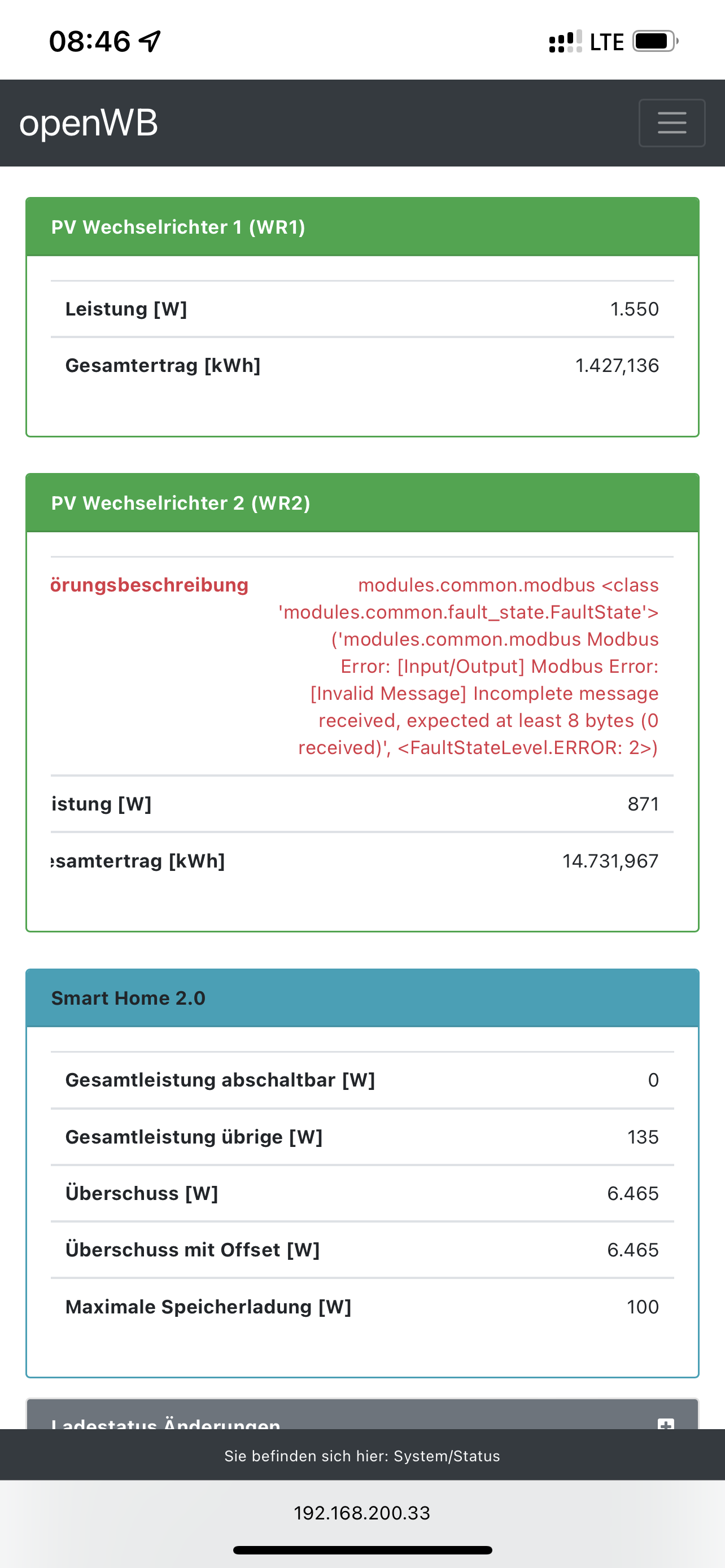

habe gestern ein Update von der letzten stable auf dieses hier durchgeführt und soweit hat auch alles gut geklappt (beide Boxen wurden geupdated) nur leider läuft das PV Kit aus dem Shop nicht mehr. Er zeigt folgendem Fehler unter Status an:
modules.common.fault_state.FaultState: ("modules.common.modbus <class 'modules.common.fault_state.FaultState'> ('modules.common.modbus Modbus Error: [Input/Output] Modbus Error: [Invalid Message] Incomplete message received, expected at least 8 bytes (0 received)', <FaultStateLevel.ERROR: 2>)", <FaultStateLevel.ERROR: 2>)
str(e)) from e
File "/var/www/html/openWB/packages/modules/common/modbus.py", line 105, in __read_registers
return self.__read_registers(self.delegate.read_input_registers, address, types, byteorder, wordorder, **kwargs)
File "/var/www/html/openWB/packages/modules/common/modbus.py", line 142, in read_input_registers
powers = self.client.read_input_registers(0x0C, [ModbusDataType.FLOAT_32]*3, unit=self.id)
File "/var/www/html/openWB/packages/modules/common/sdm.py", line 60, in get_power
self.process_error(e)
File "/var/www/html/openWB/packages/modules/common/sdm.py", line 64, in get_power
powers, power = self.__client.get_power()
File "/var/www/html/openWB/packages/modules/openwb_flex/inverter.py", line 41, in update
self.components[component].update()
File "/var/www/html/openWB/packages/modules/openwb_flex/device.py", line 60, in update
modules.common.fault_state.FaultState: ('modules.common.modbus Modbus Error: [Input/Output] Modbus Error: [Invalid Message] Incomplete message received, expected at least 8 bytes (0 received)', <FaultStateLevel.ERROR: 2>)
File "/var/www/html/openWB/packages/modules/common/modbus.py", line 89, in __read_registers
2022-06-15 08:51:15: PID: 10523: soc.modules.common.fault_state: PV-Kit flex: FaultState FaultStateLevel.ERROR, FaultStr modules.common.modbus <class 'modules.common.fault_state.FaultState'> ('modules.common.modbus Modbus Error: [Input/Output] Modbus Error: [Invalid Message] Incomplete message received, expected at least 8 bytes (0 received)', <FaultStateLevel.ERROR: 2>), Traceback:
2022-06-15 08:51:10: PID: 861: **** FATAL ********************************* (LV0)
2022-06-15 08:51:10: PID: 861: **** FATAL Regulation loop needs 10 seconds (LV0)
str(e)) from e

LarsBr87 hat geschrieben: Mi Jun 15, 2022 6:48 am Hallo,
... nur leider läuft das PV Kit aus dem Shop nicht mehr....
Hallo @LarsBr87, bist Du sicher, dass das PV-Kit gar nicht mehr läuft? Oder nur ab zu, eine Zeitlang, nicht? Wir haben hier beschrieben viewtopic.php?t=5454 das gleiche Fehlerbild im Log

Tatsächlich kommt es alle paar Sekunden vor, dass er die Verbindung wieder hat. Scheint der gleiche Fehler zu sein😬
