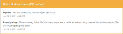

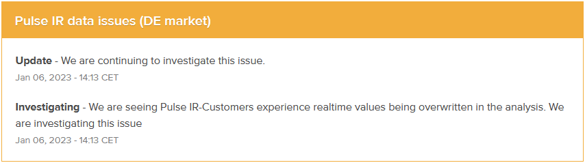

...weil es grad dazu passt:
https://status.tibber.com/
