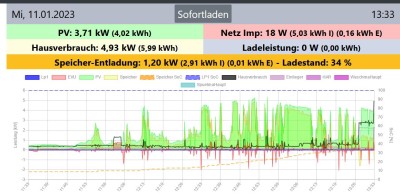

Re: Solaredge Hybrid-System
mit der OWB 2.0 Version 2023-01-10 11:20:30 +0100 [d489ed16] werden die Werte vom EVU und Hausverbrauch nicht richtig angezeigt:
2023-01-11 13:33:40,903 - {root:61} - {INFO:MainThread} - # ***Start***
2023-01-11 13:33:40,929 - {modules.devices.solaredge.device:100} - {DEBUG:device0} - Start device reading {'component0': <modules.devices.solaredge.counter.SolaredgeCounter object at 0xb2682910>, 'component1': <modules.devices.solaredge.inverter.SolaredgeInverter object at 0xb2682928>, 'component2': <modules.devices.solaredge.bat.SolaredgeBat object at 0xb2682328>}
2023-01-11 13:33:40,930 - {soc.modules.common.component_context:24} - {DEBUG:cp3} - Update Komponente ['Ladepunkt']
2023-01-11 13:33:40,936 - {soc.modules.common.component_context:24} - {DEBUG:device0} - Update Komponente ['SolarEdge Zähler']
2023-01-11 13:33:40,987 - {modules.devices.solaredge.scale:16} - {DEBUG:device0} - Registers [60, -869, 1573, -643], Scale 0
2023-01-11 13:33:41,015 - {modules.devices.solaredge.scale:16} - {DEBUG:device0} - Registers [39, 65, 27], Scale -1
2023-01-11 13:33:41,037 - {modules.devices.solaredge.scale:16} - {DEBUG:device0} - Registers [23637, 23773, 23659, 0, 0, 0, 0], Scale -2
2023-01-11 13:33:41,058 - {modules.devices.solaredge.scale:16} - {DEBUG:device0} - Registers [5000], Scale -2
2023-01-11 13:33:41,097 - {modules.devices.solaredge.scale:16} - {DEBUG:device0} - Registers [9679, -9959, 9819], Scale -2
2023-01-11 13:33:41,116 - {modules.devices.solaredge.scale:16} - {DEBUG:device0} - Registers [6606689, 2079756, 3991674, 4030776, 3820542, 5281536, 1334974, 699548], Scale 0
2023-01-11 13:33:41,117 - {soc.modules.common.store._api:26} - {DEBUG:device0} - Raw data CounterState(voltages=[236.37, 237.73000000000002, 236.59], powers=[869.0, -1573.0, 643.0], currents=[3.9000000000000004, -6.5, 2.7], power_factors=[0.9679000000000001, -0.9959, 0.9819], imported=3820542.0, exported=6606689.0, power=-60.0, frequency=50.0)
2023-01-11 13:33:41,121 - {soc.modules.common.component_context:24} - {DEBUG:device0} - Update Komponente ['SolarEdge Wechselrichter']
2023-01-11 13:33:41,147 - {modules.devices.solaredge.scale:16} - {DEBUG:device0} - Registers [4921], Scale 0
2023-01-11 13:33:41,266 - {modules.devices.solaredge.scale:16} - {DEBUG:device0} - Registers [15434343], Scale 0
2023-01-11 13:33:41,298 - {modules.devices.solaredge.scale:16} - {DEBUG:device0} - Registers [691, 692, 691], Scale -2
2023-01-11 13:33:41,317 - {modules.devices.solaredge.scale:16} - {DEBUG:device0} - Registers [4995], Scale 0
2023-01-11 13:33:41,317 - {soc.modules.common.store._api:26} - {DEBUG:device0} - Raw data InverterState(currents=[-6.91, -6.92, -6.91], power=-4921.0, exported=15434343.0, dc_power=-4995.0)
2023-01-11 13:33:41,321 - {soc.modules.common.component_context:24} - {DEBUG:device0} - Update Komponente ['SolarEdge Speicher']
2023-01-11 13:33:41,368 - {modules.common.simcount._simcount:38} - {DEBUG:device0} - Previous state: SimCounterState(timestamp=1673440410.8270175, power=-1187.0, imported=21175.61393368727, exported=15748.617039083172)
2023-01-11 13:33:41,368 - {modules.common.simcount._calculate:13} - {DEBUG:device0} - time passed: 0.00292803, power1: -1187, power2: -1254
2023-01-11 13:33:41,368 - {modules.common.simcount._calculate:29} - {DEBUG:device0} - power did not change sign. Total energy: -3.57367
2023-01-11 13:33:41,369 - {modules.common.simcount._simcount:47} - {DEBUG:device0} - imported: 0 Wh, exported: 3.57367 Wh, new state: SimCounterState(timestamp=1673440421.3679404, power=-1254.0, imported=21175.61393368727, exported=15752.190704742963)
2023-01-11 13:33:41,370 - {soc.modules.common.store._api:26} - {DEBUG:device0} - Raw data BatState(imported=21175.61393368727, exported=15752.190704742963, power=-1254.0, soc=34.0)
2023-01-11 13:33:44,053 - {soc.modules.common.fault_state:40} - {ERROR:cp3} - Ladepunkt: FaultState FaultStateLevel.ERROR, FaultStr Die Verbindung zum Host ist fehlgeschlagen. Überprüfe Adresse und Netzwerk., Traceback:
File "/var/www/html/openWB/packages/modules/chargepoints/external_openwb/chargepoint_module.py", line 60, in get_values
self.__client_error_context.reset_error_counter()
File "/var/www/html/openWB/packages/modules/common/component_context.py", line 99, in __exit__
raise exception
File "/var/www/html/openWB/packages/modules/chargepoints/external_openwb/chargepoint_module.py", line 53, in get_values
pub.pub_single("openWB/set/isss/heartbeat", 0, hostname=ip_address)
File "/var/www/html/openWB/packages/helpermodules/pub.py", line 51, in pub_single
publish.single(topic, json.dumps(payload), hostname=hostname, retain=True)
File "/home/openwb/.local/lib/python3.9/site-packages/paho/mqtt/publish.py", line 240, in single
multiple([msg], hostname, port, client_id, keepalive, will, auth, tls,
File "/home/openwb/.local/lib/python3.9/site-packages/paho/mqtt/publish.py", line 176, in multiple
client.connect(hostname, port, keepalive)
File "/home/openwb/.local/lib/python3.9/site-packages/paho/mqtt/client.py", line 914, in connect
return self.reconnect()
File "/home/openwb/.local/lib/python3.9/site-packages/paho/mqtt/client.py", line 1044, in reconnect
sock = self._create_socket_connection()
File "/home/openwb/.local/lib/python3.9/site-packages/paho/mqtt/client.py", line 3685, in _create_socket_connection
return socket.create_connection(addr, timeout=self._connect_timeout, source_address=source)
File "/usr/lib/python3.9/socket.py", line 843, in create_connection
raise err
File "/usr/lib/python3.9/socket.py", line 831, in create_connection
sock.connect(sa)
OSError: [Errno 113] No route to host
2023-01-11 13:33:44,056 - {soc.modules.common.component_context:24} - {DEBUG:component2} - Update Komponente ['SolarEdge Speicher']
2023-01-11 13:33:44,056 - {soc.modules.common.store._api:30} - {DEBUG:component2} - Saving BatState(imported=21175.61393368727, exported=15752.190704742963, power=-1254.0, soc=34.0)
2023-01-11 13:33:44,091 - {soc.modules.common.component_context:24} - {DEBUG:component1} - Update Komponente ['SolarEdge Wechselrichter']
2023-01-11 13:33:44,091 - {soc.modules.common.store._api:26} - {DEBUG:component1} - Raw data InverterState(currents=[0.0, 0.0, 0.0], power=-3667.0, exported=15439766.42, dc_power=-4995.0)
2023-01-11 13:33:44,092 - {soc.modules.common.store._api:30} - {DEBUG:component1} - Saving InverterState(currents=[0.0, 0.0, 0.0], power=-3667.0, exported=15439766.42, dc_power=-4995.0)
2023-01-11 13:33:44,093 - {soc.modules.common.component_context:24} - {DEBUG:cp3} - Update Komponente ['Ladepunkt']
2023-01-11 13:33:44,113 - {soc.modules.common.component_context:24} - {DEBUG:component0} - Update Komponente ['SolarEdge Zähler']
2023-01-11 13:33:44,148 - {control.counter:87} - {DEBUG:MainThread} - Verbleibende Ströme an Zähler 0: [39.7, 40.9, 55.4]
2023-01-11 13:33:44,149 - {control.counter:116} - {DEBUG:MainThread} - Verbleibende Leistung an Zähler 0: 37573.0
2023-01-11 13:33:44,151 - {control.chargepoint:349} - {INFO:MainThread} - LP 3: Keine Ladung, da kein Auto angesteckt ist.
2023-01-11 13:33:44,153 - {control.bat:118} - {INFO:MainThread} - -1187.0W verbliebende Speicher-Leistung
2023-01-11 13:33:44,155 - {control.data:297} - {DEBUG:MainThread} - all
{'get': {'power': -1187.0, 'imported': 21175.61, 'exported': 15748.62, 'daily_exported': 23.57, 'daily_imported': 2922.51, 'soc': 34}, 'config': {'configured': True}, 'set': {'charging_power_left': -1187.0, 'switch_on_soc_reached': False}}
2023-01-11 13:33:44,155 - {control.data:297} - {DEBUG:MainThread} - bat2
{'get': {'daily_imported': 2922.51, 'daily_exported': 23.57, 'fault_str': 'Kein Fehler.', 'fault_state': 0, 'power': -1254.0, 'soc': 34, 'imported': 21175.61, 'exported': 15752.19}}
2023-01-11 13:33:44,156 - {control.data:270} - {DEBUG:MainThread} - cp_all_data
AllChargepointData(get=AllGet(daily_imported=0, daily_exported=0, power=0, imported=0, exported=0))
2023-01-11 13:33:44,156 - {control.data:297} - {DEBUG:MainThread} - cp3
ChargepointData(get=Get(charge_state=False, connected_vehicle=ConnectedVehicle(config=ConnectedConfig(average_consumption=17, charge_template=0, chargemode='stop', current_plan=0, ev_template=0, priority=False), info=ConnectedInfo(id=0, name='Ladepunkt'), soc=ConnectedSoc(fault_str='Kein Fehler.', fault_state=0, range_charged=0, range_unit='km', range=0, soc=0, timestamp=None)), currents=[0.0, 0.0, 0.0], daily_imported=0, daily_exported=0, exported=0, fault_str='Die Verbindung zum Host ist fehlgeschlagen. Überprüfe Adresse und Netzwerk.', fault_state=2, imported=0, phases_in_use=0, plug_state=False, power=0, rfid_timestamp=None, rfid=None, state_str='Keine Ladung, da kein Auto angesteckt ist.', voltages=[230.0, 230.0, 230.0]), set=Set(change_ev_permitted=False, charging_ev=-1, charging_ev_prev=-1, current=0, energy_to_charge=0, loadmanagement_available=True, log=Log(chargemode_log_entry='_', imported_at_mode_switch=0, imported_at_plugtime=0, imported_since_mode_switch=0, imported_since_plugged=0, range_charged=0, time_charged='00:00', timestamp_start_charging=None), manual_lock=False, phases_to_use=0, plug_state_prev=False, plug_time=None, required_power=0, rfid=None, target_current=0, charging_ev_data=<control.ev.Ev object at 0xb0a9da48>), config=Config(connection_module={'type': 'external_openwb', 'name': 'Externe openWB', 'configuration': {'ip_address': '192.168.2.199', 'duo_num': 1}}, power_module={}, ev=0, name='Standard-Ladepunkt', type='external_openwb', template=0, connected_phases=3, phase_1=1, auto_phase_switch_hw=True, control_pilot_interruption_hw=True, id=3))
2023-01-11 13:33:44,156 - {control.data:297} - {DEBUG:MainThread} - cpt0
2023-01-11 13:33:44,157 - {control.data:297} - {DEBUG:MainThread} - counter0
{'set': {'reserved_surplus': 0, 'released_surplus': 0, 'raw_power_left': 37573.0, 'surplus_power_left': 0, 'consumption_left': 39500.0, 'raw_currents_left': [39.7, 40.9, 55.4]}, 'get': {'daily_exported': 0.0, 'daily_imported': 0.0, 'fault_str': 'Kein Fehler.', 'fault_state': 0, 'voltages': [234.0, 235.5, 237.73], 'currents': [9.3, 8.1, -6.4], 'powers': [2143.0, 1915.0, -1631.0], 'power_factors': [0.98, 1.0, -0.96], 'imported': 3802019.0, 'exported': 6606524.0, 'power': 2427.0, 'frequency': 49.99}, 'config': {'max_currents': [50, 50, 50], 'max_total_power': 40000}}
2023-01-11 13:33:44,157 - {control.data:274} - {DEBUG:MainThread} - counter_all_data
CounterAllData(get=Get(hierarchy=[{'id': 0, 'type': 'counter', 'children': [{'id': 1, 'type': 'inverter', 'children': [{'id': 2, 'type': 'bat', 'children': []}]}, {'id': 3, 'type': 'cp', 'children': []}, {'id': 2, 'type': 'bat', 'children': []}]}]), set=Set(loadmanagement_active=False, home_consumption=7348.0, invalid_home_consumption=0, daily_yield_home_consumption=1127.0000000000005))
2023-01-11 13:33:44,158 - {control.data:297} - {DEBUG:MainThread} - ct0
ChargeTemplateData(name='Standard-Ladeprofil-Vorlage', disable_after_unplug=False, prio=False, load_default=False, time_charging=TimeCharging(active=False, plans={}), chargemode=Chargemode(selected='pv_charging', pv_charging=PvCharging(min_soc_current=6, min_current=0, feed_in_limit=False, min_soc=0, max_soc=100), scheduled_charging=ScheduledCharging(plans={}), instant_charging=InstantCharging(current=17, limit=Limit(selected='none', amount=8000, soc=50))))
2023-01-11 13:33:44,158 - {control.data:297} - {DEBUG:MainThread} - ev0
EvData(set=Set(ev_template=EvTemplate(data=EvTemplateData(name='Standard-Fahrzeug-Vorlage', max_current_multi_phases=16, max_phases=3, phase_switch_pause=2, prevent_phase_switch=False, prevent_charge_stop=False, control_pilot_interruption=False, control_pilot_interruption_duration=4, average_consump=17, min_current=6, max_current_single_phase=32, battery_capacity=82, nominal_difference=2), et_num=0)), control_parameter=ControlParameter(required_current=0, required_currents=[0.0, 0.0, 0.0], phases=0, prio=False, timestamp_switch_on_off=None, timestamp_auto_phase_switch=None, timestamp_perform_phase_switch=None, submode=<Chargemode.STOP: 'stop'>, chargemode=<Chargemode.STOP: 'stop'>, used_amount_instant_charging=0, imported_at_plan_start=0, current_plan=None), charge_template=0, ev_template=0, name='Standard-Fahrzeug', tag_id=[], get=Get(soc=0, soc_timestamp='', force_soc_update=False, range=0, fault_state=0, fault_str=''))
2023-01-11 13:33:44,160 - {control.data:297} - {DEBUG:MainThread} - et0
EvTemplateData(name='Standard-Fahrzeug-Vorlage', max_current_multi_phases=17, max_phases=2, phase_switch_pause=2, prevent_phase_switch=False, prevent_charge_stop=False, control_pilot_interruption=False, control_pilot_interruption_duration=4, average_consump=22, min_current=6, max_current_single_phase=32, battery_capacity=13, nominal_difference=1)
2023-01-11 13:33:44,162 - {control.data:278} - {DEBUG:MainThread} - general_data
GeneralData(chargemode_config=ChargemodeConfig(instant_charging=InstantCharging(phases_to_use=1), pv_charging=PvCharging(bat_prio=True, charging_power_reserve=200, control_range=[0, 230], feed_in_yield=15000, phase_switch_delay=7, phases_to_use=1, rundown_power=1000, rundown_soc=95, switch_off_delay=60, switch_off_soc=95, switch_off_threshold=50, switch_on_delay=30, switch_on_soc=95, switch_on_threshold=1500), scheduled_charging=ScheduledCharging(phases_to_use=0), standby=Standby(phases_to_use=3), stop=Stop(phases_to_use=1), time_charging=TimeCharging(phases_to_use=1), unbalanced_load_limit=18, unbalanced_load=False), control_interval=10, extern_display_mode='local', extern=False, external_buttons_hw=False, grid_protection_active=False, grid_protection_configured=True, grid_protection_random_stop=0, grid_protection_timestamp='', mqtt_bridge=False, price_kwh=0.3, range_unit='km', ripple_control_receiver=RippleControlReceiver(configured=False, r1_active=False, r2_active=False))
2023-01-11 13:33:44,162 - {control.data:297} - {DEBUG:MainThread} - graph
{'config': {'duration': 120}}
2023-01-11 13:33:44,162 - {control.data:280} - {DEBUG:MainThread} - optional_data
2023-01-11 13:33:44,163 - {control.data:297} - {DEBUG:MainThread} - all
{'get': {'power': -3679.0, 'exported': 15439753.99, 'daily_exported': 4034.94, 'monthly_exported': 0, 'yearly_exported': 0}, 'config': {'configured': True}}
2023-01-11 13:33:44,163 - {control.data:297} - {DEBUG:MainThread} - pv1
{'get': {'daily_exported': 4034.94, 'monthly_exported': 0, 'yearly_exported': 0, 'fault_str': 'Kein Fehler.', 'fault_state': 0, 'power': -3667.0, 'exported': 15439766.42, 'currents': [0.0, 0.0, 0.0]}, 'config': {'max_ac_out': 7200}}
2023-01-11 13:33:44,163 - {control.data:297} - {DEBUG:MainThread} - system
{'update_in_progress': False, 'perform_update': False, 'ip_address': '192.168.2.129', 'current_commit': '2023-01-10 11:20:30 +0100 [d489ed16]', 'current_branch': 'master', 'current_branch_commit': '2023-01-10 11:20:30 +0100 [d489ed16]', 'current_missing_commits': [], 'boot_done': True, 'dataprotection_acknowledged': False, 'debug_level': 10, 'release_train': 'master', 'version': '1.99.101.1', 'datastore_version': 6, 'lastlivevaluesJson': {'timestamp': 1673440416, 'time': '13:33:36', 'grid': 2.427, 'house-power': 7.293, 'charging-all': 0.0, 'pv-all': 3.676, 'bat-all-power': -1.179, 'bat-all-soc': 34}, 'module_update_completed': True}
2023-01-11 13:33:44,164 - {control.data:310} - {DEBUG:MainThread} - device0
{'name': 'SolarEdge', 'type': 'solaredge', 'id': 0, 'configuration': {'port': 502, 'ip_address': '192.168.2.134'}}
2023-01-11 13:33:44,165 - {control.data:312} - {DEBUG:MainThread} - component0
2023-01-11 13:33:44,165 - {control.data:312} - {DEBUG:MainThread} - component1
2023-01-11 13:33:44,165 - {control.data:312} - {DEBUG:MainThread} - component2
{'name': 'SolarEdge Speicher', 'type': 'bat', 'id': 2, 'configuration': {'modbus_id': 1}}
2023-01-11 13:33:44,165 - {control.data:284} - {DEBUG:MainThread} -
2023-01-11 13:33:44,166 - {control.algorithm.algorithm:26} - {DEBUG:MainThread} - # Algorithmus-Start
2023-01-11 13:33:44,166 - {control.algorithm.algorithm:32} - {DEBUG:MainThread} - **Mindestrom setzen**
2023-01-11 13:33:44,170 - {control.algorithm.algorithm:34} - {DEBUG:MainThread} - **Sollstrom setzen**
2023-01-11 13:33:44,174 - {control.counter:159} - {DEBUG:MainThread} - Überschuss zur PV-geführten Ladung: 0W
2023-01-11 13:33:44,175 - {control.counter:407} - {DEBUG:MainThread} - Zähler 0: Begrenzung der verbleibenden Leistung auf 0W
2023-01-11 13:33:44,176 - {control.algorithm.algorithm:45} - {DEBUG:MainThread} - **Keine Leistung für PV-geführtes Laden übrig.**
2023-01-11 13:33:44,176 - {control.process:22} - {DEBUG:MainThread} - # Ladung starten.
2023-01-11 13:33:44,188 - {soc.modules.common.component_context:24} - {DEBUG:cp3} - Update Komponente ['Ladepunkt']
2023-01-11 13:33:47,172 - {soc.modules.common.fault_state:40} - {ERROR:cp3} - Ladepunkt: FaultState FaultStateLevel.ERROR, FaultStr Die Verbindung zum Host ist fehlgeschlagen. Überprüfe Adresse und Netzwerk., Traceback:

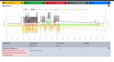

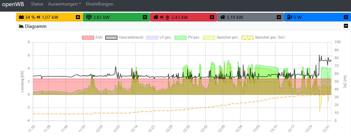

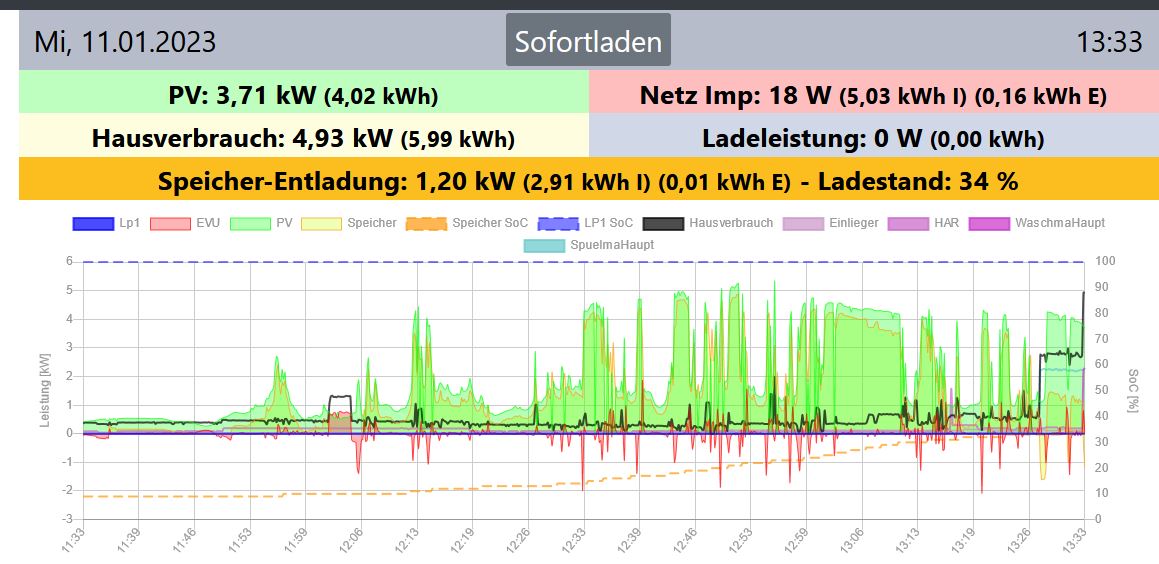

Wurde bereits behoben.Ihaglc hat geschrieben: Mi Jan 11, 2023 12:42 pm mit der OWB 2.0 Version 2023-01-10 11:20:30 +0100 [d489ed16] werden die Werte vom EVU und Hausverbrauch nicht richtig angezeigt:
- Beiträge: 584
- Has thanked: 26 times
- Been thanked: 14 times
Ja danke, Lutz.

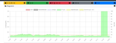

Mit der neuen Version OWB 2.0 2023-01-11 13:44:22 +0100 [330b9b1f] hat sich ein neuer Fehler eingeschlichen:
Während der Dunkelheit wird PV plötzlich angezeigt und der Wert zu dem Hausverbrauch hinzugefügt. Ab ca 18:49 werden genauso plötzlich die richtigen Werte angezeigt....

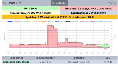

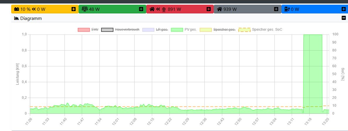

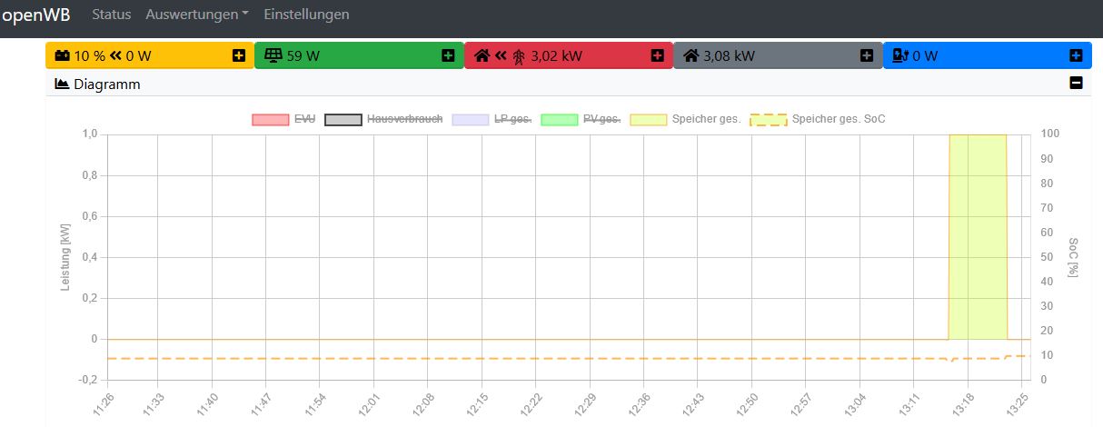

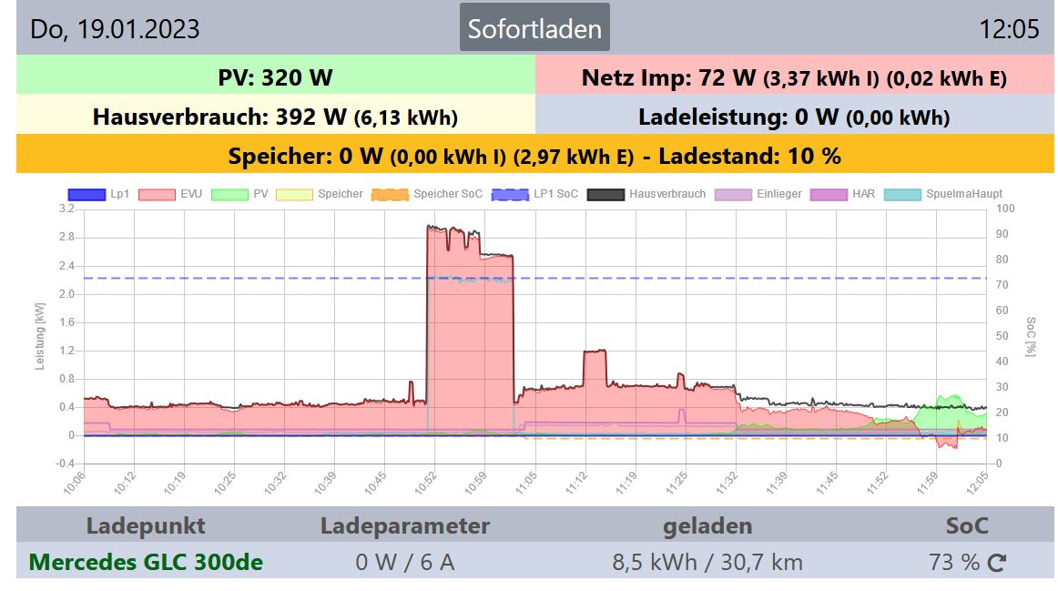

Leider stimmen mit der Version 2023-01-19 07:48:19 +0100 [bdff6e82] jetzt wieder nicht die Werte vom Hausverbrauch und der PV
2023-01-19 12:01:30,294 - {root:61} - {INFO:MainThread} - # ***Start***

2023-01-19 12:01:30,674 - {modules.devices.solaredge.scale:16} - {DEBUG:device0} - Registers [5730], Scale -1
2023-01-19 12:01:30,693 - {modules.devices.solaredge.scale:16} - {DEBUG:device0} - Registers [15479345], Scale 0
2023-01-19 12:01:30,713 - {modules.devices.solaredge.scale:16} - {DEBUG:device0} - Registers [96, 100, 96], Scale -2
2023-01-19 12:01:30,732 - {modules.devices.solaredge.scale:16} - {DEBUG:device0} - Registers [5817], Scale -1
2023-01-19 12:01:30,733 - {soc.modules.common.store._api:26} - {DEBUG:device0} - Raw data InverterState(currents=[-0.96, -1.0, -0.96], power=-573.0, exported=15479345.0, dc_power=-581.7)
2023-01-19 12:01:30,734 - {soc.modules.common.component_context:24} - {DEBUG:device0} - Update Komponente ['SolarEdge Speicher']
2023-01-19 12:01:30,782 - {modules.common.simcount._simcount:38} - {DEBUG:device0} - Previous state: SimCounterState(timestamp=1674126081.112339, power=0.0, imported=24500.715827321652, exported=24378.198947367135)
2023-01-19 12:01:30,783 - {modules.common.simcount._calculate:13} - {DEBUG:device0} - time passed: 0.00268614, power1: 0, power2: 0
2023-01-19 12:01:30,783 - {modules.common.simcount._calculate:29} - {DEBUG:device0} - power did not change sign. Total energy: 0
2023-01-19 12:01:30,783 - {modules.common.simcount._simcount:47} - {DEBUG:device0} - imported: 0 Wh, exported: 0 Wh, new state: SimCounterState(timestamp=1674126090.7824259, power=0.0, imported=24500.715827321652, exported=24378.198947367135)
2023-01-19 12:01:30,784 - {soc.modules.common.store._api:26} - {DEBUG:device0} - Raw data BatState(imported=24500.715827321652, exported=24378.198947367135, power=0.0, soc=10.0)
2023-01-19 12:01:33,415 - {soc.modules.common.fault_state:40} - {ERROR:cp3} - Ladepunkt: FaultState FaultStateLevel.ERROR, FaultStr Die Verbindung zum Host ist fehlgeschlagen. Überprüfe Adresse und Netzwerk., Traceback:
raise exception
raise err
sock.connect(sa)
2023-01-19 12:01:33,417 - {soc.modules.common.component_context:24} - {DEBUG:component2} - Update Komponente ['SolarEdge Speicher']
2023-01-19 12:01:33,418 - {soc.modules.common.store._api:30} - {DEBUG:component2} - Saving BatState(imported=24500.715827321652, exported=24378.198947367135, power=0.0, soc=10.0)
2023-01-19 12:01:33,456 - {soc.modules.common.component_context:24} - {DEBUG:component1} - Update Komponente ['SolarEdge Wechselrichter']
2023-01-19 12:01:33,458 - {soc.modules.common.component_context:24} - {DEBUG:cp3} - Update Komponente ['Ladepunkt']
2023-01-19 12:01:33,469 - {soc.modules.common.component_context:24} - {DEBUG:component0} - Update Komponente ['SolarEdge Zähler']
2023-01-19 12:01:33,469 - {soc.modules.common.store._api:30} - {DEBUG:component0} - Saving CounterState(voltages=[234.9, 235.75, 235.54], powers=[161.0, -184.0, -144.0], currents=[1.6, -1.0, -0.8], power_factors=[0.4189, -0.772, -0.68], imported=3927311.0, exported=6610108.0, power=-168.0, frequency=49.97)
2023-01-19 12:01:33,530 - {control.counter:137} - {DEBUG:MainThread} - Verbleibende Ströme an Zähler 0: [47.4, 50.0, 49.8]
2023-01-19 12:01:33,530 - {control.counter:166} - {DEBUG:MainThread} - Verbleibende Leistung an Zähler 0: 40168.0
2023-01-19 12:01:33,532 - {control.chargepoint:349} - {INFO:MainThread} - LP 3: Keine Ladung, da kein Auto angesteckt ist.
2023-01-19 12:01:33,535 - {control.bat_all:145} - {INFO:MainThread} - 0.0W verbliebende Speicher-Leistung
2023-01-19 12:01:33,536 - {control.counter_all:83} - {ERROR:MainThread} - Ungültiger Hausverbrauch: -156.0W, Berücksichtigte Komponenten neben EVU [{'id': 1, 'type': 'inverter', 'children': [{'id': 2, 'type': 'bat', 'children': []}]}, {'id': 3, 'type': 'cp', 'children': []}, {'id': 2, 'type': 'bat', 'children': []}]
2023-01-19 12:01:33,537 - {control.data:334} - {DEBUG:MainThread} - bat2
BatData(get=Get(soc=10, daily_exported=2957.44, daily_imported=0.0, imported=24500.72, exported=24378.2, fault_state=0, fault_str='Kein Fehler.', power=0.0))
2023-01-19 12:01:33,537 - {control.data:305} - {DEBUG:MainThread} - bat_all_data
BatAllData(config=Config(configured=True), get=Get(soc=10, daily_exported=2957.44, daily_imported=0.0, imported=24500.72, exported=24378.2, power=0.0), set=Set(charging_power_left=0.0, switch_on_soc_reached=False))
2023-01-19 12:01:33,537 - {control.data:306} - {DEBUG:MainThread} - cp_all_data
2023-01-19 12:01:33,537 - {control.data:334} - {DEBUG:MainThread} - cp3
ChargepointData(get=Get(charge_state=False, connected_vehicle=ConnectedVehicle(config=ConnectedConfig(average_consumption=17, charge_template=0, chargemode='stop', current_plan=0, ev_template=0, priority=False), info=ConnectedInfo(id=0, name='Ladepunkt'), soc=ConnectedSoc(fault_str='Kein Fehler.', fault_state=0, range_charged=0, range_unit='km', range=0, soc=0, timestamp=None)), currents=[0.0, 0.0, 0.0], daily_imported=0, daily_exported=0, exported=0, fault_str='Die Verbindung zum Host ist fehlgeschlagen. Überprüfe Adresse und Netzwerk.', fault_state=2, imported=0, phases_in_use=0, plug_state=False, power=0, rfid_timestamp=None, rfid=None, state_str='Keine Ladung, da kein Auto angesteckt ist.', voltages=[230.0, 230.0, 230.0]), set=Set(change_ev_permitted=False, charging_ev=-1, charging_ev_prev=-1, current=0, energy_to_charge=0, loadmanagement_available=True, log=Log(chargemode_log_entry='_', imported_at_mode_switch=0, imported_at_plugtime=0, imported_since_mode_switch=0, imported_since_plugged=0, range_charged=0, time_charged='00:00', timestamp_start_charging=None), manual_lock=False, phases_to_use=0, plug_state_prev=False, plug_time=None, required_power=0, rfid=None, target_current=0, charging_ev_data=<control.ev.Ev object at 0xb0acdb80>), config=Config(connection_module={'type': 'external_openwb', 'name': 'Externe openWB', 'configuration': {'ip_address': '192.168.2.199', 'duo_num': 1}}, power_module={}, ev=0, name='Standard-Ladepunkt', type='external_openwb', template=0, connected_phases=3, phase_1=1, auto_phase_switch_hw=True, control_pilot_interruption_hw=True, id=3))
2023-01-19 12:01:33,538 - {control.data:334} - {DEBUG:MainThread} - cpt0
2023-01-19 12:01:33,538 - {control.data:334} - {DEBUG:MainThread} - counter0
CounterData(config=Config(max_currents=[50, 50, 50], max_total_power=40000), get=Get(powers=[161.0, -184.0, -144.0], currents=[1.6, -1.0, -0.8], voltages=[234.9, 235.75, 235.54], power_factors=[0.42, -0.77, -0.68], unbalanced_load=0, frequency=49.97, daily_exported=23.0, daily_imported=3370.0, imported=3927311.0, exported=6610108.0, fault_state=1, fault_str='Der Wert für den Hausverbrauch ist nicht plausibel (negativ). Bitte die Leistungen der Komponenten und die Anordnung in der Hierarchie prüfen.', power=-168.0), set=Set(reserved_surplus=0, released_surplus=0, raw_power_left=40168.0, raw_currents_left=[47.4, 50.0, 49.8], surplus_power_left=0, state_str=''))
2023-01-19 12:01:33,542 - {control.data:310} - {DEBUG:MainThread} - counter_all_data
CounterAllData(get=Get(hierarchy=[{'id': 0, 'type': 'counter', 'children': [{'id': 1, 'type': 'inverter', 'children': [{'id': 2, 'type': 'bat', 'children': []}]}, {'id': 3, 'type': 'cp', 'children': []}, {'id': 2, 'type': 'bat', 'children': []}]}]), set=Set(loadmanagement_active=False, home_consumption=0, invalid_home_consumption=3, daily_yield_home_consumption=3347.0))
2023-01-19 12:01:33,542 - {control.data:334} - {DEBUG:MainThread} - ct0
2023-01-19 12:01:33,543 - {control.data:334} - {DEBUG:MainThread} - ev0
2023-01-19 12:01:33,543 - {control.data:334} - {DEBUG:MainThread} - et0
2023-01-19 12:01:33,543 - {control.data:314} - {DEBUG:MainThread} - general_data
2023-01-19 12:01:33,543 - {control.data:315} - {DEBUG:MainThread} - graph_data
2023-01-19 12:01:33,544 - {control.data:316} - {DEBUG:MainThread} - optional_data
2023-01-19 12:01:33,545 - {control.data:334} - {DEBUG:MainThread} - pv1
PvData(config=Config(max_ac_out=7200), get=Get(currents=[0.0, 0.0, 0.0], daily_exported=1716.96, monthly_exported=0, yearly_exported=0, imported=0, exported=15479368.52, fault_state=0, fault_str='Kein Fehler.', power=-12.0))
2023-01-19 12:01:33,546 - {control.data:318} - {DEBUG:MainThread} - pv_all_data
PvAllData(config=Config(configured=True), get=Get(daily_exported=1716.96, monthly_exported=0, yearly_exported=0, exported=15479368.52, power=-12.0))
2023-01-19 12:01:33,546 - {control.data:334} - {DEBUG:MainThread} - system
{'update_in_progress': False, 'perform_update': False, 'ip_address': '192.168.2.129', 'current_commit': '2023-01-19 07:48:19 +0100 [bdff6e82]', 'current_branch': 'master', 'current_branch_commit': '2023-01-19 07:48:19 +0100 [bdff6e82]', 'current_missing_commits': [], 'boot_done': True, 'dataprotection_acknowledged': False, 'debug_level': 10, 'release_train': 'master', 'version': '1.99.101.1', 'datastore_version': 6, 'lastlivevaluesJson': {'timestamp': 1674126087, 'time': '12:01:27', 'grid': -0.162, 'house-power': 0.0, 'charging-all': 0.0, 'pv-all': 0.012, 'bat-all-power': 0.0, 'bat-all-soc': 10}, 'module_update_completed': True}
2023-01-19 12:01:33,546 - {control.data:347} - {DEBUG:MainThread} - device0
2023-01-19 12:01:33,547 - {control.data:349} - {DEBUG:MainThread} - component0
2023-01-19 12:01:33,547 - {control.data:349} - {DEBUG:MainThread} - component1
2023-01-19 12:01:33,547 - {control.data:349} - {DEBUG:MainThread} - component2
2023-01-19 12:01:33,547 - {control.data:321} - {DEBUG:MainThread} -
2023-01-19 12:01:33,547 - {control.algorithm.algorithm:26} - {DEBUG:MainThread} - # Algorithmus
2023-01-19 12:01:33,548 - {control.algorithm.algorithm:32} - {DEBUG:MainThread} - **Mindestrom setzen**
2023-01-19 12:01:33,550 - {control.algorithm.algorithm:34} - {DEBUG:MainThread} - **Sollstrom setzen**
2023-01-19 12:01:33,552 - {control.counter:203} - {DEBUG:MainThread} - Überschuss zur PV-geführten Ladung: 0W
2023-01-19 12:01:33,553 - {control.counter:466} - {DEBUG:MainThread} - Zähler 0: Begrenzung der verbleibenden Leistung auf 0W
2023-01-19 12:01:33,553 - {control.algorithm.algorithm:45} - {DEBUG:MainThread} - **Keine Leistung für PV-geführtes Laden übrig.**
2023-01-19 12:01:33,553 - {control.process:22} - {DEBUG:MainThread} - # Ladung starten.
2023-01-19 12:01:33,554 - {soc.modules.common.component_context:24} - {DEBUG:cp3} - Update Komponente ['Ladepunkt']
2023-01-19 12:01:36,534 - {soc.modules.common.fault_state:40} - {ERROR:cp3} - Ladepunkt: FaultState FaultStateLevel.ERROR, FaultStr Die Verbindung zum Host ist fehlgeschlagen. Überprüfe Adresse und Netzwerk., Traceback:
File "/var/www/html/openWB/packages/modules/chargepoints/external_openwb/chargepoint_module.py", line 44, in set_current
pub.pub_single("openWB/set/isss/Lp2Current", current,
raise exception
File "/var/www/html/openWB/packages/modules/chargepoints/external_openwb/chargepoint_module.py", line 41, in set_current
pub.pub_single("openWB/set/isss/Current", current,
raise err
sock.connect(sa)
2023-01-19 12:01:36,540 - {control.counter:191} - {DEBUG:MainThread} - 0W reservierte EVU-Leistung, 0W freigegebene EVU-Leistung
2023-01-19 12:01:36,768 - {schedule:660} - {DEBUG:MainThread} - Running job Job(interval=1, unit=minutes, do=update, args=(), kwargs={})
2023-01-19 12:01:40,806 - {schedule:660} - {DEBUG:MainThread} - Running job Job(interval=1, unit=minutes, do=handler10Sec, args=(), kwargs={})
2023-01-19 12:01:40,806 - {root:61} - {INFO:MainThread} - # ***Start***

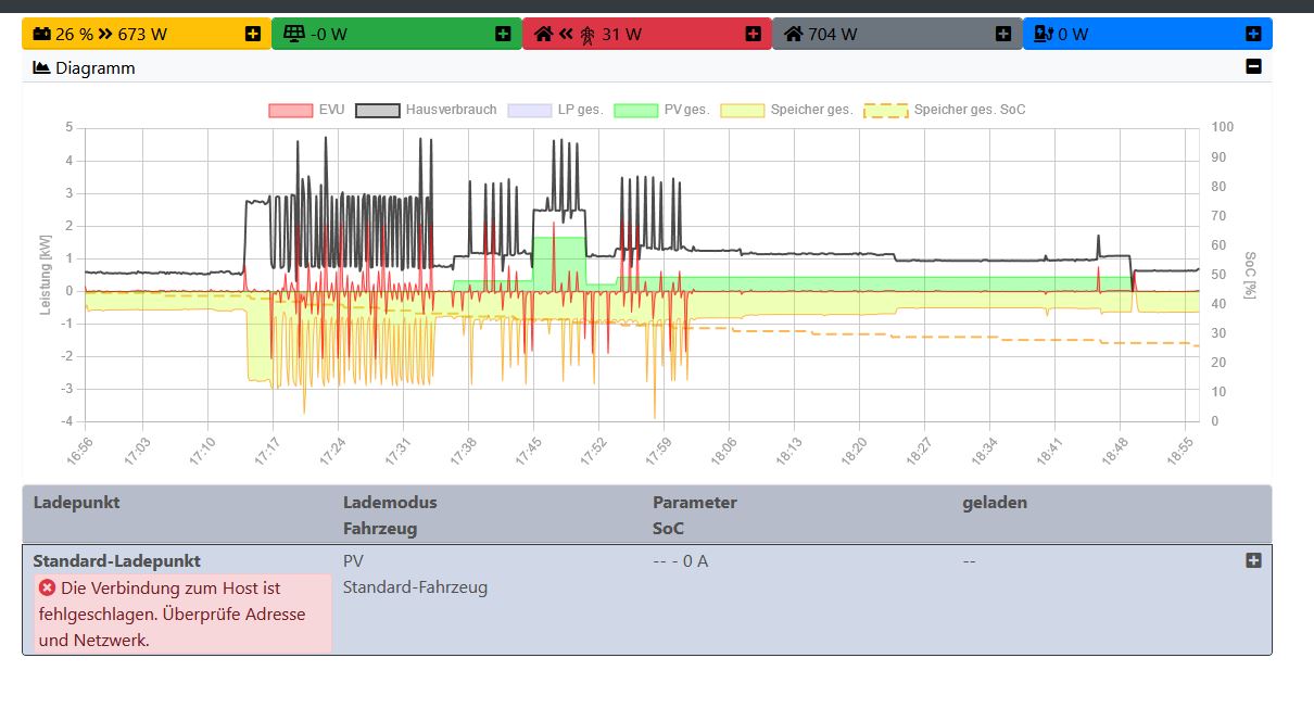

2023-01-28 15:16:33,169 - {soc.modules.common.component_context:24} - {DEBUG:component2} - Update Komponente ['SolarEdge Speicher']
2023-01-28 15:16:33,170 - {soc.modules.common.store._api:30} - {DEBUG:component2} - Saving BatState(imported=1484.2274261289497, exported=98.43074275692284, power=2003.0, soc=21.0)
2023-01-28 15:16:33,204 - {soc.modules.common.component_context:24} - {DEBUG:component1} - Update Komponente ['SolarEdge Wechselrichter']
2023-01-28 15:16:33,205 - {soc.modules.common.component_context:24} - {DEBUG:cp3} - Update Komponente ['Ladepunkt']
2023-01-28 15:16:33,212 - {soc.modules.common.component_context:24} - {DEBUG:component0} - Update Komponente ['SolarEdge Zähler']
2023-01-28 15:16:33,213 - {soc.modules.common.store._api:30} - {DEBUG:component0} - Saving CounterState(voltages=[237.43, 238.15, 238.81], powers=[272.0, -78.0, -165.0], currents=[1.3, -0.6000000000000001, -0.7000000000000001], power_factors=[0.796, -0.48300000000000004, -0.9259000000000001], imported=4091950.0, exported=6610614.0, power=28.0, frequency=49.97)
2023-01-28 15:16:33,248 - {control.bat_all:128} - {WARNING:MainThread} - Bat 2: Die maximale Entladeleistung des Wechselrichters ist erreicht.
2023-01-28 15:16:33,290 - {control.counter:137} - {DEBUG:MainThread} - Verbleibende Ströme an Zähler 0: [47.7, 49.6, 49.7]
2023-01-28 15:16:33,290 - {control.counter:166} - {DEBUG:MainThread} - Verbleibende Leistung an Zähler 0: 39972.0
2023-01-28 15:16:33,293 - {control.chargepoint:354} - {INFO:MainThread} - LP 3: Keine Ladung, da kein Auto angesteckt ist.
2023-01-28 15:16:33,294 - {control.bat_all:145} - {INFO:MainThread} - -50W verbliebende Speicher-Leistung
2023-01-28 15:16:33,295 - {control.counter_all:83} - {ERROR:MainThread} - Ungültiger Hausverbrauch: -1963.0W, Berücksichtigte Komponenten neben EVU [{'id': 1, 'type': 'inverter', 'children': [{'id': 2, 'type': 'bat', 'children': []}]}, {'id': 3, 'type': 'cp', 'children': []}, {'id': 2, 'type': 'bat', 'children': []}]
2023-01-28 15:16:33,296 - {control.data:334} - {DEBUG:MainThread} - bat2
BatData(get=Get(soc=21, daily_exported=97.46, daily_imported=1278.38, imported=1484.23, exported=98.43, fault_state=0, fault_str='Kein Fehler.', power=2003.0))
2023-01-28 15:16:33,296 - {control.data:305} - {DEBUG:MainThread} - bat_all_data
BatAllData(config=Config(configured=True), get=Get(soc=21, daily_exported=97.46, daily_imported=1278.38, imported=1478.9, exported=98.43, power=1999.0), set=Set(charging_power_left=-50, switch_on_soc_reached=False))
2023-01-28 15:16:33,297 - {control.data:306} - {DEBUG:MainThread} - cp_all_data
2023-01-28 15:16:33,297 - {control.data:334} - {DEBUG:MainThread} - cp3
ChargepointData(get=Get(charge_state=False, connected_vehicle=ConnectedVehicle(config=ConnectedConfig(average_consumption=17, charge_template=0, chargemode='stop', current_plan=0, ev_template=0, priority=False, time_charging_in_use=False), info=ConnectedInfo(id=0, name='Ladepunkt'), soc=ConnectedSoc(fault_str='Kein Fehler.', fault_state=0, range_charged=0, range_unit='km', range=0, soc=0, timestamp=None)), currents=[0.0, 0.0, 0.0], daily_imported=0, daily_exported=0, exported=0, fault_str='Die Verbindung zum Host ist fehlgeschlagen. Überprüfe Adresse und Netzwerk.', fault_state=2, imported=0, phases_in_use=0, plug_state=False, power=0, rfid_timestamp=None, rfid=None, state_str='Keine Ladung, da kein Auto angesteckt ist.', voltages=[230.0, 230.0, 230.0]), set=Set(change_ev_permitted=False, charging_ev=-1, charging_ev_prev=-1, current=0, energy_to_charge=0, loadmanagement_available=True, log=Log(chargemode_log_entry='_', imported_at_mode_switch=0, imported_at_plugtime=0, imported_since_mode_switch=0, imported_since_plugged=0, range_charged=0, time_charged='00:00', timestamp_start_charging=None), manual_lock=False, phases_to_use=0, plug_state_prev=False, plug_time=None, required_power=0, rfid=None, target_current=0, charging_ev_data=<control.ev.Ev object at 0xb0ad6e38>), config=Config(connection_module={'type': 'external_openwb', 'name': 'Externe openWB', 'configuration': {'ip_address': '192.168.2.199', 'duo_num': 1}}, power_module={}, ev=0, name='Standard-Ladepunkt', type='external_openwb', template=0, connected_phases=3, phase_1=1, auto_phase_switch_hw=True, control_pilot_interruption_hw=True, id=3))
2023-01-28 15:16:33,297 - {control.data:334} - {DEBUG:MainThread} - cpt0
2023-01-28 15:16:33,299 - {control.data:334} - {DEBUG:MainThread} - counter0
CounterData(config=Config(max_currents=[50, 50, 50], max_total_power=40000), get=Get(powers=[272.0, -78.0, -165.0], currents=[1.3, -0.6, -0.7], voltages=[237.43, 238.15, 238.81], power_factors=[0.8, -0.48, -0.93], unbalanced_load=0, frequency=49.97, daily_exported=222.0, daily_imported=64572.0, imported=4091950.0, exported=6610614.0, fault_state=1, fault_str='Der Wert für den Hausverbrauch ist nicht plausibel (negativ). Bitte die Leistungen der Komponenten und die Anordnung in der Hierarchie prüfen.', power=28.0), set=Set(reserved_surplus=0, released_surplus=0, raw_power_left=39972.0, raw_currents_left=[47.7, 49.6, 49.7], surplus_power_left=0, state_str=''))
2023-01-28 15:16:33,299 - {control.data:310} - {DEBUG:MainThread} - counter_all_data
CounterAllData(get=Get(hierarchy=[{'id': 0, 'type': 'counter', 'children': [{'id': 1, 'type': 'inverter', 'children': [{'id': 2, 'type': 'bat', 'children': []}]}, {'id': 3, 'type': 'cp', 'children': []}, {'id': 2, 'type': 'bat', 'children': []}]}]), set=Set(loadmanagement_active=False, home_consumption=0, invalid_home_consumption=3, daily_yield_home_consumption=64350.0))
2023-01-28 15:16:33,300 - {control.data:334} - {DEBUG:MainThread} - ct0
2023-01-28 15:16:33,300 - {control.data:334} - {DEBUG:MainThread} - ev0
2023-01-28 15:16:33,300 - {control.data:334} - {DEBUG:MainThread} - et0
2023-01-28 15:16:33,300 - {control.data:314} - {DEBUG:MainThread} - general_data
2023-01-28 15:16:33,301 - {control.data:315} - {DEBUG:MainThread} - graph_data
2023-01-28 15:16:33,301 - {control.data:316} - {DEBUG:MainThread} - optional_data
2023-01-28 15:16:33,301 - {control.data:334} - {DEBUG:MainThread} - pv1
PvData(config=Config(max_ac_out=7200), get=Get(currents=[0.0, 0.0, 0.0], daily_exported=0.0, monthly_exported=0, yearly_exported=0, exported=15479368.52, fault_state=0, fault_str='Kein Fehler.', power=-12.0))
2023-01-28 15:16:33,302 - {control.data:318} - {DEBUG:MainThread} - pv_all_data
PvAllData(config=Config(configured=True), get=Get(daily_exported=0.0, monthly_exported=0, yearly_exported=0, exported=15479368.52, power=-12.0))
2023-01-28 15:16:33,302 - {control.data:334} - {DEBUG:MainThread} - system
{'update_in_progress': False, 'perform_update': False, 'ip_address': '192.168.2.129', 'current_commit': '2023-01-27 07:55:01 +0100 [ff4a03ca]', 'current_branch': 'master', 'current_branch_commit': '2023-01-27 07:55:01 +0100 [ff4a03ca]', 'current_missing_commits': [], 'boot_done': True, 'dataprotection_acknowledged': False, 'debug_level': 10, 'release_train': 'master', 'version': '1.99.101.1', 'datastore_version': 6, 'lastlivevaluesJson': {'timestamp': 1674915386, 'time': '15:16:26', 'grid': 0.007, 'house-power': 0.0, 'charging-all': 0.0, 'pv-all': 0.012, 'bat-all-power': 1.999, 'bat-all-soc': 21}, 'module_update_completed': True}
2023-01-28 15:16:33,302 - {control.data:347} - {DEBUG:MainThread} - device0
2023-01-28 15:16:33,302 - {control.data:349} - {DEBUG:MainThread} - component0
2023-01-28 15:16:33,302 - {control.data:349} - {DEBUG:MainThread} - component1
2023-01-28 15:16:33,302 - {control.data:349} - {DEBUG:MainThread} - component2
2023-01-28 15:16:33,302 - {control.data:321} - {DEBUG:MainThread} -
2023-01-28 15:16:33,302 - {control.algorithm.algorithm:26} - {DEBUG:MainThread} - # Algorithmus
2023-01-28 15:16:33,303 - {control.algorithm.algorithm:32} - {DEBUG:MainThread} - **Mindestrom setzen**
2023-01-28 15:16:33,304 - {control.algorithm.algorithm:34} - {DEBUG:MainThread} - **Sollstrom setzen**
2023-01-28 15:16:33,306 - {control.counter:203} - {DEBUG:MainThread} - Überschuss zur PV-geführten Ladung: 0W
2023-01-28 15:16:33,306 - {control.counter:466} - {DEBUG:MainThread} - Zähler 0: Begrenzung der verbleibenden Leistung auf 0W
2023-01-28 15:16:33,306 - {control.algorithm.algorithm:45} - {DEBUG:MainThread} - **Keine Leistung für PV-geführtes Laden übrig.**
2023-01-28 15:16:33,306 - {control.process:22} - {DEBUG:MainThread} - # Ladung starten.
2023-01-28 15:16:33,308 - {soc.modules.common.component_context:24} - {DEBUG:cp3} - Update Komponente ['Ladepunkt']
2023-01-28 15:16:36,287 - {soc.modules.common.fault_state:40} - {ERROR:cp3} - Ladepunkt: FaultState FaultStateLevel.ERROR, FaultStr Die Verbindung zum Host ist fehlgeschlagen. Überprüfe Adresse und Netzwerk., Traceback:
raise exception
raise err
sock.connect(sa)
2023-01-28 15:16:36,292 - {control.counter:191} - {DEBUG:MainThread} - 0W reservierte EVU-Leistung, 0W freigegebene EVU-Leistung
2023-01-28 15:16:36,527 - {schedule:660} - {DEBUG:MainThread} - Running job Job(interval=1, unit=minutes, do=update, args=(), kwargs={})
2023-01-28 15:16:40,544 - {schedule:660} - {DEBUG:MainThread} - Running job Job(interval=1, unit=minutes, do=handler10Sec, args=(), kwargs={})
2023-01-28 15:16:40,545 - {root:61} - {INFO:MainThread} - # ***Start***

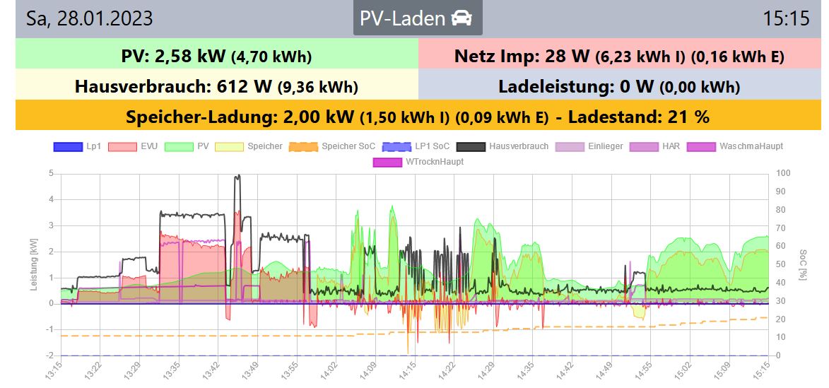

Ergänzung:
2. Fall Laden des Speichers mit EVU Leistung:
Sie wird fälschlicher Weise auch als PV Leistung angezeigt
3. Fall Laden des Speichers mit PV Leistung:
Die Werte werden in diesem Fall richtig angezeigt
