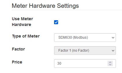

Ok, so I let my existing charging station (EvseWIFI) and use SDM630_v2 via modbus usb adapter -> RPI.
This is perfect, but WHERE in the settings I must setup this counter?

The SDM counts the WB-power. So you have to connect & configure it in EWifi:
Therefore you need a cheap RS485/UART-converter to get A/B to Rx/Tx on ESP-µC.

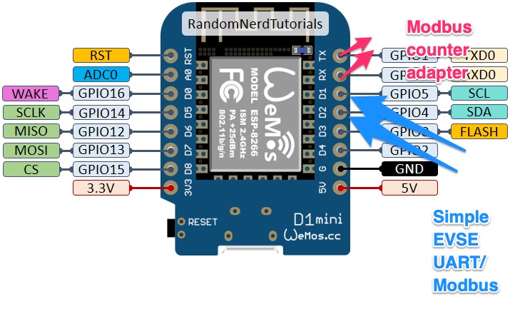

I'm very tired (small kid @ home) and I could not see the RX/TX pins on WeMos D1 mini to connect the modbus counter.

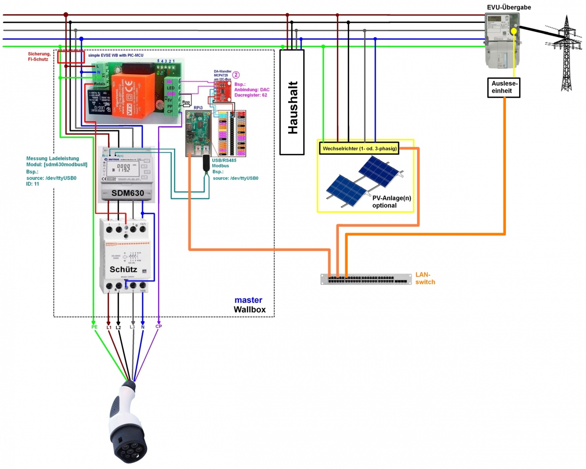

First 2 pic show EWifi with 8266. Third pic. is an old version of openWB with directly coupled DAC. This is not recommended anymore.
You can't use UART + UART/485-converter on same Rx/Tx of 8266., so you can tune up EVSE with fhis:
https://board.evse-wifi.de/viewtopic.php?f=7&t=24
After that you put the 2 devices (EVSE + SDM) on a cheap 485/UART-converter A/B of 485-bus. It is connected to the Rx/Tx of 8266.

From what I see NOW in the documentation, you can.
For Simple EVSE -> WeMos, D1 and D2 pins are used
For Modbus counter - UART adapter -> WeMos, TX and RX pins are used (different pins than D1 and D2).
With the proposed adapter, I would not use SimpleEVSE WIFi v1 (no pins left to connect on Simple EVSE)

OMG - I didn't know our own doc for v1.x. You're right - sry! I'm developing most on v2.x
Ok, than you can use the 2x diff. UARTs like on your pic.
You only need the cheap UART/RS485-converter on HW-UART @Wemos-Rx/Tx for SDM630.
EVSE is connected to SW-UART @Wemos (D1, D2).
