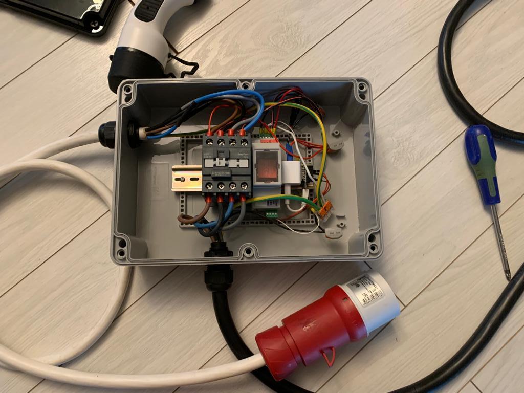

I have my self made Simple EVSE 22kW charger:
- Simple EVSE DIN (Modbus enabled)
- Simple EVSE WIFI
- 5V, 1a for WIFI
- 38A contactor
I'll soon install a 22kW PV installation, with a Fronius Inverter.

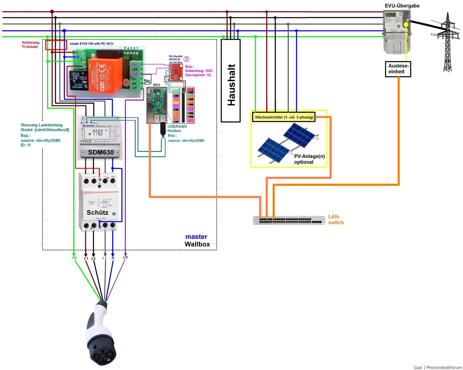

openWB supports EVSE Wifi.
What you need:
- compatible Meter for EVSE Wifi (S0 / RS485 (SDM630v2)
- openWB Standalone
What you need:
- openWB Standalone

Hey,
pls. divide into
* gridmeter and
* charging meter
OpenWB standalone reads gridmeter (EVU-kit or sometimes from PV-Inverter or storage) directly by LAN.
EVSE-Wifi reads it's own charging meter (S0 or RS485 (SDM630v2)) and delivers charging values by API.
Bye aiole
pls. divide into
* gridmeter and
* charging meter
Bye aiole

Charging Meter SDM630 is not optional. It's necesarry for WB control (feedback power & A per phase).
EVU-meter is most important for controling feedin & consumption, but if not available you can use a fixed value.
PV-Meter is option. Only to see PV-values - not for controlling.

If your PV will have an EVU-meter, it could be compatible to openWB as well.
There is a compability list on the website of openWB.
Otherwise you would need the EVU-Kit to be able to charge controlled according PV power.

My Type B RCD, Rpi3 and meter SDM630v2 are are planned to be in the main electric enclosure, inside the building.aiole hat geschrieben: So Jun 07, 2020 1:35 pm Hey,
pls. divide into
* gridmeter and
* charging meter
Bye aiole
The SimpleEVSE Wifi charging station is outside the building ~15m.
As I already have Simple EVSE DIN, with Modbus, but no RS485 module I see two options:
1. I get a "UART - RS485 converter" for my SimpleEVSE DIN, hook it to an RS485 - WLAN converter (I have very good WIFI coverage).
I will not use the EVSE WIFI anymore.
OpenWB will control the station directly via Modbus.
rPI3 (lan connected) + USB-RS485 converter to connect the SDM630v2 (on EV charger circuit) inside the electric panel, in the building
2. I use the existing charging station (SimpleEVSE WIFI), but I will integrate an S0 counter outside (next to the charging station).
I have a hiking dts238-4-m S0 enabled meter.
The SimpleEVSE WIFI will communicate via API with OpenWB the charging current, but I'm not so sure if S0 is reading the current amperage used.
