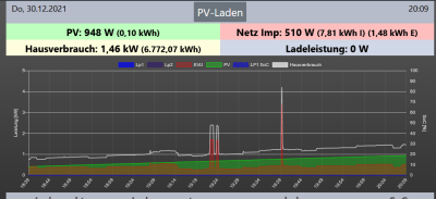

So jetzt gibts leider noch ein Problem wenn die WR schlafen gehen.
Ich habe hier saldierende PV Erträge
Debug Stufe 2:

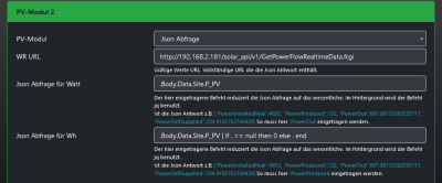

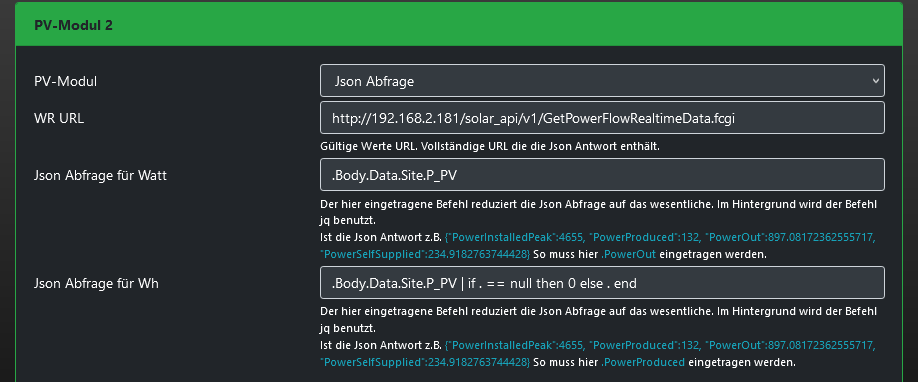

PV Log
2021-12-30 20:13:04: PID: 13237: requests.packages.urllib3.connectionpool: Starting new HTTP connection (1): 192.168.2.182
2021-12-30 20:13:04: PID: 13237: requests.packages.urllib3.connectionpool: http://192.168.2.180:80 "GET /solar_api/v1/GetPowerFlowRealtimeData.fcgi?Scope=System HTTP/1.1" 200 923
2021-12-30 20:13:04: PID: 13237: requests.packages.urllib3.connectionpool: Starting new HTTP connection (1): 192.168.2.180
2021-12-30 20:13:04: PID: 13237: root: Komponente Fronius Wechselrichter auslesen.
2021-12-30 20:13:04: PID: 13237: root: Start device reading {'component1': <modules.fronius.inverter.FroniusInverter object at 0x75b95ed0>}
2021-12-30 20:13:04: PID: 13237: root: Fronius IP-Adresse: 192.168.2.180
2021-12-30 20:13:02: WR IP2: 192.168.2.182 (LV2) at 20 main modules/wr_fronius/main.sh
2021-12-30 20:13:02: WR Gen 24: 0 (LV2) at 19 main modules/wr_fronius/main.sh
2021-12-30 20:13:02: WR IP: 192.168.2.180 (LV2) at 18 main modules/wr_fronius/main.sh
2021-12-30 20:13:01: RET: 0 (LV2) at 29 main modules/wr2_json/main.sh
TypeError: float() argument must be a string or a number, not 'NoneType'
    power = float(jq.compile(config["jq_power"]).input(response).first())
  File "/var/www/html/openWB/packages/modules/json/inverter.py", line 37, in update
    self._components[component].update(response)
  File "/var/www/html/openWB/packages/modules/json/device.py", line 65, in update
2021-12-30 20:13:01: PID: 13017: root: Json Wechselrichter: FaultState FaultStateLevel.ERROR, FaultStr <class 'TypeError'> float() argument must be a string or a number, not 'NoneType', Traceback:
2021-12-30 20:13:00: PID: 13017: root: Komponente Json Wechselrichter auslesen.
      "Timestamp" : "2021-12-30T20:13:00+01:00"
         "UserMessage" : ""
         "Reason" : "",
         "Code" : 0,
      "Status" : {
      "RequestArguments" : {},
   "Head" : {
         "Version" : "12"
            "rel_SelfConsumption" : null
            "rel_Autonomy" : null,
            "P_PV" : null,
            "P_Load" : null,
            "P_Grid" : null,
            "P_Akku" : null,
            "Mode" : "produce-only",
            "Meter_Location" : "unknown",
            "E_Year" : 10756291,
            "E_Total" : 3373.1305555555555,
            "E_Day" : 1474.2000732421875,
         "Site" : {
               "P" : 0
               "E_Total" : 3373.130615234375,
               "DT" : 232,
            "1" : {
         "Inverters" : {
      "Data" : {
   "Body" : {
2021-12-30 20:13:00: PID: 13017: root: Antwort auf http://192.168.2.181/solar_api/v1/GetPowerFlowRealtimeData.fcgi: {
2021-12-30 20:13:00: PID: 13017: requests.packages.urllib3.connectionpool: http://192.168.2.181:80 "GET /solar_api/v1/GetPowerFlowRealtimeData.fcgi HTTP/1.1" 200 942
2021-12-30 20:13:00: PID: 13017: requests.packages.urllib3.connectionpool: Starting new HTTP connection (1): 192.168.2.181
2021-12-30 20:13:00: PID: 13017: root: Start device reading {'component2': <modules.json.inverter.JsonInverter object at 0x76a1a150>}
2021-12-30 20:13:00: PID: 13017: root: Json Konfiguration: {'jq_counter': '.Body.Data.Site.E_Total', 'jq_power': '.Body.Data.Site.P_PV'}
2021-12-30 20:12:58: PV kWh : .Body.Data.Site.E_Total (LV2) at 24 main modules/wr2_json/main.sh
2021-12-30 20:12:58: PV Watt: .Body.Data.Site.P_PV (LV2) at 23 main modules/wr2_json/main.sh
2021-12-30 20:12:58: PV URL : http://192.168.2.181/solar_api/v1/GetPowerFlowRealtimeData.fcgi (LV2) at 22 main modules/wr2_json/main.sh
2021-12-30 20:12:58: RET: 0 (LV2) at 25 main modules/wr_fronius/main.sh
AttributeError: 'PreparedRequest' object has no attribute 'host'
    return "Die Verbindung zum Server {} ist fehlgeschlagen. Überprüfe Adresse und Netzwerk.".format(e.request.host)
  File "/var/www/html/openWB/packages/helpermodules/exceptions/requests.py", line 8, in handle_connection_error
    result = entry.handler(exception)
  File "/var/www/html/openWB/packages/helpermodules/exceptions/registry.py", line 31, in translate_exception
    return exceptions.get_default_exception_registry().translate_exception(exception)
  File "/var/www/html/openWB/packages/modules/common/fault_state.py", line 80, in from_exception
    fault_state = FaultState.from_exception(exception)
  File "/var/www/html/openWB/packages/modules/common/component_context.py", line 41, in __exit__
    self._components[component].update(self.bat_configured)
  File "/var/www/html/openWB/packages/modules/fronius/device.py", line 96, in update
    dev.update()
  File "/var/www/html/openWB/packages/modules/fronius/device.py", line 147, in read_legacy
    parser.set_defaults(RUN=lambda args: function(*[getattr(args, argument_name) for argument_name in arg_spec.args]))
  File "/var/www/html/openWB/packages/helpermodules/cli/_run_using_positional_cli_args.py", line 19, in <lambda>
    args.RUN(args)
  File "/var/www/html/openWB/packages/helpermodules/cli/_run_using_positional_cli_args.py", line 33, in run_using_positional_cli_args
    run_using_positional_cli_args(read_legacy)
  File "/var/www/html/openWB/packages/modules/fronius/device.py", line 152, in <module>
requests.exceptions.ConnectTimeout: HTTPConnectionPool(host='192.168.2.182', port=80): Max retries exceeded with url: /solar_api/v1/GetPowerFlowRealtimeData.fcgi?Scope=System (Caused by ConnectTimeoutError(<requests.packages.urllib3.connection.HTTPConnection object at 0x75bede70>, 'Connection to 192.168.2.182 timed out. (connect timeout=3)'))
    raise ConnectTimeout(e, request=request)
  File "/usr/lib/python3/dist-packages/requests/adapters.py", line 479, in send
    r = adapter.send(request, **kwargs)
  File "/usr/lib/python3/dist-packages/requests/sessions.py", line 609, in send
  File "/usr/lib/python3/dist-packages/requests/sessions.py", line 488, in request
    return session.request(method=method, url=url, **kwargs)
  File "/usr/lib/python3/dist-packages/requests/api.py", line 56, in request
    return request('get', url, params=params, **kwargs)
  File "/usr/lib/python3/dist-packages/requests/api.py", line 70, in get
    params=params, timeout=3)
  File "/var/www/html/openWB/packages/modules/fronius/inverter.py", line 90, in __get_wr2
    power2, counter2 = self.__get_wr2()
  File "/var/www/html/openWB/packages/modules/fronius/inverter.py", line 57, in update
    power_inverter = self._components[component].update(self.bat_configured)
  File "/var/www/html/openWB/packages/modules/fronius/device.py", line 68, in update
requests.packages.urllib3.exceptions.MaxRetryError: HTTPConnectionPool(host='192.168.2.182', port=80): Max retries exceeded with url: /solar_api/v1/GetPowerFlowRealtimeData.fcgi?Scope=System (Caused by ConnectTimeoutError(<requests.packages.urllib3.connection.HTTPConnection object at 0x75bede70>, 'Connection to 192.168.2.182 timed out. (connect timeout=3)'))
    raise MaxRetryError(_pool, url, error or ResponseError(cause))
  File "/usr/lib/python3/dist-packages/urllib3/util/retry.py", line 363, in increment
    _stacktrace=sys.exc_info()[2])
  File "/usr/lib/python3/dist-packages/urllib3/connectionpool.py", line 643, in urlopen
    timeout=timeout
  File "/usr/lib/python3/dist-packages/requests/adapters.py", line 423, in send
requests.packages.urllib3.exceptions.ConnectTimeoutError: (<requests.packages.urllib3.connection.HTTPConnection object at 0x75bede70>, 'Connection to 192.168.2.182 timed out. (connect timeout=3)')
    (self.host, self.timeout))
  File "/usr/lib/python3/dist-packages/urllib3/connection.py", line 143, in _new_conn
    conn = self._new_conn()
  File "/usr/lib/python3/dist-packages/urllib3/connection.py", line 163, in connect

Ich habe das mal so wie von Yankee reinkopiert, bekomme aber Fehlermeldungen:
/var/www/html/openWB/loadconfig.sh: Zeile 8: export: `.': Ist kein gültiger Bezeichner.
/var/www/html/openWB/loadconfig.sh: Zeile 8: export: `0': Ist kein gültiger Bezeichner.
/var/www/html/openWB/loadconfig.sh: Zeile 8: export: `==': Ist kein gültiger Bezeichner.
/var/www/html/openWB/loadconfig.sh: Zeile 8: export: `|': Ist kein gültiger Bezeichner.
AttributeError: 'NoneType' object has no attribute 'interCharTimeout'
    self.socket.interCharTimeout = self.inter_char_timeout
  File "/usr/local/lib/python2.7/dist-packages/pymodbus/client/sync.py", line 476, in connect
    if not self.connect():
  File "/usr/local/lib/python2.7/dist-packages/pymodbus/client/sync.py", line 106, in execute
    return self.execute(request)
  File "/usr/local/lib/python2.7/dist-packages/pymodbus/client/common.py", line 125, in read_input_registers
    resp = client.read_input_registers(0x00,2, unit=sdmid)
  File "/var/www/html/openWB/modules/mpm3pmll/readmpm3pm.py", line 93, in <module>
2021-12-31 08:28:13: **** FATAL ********************************* (LV0)
2021-12-31 08:28:13: **** FATAL Regulation loop needs 12 seconds (LV0)
loadvars.sh: Zeile 126: [: : Ganzzahliger Ausdruck erwartet.
2021-12-31 08:28:12: Modbus EVSE read CP1 issue - using previous state '' (LV0)
loadvars.sh: Zeile 120: /var/www/html/openWB/ramdisk/evseplugstate: Datei oder Verzeichnis nicht gefunden
  File "/usr/local/lib/python2.7/dist-packages/pymodbus/client/common.py", line 114, in read_holding_registers
    request = client.read_holding_registers(readreg,reganzahl,unit=modbusid)
  File "runs/readmodbus.py", line 17, in <module>
War das so richtig?
3 x Victron Multiplus II 5000 mit 71kWh Pylontech im Second Live
Tesla Model 3 LR
1 OpenWB Standard+, 1 OpenWB Pro

Hmm, das wird nicht richtig aufgelöst. Welche openWB Version hast du gerade am laufen?
Ich hab das gerade bei mir getestet, da geht es. Sieht so aus, als ob in der openwb.config was daneben liegt.
Evtl. fehlen da Quotes.
