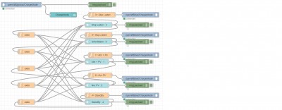

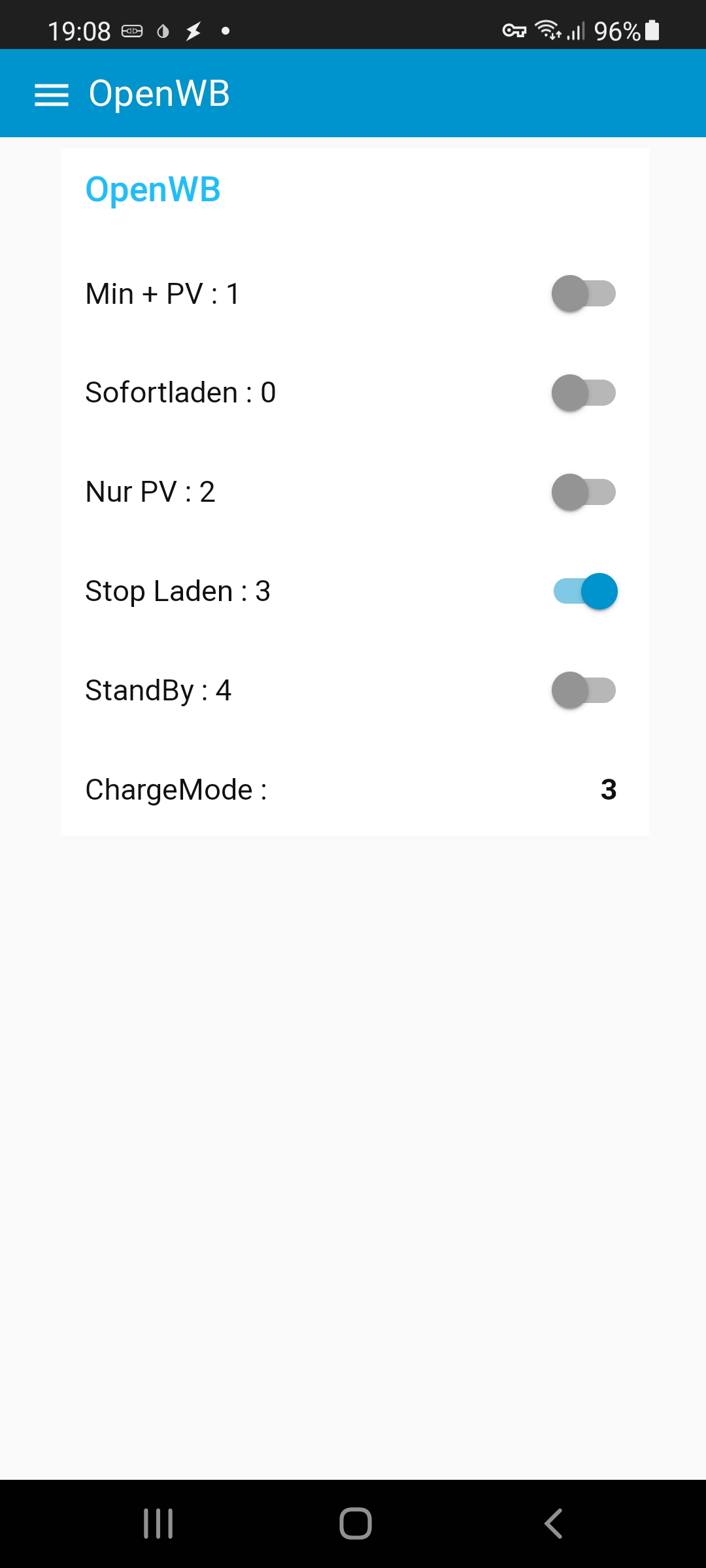

[Ich habe mir auch mal in NodeRed was programmiert.
Den ChargeMode habe ich mal anders modelliert s.Bild.
Auf einem Handy kann man die OpenWB so einfach bedienen.
NodeRed Code:
        "id": "59812e76.282eb",
        "type": "tab",
        "label": "Wallbox",
        "disabled": false,
        "info": ""
        "id": "d21437f6.cd79c8",
        "type": "ui_switch",
        "z": "59812e76.282eb",
        "name": "",
        "label": "Min + PV : 1",
        "tooltip": "",
        "group": "dbe87afe.d08e98",
        "order": 1,
        "width": 0,
        "height": 0,
        "passthru": true,
        "decouple": "false",
        "topic": "",
        "topicType": "str",
        "style": "",
        "onvalue": "true",
        "onvalueType": "bool",
        "onicon": "",
        "oncolor": "",
        "offvalue": "false",
        "offvalueType": "bool",
        "officon": "",
        "offcolor": "",
        "animate": true,
        "x": 970,
        "y": 380,
        "wires": [
                "8b4c00ee.f15d5",
                "156b5a33.34a2d6",
                "1b63f614.eda3ca"

        "name": "openWB/set/ChargeMode",
        "topic": "mqtt.0.openWB.set.ChargeMode",
        "ack": "false",
        "autoCreate": "false",
        "stateName": "",
        "role": "",
        "payloadType": "",
        "readonly": "",
        "stateUnit": "",
        "stateMin": "",
        "stateMax": "",
        "x": 1230,
        "y": 580,
        "wires": []
        "id": "69fa2659.d14e08",
        "type": "ioBroker out",
        "ack": "false",
        "stateName": "",
        "role": "",
        "payloadType": "",
        "readonly": "",
        "stateUnit": "",
        "stateMin": "",
        "stateMax": "",
        "x": 1230,
        "y": 480,
        "wires": []
        "id": "58ac18b6.950008",
        "type": "function",
        "name": "0= Stop Laden",
        "func": "if (msg.payload == 1) msg.payload = 0;\nreturn msg;",
        "outputs": 1,
        "noerr": 0,
        "initialize": "",
        "finalize": "",
        "libs": [],
        "x": 980,
        "y": 220,
        "wires": [
                "d901125.0fce3f"
        "id": "d901125.0fce3f",
        "ack": "false",
        "stateName": "",
        "role": "",
        "payloadType": "",
        "readonly": "",
        "stateUnit": "",
        "stateMin": "",
        "stateMax": "",
        "x": 1230,
        "y": 220,
        "wires": []
        "id": "407535b8.c63b2c",
        "type": "ui_text",
        "order": 6,
        "width": 0,
        "height": 0,
        "name": "",
        "label": "ChargeMode :",
        "format": "{{msg.payload}}",
        "layout": "row-spread",
        "x": 770,
        "y": 100,
        "wires": []
        "id": "dbe87afe.d08e98",
        "type": "ui_group",
        "name": "Wallbox",
        "tab": "9e6b63bb.c14de",
        "order": 1,
        "disp": true,
        "width": "6",
        "collapse": false
        "id": "9e6b63bb.c14de",
        "type": "ui_tab",
        "name": "OpenWB",
        "icon": "dashboard",
        "order": 3,
        "disabled": false,
        "hidden": false
