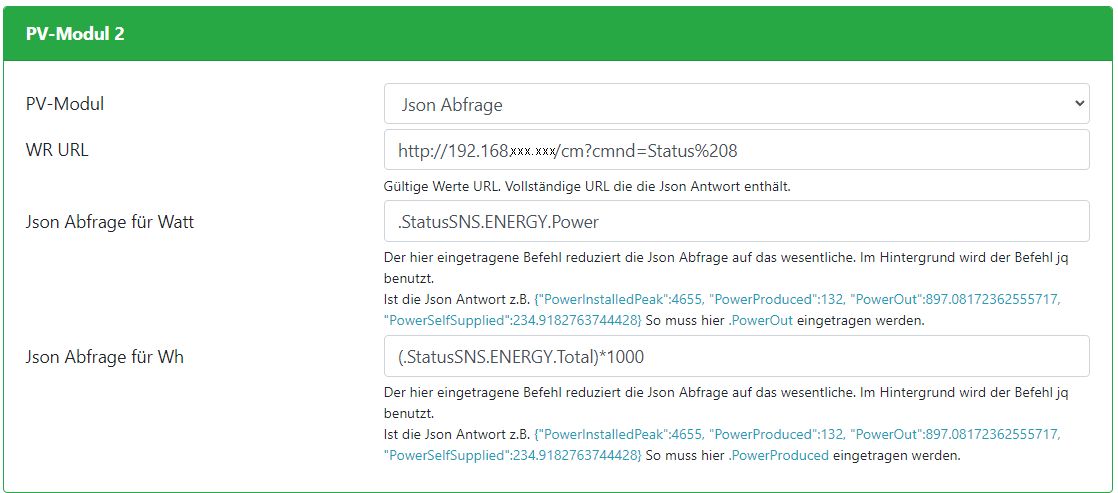

Ich hoffe der Ausschnitt reicht:
2022-11-24 12:40:17: PID: 2071: legacy run server: Completed running command in 1.75s: ["modules.json.device","inverter","http://192.168.2.247/cm?cmnd=Status%208",".StatusSNS.Energy.Power
ValueError: null (null) and number (-1) cannot be multiplied
File "jq.pyx", line 319, in jq._ResultIterator.__next__
File "jq.pyx", line 278, in jq._ProgramWithInput.first
power = float(jq.compile(config.jq_power).input(response).first())
File "/var/www/html/openWB/packages/modules/json/inverter.py", line 26, in update
self.components[component].update(response.json())
File "/var/www/html/openWB/packages/modules/json/device.py", line 62, in update
2022-11-24 12:40:17: PID: 2071: soc.modules.common.fault_state: Json Wechselrichter: FaultState FaultStateLevel.ERROR, FaultStr <class 'ValueError'> null (null) and number (-1) cannot be multiplied, Traceback:
2022-11-24 12:40:17: PID: 22063: uberschuss -1340 wattbezug 1350 ladestatus 0 llsoll 0 pvwatt -303 mindestuberschussphasen 1200 wattkombiniert -1340 schaltschwelle 230 (LV2) at 576 main /var/www/html/openWB/regel.sh
