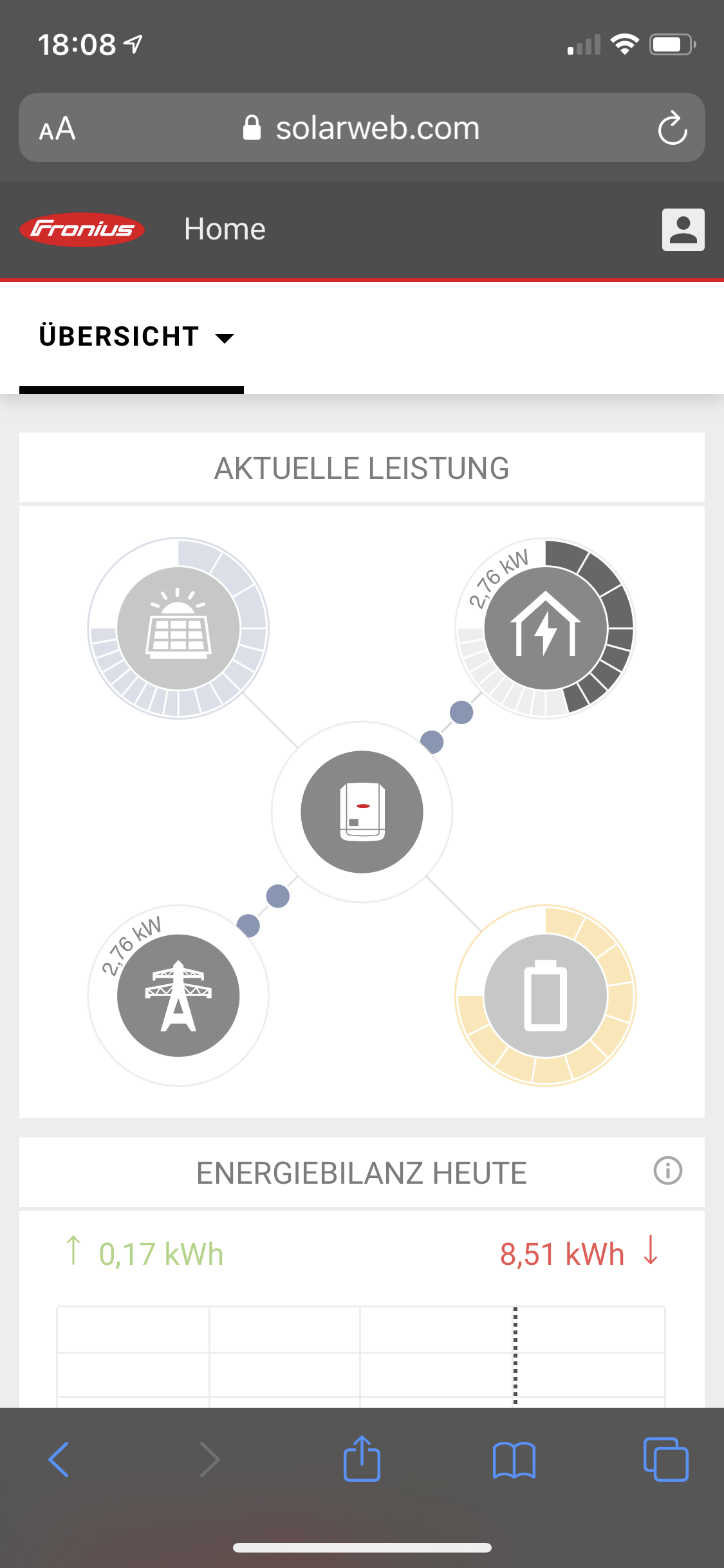

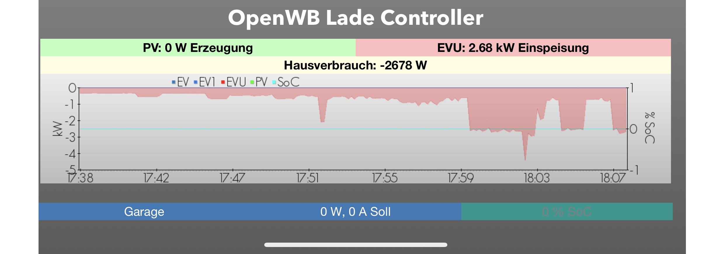

Re: Fronius WR mit SmartMeter
Leider ist es mir nicht möglich den Smart Meter einfach an den Einspeisepunkt zu klemmen
Anbei noch die gewünschten Daten:
Hier die JSON Antwort:
"Body" : {
"Data" : {
"Current_AC_Phase_1" : 0.625,
"Current_AC_Phase_2" : 1.889,
"Current_AC_Phase_3" : 9.7569999999999997,
"Details" : {
"Manufacturer" : "Fronius",
"Model" : "Smart Meter 63A",
"Serial" : "16482021"
"Enable" : 1,
"EnergyReactive_VArAC_Sum_Consumed" : 358680,
"EnergyReactive_VArAC_Sum_Produced" : 36697410,
"EnergyReal_WAC_Minus_Absolute" : 14739325,
"EnergyReal_WAC_Plus_Absolute" : 0,
"EnergyReal_WAC_Sum_Consumed" : 14739325,
"EnergyReal_WAC_Sum_Produced" : 0,
"Frequency_Phase_Average" : 50,
"Meter_Location_Current" : 1,
"PowerApparent_S_Phase_1" : 142.5625,
"PowerApparent_S_Phase_2" : 419.73579999999998,
"PowerApparent_S_Phase_3" : 2193.3735999999999,
"PowerApparent_S_Sum" : 2655,
"PowerFactor_Phase_1" : 0.97999999999999998,
"PowerFactor_Phase_2" : 0.93999999999999995,
"PowerFactor_Phase_3" : -0.98999999999999999,
"PowerFactor_Sum" : 0.98999999999999999,
"PowerReactive_Q_Phase_1" : -24.039999999999999,
"PowerReactive_Q_Phase_2" : -122.48,
"PowerReactive_Q_Phase_3" : 35.340000000000003,
"PowerReactive_Q_Sum" : -111.18000000000001,
"PowerReal_P_Phase_1" : -128.94999999999999,
"PowerReal_P_Phase_2" : -346.35000000000002,
"PowerReal_P_Phase_3" : -2178.5,
"PowerReal_P_Sum" : -2653.8000000000002,
"TimeStamp" : 1580576869,
"Visible" : 1,
"Voltage_AC_PhaseToPhase_12" : 390,
"Voltage_AC_PhaseToPhase_23" : 387.10000000000002,
"Voltage_AC_PhaseToPhase_31" : 392.19999999999999,
"Voltage_AC_Phase_1" : 228.09999999999999,
"Voltage_AC_Phase_2" : 222.19999999999999,
"Voltage_AC_Phase_3" : 224.80000000000001
"Head" : {
"RequestArguments" : {
"DeviceClass" : "Meter",
"DeviceId" : "0",
"Scope" : "Device"
"Status" : {
"Code" : 0,
"Reason" : "",
"UserMessage" : ""
"Timestamp" : "2020-02-01T18:07:49+01:00"

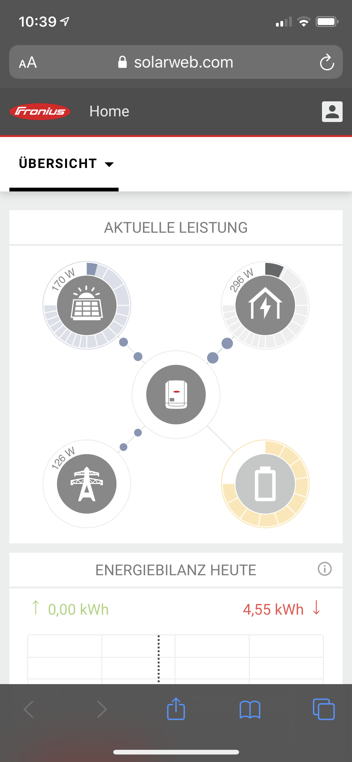

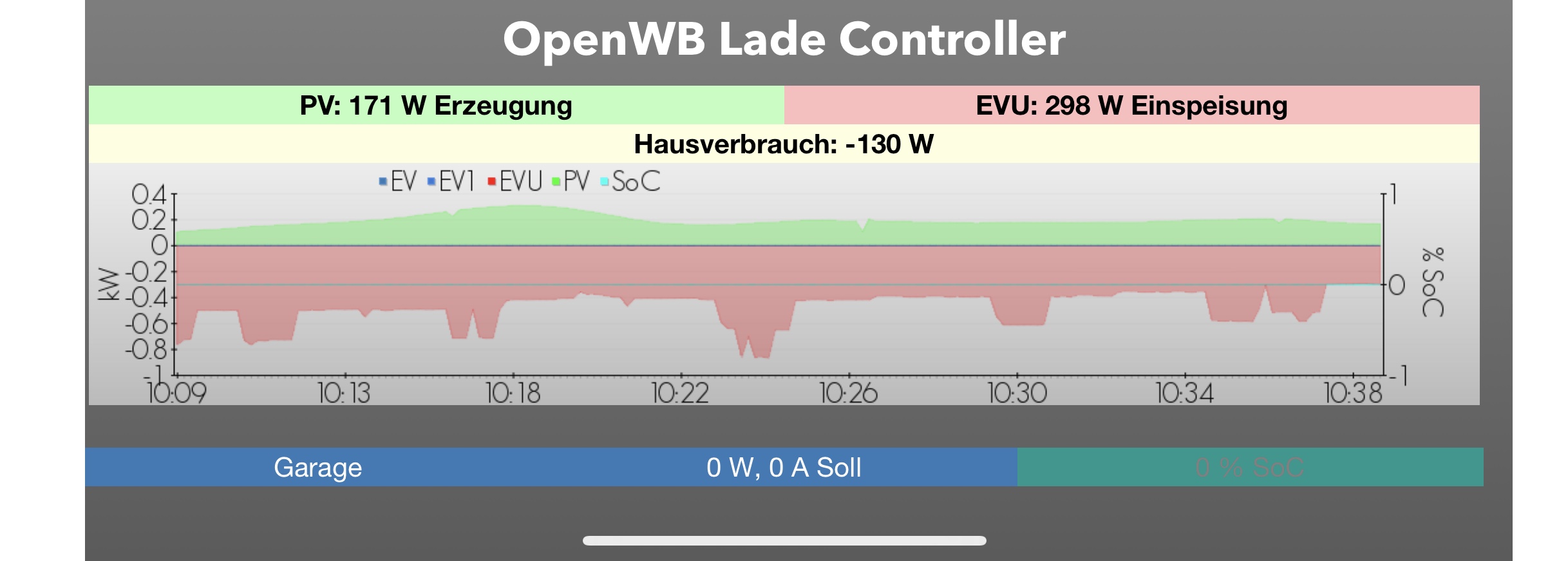

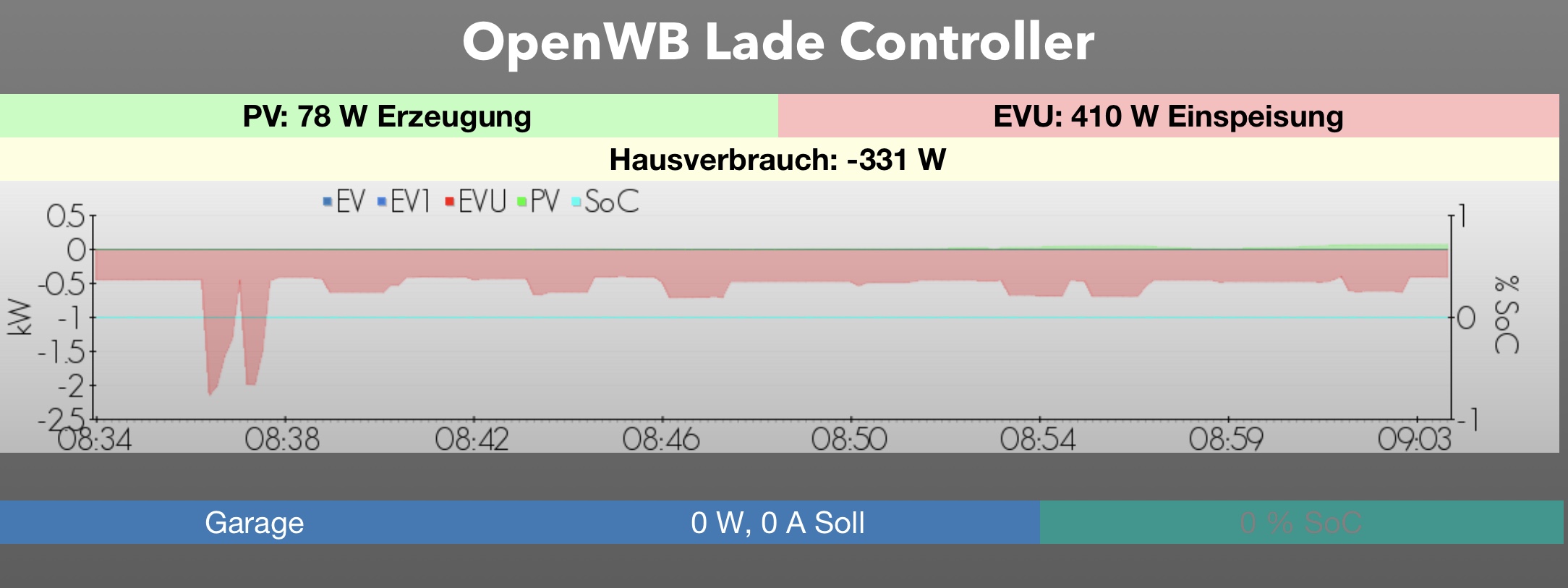

Hab noch mal einen besseren Datensatz gemacht.
Der vorherige hatte ja keine PV-Leistung.
Hier die JSON Rückantwort:
"Body" : {
"Data" : {
"Current_AC_Phase_1" : 0.45100000000000001,
"Current_AC_Phase_2" : 1.1040000000000001,
"Current_AC_Phase_3" : 0.66000000000000003,
"Details" : {
"Enable" : 1,
"EnergyReactive_VArAC_Sum_Produced" : 36724670,
"EnergyReal_WAC_Minus_Absolute" : 14749291,
"EnergyReal_WAC_Sum_Consumed" : 14749291,
"PowerApparent_S_Phase_1" : 103.3241,
"PowerApparent_S_Phase_2" : 249.83520000000004,
"PowerApparent_S_Phase_3" : 151.99800000000002,
"PowerApparent_S_Sum" : 345,
"PowerFactor_Phase_1" : 0.93000000000000005,
"PowerFactor_Phase_2" : 0.83999999999999997,
"PowerFactor_Phase_3" : 0.87,
"PowerFactor_Sum" : 0.87,
"PowerReactive_Q_Phase_1" : -26.370000000000001,
"PowerReactive_Q_Phase_2" : -99.189999999999998,
"PowerReactive_Q_Phase_3" : -43.5,
"PowerReactive_Q_Sum" : -169.06,
"PowerReal_P_Phase_1" : -64.239999999999995,
"PowerReal_P_Phase_2" : -155.03,
"PowerReal_P_Phase_3" : -82.560000000000002,
"PowerReal_P_Sum" : -301.82999999999998,
"TimeStamp" : 1580636373,
"Visible" : 1,
"Voltage_AC_PhaseToPhase_12" : 394.39999999999998,
"Voltage_AC_PhaseToPhase_23" : 395.39999999999998,
"Voltage_AC_PhaseToPhase_31" : 397.89999999999998,
"Voltage_AC_Phase_1" : 229.09999999999999,
"Voltage_AC_Phase_2" : 226.30000000000001,
"Voltage_AC_Phase_3" : 230.30000000000001
"Head" : {
"DeviceId" : "0",
"Scope" : "Device"
"Status" : {
"Code" : 0,
"Reason" : "",
"UserMessage" : ""
"Timestamp" : "2020-02-02T10:39:33+01:00"
Danke schon mal für eure Hilfe echt Top
Hier die geforderten Daten:
So... ich habe das Bezugsmodul mal überarbeitet: https://github.com/snaptec/openWB/pull/350
@Bitdevil: Wenn Kevin das in den master gemergt hat, bitte ich Dich das mal zu testen. Ich hoffe dass da nicht noch irgendwo ein Vorzeichendreher drin ist. Bitte schau Dir auch mal die EVU-Werte auf der Status-Seite an... bei mir zumindest sieht das schlüssig aus, wobei ich natürlich nicht das SmartMeter umgeklemmt, sondern nur die Einstellung für ein Einbauort gewechselt habe.
@Kevin: Am alten Code habe ich nichts geändert. Da ich nicht weiß, welche Werte für "Meter_Location_Current" es sonst noch so gibt, lasse ich für alles außer "1" den alten Code durchlaufen. Nur bei "1" (-> SmartMeter sitzt im Verbrauchszweig) versuche ich so viel wie möglich aus den Daten des SmartMeters und des Wechselrichters zu kombinieren.
Viele Grüße,
Michael
Viele Grüße,
Michael

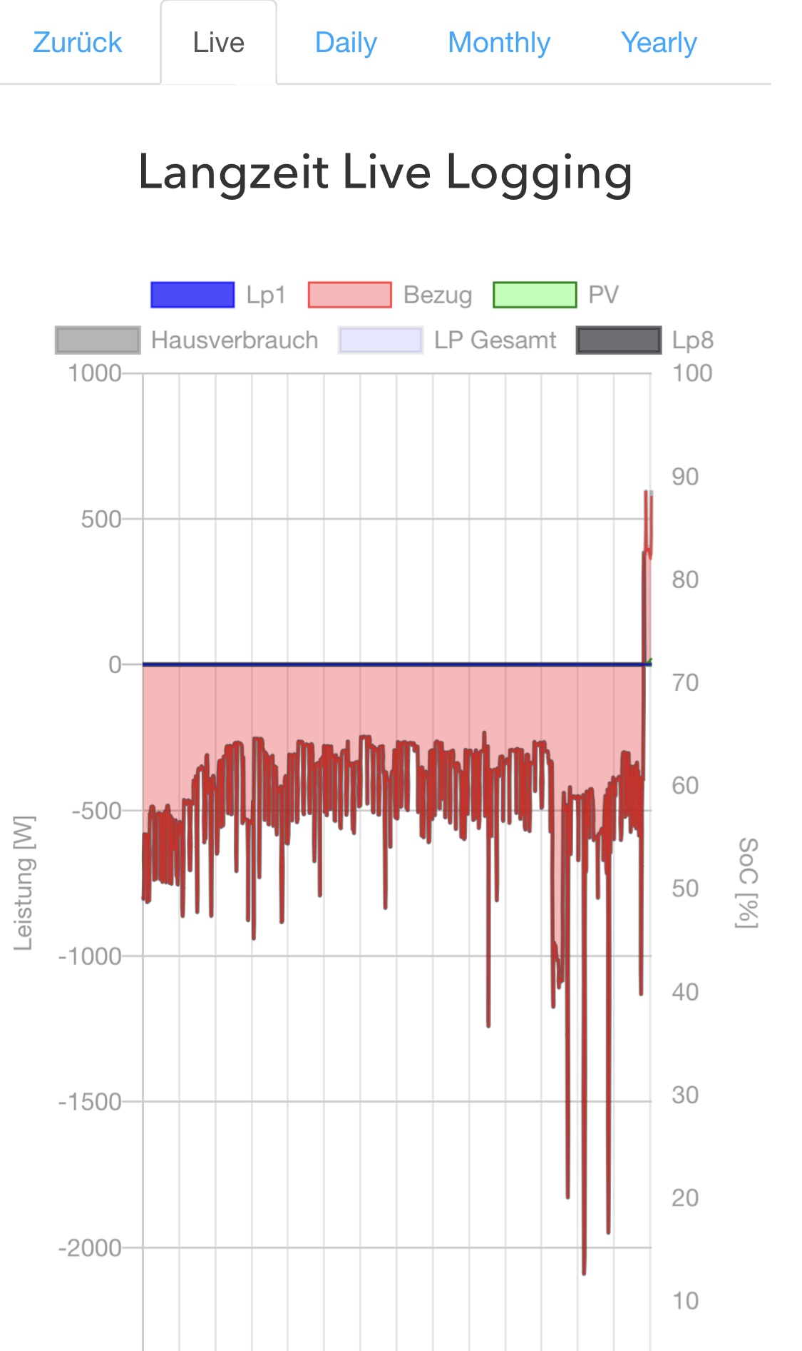

Habe die nightly Version installiert.
Beim Live logging hat sich etwas geändert.
Aber beim Daily usw. stehen keine Daten.
