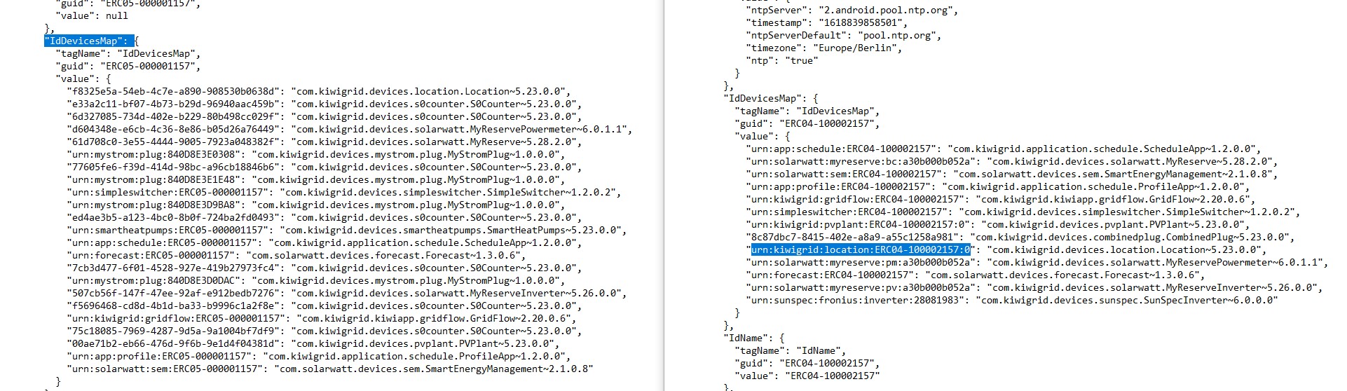

Ich habe daher mal geschaut, wo diese guid noch verwendet wird.
"IdDevicesMap": {
"tagName": "IdDevicesMap",
"guid": "ERC05-000001157",
"value": {
"f8325e5a-54eb-4c7e-a890-908530b0638d": "com.kiwigrid.devices.location.Location~5.23.0.0",
"e33a2c11-bf07-4b73-b29d-96940aac459b": "com.kiwigrid.devices.s0counter.S0Counter~5.23.0.0",
"6d327085-734d-402e-b229-80b498cc029f": "com.kiwigrid.devices.s0counter.S0Counter~5.23.0.0",
"d604348e-e6cb-4c36-8e86-b05d26a76449": "com.kiwigrid.devices.solarwatt.MyReservePowermeter~6.0.1.1",
"61d708c0-3e55-4444-9005-7923a048382f": "com.kiwigrid.devices.solarwatt.MyReserve~5.28.2.0",
"urn:mystrom:plug:840D8E3E0308": "com.kiwigrid.devices.mystrom.plug.MyStromPlug~1.0.0.0",
"77605fe6-f39d-414d-98bc-a96cb18846b6": "com.kiwigrid.devices.s0counter.S0Counter~5.23.0.0",
"urn:mystrom:plug:840D8E3E1E48": "com.kiwigrid.devices.mystrom.plug.MyStromPlug~1.0.0.0",
"urn:simpleswitcher:ERC05-000001157": "com.kiwigrid.devices.simpleswitcher.SimpleSwitcher~1.2.0.2",
"urn:mystrom:plug:840D8E3D9BA8": "com.kiwigrid.devices.mystrom.plug.MyStromPlug~1.0.0.0",
"ed4ae3b5-a123-4bc0-8b0f-724ba2fd0493": "com.kiwigrid.devices.s0counter.S0Counter~5.23.0.0",
"urn:smartheatpumps:ERC05-000001157": "com.kiwigrid.devices.smartheatpumps.SmartHeatPumps~5.23.0.0",
"urn:app:schedule:ERC05-000001157": "com.kiwigrid.application.schedule.ScheduleApp~1.2.0.0",
"urn:forecast:ERC05-000001157": "com.solarwatt.devices.forecast.Forecast~1.3.0.6",
"7cb3d477-6f01-4528-927e-419b27973fc4": "com.kiwigrid.devices.s0counter.S0Counter~5.23.0.0",
"urn:mystrom:plug:840D8E3D0DAC": "com.kiwigrid.devices.mystrom.plug.MyStromPlug~1.0.0.0",
"507cb56f-147f-47ee-92af-e912bedb7276": "com.kiwigrid.devices.solarwatt.MyReserveInverter~5.26.0.0",
"f5696468-cd8d-4b1d-ba33-b9996c1a2f8e": "com.kiwigrid.devices.s0counter.S0Counter~5.23.0.0",
"urn:kiwigrid:gridflow:ERC05-000001157": "com.kiwigrid.kiwiapp.gridflow.GridFlow~2.20.0.6",
"75c18085-7969-4287-9d5a-9a1004bf7df9": "com.kiwigrid.devices.s0counter.S0Counter~5.23.0.0",
"00ae71b2-eb66-476d-9f6b-9e1d4f04381d": "com.kiwigrid.devices.pvplant.PVPlant~5.23.0.0",
"urn:app:profile:ERC05-000001157": "com.kiwigrid.application.schedule.ProfileApp~1.2.0.0",
"urn:solarwatt:sem:ERC05-000001157": "com.solarwatt.devices.sem.SmartEnergyManagement~2.1.0.8"
Das sind ne ganze Menge Definitionen und ich vermute, dass du nicht alles hast, was da irgendwie aufgeführt ist.
Kannst du dir das erklären?
"IdDevicesMap": {
"value": {

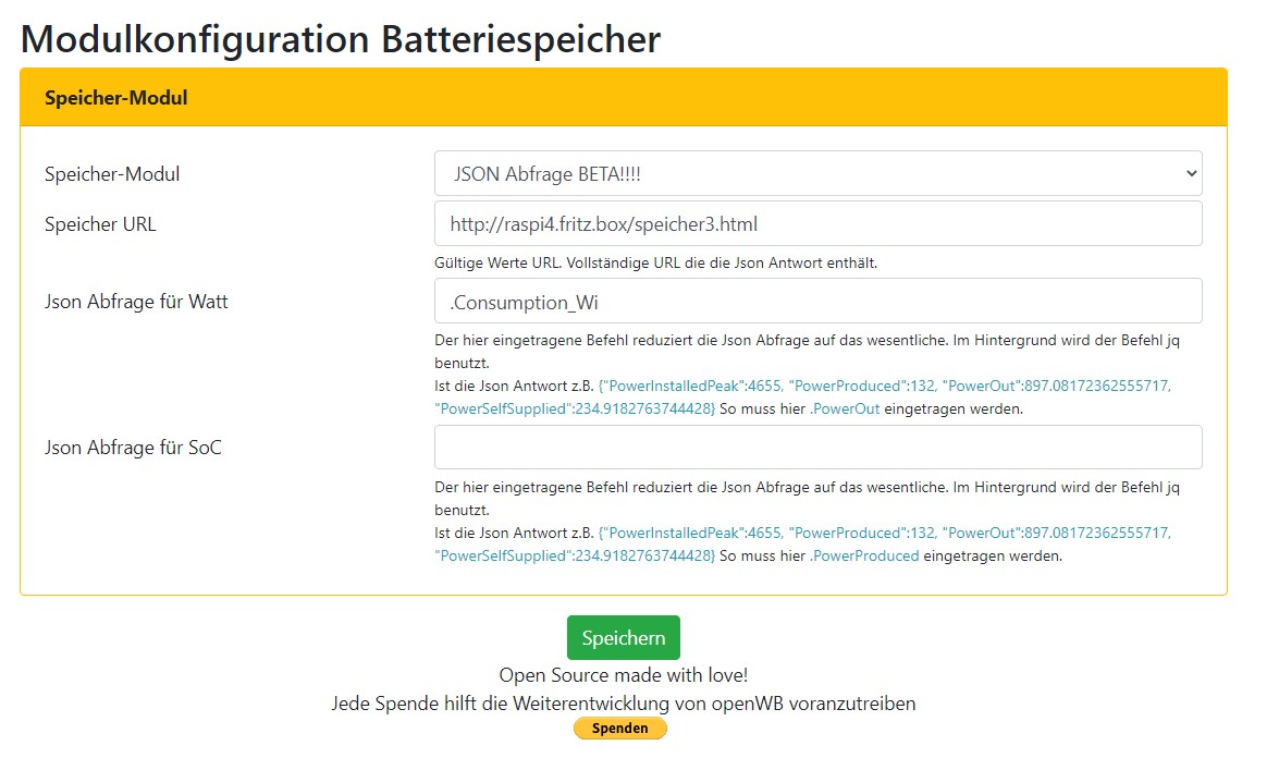

Aus dem Gateway kannst du dir das ziemlich sicher bereits mit den allgemeinen JSON Modulen holen.
Da jq direkt rechnen kann, ist das ohne Programmierung möglich. Falls du negieren musst, einfach noch *-1 anhängen
Den SoC Value holst du mit dem Filter : .SData.SoC
Für Deine Berechnung Ladung/Entladung z.B. kannst du mit dem folgenden jq Filter arbeiten: (.FData.VBat*.FData.IBat){
