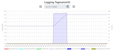

also nein bin auf Brave Browser unterwegs "Brave Shild" ist aus (das war meine erste Intention) Virenscanner is Brav (Defender) und alles auf der Lokalen Wallbox kein Cloud zugriff.

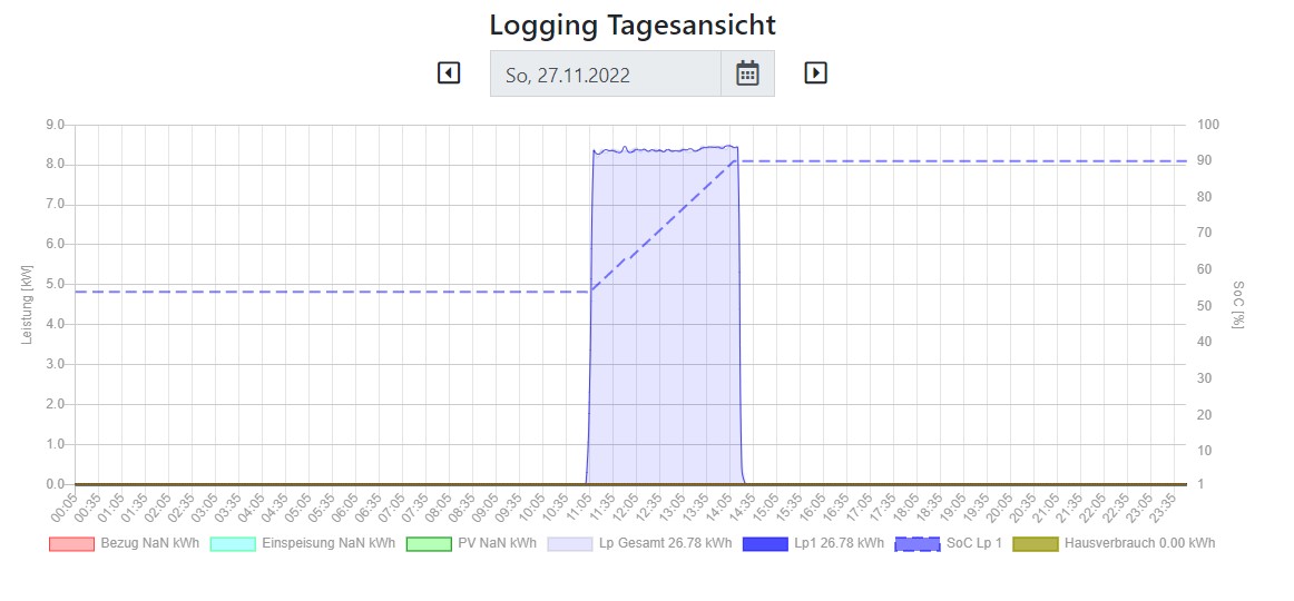

Inhalt der Nov. Datei (wo es noch bis ans ende Einträge gibt:
20221124,0,0,0,729151.000,0,0,729151.000,0,0,0,0,0,0,0,0,0,0,0,0,0,0,0,0,0,0,0,0,0
20221125,0,0,0,729151.000,0,0,729151.000,0,0,0,0,0,0,0,0,0,0,0,0,0,0,0,0,0,0,0,0,0
20221126,0,0,0,729151.000,0,0,729151.000,0,0,0,0,0,0,0,0,0,0,0,0,0,0,0,0,0,0,0,0,0
20221127,0,0,0,729151.000,0,0,729151.000,0,0,0,0,0,0,0,0,0,0,0,0,0,0,0,0,0,0,0,0,0
20221128,0,0,0,755933.000,0,0,755933.000,0,0,0,0,0,0,0,0,0,0,0,0,0,0,0,0,0,0,0,0,0
20221129,0,0,0,757308.000,0,0,757308.000,0,0,0,0,0,0,0,0,0,0,0,0,0,0,0,0,0,0,0,0,0
20221130,0,0,0,757308.000,0,0,757308.000,0,0,0,0,0,0,0,0,0,0,0,0,0,0,0,0,0,0,0,0,0
20221201,0,0,0,757308.000,0,0,757308.000,0,0,0,0,0,0,0,0,0,0,0,0,0,0,0,0,0,0,0,0,0
20221202,0,0,0,757308.000,0,0,757308.000,0,0,0,0,0,0,0,0,0,0,0,0,0,0,0,0,0,0,0,0,0
20221203,0,0,0,757308.000,757307983.3984375000,0,757308.000,0,0,0,0,0,0,0,0,0,0,0,0,0,0,0,0,0,0,0,0,0
20221204,0,0,0,757308.000,757307983.3984375000,0,757308.000,0,0,0,0,0,0,0,0,0,0,0,0,0,0,0,0,0,0,0,0,0
20221205,0,0,0,757308.000,784068969.7265625000,0,757308.000,0,0,0,0,0,0,0,0,0,0,0,0,0,0,0,0,0,0,0,0,0
20221206,0,0,0,757308.000,784956970.2148438000,0,757308.000,0,0,0,0,0,0,0,0,0,0,0,0,0,0,0,0,0,0,0,0,0
20221207,0,0,0,757308.000,784956970.2148438000,0,757308.000,0,0,0,0,0,0,0,0,0,0,0,0,0,0,0,0,0,0,0,0,0
20221208,0,0,0,757308.000,784956970.2148438000,0,757308.000,0,0,0,0,0,0,0,0,0,0,0,0,0,0,0,0,0,0,0,0,0
20221215,0,0,0,0,813836975.0976562000,0,0,0,0,0,0,0,0,0,0,0,0,0,0,0,0,0,0,0,0,0,0,0
20221216,0,0,0,0,813836975.0976562000,0,0,0,0,0,0,0,0,0,0,0,0,0,0,0,0,0,0,0,0,0,0,0
20221217,0,0,0,0,813836975.0976562000,0,0,0,0,0,0,0,0,0,0,0,0,0,0,0,0,0,0,0,0,0,0,0
20221218,0,0,0,0,837992980.9570312000,0,0,0,0,0,0,0,0,0,0,0,0,0,0,0,0,0,0,0,0,0,0,0
20221219,0,0,0,0,866552001.953125000,0,0,0,0,0,0,0,0,0,0,0,0,0,0,0,0,0,0,0,0,0,0,0
20221220,0,0,0,0,868906005.859375000,0,0,0,0,0,0,0,0,0,0,0,0,0,0,0,0,0,0,0,0,0,0,0
20221221,0,0,0,0,868906005.859375000,0,0,0,0,0,0,0,0,0,0,0,0,0,0,0,0,0,0,0,0,0,0,0
20221222,0,0,0,0,868906005.859375000,0,0,0,0,0,0,0,0,0,0,0,0,0,0,0,0,0,0,0,0,0,0,0
20221223,0,0,0,0,868906005.859375000,0,0,0,0,0,0,0,0,0,0,0,0,0,0,0,0,0,0,0,0,0,0,0
20221224,0,0,0,0,880994018.5546875000,0,0,0,0,0,0,0,0,0,0,0,0,0,0,0,0,0,0,0,0,0,0,0
20221225,0,0,0,0,880994018.5546875000,0,0,0,0,0,0,0,0,0,0,0,0,0,0,0,0,0,0,0,0,0,0,0
20221226,0,0,0,0,880994018.5546875000,0,0,0,0,0,0,0,0,0,0,0,0,0,0,0,0,0,0,0,0,0,0,0
20221227,0,0,0,0,880994018.5546875000,0,0,0,0,0,0,0,0,0,0,0,0,0,0,0,0,0,0,0,0,0,0,0
20221228,0,0,0,0,892083984.375000,0,0,0,0,0,0,0,0,0,0,0,0,0,0,0,0,0,0,0,0,0,0,0
20221229,0,0,0,0,907747985.8398438000,0,0,0,0,0,0,0,0,0,0,0,0,0,0,0,0,0,0,0,0,0,0,0
20221230,0,0,0,0,928728027.34375000,0,0,0,0,0,0,0,0,0,0,0,0,0,0,0,0,0,0,0,0,0,0,0
20221231,0,0,0,0,947237976.0742188000,0,0,0,0,0,0,0,0,0,0,0,0,0,0,0,0,0,0,0,0,0,0,0
20230101,0,0,0,0,947237976.0742188000,0,0,0,0,0,0,0,0,0,0,0,0,0,0,0,0,0,0,0,0,0,0,0
20230102,0,0,0,0,947237976.0742188000,0,0,0,0,0,0,0,0,0,0,0,0,0,0,0,0,0,0,0,0,0,0,0
20230103,0,0,0,0,947237976.0742188000,0,0,0,0,0,0,0,0,0,0,0,0,0,0,0,0,0,0,0,0,0,0,0
20230104,0,0,0,0,947237976.0742188000,0,0,0,0,0,0,0,0,0,0,0,0,0,0,0,0,0,0,0,0,0,0,0

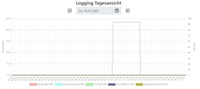

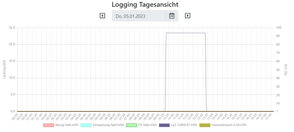

20230105,0,0,0,0,947327026.3671875000,0,0,0,0,0,0,0,0,0,0,0,0,0,0,0,0,0,0,0,0,0,0,0
Heute: 23909,97 kWh das wird teuer ...
