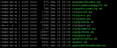

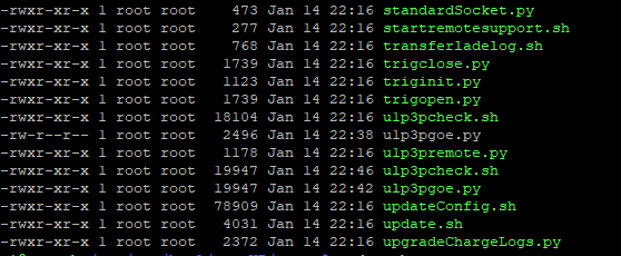

How come I have the exact same file ulp3pgoe.py in the "runs"-folder? (see picture attached) the grey one i cannot delet or edit.
Also I noticed, that the start page to load the graph stops at 42% and sometimes does not continue to load.
