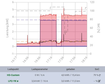

Re: Support: Manuell + Berechnung
Verfasst: Mo Jan 24, 2022 5:23 pm
von HSC
Habe hier auch ein neues feature in der 251 gefunden.
Hatte mich nachmittags über 0% im WB- Display gewundert. LP2 läuft über Berechnung.
Im neuen Ladevorgang habe ich dann direkt mal 90% gesetzt, inzwischen bin ich schon bei 109%....🤔
 2022-01-24 18:14:08: PID: 21773: SoC Manual: 90% + 2 kWh = 108.182%
2022-01-24 18:14:08: PID: 21773: SoC Manual: SoC-Gain: Charged (2 kWh) * efficiency (100%) / battery-size (11 kWh) = 18.2%
2022-01-24 18:14:08: PID: 21773: SoC Manual: Charged: 957 kWh -> 959 kWh = 2 kWh
2022-01-24 18:14:06: Lp1: Nothing to do yet. Incrementing timer. (LV1) at 74 main modules/soc_id/main.sh
2022-01-24 18:14:06: Lp1: timer = 1020 (LV1) at 69 main modules/soc_id/main.sh
2022-01-24 18:13:59: PID: 20209: SoC Manual: 90% + 2 kWh = 108.182%
2022-01-24 18:13:59: PID: 20209: SoC Manual: SoC-Gain: Charged (2 kWh) * efficiency (100%) / battery-size (11 kWh) = 18.2%
2022-01-24 18:13:59: PID: 20209: SoC Manual: Charged: 957 kWh -> 959 kWh = 2 kWh
2022-01-24 18:13:57: Lp1: Nothing to do yet. Incrementing timer. (LV1) at 74 main modules/soc_id/main.sh
2022-01-24 18:13:57: Lp1: timer = 1019 (LV1) at 69 main modules/soc_id/main.sh
2022-01-24 18:13:48: PID: 18680: SoC Manual: 90% + 1 kWh = 99.0909%
😳 knapp 140 % nun ...
