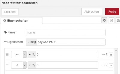

Ich wollte da gerne 2 Topics raus bauen, was auch klappt: mit "Switch": aber leider wird der jeweils letzte Wert beim Wechsel zwischen + und - bzw. - und + gespeichert, so dass meine Datenbank natürlich nur Mist bekäme.

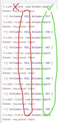

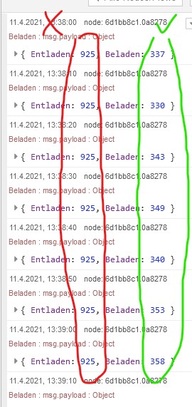

So sieht das aus: Wie schaffe ich es, dass immer der jeweils nicht akutelle Wert = 0 gesetzt wird ?

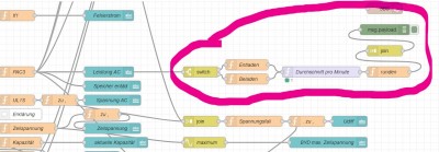

Hier der Flow:
[{"id":"52afd055.a836a8","type":"function","z":"9f6752b0.b55988","name":"PAC3","func":"msg.payload = msg.payload.PAC3;\nmsg.topic = \"PAC3\";\nreturn msg;","outputs":1,"noerr":0,"initialize":"","finalize":"","x":830,"y":1940,"wires":[["61997a16.71aefc","3ac6a532.5e5e5a","a8d64f72.66cf18","2e0cdfdb.db198","8ec4b63c.80096","6f07f889.bda788"]]},{"id":"b6efc276.3b37","type":"switch","z":"9f6752b0.b55988","name":"","property":"payload.PAC3","propertyType":"msg","rules":[{"t":"gte","v":"0","vt":"num"},{"t":"lt","v":"0","vt":"num"}],"checkall":"true","repair":false,"outputs":2,"x":1350,"y":1940,"wires":[["4d18ea91.fe6d24"],["fbb45a39.7ca4d8"]]},{"id":"4d18ea91.fe6d24","type":"function","z":"9f6752b0.b55988","name":"Entladen","func":"msg.payload = msg.payload.PAC3;\nmsg.topic = \"Entladen\";\nreturn msg;","outputs":1,"noerr":0,"initialize":"","finalize":"","x":1480,"y":1920,"wires":[["b028ac79.76d8a"]]},{"id":"fbb45a39.7ca4d8","type":"function","z":"9f6752b0.b55988","name":"Beladen","func":"msg.payload = (msg.payload.PAC3 * -1);\nmsg.topic = \"Beladen\";\nreturn msg;","outputs":1,"noerr":0,"initialize":"","finalize":"","x":1480,"y":1960,"wires":[["b028ac79.76d8a"]]},{"id":"b028ac79.76d8a","type":"calculate","z":"9f6752b0.b55988","name":"Durchschnitt pro Minute","pauseType":"timed","calculation":"average","timeout":"10","timeoutUnits":"seconds","rate":"10","x":1690,"y":1940,"wires":[["f01d2ea8.e59cb"]]},{"id":"f01d2ea8.e59cb","type":"function","z":"9f6752b0.b55988","name":"runden","func":"var temp = msg.payload\nmsg.payload = parseFloat(temp.toFixed(0));\nreturn msg;","outputs":1,"noerr":0,"initialize":"","finalize":"","x":1880,"y":1940,"wires":[["e2b13662.528b18"]]},{"id":"e2b13662.528b18","type":"join","z":"9f6752b0.b55988","name":"","mode":"custom","build":"object","property":"payload","propertyType":"msg","key":"topic","joiner":"\\n","joinerType":"str","accumulate":true,"timeout":"","count":"1","reduceRight":false,"reduceExp":"","reduceInit":"","reduceInitType":"","reduceFixup":"","x":1870,"y":1880,"wires":[["6d1bb8c1.0a8278"]]},{"id":"6d1bb8c1.0a8278","type":"debug","z":"9f6752b0.b55988","name":"","active":true,"tosidebar":true,"console":false,"tostatus":false,"complete":"false","statusVal":"","statusType":"auto","x":1870,"y":1820,"wires":[]}]
die beiden Funktionen "Beladen" und "Entladen" machen bloß Topic =... und beim einen *-1
Durchschnitt sollte sich von selbst erklären, Durchschnitt pro Minute (steht gerade auf 10s) und anschließend runden.
Danach durch "join" ein Objekt für InfluxDB.

Wie schon vermutet, sind die Funktion-Nodes nicht wirklich notwendig, sondern könnten durch Change-Nodes ersetzt werden (warum wollen immer Alle programmieren, in NR?).
Für influx fehlt das Timestamp, zumindest sehe ich es nicht.
Warum willst Du aus den Rohdatren einen Mittelwert bauen und den dann in die influxDB paclen?
Ich würde die Rohdaten da reinlaufen lassen und die Mittelwertbildung von Influx bei der Abfrage / Query nutzen....hast Du Platzproblme am Speicherort?

- ...aus welcher Bibliothek ist der Node für die Mittelwert-Bildung (calculate)?
- Könntest Du: den msg-Output des Debig mal mit vollständigem msg-Objekt zeigen?
- Kannst Du eine Demo-Nachricht aus dem PAC3-Nodes bzw als Eingang für den Switch-Node bereitstellen?
- Bis Du sicher, das der Switch-Node funktioniert (wird der Wert der Payload (payload.PAC3) auch als numerischer Wert erkannt?) und was passiert, wenn Du im Switch-Node sagst "Nach erster Übereinstimmung stoppen"

Wie gesagt, ich denke das "Problem" ist, dass Du die Wechsel zwischen be- und entladen nicht unterscheiden kannst, aus zwei Gründen:
- Du baust einen Mittelwert aus allen Nachrichten innerhalb des Intervals, egal ob Be- oder Entladung
- der Join Node nimmt immer zwei Mittelwert-Msg, ebenfalls egal, was drin steht
...wenn in diesem Intervall (2 Mittelwert-Intervalle) ein Wechsel stattfindet, bekommst Du es nicht mit, bzw. es ist dann halt jeweils enthalten und eben - da Du keine Timestamps hast - sieht es so aus, als ob es zeitgleich ist.
Deine vermutlich getroffene Annahme, dass ein Wechsel zwischen be- und entladen nicht so häufig erfolgt ist wohl falsch.
Mein Flow mit dem random Generatior treibt das zuzusagen auf die Spitze und daher erhält man gleich "Dein Problem"-Ergebnis.
