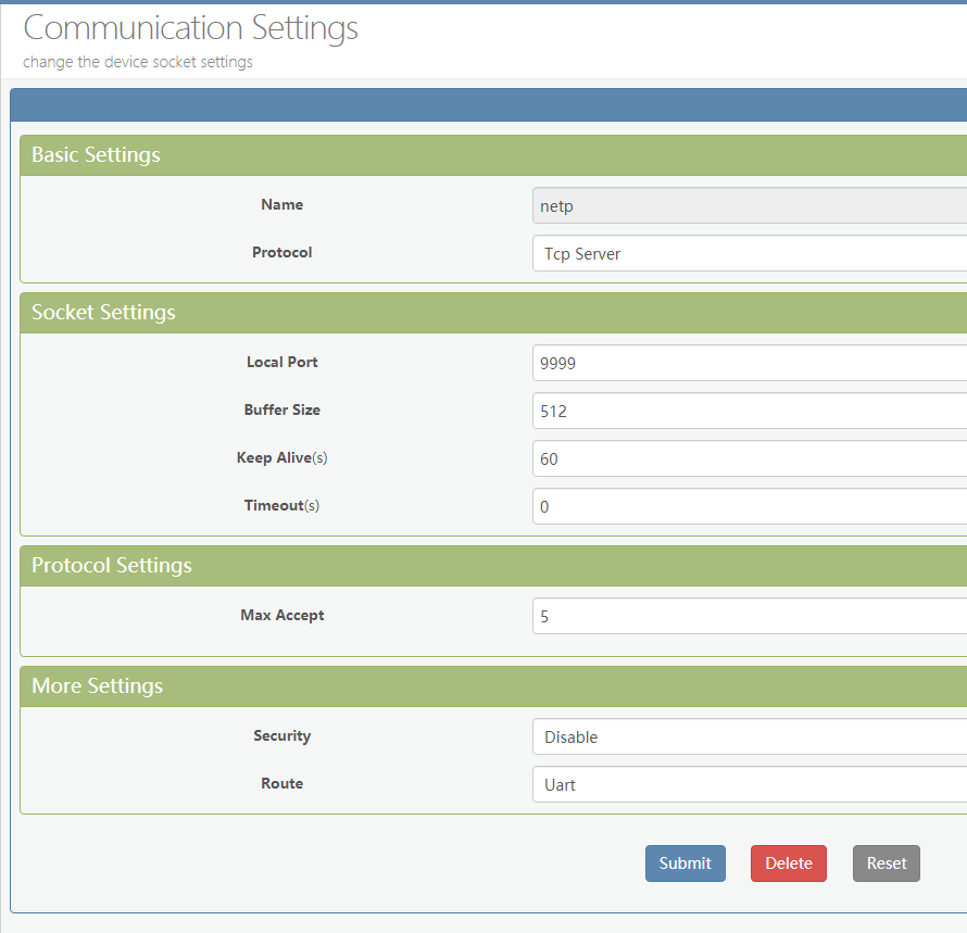

Hello!
I have one SDM630Modbus V2 for my EVSE-WIFI, connected to a Protoss PE11-H Modbus- > TCP converter.
That changes I must do to the Protoss configuration?
Thank you.
Here are my settings. Do I need to change something?
Thank you!

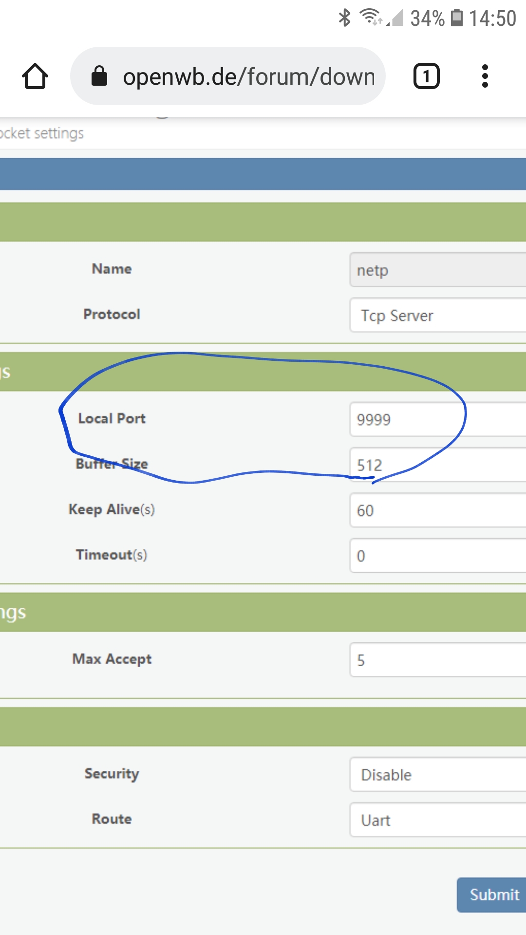

Here is a problem:
Wait pleace 1 min....
Re: Protoss PE11-H configuration ?

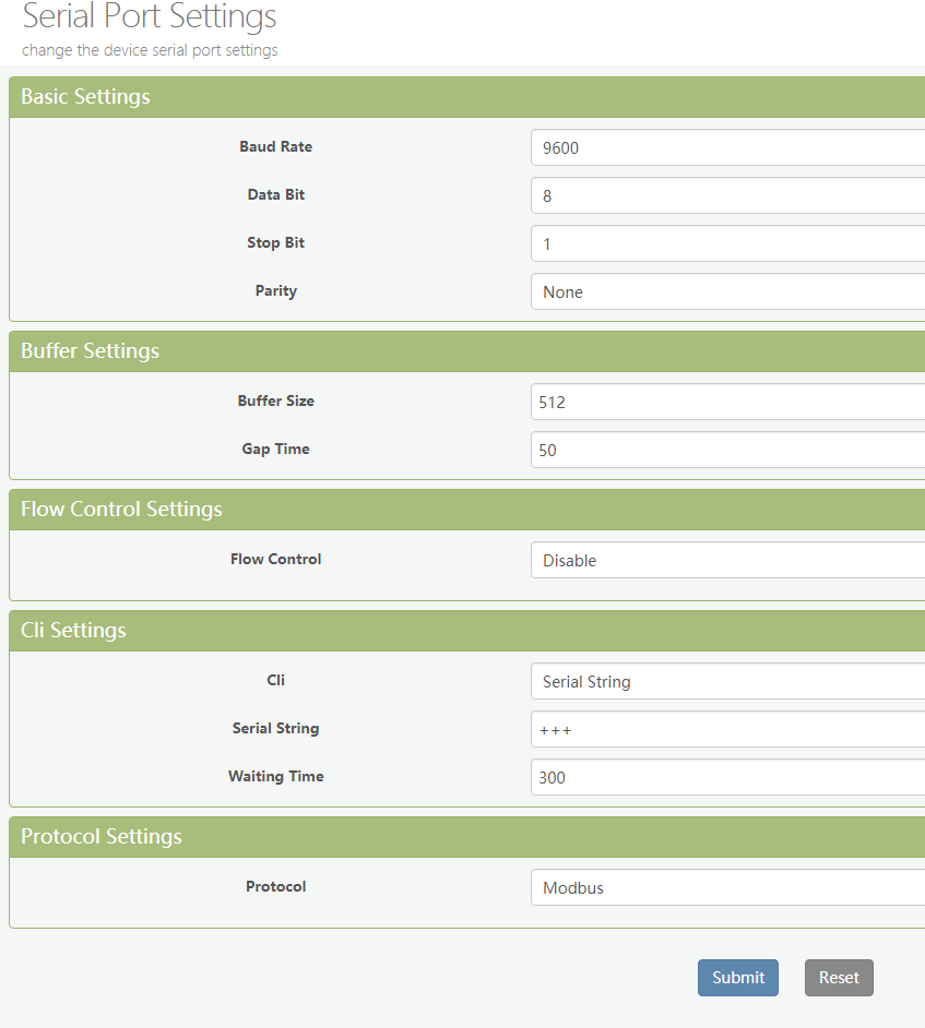

There is a .pdf:
viewtopic.php?p=45047#p45047
The same konfig for the sdm 630: 9600, ID xxx, none.

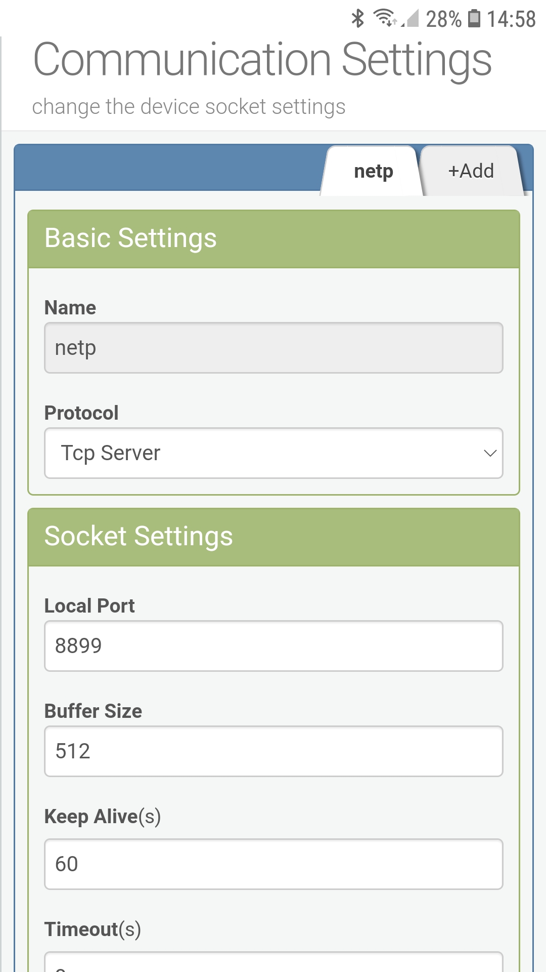

So
Local port: 8899
Thank you

That depends which which module you want to use it.
8899 is usually used in openWB, but you are referencing EVSE Wifi.
Best regards
For what or in which module do you want to use the SDM 630?
Will it be used with openWB software?
Many greetings

I will try OpenWB and EVCC.
Beiträge: 4567
Has thanked: 12 times
Been thanked: 52 times
To use it in openWB as a meter to measure the powerflow from or to the grid, you have to use it as
EVU Kit type SDM and that needs a special setup of the IP address and of the unit_id.
IPAddress: 192.168.193.15
Port: 8899
Unit_id: 115
Best regards
