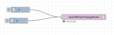

Wie das im ioBroker geht, kann ich Dir nicht sagen. Hier ein kleiner nodeRED-Flow, der den ChargeMode von PV (2) auf Sofort (0) schalten kann, je nachdem, auf welche Inject-Node man klickt:
[{"id":"6c76caae.65dee4","type":"tab","label":"Flow 2","disabled":false,"info":""},{"id":"5503e017.e3572","type":"inject","z":"6c76caae.65dee4","name":"","props":[{"p":"payload"},{"p":"topic","vt":"str"}],"repeat":"","crontab":"","once":false,"onceDelay":0.1,"topic":"","payload":"2","payloadType":"num","x":200,"y":200,"wires":[["c1808442.e83688"]]},{"id":"c1808442.e83688","type":"mqtt out","z":"6c76caae.65dee4","name":"","topic":"openWB/set/ChargeMode","qos":"","retain":"","broker":"978968c8.7b5238","x":550,"y":180,"wires":[]},{"id":"2e892f52.a41f7","type":"inject","z":"6c76caae.65dee4","name":"","props":[{"p":"payload"},{"p":"topic","vt":"str"}],"repeat":"","crontab":"","once":false,"onceDelay":0.1,"topic":"","payload":"0","payloadType":"num","x":210,"y":140,"wires":[["c1808442.e83688"]]},{"id":"978968c8.7b5238","type":"mqtt-broker","name":"OpenWB","broker":"192.168.8.11","port":"1883","clientid":"","usetls":false,"compatmode":false,"keepalive":"30","cleansession":true,"birthTopic":"","birthQos":"0","birthRetain":"false","birthPayload":"","closeTopic":"","closeQos":"0","closeRetain":"false","closePayload":"","willTopic":"","willQos":"0","willRetain":"false","willPayload":""}]
Die openWB funktioniert also, es scheint mir hier am ioBroker zu liegen, bei dem nicht ganz klar ist, wie man in ein Topic Werte geschrieben bekommt.
