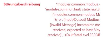

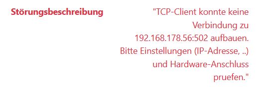

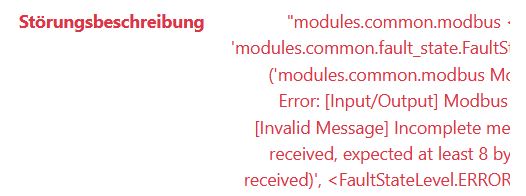

Hallo Lutz,
so hier nochmal alles auf einen Blick:
Fehler-Log:
2022-01-25 12:10:05: **** Regulation loop needs 4 seconds (LV0) at 55 cleanup /var/www/html/openWB/regel.sh
2022-01-25 12:10:04: ##### cron5min.sh finished ##### (LV0) at 426 main /var/www/html/openWB/runs/cron5min.sh
2022-01-25 12:10:04: chargestatlp1 0	chargestatlp2 0	chargestatlp3 0 (LV1) at 1275 loadvars loadvars.sh
2022-01-25 12:10:04: plugstatlp1 0	plugstatlp2 0	plugstatlp3 0 (LV1) at 1274 loadvars loadvars.sh
2022-01-25 12:10:04: lp1enabled 1	lp2enabled 1	lp3enabled 1 (LV1) at 1273 loadvars loadvars.sh
2022-01-25 12:10:04: EVU 1:V/0A 2: V/0A 3: V/0A (LV1) at 1272 loadvars loadvars.sh
2022-01-25 12:10:04: lla3 0	llv3 230.8	llas13  llas23  soclp1 70 soclp2 (LV1) at 1271 loadvars loadvars.sh
2022-01-25 12:10:04: lla2 0	llv2 230.1	llas12  llas22  sofortll 16 hausverbrauch 0 wattbezug -22 uberschuss 1397 (LV1) at 1270 loadvars loadvars.sh
2022-01-25 12:10:04: lla1 0	llv1 229.6	llas11  llas21  mindestuberschuss 1500 abschaltuberschuss 5 lademodus 3 (LV1) at 1269 loadvars loadvars.sh
2022-01-25 12:10:04: pv1watt -1380 pv2watt  pvwatt -1380 ladeleistung 0 llalt 0 nachtladen 0 nachtladen 0 minimalA 10 maximalA 32 (LV1) at 1268 loadvars loadvars.sh
2022-01-25 12:10:04: speicherleistung 1375 speichersoc 12 (LV1) at 1263 loadvars loadvars.sh
2022-01-25 12:10:04: EVU RET: 0 (LV2) at 21 main modules/bezug_siemens/main.sh
2022-01-25 12:10:04: PID: 2499: legacy run server: Completed running command in 0.05s: ["modules.siemens.device","counter","192.168.178.56"]
2022-01-25 12:10:04: PID: 2499: ValueStore: Saving CounterState(currents=[0.0, 0.0, 0.0], power=-22, voltages=[230, 230, 230], exported=4177.292116261986, powers=[0, 0, 0], frequency=50, power_factors=[0, 0, 0], imported=59677.04944444444)
2022-01-25 12:10:04: PID: 2499: root: Siemens Zähler Leistung[W]: -22
2022-01-25 12:10:04: PID: 2499: root: simcount Zwischenergebnisse atkuelle Berechnung: Import: 214837378 Export: 15038251.618543148 Power: -22
2022-01-25 12:10:04: PID: 2499: root: simcount Ergebnis: Bezug[Wh]: 59677.04944444444, Einspeisung[Wh]: 4177.292116261986
2022-01-25 12:10:04: PID: 2499: root: simcount aufsummierte Energie: Bezug[Ws]: 214837378, Einspeisung[Ws]: 15038251.618543148
2022-01-25 12:10:04: PID: 2499: root: simcount Gesamtenergie im Zeitintervall: -288.61854314804077
2022-01-25 12:10:04: PID: 2499: root: simcount Berechnungsgrundlage: vergangene Zeit [s]19.241236209869385, vorherige Leistung[W]: -8, aktuelle Leistung[W]: -22
2022-01-25 12:10:04: PID: 2499: root: simcount Zwischenergebnisse letzte Berechnung: Import: 214837378 Export: 15037963 Power: -8
2022-01-25 12:10:04: PID: 2499: pymodbus.payload: [b'\xff\xff', b'\xff\xea']
2022-01-25 12:10:04: PID: 2499: pymodbus.payload: [65535, 65514]
2022-01-25 12:10:04: PID: 2499: pymodbus.transaction: Changing transaction state from 'PROCESSING REPLY' to 'TRANSACTION_COMPLETE'
2022-01-25 12:10:04: PID: 2499: pymodbus.transaction: Getting transaction 1
2022-01-25 12:10:04: PID: 2499: pymodbus.transaction: Adding transaction 1
2022-01-25 12:10:04: PID: 2499: pymodbus.factory: Factory Response[ReadHoldingRegistersResponse: 3]
2022-01-25 12:10:04: PID: 2499: pymodbus.framer.socket_framer: Processing: 0x0 0x1 0x0 0x0 0x0 0x7 0x1 0x3 0x4 0xff 0xff 0xff 0xea
2022-01-25 12:10:04: PID: 2499: pymodbus.transaction: RECV: 0x0 0x1 0x0 0x0 0x0 0x7 0x1 0x3 0x4 0xff 0xff 0xff 0xea
2022-01-25 12:10:04: PID: 2499: pymodbus.transaction: Changing transaction state from 'WAITING FOR REPLY' to 'PROCESSING REPLY'
2022-01-25 12:10:04: PID: 2499: pymodbus.transaction: Changing transaction state from 'SENDING' to 'WAITING FOR REPLY'
2022-01-25 12:10:04: PID: 2499: pymodbus.client.sync: New Transaction state 'SENDING'
2022-01-25 12:10:04: PID: 2499: pymodbus.transaction: SEND: 0x0 0x1 0x0 0x0 0x0 0x6 0x1 0x3 0x0 0xe 0x0 0x2
2022-01-25 12:10:04: PID: 2499: pymodbus.transaction: Running transaction 1
2022-01-25 12:10:04: PID: 2499: pymodbus.transaction: Current transaction state - IDLE
2022-01-25 12:10:04: PID: 2499: root: Komponente Siemens Zähler auslesen.
2022-01-25 12:10:04: PID: 2499: root: Start device reading{'componentNone': <modules.siemens.counter.SiemensCounter object at 0x73d681d0>}
2022-01-25 12:10:04: PID: 2499: root: Siemens IP-Adresse: 192.168.178.56
2022-01-25 12:10:04: PID: 2499: legacy run server: Received command ["modules.siemens.device","counter","192.168.178.56"]
2022-01-25 12:10:04: logfile cleanup triggered (LV1) at 423 main /var/www/html/openWB/runs/cron5min.sh
    pf2 = struct.unpack('>f',struct.pack('>HH',*resp.registers))[0]
  File "/var/www/html/openWB/modules/mpm3pmll/readmpm3pm.py", line 165, in <module>
2022-01-25 12:10:02: BAT RET: 0 (LV2) at 21 main modules/speicher_siemens/main.sh
2022-01-25 12:10:02: PID: 2499: legacy run server: Completed running command in 0.07s: ["modules.siemens.device","bat","192.168.178.56"]
2022-01-25 12:10:02: PID: 2499: ValueStore: Saving BatState(exported=37260016.97111111, soc=12, power=1375, imported=14423.773483550614)
2022-01-25 12:10:02: PID: 2499: root: simcount Zwischenergebnisse atkuelle Berechnung: Import: 51925584.54078221 Export: 134136061096 Power: 1375
2022-01-25 12:10:02: PID: 2499: root: simcount Ergebnis: Bezug[Wh]: 14423.773483550614, Einspeisung[Wh]: 37260016.97111111
2022-01-25 12:10:02: PID: 2499: root: simcount aufsummierte Energie: Bezug[Ws]: 51925584.54078221, Einspeisung[Ws]: 134136061096
2022-01-25 12:10:02: PID: 2499: root: simcount Gesamtenergie im Zeitintervall: 25535.54078221321
2022-01-25 12:10:02: PID: 2499: root: simcount Berechnungsgrundlage: vergangene Zeit [s]18.331328630447388, vorherige Leistung[W]: 1411, aktuelle Leistung[W]: 1375
2022-01-25 12:10:02: PID: 2499: root: simcount Zwischenergebnisse letzte Berechnung: Import: 51900049 Export: 134136061096 Power: 1411
2022-01-25 12:10:02: PID: 2499: pymodbus.payload: [b'\x00\x00', b'\x00\x0c']
2022-01-25 12:10:02: PID: 2499: pymodbus.payload: [0, 12]
2022-01-25 12:10:02: PID: 2499: pymodbus.transaction: Changing transaction state from 'PROCESSING REPLY' to 'TRANSACTION_COMPLETE'
2022-01-25 12:10:02: PID: 2499: pymodbus.transaction: Getting transaction 2
2022-01-25 12:10:02: PID: 2499: pymodbus.transaction: Adding transaction 2
2022-01-25 12:10:02: PID: 2499: pymodbus.factory: Factory Response[ReadHoldingRegistersResponse: 3]
2022-01-25 12:10:02: PID: 2499: pymodbus.framer.socket_framer: Processing: 0x0 0x2 0x0 0x0 0x0 0x7 0x1 0x3 0x4 0x0 0x0 0x0 0xc
2022-01-25 12:10:02: PID: 2499: pymodbus.transaction: RECV: 0x0 0x2 0x0 0x0 0x0 0x7 0x1 0x3 0x4 0x0 0x0 0x0 0xc
2022-01-25 12:10:02: PID: 2499: pymodbus.transaction: Changing transaction state from 'WAITING FOR REPLY' to 'PROCESSING REPLY'
2022-01-25 12:10:02: PID: 2499: pymodbus.transaction: Changing transaction state from 'SENDING' to 'WAITING FOR REPLY'
2022-01-25 12:10:02: PID: 2499: pymodbus.client.sync: New Transaction state 'SENDING'
2022-01-25 12:10:02: PID: 2499: pymodbus.transaction: SEND: 0x0 0x2 0x0 0x0 0x0 0x6 0x1 0x3 0x0 0x8 0x0 0x2
2022-01-25 12:10:02: PID: 2499: pymodbus.transaction: Running transaction 2
2022-01-25 12:10:02: PID: 2499: pymodbus.transaction: Current transaction state - TRANSACTION_COMPLETE
2022-01-25 12:10:02: PID: 2499: pymodbus.payload: [b'\xff\xff', b'\xfa\xa1']
2022-01-25 12:10:02: PID: 2499: pymodbus.payload: [65535, 64161]
2022-01-25 12:10:02: PID: 2499: pymodbus.transaction: Getting transaction 1
2022-01-25 12:10:02: PID: 2499: pymodbus.transaction: Adding transaction 1
2022-01-25 12:10:02: PID: 2499: pymodbus.framer.socket_framer: Processing: 0x0 0x1 0x0 0x0 0x0 0x7 0x1 0x3 0x4 0xff 0xff 0xfa 0xa1
2022-01-25 12:10:02: PID: 2499: pymodbus.transaction: RECV: 0x0 0x1 0x0 0x0 0x0 0x7 0x1 0x3 0x4 0xff 0xff 0xfa 0xa1
2022-01-25 12:10:02: PID: 2499: pymodbus.transaction: SEND: 0x0 0x1 0x0 0x0 0x0 0x6 0x1 0x3 0x0 0x6 0x0 0x2
2022-01-25 12:10:02: PID: 2499: pymodbus.transaction: Running transaction 1
2022-01-25 12:10:02: PID: 2499: pymodbus.transaction: Current transaction state - IDLE
2022-01-25 12:10:02: PID: 2499: root: Komponente Siemens Speicher auslesen.
2022-01-25 12:10:02: PID: 2499: root: Start device reading{'componentNone': <modules.siemens.bat.SiemensBat object at 0x73d68950>}
2022-01-25 12:10:02: PID: 2499: root: Siemens IP-Adresse: 192.168.178.56
2022-01-25 12:10:02: starting evsecheck (LV1) at 419 main /var/www/html/openWB/runs/cron5min.sh
2022-01-25 12:10:02: PID: 2499: legacy run server: Received command ["modules.siemens.device","bat","192.168.178.56"]
2022-01-25 12:10:02: PID: 2499: legacy run server: Completed running command in 0.02s: ["modules.siemens.device","inverter","192.168.178.56","1"]
modules.common.fault_state.FaultState: ('TCP-Client konnte keine Verbindung zu 192.168.178.56:502 aufbauen. Bitte Einstellungen (IP-Adresse, ..) und Hardware-Anschluss pruefen.', <FaultStateLevel.ERROR: 2>)
" aufbauen. Bitte Einstellungen (IP-Adresse, ..) und " + "Hardware-Anschluss pruefen.") from e
File "/var/www/html/openWB/packages/modules/common/modbus.py", line 89, in __read_registers
File "/var/www/html/openWB/packages/modules/common/modbus.py", line 115, in read_holding_registers
power = self.__tcp_client.read_holding_registers(16, ModbusDataType.INT_32, unit=1) * -1
File "/var/www/html/openWB/packages/modules/siemens/inverter.py", line 37, in update
self._components[component].update()
File "/var/www/html/openWB/packages/modules/siemens/device.py", line 55, in update
pymodbus.exceptions.ConnectionException: Modbus Error: [Connection] Failed to connect[ModbusTcpClient(192.168.178.56:502)]
File "/usr/local/lib/python3.5/dist-packages/pymodbus/client/sync.py", line 107, in execute
return self.execute(request)
File "/usr/local/lib/python3.5/dist-packages/pymodbus/client/common.py", line 114, in read_holding_registers
address, number_of_addresses, **kwargs)
File "/var/www/html/openWB/packages/modules/common/modbus.py", line 79, in __read_registers
2022-01-25 12:10:02: PID: 2499: root: Siemens Wechselrichter: FaultState FaultStateLevel.ERROR, FaultStr TCP-Client konnte keine Verbindung zu 192.168.178.56:502 aufbauen. Bitte Einstellungen (IP-Adresse, ..) und Hardware-Anschluss pruefen., Traceback:
2022-01-25 12:10:02: PID: 2499: pymodbus.client.sync: Connection to (192.168.178.56, 502) failed: [Errno 111] Connection refused
2022-01-25 12:10:02: PID: 2499: root: Komponente Siemens Wechselrichter auslesen.
2022-01-25 12:10:02: PID: 2499: root: Start device reading{'component1': <modules.siemens.inverter.SiemensInverter object at 0x768f3f50>}
2022-01-25 12:10:02: PID: 2499: legacy run server: Received command ["modules.siemens.device","inverter","192.168.178.56","1"]
2022-01-25 12:10:02:  Load: 3.50 3.08 2.08
2022-01-25 12:10:02: pingcheck configured; starting (LV1) at 409 main /var/www/html/openWB/runs/cron5min.sh
2022-01-25 12:10:02: modbus tcp server already running (LV1) at 401 main /var/www/html/openWB/runs/cron5min.sh
2022-01-25 12:10:01: external openWB or daemon mode not configured; checking network setup (LV1) at 336 main /var/www/html/openWB/runs/cron5min.sh
2022-01-25 12:10:01: smarthome handler is already running (LV1) at 319 main /var/www/html/openWB/runs/cron5min.sh
2022-01-25 12:10:01: legacy_run_server is already running (LV1) at 313 main /var/www/html/openWB/runs/cron5min.sh
2022-01-25 12:10:01: mqtt handler is already running (LV1) at 300 main /var/www/html/openWB/runs/cron5min.sh
2022-01-25 12:10:01: current ip: 192.168.178.114 (LV1) at 295 main /var/www/html/openWB/runs/cron5min.sh
2022-01-25 12:10:01: updating daily yield stats (LV1) at 165 main /var/www/html/openWB/runs/cron5min.sh
2022-01-25 12:10:01: electricity provider not set up; skipping price update (LV2) at 161 main /var/www/html/openWB/runs/cron5min.sh
2022-01-25 12:10:01: Netzschutz konfiguriert; aktuelle Frequenz: 4995 (LV1) at 110 main /var/www/html/openWB/runs/cron5min.sh
2022-01-25 12:10:01: daily csv updated: /var/www/html/openWB/web/logging/data/daily/20220125.csv (LV1) at 102 main /var/www/html/openWB/runs/cron5min.sh
2022-01-25 12:10:01: ##### cron5min.sh started ##### (LV0) at 23 main /var/www/html/openWB/runs/cron5min.sh
2022-01-25 12:10:01: **** Regulation loop start **** (LV1) at 70 main /var/www/html/openWB/regel.sh
2022-01-25 12:09:56: **** Regulation loop needs 5 seconds (LV0) at 55 cleanup /var/www/html/openWB/regel.sh
2022-01-25 12:09:55: PID: 2499: legacy run server: Completed running command in 3.04s: ["modules.siemens.device","inverter","192.168.178.56","1"]
modules.common.fault_state.FaultState: ("modules.common.modbus <class 'modules.common.fault_state.FaultState'> ('modules.common.modbus Modbus Error: [Input/Output] Modbus Error: [Invalid Message] Incomplete message received, expected at least 8 bytes (0 received)', <FaultStateLevel.ERROR: 2>)", <FaultStateLevel.ERROR: 2>)
str(e)) from e
File "/var/www/html/openWB/packages/modules/common/modbus.py", line 97, in __read_registers
modules.common.fault_state.FaultState: ('modules.common.modbus Modbus Error: [Input/Output] Modbus Error: [Invalid Message] Incomplete message received, expected at least 8 bytes (0 received)', <FaultStateLevel.ERROR: 2>)
File "/var/www/html/openWB/packages/modules/common/modbus.py", line 81, in __read_registers
2022-01-25 12:09:55: PID: 2499: root: Siemens Wechselrichter: FaultState FaultStateLevel.ERROR, FaultStr modules.common.modbus <class 'modules.common.fault_state.FaultState'> ('modules.common.modbus Modbus Error: [Input/Output] Modbus Error: [Invalid Message] Incomplete message received, expected at least 8 bytes (0 received)', <FaultStateLevel.ERROR: 2>), Traceback:
2022-01-25 12:09:55: PID: 2499: pymodbus.transaction: Changing transaction state from 'PROCESSING REPLY' to 'TRANSACTION_COMPLETE'
2022-01-25 12:09:55: PID: 2499: pymodbus.transaction: Getting transaction 1
2022-01-25 12:09:55: PID: 2499: pymodbus.framer.socket_framer: Processing:
2022-01-25 12:09:55: PID: 2499: pymodbus.transaction: Transaction failed. (Modbus Error: [Invalid Message] Incomplete message received, expected at least 8 bytes (0 received))

2022-01-25 12:09:54: PID: 2499: root: Siemens Zähler: FaultState FaultStateLevel.ERROR, FaultStr TCP-Client konnte keine Verbindung zu 192.168.178.56:502 aufbauen. Bitte Einstellungen (IP-Adresse, ..) und Hardware-Anschluss pruefen., Traceback:
2022-01-25 12:09:54: PID: 2499: pymodbus.client.sync: Connection to (192.168.178.56, 502) failed: [Errno 111] Connection refused

2022-01-25 12:09:42: PID: 2499: root: Siemens Wechselrichter: FaultState FaultStateLevel.ERROR, FaultStr TCP-Client konnte keine Verbindung zu 192.168.178.56:502 aufbauen. Bitte Einstellungen (IP-Adresse, ..) und Hardware-Anschluss pruefen., Traceback:
2022-01-25 12:09:42: PID: 2499: pymodbus.client.sync: Connection to (192.168.178.56, 502) failed: [Errno 111] Connection refused
2022-01-25 12:09:42: PID: 2499: root: Komponente Siemens Wechselrichter auslesen.
2022-01-25 12:09:42: PID: 2499: root: Start device reading{'component1': <modules.siemens.inverter.SiemensInverter object at 0x7683ba10>}
2022-01-25 12:09:42: PID: 2499: root: Siemens IP-Adresse: 192.168.178.56
2022-01-25 12:09:42: PID: 2499: legacy run server: Received command ["modules.siemens.device","inverter","192.168.178.56","1"]
2022-01-25 12:09:42: **** Regulation loop start **** (LV1) at 70 main /var/www/html/openWB/regel.sh
2022-01-25 12:09:36: **** Regulation loop needs 5 seconds (LV0) at 55 cleanup /var/www/html/openWB/regel.sh
2022-01-25 12:09:36: PID: 2499: legacy run server: Completed running command in 3.03s: ["modules.siemens.device","inverter","192.168.178.56","1"]
str(e)) from e
2022-01-25 12:09:36: PID: 2499: root: Siemens Wechselrichter: FaultState FaultStateLevel.ERROR, FaultStr modules.common.modbus <class 'modules.common.fault_state.FaultState'> ('modules.common.modbus Modbus Error: [Input/Output] Modbus Error: [Invalid Message] Incomplete message received, expected at least 8 bytes (0 received)', <FaultStateLevel.ERROR: 2>), Traceback:
2022-01-25 12:09:36: PID: 2499: pymodbus.transaction: Changing transaction state from 'PROCESSING REPLY' to 'TRANSACTION_COMPLETE'
2022-01-25 12:09:36: PID: 2499: pymodbus.transaction: Getting transaction 1
2022-01-25 12:09:36: PID: 2499: pymodbus.framer.socket_framer: Processing:
2022-01-25 12:09:36: PID: 2499: pymodbus.transaction: Transaction failed. (Modbus Error: [Invalid Message] Incomplete message received, expected at least 8 bytes (0 received))
power = self.__tcp_client.read_holding_registers(14, ModbusDataType.INT_32, unit=1)
File "/var/www/html/openWB/packages/modules/siemens/counter.py", line 37, in update
2022-01-25 12:09:34: PID: 2499: root: Siemens Zähler: FaultState FaultStateLevel.ERROR, FaultStr TCP-Client konnte keine Verbindung zu 192.168.178.56:502 aufbauen. Bitte Einstellungen (IP-Adresse, ..) und Hardware-Anschluss pruefen., Traceback:
2022-01-25 12:09:34: PID: 2499: pymodbus.client.sync: Connection to (192.168.178.56, 502) failed: [Errno 111] Connection refused
2022-01-25 12:09:34: PID: 2499: root: Komponente Siemens Zähler auslesen.
2022-01-25 12:09:34: PID: 2499: root: Start device reading{'componentNone': <modules.siemens.counter.SiemensCounter object at 0x73da4b50>}
2022-01-25 12:09:34: PID: 2499: root: Siemens IP-Adresse: 192.168.178.56
2022-01-25 12:09:34: PID: 2499: legacy run server: Received command ["modules.siemens.device","counter","192.168.178.56"]

•Die IP der Batterie ist 192.168.178.56. Das ist sie auch, ist zum einen mehrfach überprüft, zum anderen haben alle Geräte die irgendwie an Smarthome beteiligt sind die gleiche IP
•Alle hängen im selben Netzwerk
•Die Batterie funktioniert einwandfrei, Modbus auf dieser Seite wurde überprüft. Die Hardware kann ich also sehr sicher ausschließen.
•Mehrfache Neustarts brachten keinen Erfolg
•Die Abfrage friert tatsächlich einfach öfter ein: Es kommen schon ab und an Werte, aber dann wieder plötzlich gar nichts und ich bekomme den Fehler:
oder auch diesen
Die Fehler traten zu 99% erst nach dem Update auf die Nightly 251 auf (ich nutze die Android-App von Philipp und checke die Mehrfach täglich und da wäre mir aufgefallen, wenn Werte nicht passen (z.B. Nachts 1,5 kW PV Leistung so wie jetzt manchmal wenn der Wert nicht aktualisiert wird).
Was auch interessant scheint: Wenn das eine geht, geht das andere nicht.... gestern habe ich PV Daten bekommen, aber keine Batterie Daten (SoC etc). Heute geht Batterie, dafür spuckt ein anderes Modbus Register den Fehler aus.
Vor den Update lief alles reibungslos, ich muss eigentlich jeden Tag Wäsche waschen und schaue daher im Smarthomelog nach wie die Anschlaltbedingungen sind, da wäre mir ein Fehler auch aufgefallen.
Wenn ihr noch mehr zur Analyse braucht sagt einfach Bescheid, ich helfe wo ich kann!
