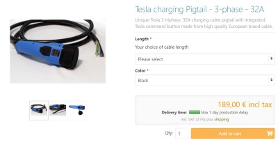

Würde folgendes Tesla Typ 2 Kabel mit der openWB funktionieren?
Produktbeschreibung:
This charging cable has a Type 2 female connector on one end of the cable, and an open end at the other end. This cable can be used in tethered charging stations, specifically those used for Tesla vehicles.
This pigtail has the Tesla Chargeport functionality, a seamlessly integrated waterproof button on the vehicle-side Type 2 connector, allowing you to open the chargeport, start and stop charging your Tesla or unlock the cable, without the need to enter the car first, or look for the keyfob. This is a unique feature found only on EVChargeKing cables!
The cable release of course only works when the car's keyfob is around! The cable will not unlock when the car's keyfob is not in the vincinity (same as at the superchargers).
The cable has 5 x 6mm² conductors, allowing 3 x 32A current, which represents a charging capacity of 22 kW.
Attention: You cannot connect a blue or red commando plug to this pigtail and charge from a commando socket. It can only be used in combination with a charging station! This pigtail also is not a standard replacement for the cable used in the Tesla Wallchargers, it can be used for that purpose but you need to perform a few extra steps, see this forum post: Change Charging Cable of Tesla Wall Connector
Standard length of the cable is 2 meter, but you can order any length you like by selecting the appropriate value in the dropdown selector. For lengths not specified in the list, just send us a message and we will quote you for your special request.
We don't use the typical Chinese cable, but a high quality European brand cable, that is 20% lighter and thinner while being more durable! The connectors have rustfree contacts. The electronics used are CE approved.
Don't forget to choose the right length when ordering! When the charging point is on the other side of the car's chargeport, you really need a minimum of 4 meter to be safe.
Specifications:
Connectors Type 2 female on vehicle side, open end at the other side.
Cable 3 - phase, 5 x 6mm² + 0.75mm², max electric power: 3 x 32A (22 kW charging capability)
Color Blue / Black

da es keine weitere Rückmeldung gab, möchte ich für alle die sich die gleiche Frage stellen es hier kurz dokumentieren:
Habe mir das 7m Kabel von evchargeking.com bestellt und heute in Betrieb genommen.
Das Kabel ist 1 zu 1 verwendbar. Es muss keine Modifikation vorgenommen werden und alles kann wie beim original openWB Kabel angeschlossen werden.
Jürgen

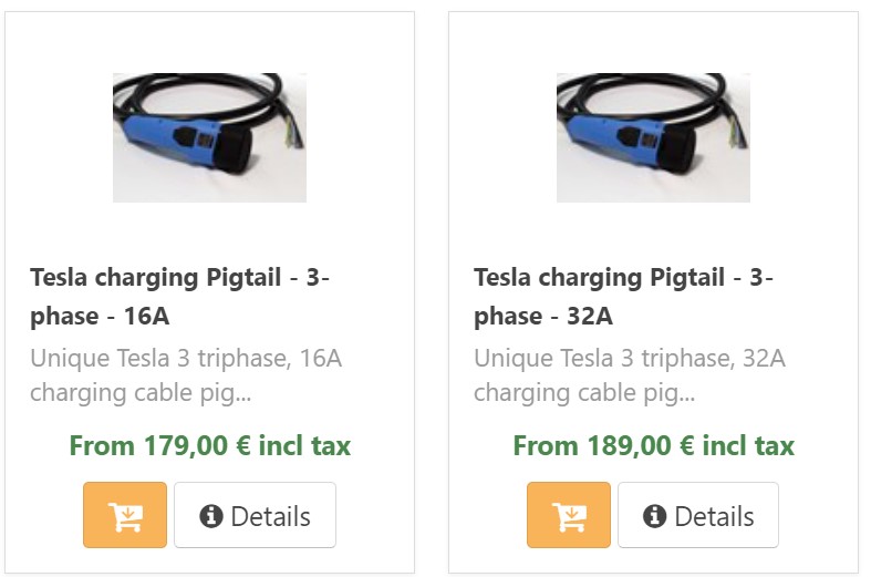

ich habe eine OpenWB Duo... Welches Kabel müsste ich dafür erwerben? 16A oder 32A?
Hatte es leider versäumt bei der damaligen Konfiguration einen Tesla-Stecker mitzubestellen. Aktuell kann man diese Option auch gar nicht mehr wählen?!
Beiträge: 4216
Has thanked: 20 times
Been thanked: 140 times
Re: Tesla Typ 2 Kabel kompatibel mit openWB?
Da die openWB immer für 32A ausgelegt ist, würde ich auch das Kabel entsprechend auslegen. Wenn Deine Box auf 11kW begrenzt ist und Du das auch nie ändern willst, reicht auch die 16A Variante.
Die Kabel sind übrigens nicht mehr im Shop, weil es andauernd Liefer- und Qualitätsprobleme gab. Persönlich halte ich das Feature für überbewertet. Bei meinem Model S habe ich eh den Fob in der Tasche, um den Ladeanschluss zu öffnen. Ich weiß natürlich nicht, wie es beim 3 oder Y aussieht. Die haben ja nur die Keycard.

enJOyIT hat geschrieben: Sa Apr 16, 2022 7:21 am Schade, dass das nicht mehr bestellbar ist.
bei EV Charge King sind die nach wie vor bestellbar. Nur direkt von openWB gibt es die Kabel nicht mehr.
Siehe: https://www.evchargeking.com/en/tesla-c ... -phase-32a
Innerhalb von 4 Tagen erhalten.
Die Qualität macht für mich einen guten Eindruck.
Übrigens ist der Preisunterschied zwischen 16A und 32A nur 10,- Euro. Da würde ich definitiv immer das 32A nehmen!
