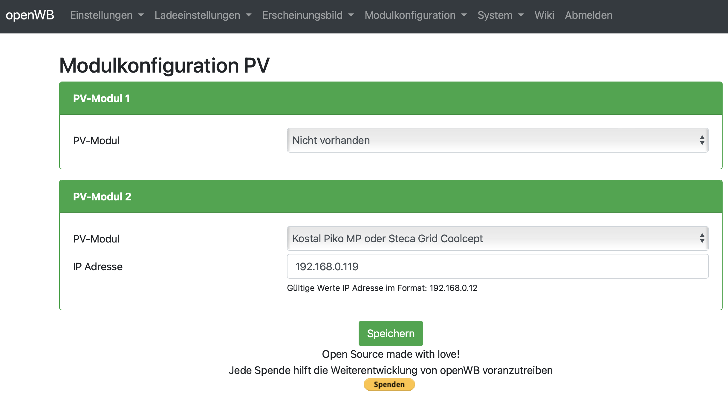

Zeig mal einen Screenshot der Konfiguration, die du gemacht hast

Die Konfiguration:

2022-06-29 14:26:22: PID: 2594: KostalSteca WR: YIELD: <?xml version='1.0' encoding='UTF-8'?><root><Device Name='PIKO 3.6 MP' Type='Inverter' Serial='755810BL006202240015' BusAddress='1' NetBiosName='INV006202240015' IpAddress='192.168.0.119' DateTime='2022-06-29T14:26:18'><Yields></Yields></Device></root>
2022-06-29 14:26:22: PID: 2594: requests.packages.urllib3.connectionpool: http://192.168.0.119:80 "GET /yields.xml HTTP/1.1" 200 None
2022-06-29 14:26:22: PID: 2594: requests.packages.urllib3.connectionpool: Starting new HTTP connection (1): 192.168.0.119:80
2022-06-29 14:26:22: PID: 2594: KostalSteca WR: PVWatt: -1240
2022-06-29 14:26:22: PID: 1243: RET: 0 (LV2) at 19 main modules/wr2_kostalsteca/main.sh
2022-06-29 14:26:22: PID: 2594: KostalSteca WR: measurements: <?xml version='1.0' encoding='UTF-8'?><root><Device Name='PIKO 3.6 MP' Type='Inverter' Serial='755810BL006202240015' BusAddress='1' NetBiosName='INV006202240015' IpAddress='192.168.0.119' DateTime='2022-06-29T14:26:18'><Measurements><Measurement Value='234.205' Unit='V' Type='AC_Voltage'/><Measurement Value='5.366' Unit='A' Type='AC_Current'/><Measurement Value='1240.010' Unit='W' Type='AC_Power'/><Measurement Value='49.987' Unit='Hz' Type='AC_Frequency'/><Measurement Value='429.118' Unit='V' Type='DC_Voltage'/><Measurement Value='2.874' Unit='A' Type='DC_Current'/><Measurement Value='1234.230' Unit='W' Type='DC_Power'/><Measurement Value='43.800' Unit='°C' Type='Temp'/><Measurement Value='nan' Unit='W' Type='Consumption PV'/><Measurement Value='nan' Unit='W' Type='Consumption Grid'/><Measurement Value='nan' Unit='W' Type='GridPower'/><Measurement Value='100.0' Unit='%' Type='Dearting'/></Measurements></Device></root>
2022-06-29 14:26:22: PID: 2594: requests.packages.urllib3.connectionpool: http://192.168.0.119:80 "GET /measurements.xml HTTP/1.1" 200 None
2022-06-29 14:26:22: PID: 2594: KostalSteca WR: PV Kostal Steca IP: 192.168.0.119
2022-06-29 14:26:22: PID: 2594: legacy run server: Received command ["wr2_kostalsteca.kostal_steca","192.168.0.119"]
2022-06-29 14:26:22: PID: 1243: PV IP: 192.168.0.119 (LV2) at 14 main modules/wr2_kostalsteca/main.sh
2022-06-29 14:26:21: PID: 1098: **** Regulation loop start **** (LV1) at 70 main /var/www/html/openWB/regel.shCode: Alles auswählen
<root>
<Device Name="PIKO 3.6 MP" Type="Inverter" Serial="755810BL006202240015" BusAddress="1" NetBiosName="INV006202240015" IpAddress="192.168.0.119" DateTime="2022-06-29T14:27:27">
<Yields/>
</Device>
</root>-
andlem
- Beiträge: 95
- Registriert: Mi Jun 29, 2022 9:06 am
- Been thanked: 12 times
Re: Welches Modul for Kostal Piko 3.6 MP?
Ich habe https://github.com/snaptec/openWB/issues/2268 erstellt. Kann ich sonst noch etwas tun, um das Problem zu lösen?
