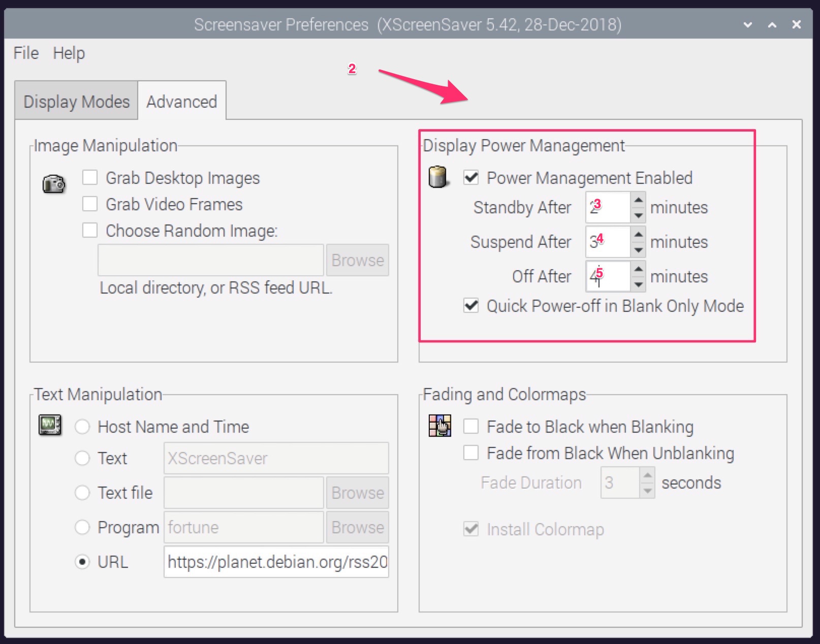

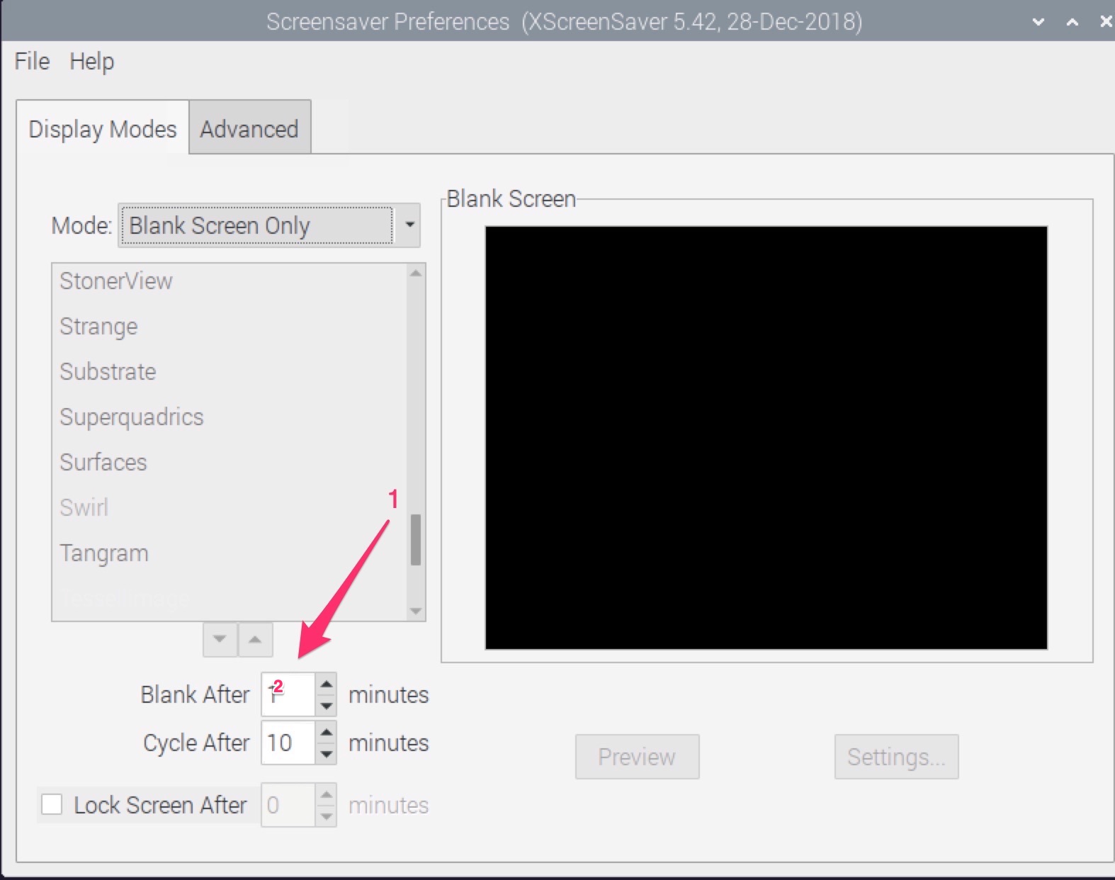

In the linux GUI, go to Start Button - Preferences - Xscreensaver.
Make the same settings as in the attached below pictures.
In Open WB settings, you can activate the LCD and display sleep.
