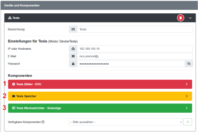

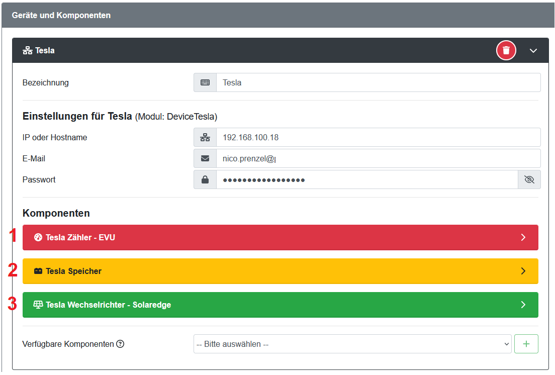

So, ich habe mir das mal jetzt etwas genauer angesehen und bin nun etwas über die vielen Abfragen an die Tesla Powerwall verwundert.
Speziell die Abfrage von .../api/meters/aggregates wird bei mir 3x in sehr kurzen Abständen durchgeführt.
Anbei ein Auszug aus der main.log:
2024-01-24 13:43:10,525 - {modules.devices.tesla.device:61} - {DEBUG:device0} - Beginning update
2024-01-24 13:43:10,526 - {modules.common.component_context:51} - {DEBUG:device0} - Update Komponenten ['Tesla Zähler - EVU', 'Tesla Speicher', 'Tesla Wechselrichter - Solaredge']
2024-01-24 13:43:10,529 - {modules.common.component_context:24} - {DEBUG:set values cp2} - Update Komponente ['Ladepunkt']
2024-01-24 13:43:10,555 - {urllib3.connectionpool:973} - {DEBUG:device0} - Starting new HTTPS connection (1): 192.168.100.18:443
2024-01-24 13:43:10,646 - {urllib3.connectionpool:452} - {DEBUG:device0} - https://192.168.100.18:443 "GET /api/meters/aggregates HTTP/1.1" 200 None
2024-01-24 13:43:10,652 - {modules.common.req:11} - {DEBUG:device0} - Get-Response: {"site":{"last_communication_time":"2024-01-24T13:43:10.550568108+01:00","instant_power":-49.60566711425781,"instant_reactive_power":289.4276657104492,"instant_apparent_power":293.64791143212665,"frequency":49.9873161315918,"energy_exported":3661340.331563209,"energy_imported":4850455.101542912,"instant_average_voltage":323.6488353488817,"instant_average_current":6.6265,"i_a_current":0,"i_b_current":0,"i_c_current":0,"last_phase_voltage_communication_time":"0001-01-01T00:00:00Z","last_phase_power_communication_time":"0001-01-01T00:00:00Z","last_phase_energy_communication_time":"0001-01-01T00:00:00Z","timeout":1500000000,"num_meters_aggregated":2,"instant_total_current":6.6265},"battery":{"last_communication_time":"2024-01-24T13:43:10.589522853+01:00","instant_power":-1440,"instant_reactive_power":20,"instant_apparent_power":1440.1388821915752,"frequency":49.998,"energy_exported":1525950,"energy_imported":1761330,"instant_average_voltage":235,"instant_average_current":31.900000000000002,"i_a_current":0,"i_b_current":0,"i_c_current":0,"last_phase_voltage_communication_time":"0001-01-01T00:00:00Z","last_phase_power_communication_time":"0001-01-01T00:00:00Z","last_phase_energy_communication_time":"0001-01-01T00:00:00Z","timeout":1500000000,"num_meters_aggregated":1,"instant_total_current":31.900000000000002},"load":{"last_communication_time":"2024-01-24T13:43:10.550568108+01:00","instant_power":3229.4639765514416,"instant_reactive_power":-323.9644663393086,"instant_apparent_power":3245.6725884312427,"frequency":49.9873161315918,"energy_exported":0,"energy_imported":10665588.130430643,"instant_average_voltage":323.6488353488817,"instant_average_current":9.978296300897227,"i_a_current":0,"i_b_current":0,"i_c_current":0,"last_phase_voltage_communication_time":"0001-01-01T00:00:00Z","last_phase_power_communication_time":"0001-01-01T00:00:00Z","last_phase_energy_communication_time":"0001-01-01T00:00:00Z","timeout":1500000000,"instant_total_current":9.978296300897227},"solar":{"last_communication_time":"2024-01-24T13:43:10.557514751+01:00","instant_power":4684,"instant_reactive_power":-607,"instant_apparent_power":4723.166840161376,"frequency":0,"energy_exported":9732237.25841266,"energy_imported":20383.89796172001,"instant_average_voltage":409.878276605791,"instant_average_current":20.0095,"i_a_current":0,"i_b_current":0,"i_c_current":0,"last_phase_voltage_communication_time":"0001-01-01T00:00:00Z","last_phase_power_communication_time":"0001-01-01T00:00:00Z","last_phase_energy_communication_time":"0001-01-01T00:00:00Z","timeout":1500000000,"num_meters_aggregated":1,"instant_total_current":20.0095}}
2024-01-24 13:43:10,673 - {urllib3.connectionpool:452} - {DEBUG:device0} - https://192.168.100.18:443 "GET /api/status HTTP/1.1" 200 274
2024-01-24 13:43:10,679 - {modules.common.req:11} - {DEBUG:device0} - Get-Response: {"din":"1152100-13-J--CNXXXX","start_time":"2024-01-24 13:36:31 +0800","up_time_seconds":"6m38.692933135s","is_new":false,"version":"23.12.2 63bc46d8","git_hash":"63bc46d8c35d6e7c23e4a17b9632ec84bd0b2a41","commission_count":0,"device_type":"teg","teg_type":"unknown","sync_type":"v2.1","leader":"","followers":null,"cellular_disabled":false}
2024-01-24 13:43:10,682 - {modules.devices.tesla.counter:26} - {DEBUG:device0} - Firmware: 23.12.2 63bc46d8
2024-01-24 13:43:10,710 - {urllib3.connectionpool:452} - {DEBUG:device0} - https://192.168.100.18:443 "GET /api/meters/site HTTP/1.1" 200 None
2024-01-24 13:43:10,712 - {modules.common.req:11} - {DEBUG:device0} - Get-Response: [{"id":0,"location":"site","type":"synchrometerX","cts":[true,true,true,false],"inverted":[false,false,false,false],"connection":{"short_id":"1152100-13-J--CNXXXX","device_serial":"JBL20338Y3F0ACsynchrometerX","https_conf":{}},"Cached_readings":{"last_communication_time":"2024-01-24T13:43:10.657082999+01:00","instant_power":1520,"instant_reactive_power":-108,"instant_apparent_power":1523.8320117388268,"frequency":0,"energy_exported":9112.5,"energy_imported":242786.59881291343,"instant_average_voltage":409.87827660579103,"instant_average_current":6.57,"i_a_current":6.57,"i_b_current":0,"i_c_current":0,"last_phase_voltage_communication_time":"2024-01-24T13:43:10.657179369+01:00","v_l1n":235.6,"v_l2n":238.6,"v_l3n":235.73000000000002,"last_phase_power_communication_time":"2024-01-24T13:43:10.657082999+01:00","real_power_a":1520,"reactive_power_a":-108,"last_phase_energy_communication_time":"0001-01-01T00:00:00Z","serial_number":"JBL20338Y3F0AC","version":"63bc46d8c35d6e","timeout":1500000000,"instant_total_current":6.57}},{"id":1,"location":"site","type":"neurio_w2_mb","cts":[true,true,true,false],"inverted":[false,false,false,false],"connection":{"serial_port":"/dev/ttyrs485a","baud":115200,"modbus_id":1,"short_id":"10589(1.7.2-Tesla)","device_serial":"VAH4770AB3708","neurio_connected":true,"https_conf":{}},"real_power_scale_factor":1,"Cached_readings":{"last_communication_time":"2024-01-24T13:43:10.670104454+01:00","instant_power":-1562.3003234863281,"instant_reactive_power":384.5363311767578,"instant_apparent_power":1608.9283671936319,"frequency":49.9873161315918,"energy_exported":5688951.328055818,"energy_imported":4385133.72138915,"instant_average_voltage":237.39759318033853,"instant_average_current":0,"i_a_current":0,"i_b_current":0,"i_c_current":0,"last_phase_voltage_communication_time":"2024-01-24T13:43:10.550619481+01:00","v_l1n":236.3645782470703,"v_l2n":239.3324432373047,"v_l3n":236.52651977539062,"last_phase_power_communication_time":"2024-01-24T13:43:10.670104454+01:00","real_power_a":175.25979614257812,"real_power_b":-1362.473876953125,"real_power_c":-375.08624267578125,"reactive_power_a":67.905029296875,"reactive_power_b":157.58311462402344,"reactive_power_c":159.04818725585938,"last_phase_energy_communication_time":"2024-01-24T13:43:06.581380849+01:00","energy_exported_a":1716366.52,"energy_exported_b":2151459.9086111113,"energy_exported_c":1830395.7061111112,"energy_imported_a":2730518.6272222223,"energy_imported_b":676066.0108333334,"energy_imported_c":987821.6497222222,"serial_number":"VAH4770AB3708","version":"10589(1.7.2-Tesla)","timeout":1500000000,"instant_total_current":0}}]
2024-01-24 13:43:10,713 - {modules.devices.tesla.counter:39} - {DEBUG:device0} - Firmware seems not to provide detailed phase measurements. Fallback to total power only.
2024-01-24 13:43:10,713 - {modules.common.store._api:26} - {DEBUG:device0} - Raw data CounterState(currents=[0.0, 0.0, 0.0], powers=[0.0, 0.0, 0.0], voltages=[230.0, 230.0, 230.0], power_factors=[0.0, 0.0, 0.0], imported=4850455.101542912, exported=3661340.331563209, power=-49.60566711425781, frequency=50)
2024-01-24 13:43:10,742 - {urllib3.connectionpool:452} - {DEBUG:device0} - https://192.168.100.18:443 "GET /api/meters/aggregates HTTP/1.1" 200 None
2024-01-24 13:43:10,744 - {modules.common.req:11} - {DEBUG:device0} - Get-Response: {"site":{"last_communication_time":"2024-01-24T13:43:10.657082999+01:00","instant_power":-42.300323486328125,"instant_reactive_power":276.5363311767578,"instant_apparent_power":279.7528549054495,"frequency":49.9873161315918,"energy_exported":3661340.331563209,"energy_imported":4850455.101542912,"instant_average_voltage":323.63793489306477,"instant_average_current":6.57,"i_a_current":0,"i_b_current":0,"i_c_current":0,"last_phase_voltage_communication_time":"0001-01-01T00:00:00Z","last_phase_power_communication_time":"0001-01-01T00:00:00Z","last_phase_energy_communication_time":"0001-01-01T00:00:00Z","timeout":1500000000,"num_meters_aggregated":2,"instant_total_current":6.57},"battery":{"last_communication_time":"2024-01-24T13:43:10.689926683+01:00","instant_power":-1460,"instant_reactive_power":0,"instant_apparent_power":1460,"frequency":49.998,"energy_exported":1525950,"energy_imported":1761330,"instant_average_voltage":235,"instant_average_current":31.900000000000002,"i_a_current":0,"i_b_current":0,"i_c_current":0,"last_phase_voltage_communication_time":"0001-01-01T00:00:00Z","last_phase_power_communication_time":"0001-01-01T00:00:00Z","last_phase_energy_communication_time":"0001-01-01T00:00:00Z","timeout":1500000000,"num_meters_aggregated":1,"instant_total_current":31.900000000000002},"load":{"last_communication_time":"2024-01-24T13:43:10.657082999+01:00","instant_power":3214.9921568963314,"instant_reactive_power":-318.75729690940705,"instant_apparent_power":3230.7554508563344,"frequency":49.9873161315918,"energy_exported":0,"energy_imported":10665588.130430643,"instant_average_voltage":323.63793489306477,"instant_average_current":9.933916300506048,"i_a_current":0,"i_b_current":0,"i_c_current":0,"last_phase_voltage_communication_time":"0001-01-01T00:00:00Z","last_phase_power_communication_time":"0001-01-01T00:00:00Z","last_phase_energy_communication_time":"0001-01-01T00:00:00Z","timeout":1500000000,"instant_total_current":9.933916300506048},"solar":{"last_communication_time":"2024-01-24T13:43:10.657987577+01:00","instant_power":4682,"instant_reactive_power":-608,"instant_apparent_power":4721.312105760431,"frequency":0,"energy_exported":9732237.25841266,"energy_imported":20383.89796172001,"instant_average_voltage":409.8725031030991,"instant_average_current":20.008,"i_a_current":0,"i_b_current":0,"i_c_current":0,"last_phase_voltage_communication_time":"0001-01-01T00:00:00Z","last_phase_power_communication_time":"0001-01-01T00:00:00Z","last_phase_energy_communication_time":"0001-01-01T00:00:00Z","timeout":1500000000,"num_meters_aggregated":1,"instant_total_current":20.008}}
2024-01-24 13:43:10,761 - {urllib3.connectionpool:452} - {DEBUG:device0} - https://192.168.100.18:443 "GET /api/system_status/soe HTTP/1.1" 200 33
2024-01-24 13:43:10,762 - {modules.common.req:11} - {DEBUG:device0} - Get-Response: {"percentage":23.651647612642908}
2024-01-24 13:43:10,763 - {modules.common.store._api:26} - {DEBUG:device0} - Raw data BatState(imported=1761330, exported=1525950, power=1460, soc=23.651647612642908)
2024-01-24 13:43:10,784 - {urllib3.connectionpool:452} - {DEBUG:device0} - https://192.168.100.18:443 "GET /api/meters/aggregates HTTP/1.1" 200 None
2024-01-24 13:43:10,786 - {modules.common.req:11} - {DEBUG:device0} - Get-Response: {"site":{"last_communication_time":"2024-01-24T13:43:10.657082999+01:00","instant_power":-42.300323486328125,"instant_reactive_power":276.5363311767578,"instant_apparent_power":279.7528549054495,"frequency":49.9873161315918,"energy_exported":3661340.331563209,"energy_imported":4850455.101542912,"instant_average_voltage":323.63793489306477,"instant_average_current":6.57,"i_a_current":0,"i_b_current":0,"i_c_current":0,"last_phase_voltage_communication_time":"0001-01-01T00:00:00Z","last_phase_power_communication_time":"0001-01-01T00:00:00Z","last_phase_energy_communication_time":"0001-01-01T00:00:00Z","timeout":1500000000,"num_meters_aggregated":2,"instant_total_current":6.57},"battery":{"last_communication_time":"2024-01-24T13:43:10.689926683+01:00","instant_power":-1460,"instant_reactive_power":0,"instant_apparent_power":1460,"frequency":49.998,"energy_exported":1525950,"energy_imported":1761330,"instant_average_voltage":235,"instant_average_current":31.900000000000002,"i_a_current":0,"i_b_current":0,"i_c_current":0,"last_phase_voltage_communication_time":"0001-01-01T00:00:00Z","last_phase_power_communication_time":"0001-01-01T00:00:00Z","last_phase_energy_communication_time":"0001-01-01T00:00:00Z","timeout":1500000000,"num_meters_aggregated":1,"instant_total_current":31.900000000000002},"load":{"last_communication_time":"2024-01-24T13:43:10.657082999+01:00","instant_power":3214.9921568963314,"instant_reactive_power":-318.75729690940705,"instant_apparent_power":3230.7554508563344,"frequency":49.9873161315918,"energy_exported":0,"energy_imported":10665588.130430643,"instant_average_voltage":323.63793489306477,"instant_average_current":9.933916300506048,"i_a_current":0,"i_b_current":0,"i_c_current":0,"last_phase_voltage_communication_time":"0001-01-01T00:00:00Z","last_phase_power_communication_time":"0001-01-01T00:00:00Z","last_phase_energy_communication_time":"0001-01-01T00:00:00Z","timeout":1500000000,"instant_total_current":9.933916300506048},"solar":{"last_communication_time":"2024-01-24T13:43:10.657987577+01:00","instant_power":4682,"instant_reactive_power":-608,"instant_apparent_power":4721.312105760431,"frequency":0,"energy_exported":9732237.25841266,"energy_imported":20383.89796172001,"instant_average_voltage":409.8725031030991,"instant_average_current":20.008,"i_a_current":0,"i_b_current":0,"i_c_current":0,"last_phase_voltage_communication_time":"0001-01-01T00:00:00Z","last_phase_power_communication_time":"0001-01-01T00:00:00Z","last_phase_energy_communication_time":"0001-01-01T00:00:00Z","timeout":1500000000,"num_meters_aggregated":1,"instant_total_current":20.008}}
Könnte es nicht einfach sein, dass der Powerwall die Abfragen zuviel werden? Evtl. ein Block bei zu vielen Anfragen in zu kurzer Zeit?

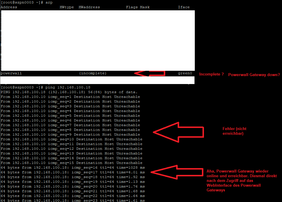

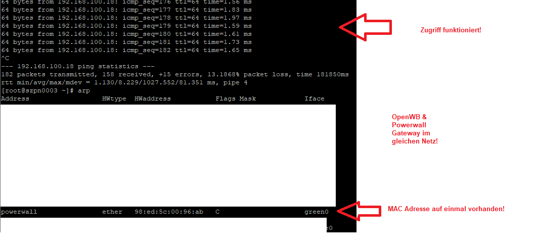

Interessant in diesem Zusammenhang ist, dass die Powerwall dann auch über Layer 2 anscheinend nicht erreichbar ist:
Kurze Zeit später ist diese wieder erreichbar:
Daher würde ich vorschlagen, zuerst mal die mehrfachen Abfragen auf .../api/meters/aggregates zu reduzieren. Die Rückgabe enthält sowieso immer die Daten für alle Geräte. In so kurzen Abständen ist ja eh keine relevante Werteänderung zu erwarten.
Ich könnte mir vorstellen, dass die 3-fache Abfrage auch von meiner Gerätekonfiguration abhängt. Dort werden 3 Geräte aufgelistet. Das ist doch korrekt so, oder?

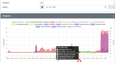

Alleine gestern hatte ich wieder zwei kurze Zeitintervalle in denen keine Daten von der Powerwall abgerufen werden konnten:
Zwischenzeitlich hat Tesla mir auf Anfrage ein Update der Gateway Software eingespielt. Bin nun auf Firmware: 23.44.0! Leider hat sich damit keine Veränderung der oben beschriebenen Problematik eingestellt.

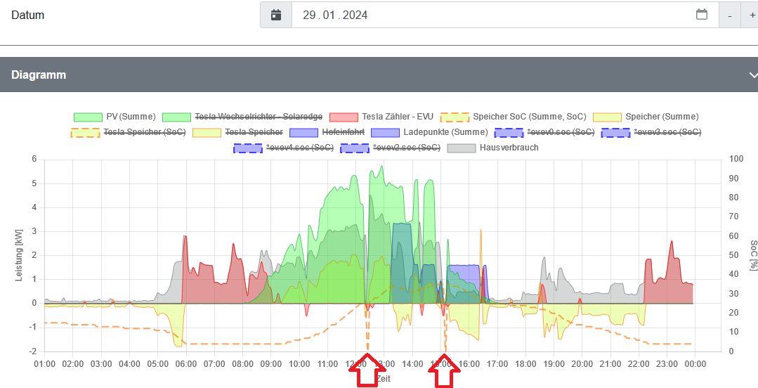

Ich musste leider feststellen, dass das Problem leider immer noch besteht.
Ich würde trotzdem dafür plädieren den letzten Commit https://github.com/openWB/core/pull/1386 zur Powerwall beizubehalten, da die Reduktion der Abfragen ja eine Optimierung darstellt und keinen neuen Fehler hinzugefügt hat.
Hat jemand noch das Problem mit den misslingenden Powerwall-Abfragen?
Parallel frage ich nun Tesla zu dem Thema an.

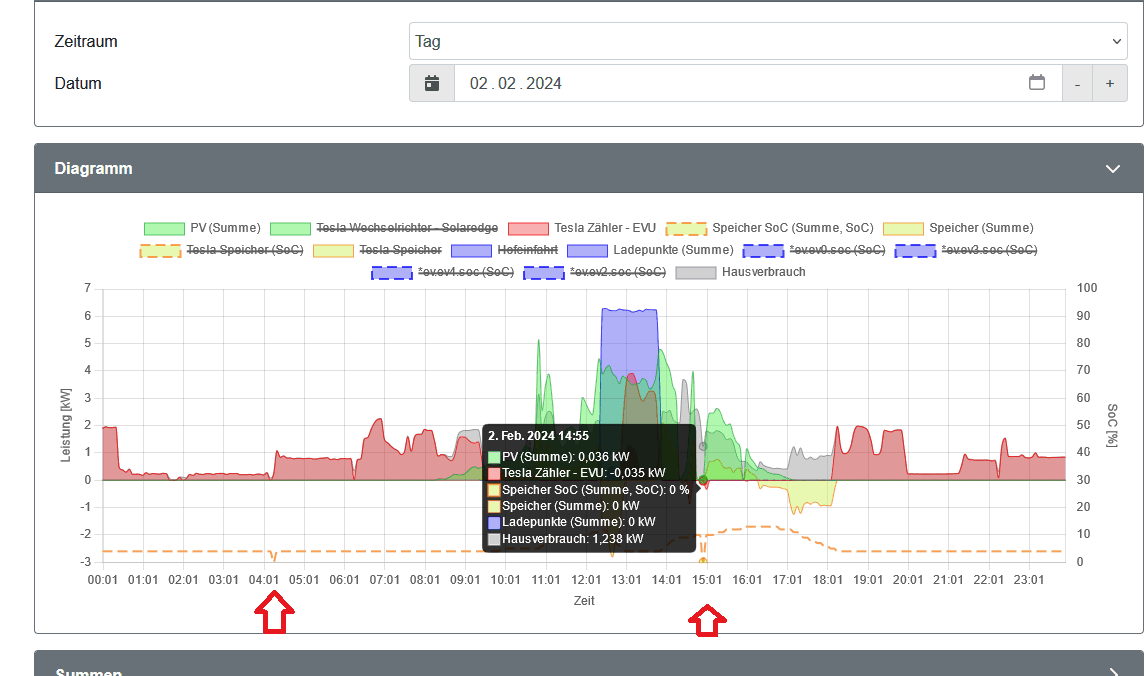

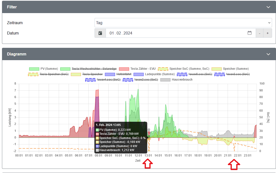

Anbei noch ein paar Tagesdiagramme mit denen das Problem leicht erkennbar wird:
