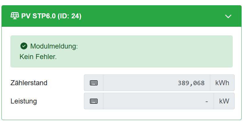

Ab hier verlassen sie mich dann. Auf der openWB wird mir aber ein Zählerstand von 389kWh angezeigt, den finde ich ebenfalls im Log, und zwar hier. Nicht mehr das Device17 sondern Component24.
Screenshot 2024-03-04 231552.png (23.42 KiB) 487 mal betrachtet

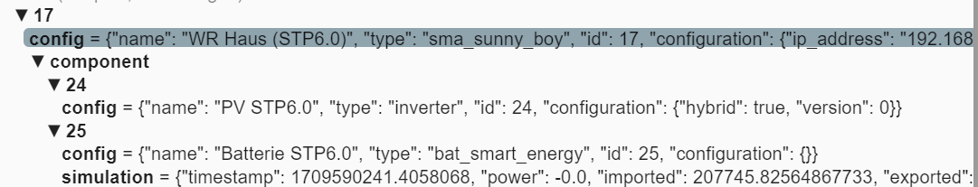

Device17 (SMA WR, type sma_sunny_boy) beherbergt zwei Komponenten, component24 (PV WR, type inverter), componente25 (Batterie, type bat_smart_energy)

2024-03-04 22:08:02,753 - {control.data:279} - {INFO:MainThread} - device17
{'name': 'WR Haus (STP6.0)', 'type': 'sma_sunny_boy', 'id': 17, 'configuration': {'ip_address': '192.168.178.206'}}
2024-03-04 22:08:02,755 - {control.data:281} - {INFO:MainThread} - component24
{'name': 'PV STP6.0', 'type': 'inverter', 'id': 24, 'configuration': {'hybrid': True, 'version': 0}}
2024-03-04 22:08:02,756 - {control.data:281} - {INFO:MainThread} - component25
{'name': 'Batterie STP6.0', 'type': 'bat_smart_energy', 'id': 25, 'configuration': {}}

hybrider SMA Wechselrichter (device17, wr component24, bat component25) liefert ebenfalls die erwarteten Rohwerte (exported=331114 im InverterState)
2024-03-04 22:08:00,885 - {modules.common.component_context:25} - {DEBUG:device17} - Update Komponente ['PV STP6.0']
2024-03-04 22:08:01,893 - {modules.devices.sma_sunny_boy.inverter:73} - {DEBUG:device17} - WR 192.168.178.206: InverterState(currents=[0.0, 0.0, 0.0], power=0, exported=331114, dc_power=0)
2024-03-04 22:08:01,897 - {modules.common.store._api:26} - {DEBUG:device17} - Raw data InverterState(currents=[0.0, 0.0, 0.0], power=0, exported=331114, dc_power=0)
2024-03-04 22:08:01,907 - {modules.common.component_context:25} - {DEBUG:device17} - Update Komponente ['Batterie STP6.0']
2024-03-04 22:08:01,995 - {modules.common.simcount._simcount:37} - {DEBUG:device17} - Previous state: SimCounterState(timestamp=1709586471.6718953, power=-0.0, imported=207745.82564867733, exported=149791.79642494305)
2024-03-04 22:08:01,996 - {modules.common.simcount._calculate:11} - {DEBUG:device17} - time passed: 0.00286778, power1: -0, power2: -0
2024-03-04 22:08:01,996 - {modules.common.simcount._calculate:27} - {DEBUG:device17} - power did not change sign. Total energy: 0
2024-03-04 22:08:01,997 - {modules.common.simcount._simcount:46} - {DEBUG:device17} - imported: 0 Wh, exported: 0 Wh, new state: SimCounterState(timestamp=1709586481.9959111, power=-0.0, imported=207745.82564867733, exported=149791.79642494305)
2024-03-04 22:08:01,998 - {modules.common.store._api:26} - {DEBUG:device17} - Raw data BatState(imported=207745.82564867733, exported=149791.79642494305, power=-0.0, soc=0)
Für component24 wird dann aber ein anderere InverterState geschrieben, woher die vermutlich berechneten/angepassten Werte stammen ist mir nicht klar. Auffällig ist dass aus dem int ein float wird. InverterState hat nun exported=389068.03, nicht mehr 331114. Woher kommt der Unterschied?
2024-03-04 22:08:02,250 - {modules.common.component_context:25} - {DEBUG:component24} - Update Komponente ['PV STP6.0']
2024-03-04 22:08:02,282 - {modules.common.store._api:26} - {DEBUG:component24} - Raw data InverterState(currents=[0.0, 0.0, 0.0], power=0, exported=[b]389068.03[/b], dc_power=None)
2024-03-04 22:08:02,294 - {modules.common.store._api:30} - {INFO:component24} - Saving InverterState(currents=[0.0, 0.0, 0.0], power=0, exported=389068.03, dc_power=None)

Jup, das wird es wohl sein:
https://github.com/openWB/core/blob/mas ... ter.py#L73
device17 InverterState exported + (device17 BatState imported - device17 BatState exported) = component24 InverterState
331114 + (207745 - 149791) = 389068
SMA liefert wohl Zählerstände welche nicht weiter verrechnet werden müssen.
