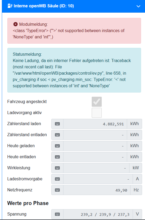

Ich kann seit dem Wochenende nicht mehr das Auto laden. :?
Fehlermeldung: <class 'TypeError'> ("'>' not supported between instances of 'NoneType' and 'int'",)
Der Support meinte, ich soll den Ladepunkt löschen. Das hatte ich getan und neu angelegt. Leider ohne Erfolg.
Habt ihr noch einen Tip?
Installiert ist die neuste Version von heute.
Eine Version von vor einem Monat funktioniert auch nicht.
openWB series2 standard+ mit PV-Anlage

2024-04-04 18:34:30,512 - {asyncio:59} - {DEBUG:Internal Chargepoint} - Using selector: EpollSelector
2024-04-04 18:34:32,657 - {modules.internal_chargepoint_handler.internal_chargepoint_handler:144} - {DEBUG:Internal Chargepoint} - Init internal chargepoint as series
2024-04-04 18:34:32,658 - {modules.common.component_context:25} - {DEBUG:Internal Chargepoint} - Update Komponente ['Interner Ladepunkt 0']
2024-04-04 18:34:32,660 - {modules.internal_chargepoint_handler.clients:94} - {DEBUG:Internal Chargepoint} - tty_devices[PosixPath('/dev/serial/by-path/platform-3f980000.usb-usb-0:1.2:1.0-port0')]
2024-04-04 18:34:32,661 - {modules.internal_chargepoint_handler.clients:96} - {DEBUG:Internal Chargepoint} - resolved_devices['/dev/ttyUSB0']
2024-04-04 18:34:32,662 - {modules.internal_chargepoint_handler.clients:107} - {ERROR:Internal Chargepoint} - LP0 Device: /dev/ttyUSB0
2024-04-04 18:34:32,827 - {modules.internal_chargepoint_handler.clients:52} - {DEBUG:Internal Chargepoint} - <modules.common.modbus.ModbusSerialClient_ object at 0x70149ca0>
2024-04-04 18:34:32,828 - {modules.internal_chargepoint_handler.clients:53} - {ERROR:Internal Chargepoint} - Modbus-ID der EVSE an LP0: 1
2024-04-04 18:34:33,839 - {modules.internal_chargepoint_handler.clients:70} - {DEBUG:Internal Chargepoint} - <modules.common.modbus.ModbusSerialClient_ object at 0x70149ca0>
2024-04-04 18:34:33,840 - {modules.internal_chargepoint_handler.clients:71} - {DEBUG:Internal Chargepoint} - Zähler <class 'modules.common.mpm3pm.Mpm3pm'> mit Modbus-ID:5 antwortet nicht.
2024-04-04 18:34:33,899 - {modules.internal_chargepoint_handler.clients:67} - {ERROR:Internal Chargepoint} - Verbauter Zähler: <class 'modules.common.sdm.Sdm630'> mit Modbus-ID: 105
2024-04-04 18:34:34,356 - {modules.internal_chargepoint_handler.chargepoint_module:45} - {DEBUG:Internal Chargepoint} - Firmware-Version der EVSE: 15
2024-04-04 18:34:34,363 - {modules.common.component_context:25} - {DEBUG:Internal Chargepoint} - Update Komponente ['Ladepunkt 0']
2024-04-04 18:34:34,391 - {modules.common.component_context:25} - {DEBUG:Internal Chargepoint} - Update Komponente ['Ladepunkt 0']
2024-04-04 18:34:36,437 - {modules.internal_chargepoint_handler.internal_chargepoint_handler:144} - {DEBUG:Internal Chargepoint} - Init internal chargepoint as series
2024-04-04 18:34:36,438 - {modules.common.component_context:25} - {DEBUG:Internal Chargepoint} - Update Komponente ['Interner Ladepunkt 0']
2024-04-04 18:34:36,439 - {modules.internal_chargepoint_handler.clients:94} - {DEBUG:Internal Chargepoint} - tty_devices[PosixPath('/dev/serial/by-path/platform-3f980000.usb-usb-0:1.2:1.0-port0')]
2024-04-04 18:34:36,441 - {modules.internal_chargepoint_handler.clients:96} - {DEBUG:Internal Chargepoint} - resolved_devices['/dev/ttyUSB0']
2024-04-04 18:34:36,441 - {modules.internal_chargepoint_handler.clients:107} - {ERROR:Internal Chargepoint} - LP0 Device: /dev/ttyUSB0
2024-04-04 18:34:36,602 - {modules.internal_chargepoint_handler.clients:52} - {DEBUG:Internal Chargepoint} - <modules.common.modbus.ModbusSerialClient_ object at 0x7013fe98>
2024-04-04 18:34:36,603 - {modules.internal_chargepoint_handler.clients:53} - {ERROR:Internal Chargepoint} - Modbus-ID der EVSE an LP0: 1
2024-04-04 18:34:37,616 - {modules.internal_chargepoint_handler.clients:70} - {DEBUG:Internal Chargepoint} - <modules.common.modbus.ModbusSerialClient_ object at 0x7013fe98>
2024-04-04 18:34:37,617 - {modules.internal_chargepoint_handler.clients:71} - {DEBUG:Internal Chargepoint} - Zähler <class 'modules.common.mpm3pm.Mpm3pm'> mit Modbus-ID:5 antwortet nicht.
2024-04-04 18:34:37,672 - {modules.internal_chargepoint_handler.clients:67} - {ERROR:Internal Chargepoint} - Verbauter Zähler: <class 'modules.common.sdm.Sdm630'> mit Modbus-ID: 105
2024-04-04 18:34:38,074 - {modules.internal_chargepoint_handler.chargepoint_module:45} - {DEBUG:Internal Chargepoint} - Firmware-Version der EVSE: 15
2024-04-04 18:34:38,076 - {modules.common.component_context:25} - {DEBUG:Internal Chargepoint} - Update Komponente ['Ladepunkt 0']
2024-04-04 18:34:38,089 - {modules.common.component_context:25} - {DEBUG:Internal Chargepoint} - Update Komponente ['Ladepunkt 0']
2024-04-04 18:34:38,091 - {modules.internal_chargepoint_handler.internal_chargepoint_handler:189} - {DEBUG:Internal Chargepoint} - ***Start***
2024-04-04 18:34:38,096 - {modules.internal_chargepoint_handler.internal_chargepoint_handler:191} - {DEBUG:Internal Chargepoint} - {'cp0': InternalChargepoint(data=InternalChargepointData(cp_interruption_duration=None, parent_cp='10', phases_to_use=0, set_current=0, trigger_phase_switch=False), get=Get(charge_state=False, currents=[0.0, 0.0, 0.0], evse_current=0, exported=0, fault_str='Kein Fehler.', fault_state=0, imported=0, phases_in_use=0, plug_state=False, power=0, rfid_timestamp=None, rfid=None, voltages=[230.0, 230.0, 230.0])), 'cp1': InternalChargepoint(data=InternalChargepointData(cp_interruption_duration=0, parent_cp=None, phases_to_use=0, set_current=0, trigger_phase_switch=False), get=Get(charge_state=False, currents=[0.0, 0.0, 0.0], evse_current=0, exported=0, fault_str='Kein Fehler.', fault_state=0, imported=0, phases_in_use=0, plug_state=False, power=0, rfid_timestamp=None, rfid=None, voltages=[230.0, 230.0, 230.0])), 'global_data': GlobalHandlerData(heartbeat=1712248321.00169, parent_ip='localhost', configured=True), 'rfid_data': RfidData(last_tag='')}
2024-04-04 18:34:38,104 - {modules.common.component_context:25} - {DEBUG:Internal Chargepoint} - Update Komponente ['Ladepunkt 0']
2024-04-04 18:34:38,903 - {modules.common.evse:42} - {DEBUG:Internal Chargepoint} - Gesetzte Stromstärke EVSE: 13, Status: 1, Modbus-ID: 1
2024-04-04 18:34:38,904 - {modules.common.store._api:26} - {DEBUG:Internal Chargepoint} - Raw data ChargepointState(currents=[0.0, 0.0, 0.0], powers=[0.0, 0.0, 0.0], voltages=[239.3894805908203, 239.8659210205078, 237.16937255859375], frequency=49.946895599365234, imported=4882590.8203125, exported=0, power=0, serial_number=20276697, phases_in_use=0, charge_state=False, plug_state=False, rfid=, rfid_timestamp=None, power_factors=[1.0, 1.0, 1.0], soc=None, soc_timestamp=None, evse_current=13, vehicle_id=None)
2024-04-04 18:34:38,906 - {modules.common.store._api:30} - {INFO:Internal Chargepoint} - Saving ChargepointState(currents=[0.0, 0.0, 0.0], powers=[0.0, 0.0, 0.0], voltages=[239.3894805908203, 239.8659210205078, 237.16937255859375], frequency=49.946895599365234, imported=4882590.8203125, exported=0, power=0, serial_number=20276697, phases_in_use=0, charge_state=False, plug_state=False, rfid=, rfid_timestamp=None, power_factors=[1.0, 1.0, 1.0], soc=None, soc_timestamp=None, evse_current=13, vehicle_id=None)
2024-04-04 18:34:38,933 - {modules.common.store._api:26} - {DEBUG:Internal Chargepoint} - Raw data ChargepointState(currents=[0.0, 0.0, 0.0], powers=[0.0, 0.0, 0.0], voltages=[239.3894805908203, 239.8659210205078, 237.16937255859375], frequency=49.946895599365234, imported=4882590.8203125, exported=0, power=0, serial_number=20276697, phases_in_use=0, charge_state=False, plug_state=False, rfid=, rfid_timestamp=None, power_factors=[1.0, 1.0, 1.0], soc=None, soc_timestamp=None, evse_current=13, vehicle_id=None)
2024-04-04 18:34:38,935 - {modules.common.store._api:30} - {INFO:Internal Chargepoint} - Saving ChargepointState(currents=[0.0, 0.0, 0.0], powers=[0.0, 0.0, 0.0], voltages=[239.3894805908203, 239.8659210205078, 237.16937255859375], frequency=49.946895599365234, imported=4882590.8203125, exported=0, power=0, serial_number=20276697, phases_in_use=0, charge_state=False, plug_state=False, rfid=, rfid_timestamp=None, power_factors=[1.0, 1.0, 1.0], soc=None, soc_timestamp=None, evse_current=13, vehicle_id=None)
2024-04-04 18:34:38,942 - {modules.internal_chargepoint_handler.internal_chargepoint_handler:247} - {DEBUG:Internal Chargepoint} - Published plug state False
2024-04-04 18:34:38,943 - {modules.internal_chargepoint_handler.internal_chargepoint_handler:255} - {ERROR:Internal Chargepoint} - Heartbeat Fehler seit 157.94172406196594s keine Verbindung. Stoppe Ladung.
2024-04-04 18:34:39,223 - {modules.internal_chargepoint_handler.internal_chargepoint_handler:93} - {DEBUG:Internal Chargepoint} - Values from parentWB: InternalChargepointData(cp_interruption_duration=None, parent_cp='10', phases_to_use=0, set_current=0, trigger_phase_switch=False)
2024-04-04 18:34:39,224 - {modules.common.component_context:25} - {DEBUG:Internal Chargepoint} - Update Komponente ['Ladepunkt 0']
2024-04-04 18:34:39,392 - {modules.common.fault_state:49} - {ERROR:Internal Chargepoint} - Ladepunkt 0: FaultState FaultStateLevel.ERROR, FaultStr <class 'TypeError'> ("'>' not supported between instances of 'NoneType' and 'int'",), Traceback:
  File "/var/www/html/openWB/packages/modules/internal_chargepoint_handler/internal_chargepoint_handler.py", line 251, in update
    self.update_state.update_state(data, heartbeat_expired)
  File "/var/www/html/openWB/packages/modules/internal_chargepoint_handler/internal_chargepoint_handler.py", line 114, in update_state
    if data.cp_interruption_duration > 0:
TypeError: '>' not supported between instances of 'NoneType' and 'int'
2024-04-04 18:34:40,495 - {modules.internal_chargepoint_handler.internal_chargepoint_handler:189} - {DEBUG:Internal Chargepoint} - ***Start***
2024-04-04 18:34:40,498 - {modules.internal_chargepoint_handler.internal_chargepoint_handler:191} - {DEBUG:Internal Chargepoint} - {'cp0': InternalChargepoint(data=InternalChargepointData(cp_interruption_duration=None, parent_cp='10', phases_to_use=0, set_current=0, trigger_phase_switch=False), get=Get(charge_state=False, currents=[0.0, 0.0, 0.0], evse_current=13, exported=0, fault_str='Kein Fehler.', fault_state=0, imported=4882590.82, phases_in_use=0, plug_state=False, power=0, rfid_timestamp=None, rfid=None, voltages=[239.39, 239.87, 237.17])), 'cp1': InternalChargepoint(data=InternalChargepointData(cp_interruption_duration=0, parent_cp=None, phases_to_use=0, set_current=0, trigger_phase_switch=False), get=Get(charge_state=False, currents=[0.0, 0.0, 0.0], evse_current=0, exported=0, fault_str='Kein Fehler.', fault_state=0, imported=0, phases_in_use=0, plug_state=False, power=0, rfid_timestamp=None, rfid=None, voltages=[230.0, 230.0, 230.0])), 'global_data': GlobalHandlerData(heartbeat=1712248321.00169, parent_ip='localhost', configured=True), 'rfid_data': RfidData(last_tag='')}
2024-04-04 18:34:40,501 - {modules.common.component_context:25} - {DEBUG:Internal Chargepoint} - Update Komponente ['Ladepunkt 0']
2024-04-04 18:34:41,354 - {modules.common.evse:42} - {DEBUG:Internal Chargepoint} - Gesetzte Stromstärke EVSE: 0, Status: 1, Modbus-ID: 1
2024-04-04 18:34:41,356 - {modules.common.store._api:26} - {DEBUG:Internal Chargepoint} - Raw data ChargepointState(currents=[0.0, 0.0, 0.0], powers=[0.0, 0.0, 0.0], voltages=[239.20831298828125, 239.99810791015625, 236.85069274902344], frequency=49.93525695800781, imported=4882590.8203125, exported=0, power=0, serial_number=20276697, phases_in_use=0, charge_state=False, plug_state=False, rfid=, rfid_timestamp=None, power_factors=[1.0, 1.0, 1.0], soc=None, soc_timestamp=None, evse_current=0, vehicle_id=None)
2024-04-04 18:34:41,357 - {modules.common.store._api:30} - {INFO:Internal Chargepoint} - Saving ChargepointState(currents=[0.0, 0.0, 0.0], powers=[0.0, 0.0, 0.0], voltages=[239.20831298828125, 239.99810791015625, 236.85069274902344], frequency=49.93525695800781, imported=4882590.8203125, exported=0, power=0, serial_number=20276697, phases_in_use=0, charge_state=False, plug_state=False, rfid=, rfid_timestamp=None, power_factors=[1.0, 1.0, 1.0], soc=None, soc_timestamp=None, evse_current=0, vehicle_id=None)
2024-04-04 18:34:41,365 - {modules.common.store._api:26} - {DEBUG:Internal Chargepoint} - Raw data ChargepointState(currents=[0.0, 0.0, 0.0], powers=[0.0, 0.0, 0.0], voltages=[239.20831298828125, 239.99810791015625, 236.85069274902344], frequency=49.93525695800781, imported=4882590.8203125, exported=0, power=0, serial_number=20276697, phases_in_use=0, charge_state=False, plug_state=False, rfid=, rfid_timestamp=None, power_factors=[1.0, 1.0, 1.0], soc=None, soc_timestamp=None, evse_current=0, vehicle_id=None)
2024-04-04 18:34:41,368 - {modules.common.store._api:30} - {INFO:Internal Chargepoint} - Saving ChargepointState(currents=[0.0, 0.0, 0.0], powers=[0.0, 0.0, 0.0], voltages=[239.20831298828125, 239.99810791015625, 236.85069274902344], frequency=49.93525695800781, imported=4882590.8203125, exported=0, power=0, serial_number=20276697, phases_in_use=0, charge_state=False, plug_state=False, rfid=, rfid_timestamp=None, power_factors=[1.0, 1.0, 1.0], soc=None, soc_timestamp=None, evse_current=0, vehicle_id=None)
2024-04-04 18:34:41,377 - {modules.internal_chargepoint_handler.internal_chargepoint_handler:247} - {DEBUG:Internal Chargepoint} - Published plug state False
2024-04-04 18:34:41,380 - {modules.internal_chargepoint_handler.internal_chargepoint_handler:255} - {ERROR:Internal Chargepoint} - Heartbeat Fehler seit 160.37852907180786s keine Verbindung. Stoppe Ladung.
2024-04-04 18:34:41,611 - {modules.internal_chargepoint_handler.internal_chargepoint_handler:93} - {DEBUG:Internal Chargepoint} - Values from parentWB: InternalChargepointData(cp_interruption_duration=None, parent_cp='10', phases_to_use=0, set_current=0, trigger_phase_switch=False)
2024-04-04 18:34:41,612 - {modules.common.component_context:25} - {DEBUG:Internal Chargepoint} - Update Komponente ['Ladepunkt 0']
2024-04-04 18:34:41,628 - {modules.common.fault_state:49} - {ERROR:Internal Chargepoint} - Ladepunkt 0: FaultState FaultStateLevel.ERROR, FaultStr <class 'TypeError'> ("'>' not supported between instances of 'NoneType' and 'int'",), Traceback:
