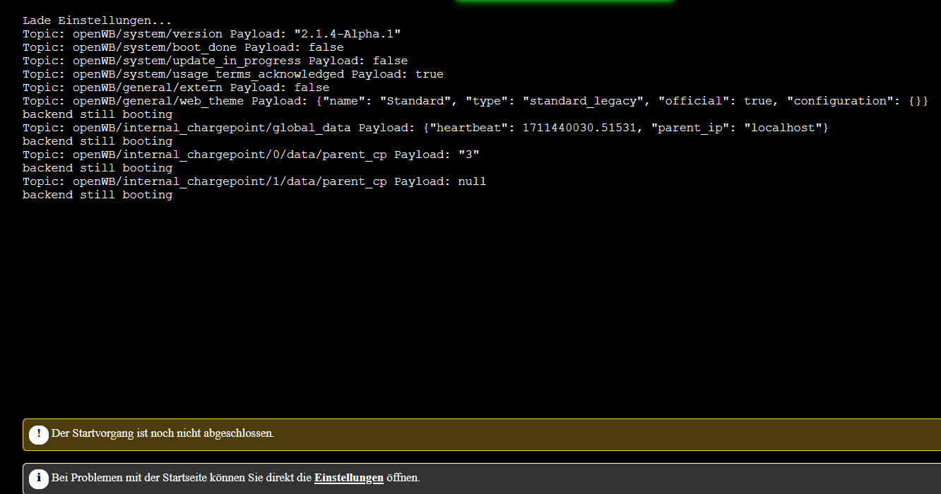

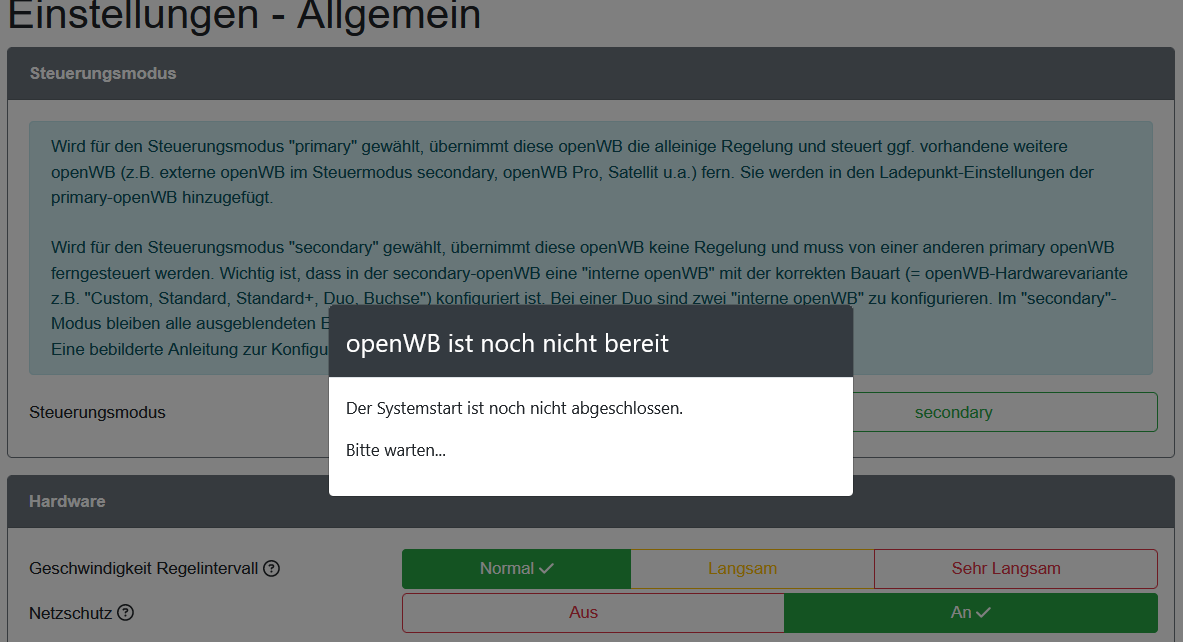

Re: Rückmeldungen openWB software 2.1.4 Alpha 1
Beitrag von Cpt.Körg »
Hallöchen,
ich bekomme mit der letzten Master von 13:23 Uhr eine Fehlermeldung am internen Ladepunkt.
2024-03-25 13:26:40,531 - {root:75} - {INFO:MainThread} - # ***Start***

Hier noch das Log vom Ladepunkt:
2024-03-25 13:30:02,324 - {modules.internal_chargepoint_handler.internal_chargepoint_handler:301} - {ERROR:Internal Chargepoint} - Fehler im internem Ladepunkt
  File "/var/www/html/openWB/packages/modules/internal_chargepoint_handler/internal_chargepoint_handler.py", line 297, in handler
    self.internal_chargepoint_handler.loop()
  File "/var/www/html/openWB/packages/modules/internal_chargepoint_handler/internal_chargepoint_handler.py", line 198, in loop
    with SingleComponentUpdateContext(self.cp0.module.fault_state):
AttributeError: 'InternalChargepointHandler' object has no attribute 'cp0'
2024-03-25 13:35:02,722 - {modules.internal_chargepoint_handler.internal_chargepoint_handler:145} - {DEBUG:Internal Chargepoint} - Init internal chargepoint as series
2024-03-25 13:35:02,722 - {modules.common.component_context:25} - {DEBUG:Internal Chargepoint} - Update Komponente ['Interner Ladepunkt 0']
2024-03-25 13:35:02,723 - {modules.internal_chargepoint_handler.clients:94} - {DEBUG:Internal Chargepoint} - tty_devices[PosixPath('/dev/serial/by-path/platform-3f980000.usb-usb-0:1.5:1.0-port0')]
2024-03-25 13:35:02,724 - {modules.internal_chargepoint_handler.clients:96} - {DEBUG:Internal Chargepoint} - resolved_devices['/dev/ttyUSB0']
2024-03-25 13:35:02,724 - {modules.internal_chargepoint_handler.clients:107} - {ERROR:Internal Chargepoint} - LP0 Device: /dev/ttyUSB0
2024-03-25 13:35:02,728 - {modules.common.fault_state:49} - {ERROR:Internal Chargepoint} - Interner Ladepunkt 0: FaultState FaultStateLevel.ERROR, FaultStr <class 'TypeError'> ('an integer is required (got type NoneType)',), Traceback:
  File "/var/www/html/openWB/packages/modules/internal_chargepoint_handler/internal_chargepoint_handler.py", line 157, in __init__
    self.cp0_client_handler = client_factory(0, fault_state_info_cp0)
  File "/var/www/html/openWB/packages/modules/internal_chargepoint_handler/clients.py", line 132, in client_factory
    return ClientHandler(local_charge_point_num, serial_client, evse_ids, fault_state)
  File "/var/www/html/openWB/packages/modules/internal_chargepoint_handler/clients.py", line 40, in __init__
    self.evse_client = self._evse_factory(client, evse_ids)
  File "/var/www/html/openWB/packages/modules/internal_chargepoint_handler/clients.py", line 49, in _evse_factory
    with client:
  File "/var/www/html/openWB/packages/modules/common/modbus.py", line 62, in __enter__
    time.sleep(self.sleep_after_connect)
TypeError: an integer is required (got type NoneType)
2024-03-25 13:35:02,730 - {modules.internal_chargepoint_handler.internal_chargepoint_handler:301} - {ERROR:Internal Chargepoint} - Fehler im internem Ladepunkt
Grüße vom Jörg

Cpt.Körg hat geschrieben: Mo Mär 25, 2024 12:38 pm Hallöchen,

Grundlage:
Keine Smarthomegeräte oder irgendwelche Anbindungen. Update auf die heutige Alpha. (Backup vorher erstellt)
Kein starten mehr möglich. (ca. 25 min gewartet) Eine softe Abschaltung ist nicht möglich. (Habe keinen ssh Zugang)
Startet nicht mehr
Startet nicht mehr.png (51.72 KiB) 1821 mal betrachtet
Auf Einstellung keine Möglichkeit softe Abschaltung bzw. Neustart...
keine Möglichkeit Softstart.png (75.66 KiB) 1821 mal betrachtet
Display:
Lade Einstellungen...
Topic: openWB/system/version Payload: "2.1.4-Alpha.1"
Topic: openWB/system/boot_done Payload: false
Topic: openWB/system/update_in_progress Payload: false
Topic: openWB/general/extern Payload: false
Topic: openWB/optional/int_display/theme Payload: {"name": "Cards", "type": "cards", "configuration": {"lock_changes": false, "lock_changes_code": null, "enable_dashboard_view": true, "enable_dashboard_card_grid": true, "enable_dashboard_card_home_consumption": true, "enable_dashboard_card_battery_sum": true, "enable_dashboard_card_inverter_sum": true, "enable_dashboard_card_charge_point_sum": true, "enable_charge_points_view": true, "enable_status_view": true}, "official": true}
Topic: openWB/optional/int_display/only_local_charge_points Payload: false
backend still booting
Topic: openWB/general/extern_display_mode Payload: "local"
Topic: openWB/internal_chargepoint/global_data Payload: {"heartbeat": 1711440030.51531, "parent_ip": "localhost"}
Topic: openWB/internal_chargepoint/0/data/parent_cp Payload: "3"
Topic: openWB/internal_chargepoint/1/data/parent_cp Payload: null
PV: 9,86kWp an E3DC S10 13kWh
LP1: openWB Series2 standard+
Kia EV6
Nutzung von Tibber
