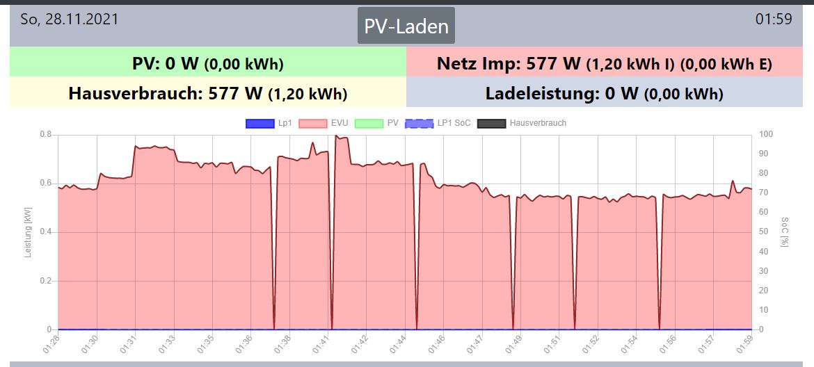

Teta
Beiträge: 42
Registriert: Fr Jul 05, 2019 6:25 pm
Re: SMA Home Manager Software Change auf 2.07.5.R
Beitrag von Teta »
Hier werkelt unter anderem so ein SMA Home Manager 2.0.
Der Graph on der openWB sieht hier 'normal' aus. Vor ein paar Tagen waren da in der Tat diese Zacken drin.

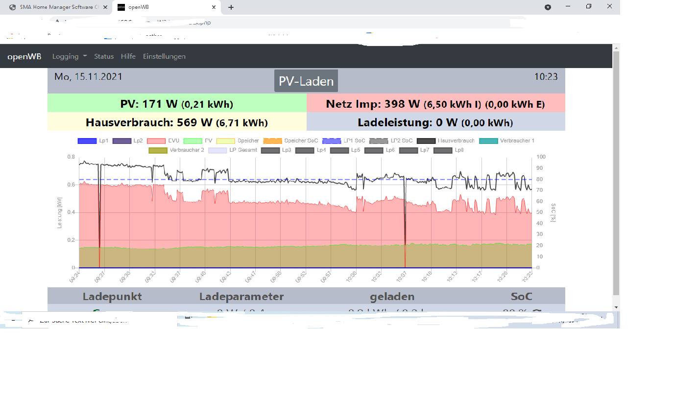

ich kann es nicht verstehen... manchmal sind diese häufiger und manchmal seltener.

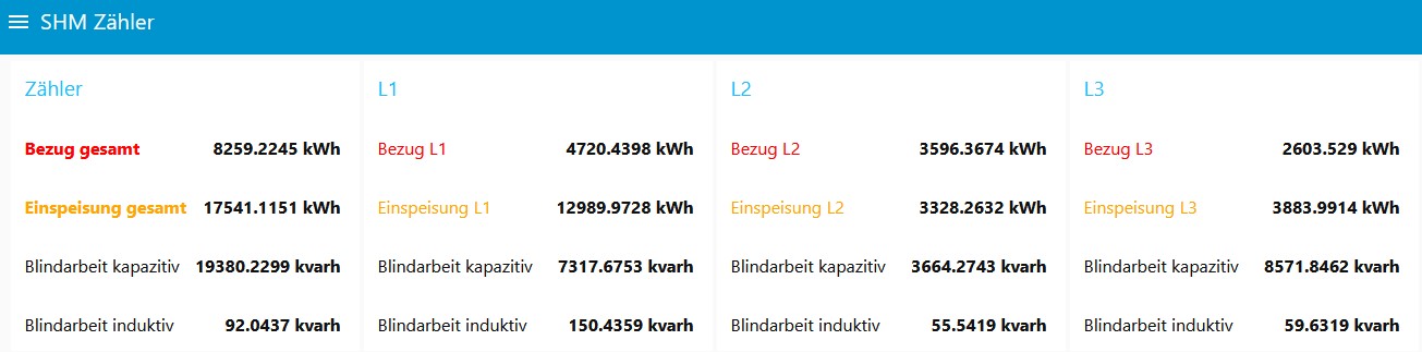

Was mir aufgefallen ist, in meiner Node-Red Abfrage stocken die Werte alle 30s kurz.
Als Rohdaten sehe ich folgendes:
Das Paket hat nicht mehr die Länge von 608 sondern nur noch von 58 und scheinbar keine Messdaten.
Was auch immer da drin ist.
[83,77,65,0,0,4,2,160,0,0,0,1,0,38,0,16,96,101,9,160,255,255,255,255,255,255,0,0,116,1,228,181,89,113,0,0,0,0,0,0,27,177,0,2,0,0,0,0,0,0,0,0,0,0,0,0,0,0]
zu
[83,77,65,0,0,4,2,160,0,0,0,1,2,76,0,16,96,105,1,116,113,89,181,228,111,170,172,50,0,1,4,0,0,0,18,63,0,1,8,0,0,0,0,6,231,89,65,104,0,2,4,0,0,0,0,0,0,2,8,0,0,0,0,14,179,226,181,240,0,3,4,0,0,0,0,0,0,3,8,0,0,0,0,0,19,192,28,136,0,4,4,0,0,0,39,2,0,4,8,0,0,0,0,16,57,140,115,32,0,9,4,0,0,0,43,16,0,9,8,0,0,0,0,13,180,146,239,112,0,10,4,0,0,0,0,0,0,10,8,0,0,0,0,17,122,14,240,192,0,13,4,0,0,0,1,168,0,14,4,0,0,0,195,90,0,21,4,0,0,0,5,62,0,21,8,0,0,0,0,3,242,250,89,16,0,22,4,0,0,0,0,0,0,22,8,0,0,0,0,10,227,44,209,200,0,23,4,0,0,0,0,0,0,23,8,0,0,0,0,0,32,71,176,216,0,24,4,0,0,0,15,180,0,24,8,0,0,0,0,6,32,88,154,80,0,29,4,0,0,0,16,142,0,29,8,0,0,0,0,5,206,12,21,56,0,30,4,0,0,0,0,0,0,30,8,0,0,0,0,11,222,138,215,104,0,31,4,0,0,0,7,147,0,32,4,0,0,3,137,50,0,33,4,0,0,0,1,61,0,41,4,0,0,0,11,16,0,41,8,0,0,0,0,3,2,43,169,8,0,42,4,0,0,0,0,0,0,42,8,0,0,0,0,2,202,30,51,240,0,43,4,0,0,0,0,0,0,43,8,0,0,0,0,0,11,235,1,248,0,44,4,0,0,0,10,189,0,44,8,0,0,0,0,3,16,219,62,0,0,49,4,0,0,0,15,107,0,49,8,0,0,0,0,4,89,198,213,96,0,50,4,0,0,0,0,0,0,50,8,0,0,0,0,2,235,185,130,48,0,51,4,0,0,0,6,236,0,52,4,0,0,3,143,104,0,53,4,0,0,0,2,206,0,61,4,0,0,0,1,242,0,61,8,0,0,0,0,2,44,209,6,144,0,62,4,0,0,0,0,0,0,62,8,0,0,0,0,3,65,53,126,128,0,63,4,0,0,0,0,0]

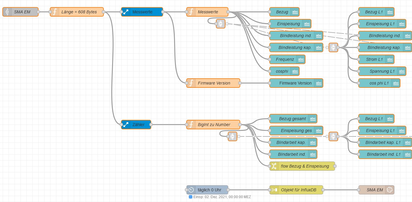

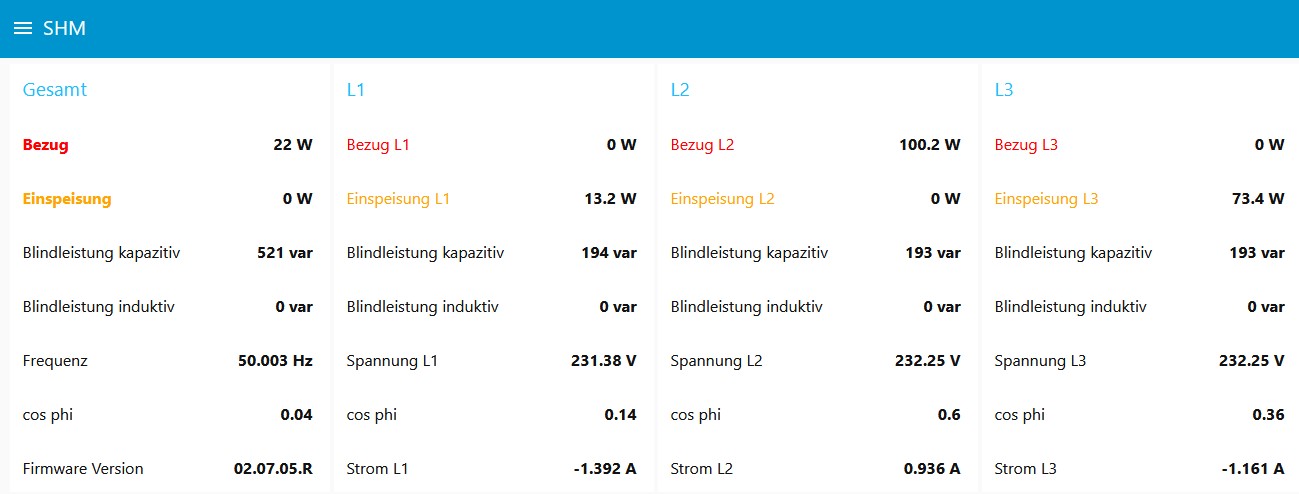

ich habe mich gestern paar Stunden hingesetzt und den Speedwiredecoder selber dekodiert, da mir die Bauart von "Datenschuft" zu viel CPU Last erzeugte und durch das Datenpaket mit 58Bytes alle 30s kurz ruckt.
Raus gekommen ist was sehr einfaches, was kaum CPU Last benötigt, allerdings arbeite ich ohne OBIS Kennzahlen, d.h. wenn SMA mit einem Fw-Update die Messkanäle ändert, dann muss ich wieder alles anpassen. Glaube ich aber nicht, die Kanäle wurden einmal angepasst um die Frequenz mit zu übertragen, dazu wurde das Paket damals auf 608 Byte vergrößert.
Wenn die Programmierer den Flow, besser gesagt den Dekoder in openWB´s Python übernehmen, dann sollte das Problem in 10min erledigt sein ;)
Edit:

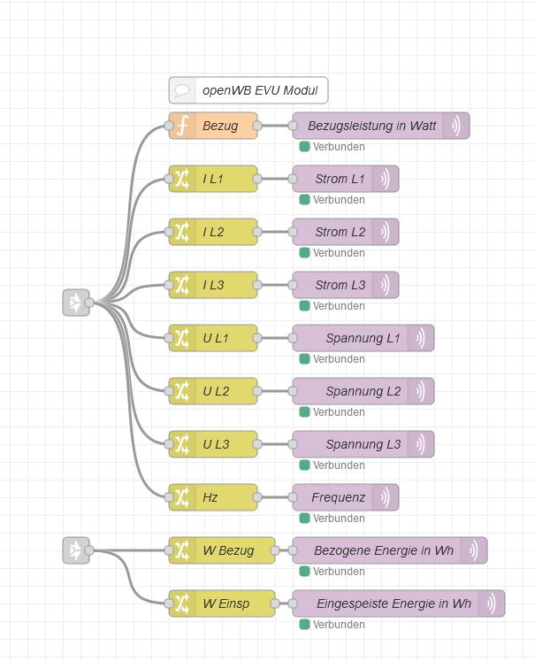

habe zusätzlich noch MQTT für das openWB EVU Modul angebaut, so gibt es keinerlei Probleme mehr (insbesondere bleibt das Netzwerk auf IGMPv3) !
Siehe: viewtopic.php?p=51576#p51576
