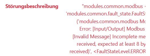

Hallo Lutz,
Version 1.9.252 (2022-01-27 07:48:56 +0100 [fcb648de] ) ergibt folgenden Log:
2022-01-27 09:56:04: **** Regulation loop needs 3 seconds (LV2) at 55 cleanup /var/www/html/openWB/regel.sh

2022-01-27 09:55:56: PID: 2487: legacy run server: Completed running command in 3.03s: ["modules.siemens.device","counter","192.168.178.56"]
modules.common.fault_state.FaultState: ("modules.common.modbus <class 'modules.common.fault_state.FaultState'> ('modules.common.modbus Modbus Error: [Input/Output] Modbus Error: [Invalid Message] Incomplete message received, expected at least 8 bytes (0 received)', <FaultStateLevel.ERROR: 2>)", <FaultStateLevel.ERROR: 2>)
str(e)) from e
File "/var/www/html/openWB/packages/modules/common/modbus.py", line 97, in __read_registers
File "/var/www/html/openWB/packages/modules/common/modbus.py", line 115, in read_holding_registers
power = self.__tcp_client.read_holding_registers(14, ModbusDataType.INT_32, unit=1)
File "/var/www/html/openWB/packages/modules/siemens/counter.py", line 37, in update
self._components[component].update()
File "/var/www/html/openWB/packages/modules/siemens/device.py", line 55, in update
modules.common.fault_state.FaultState: ('modules.common.modbus Modbus Error: [Input/Output] Modbus Error: [Invalid Message] Incomplete message received, expected at least 8 bytes (0 received)', <FaultStateLevel.ERROR: 2>)
File "/var/www/html/openWB/packages/modules/common/modbus.py", line 81, in __read_registers
2022-01-27 09:55:56: PID: 2487: root: Siemens Zähler: FaultState FaultStateLevel.ERROR, FaultStr modules.common.modbus <class 'modules.common.fault_state.FaultState'> ('modules.common.modbus Modbus Error: [Input/Output] Modbus Error: [Invalid Message] Incomplete message received, expected at least 8 bytes (0 received)', <FaultStateLevel.ERROR: 2>), Traceback:

modules.common.fault_state.FaultState: ('TCP-Client konnte keine Verbindung zu 192.168.178.56:502 aufbauen. Bitte Einstellungen (IP-Adresse, ..) und Hardware-Anschluss prüfen.', <FaultStateLevel.ERROR: 2>)
" aufbauen. Bitte Einstellungen (IP-Adresse, ..) und " + "Hardware-Anschluss prüfen.") from e
File "/var/www/html/openWB/packages/modules/common/modbus.py", line 89, in __read_registers
power = self.__tcp_client.read_holding_registers(16, ModbusDataType.INT_32, unit=1) * -1
File "/var/www/html/openWB/packages/modules/siemens/inverter.py", line 37, in update
pymodbus.exceptions.ConnectionException: Modbus Error: [Connection] Failed to connect[ModbusTcpClient(192.168.178.56:502)]

2022-01-27 09:55:45: PID: 2487: legacy run server: Completed running command in 3.05s: ["modules.siemens.device","inverter","192.168.178.56","1"]
str(e)) from e
2022-01-27 09:55:45: PID: 2487: root: Siemens Wechselrichter: FaultState FaultStateLevel.ERROR, FaultStr modules.common.modbus <class 'modules.common.fault_state.FaultState'> ('modules.common.modbus Modbus Error: [Input/Output] Modbus Error: [Invalid Message] Incomplete message received, expected at least 8 bytes (0 received)', <FaultStateLevel.ERROR: 2>), Traceback:

2022-01-27 09:55:33: PID: 2487: pymodbus.transaction: RECV: 0x0 0x1 0x0 0x0 0x0 0x7 0x1 0x3 0x4 0x0 0x0 0x0 0x7
2022-01-27 09:55:33: PID: 2487: pymodbus.transaction: Changing transaction state from 'WAITING FOR REPLY' to 'PROCESSING REPLY'
2022-01-27 09:55:33: PID: 2487: pymodbus.transaction: Changing transaction state from 'SENDING' to 'WAITING FOR REPLY'
2022-01-27 09:55:33: PID: 2487: pymodbus.client.sync: New Transaction state 'SENDING'
2022-01-27 09:55:33: PID: 2487: pymodbus.transaction: SEND: 0x0 0x1 0x0 0x0 0x0 0x6 0x1 0x3 0x0 0xe 0x0 0x2
2022-01-27 09:55:33: PID: 2487: pymodbus.transaction: Running transaction 1
2022-01-27 09:55:33: PID: 2487: pymodbus.transaction: Current transaction state - IDLE
2022-01-27 09:55:33: PID: 2487: root: Komponente Siemens Zähler auslesen.
2022-01-27 09:55:33: PID: 2487: root: Start device reading{'componentNone': <modules.siemens.counter.SiemensCounter object at 0x744a3570>}
2022-01-27 09:55:33: PID: 2487: root: Siemens IP-Adresse: 192.168.178.56
2022-01-27 09:55:33: PID: 2487: legacy run server: Received command ["modules.siemens.device","counter","192.168.178.56"]
2022-01-27 09:55:32: BAT RET: 0 (LV2) at 21 main modules/speicher_siemens/main.sh
2022-01-27 09:55:32: PID: 2487: legacy run server: Completed running command in 0.03s: ["modules.siemens.device","bat","192.168.178.56"]
power = self.__tcp_client.read_holding_registers(6, ModbusDataType.INT_32, unit=1) * -1
File "/var/www/html/openWB/packages/modules/siemens/bat.py", line 36, in update
File "/usr/local/lib/python3.5/dist-packages/pymodbus/client/sync.py", line 107, in execute
return self.execute(request)
File "/usr/local/lib/python3.5/dist-packages/pymodbus/client/common.py", line 114, in read_holding_registers
address, number_of_addresses, **kwargs)
File "/var/www/html/openWB/packages/modules/common/modbus.py", line 79, in __read_registers
2022-01-27 09:55:32: PID: 2487: root: Siemens Speicher: FaultState FaultStateLevel.ERROR, FaultStr TCP-Client konnte keine Verbindung zu 192.168.178.56:502 aufbauen. Bitte Einstellungen (IP-Adresse, ..) und Hardware-Anschluss prüfen., Traceback:
2022-01-27 09:55:32: PID: 2487: pymodbus.client.sync: Connection to (192.168.178.56, 502) failed: [Errno 111] Connection refused
2022-01-27 09:55:32: PID: 2487: root: Komponente Siemens Speicher auslesen.
2022-01-27 09:55:32: PID: 2487: root: Start device reading{'componentNone': <modules.siemens.bat.SiemensBat object at 0x744a35b0>}
2022-01-27 09:55:32: PID: 2487: root: Siemens IP-Adresse: 192.168.178.56
2022-01-27 09:55:32: PID: 2487: legacy run server: Received command ["modules.siemens.device","bat","192.168.178.56"]
2022-01-27 09:55:32: PID: 2487: legacy run server: Completed running command in 0.02s: ["modules.siemens.device","inverter","192.168.178.56","1"]
2022-01-27 09:55:32: PID: 2487: root: Siemens Wechselrichter: FaultState FaultStateLevel.ERROR, FaultStr TCP-Client konnte keine Verbindung zu 192.168.178.56:502 aufbauen. Bitte Einstellungen (IP-Adresse, ..) und Hardware-Anschluss prüfen., Traceback:
2022-01-27 09:55:32: PID: 2487: root: Komponente Siemens Wechselrichter auslesen.
2022-01-27 09:55:32: PID: 2487: root: Start device reading{'component1': <modules.siemens.inverter.SiemensInverter object at 0x744a3c70>}
2022-01-27 09:55:32: PID: 2487: legacy run server: Received command ["modules.siemens.device","inverter","192.168.178.56","1"]
2022-01-27 09:55:31: **** Regulation loop start **** (LV1) at 70 main /var/www/html/openWB/regel.sh
2022-01-27 09:55:28: **** Regulation loop needs 7 seconds (LV2) at 55 cleanup /var/www/html/openWB/regel.sh
2022-01-27 09:55:26: chargestatlp1 0	chargestatlp2 0	chargestatlp3 0 (LV1) at 1275 loadvars loadvars.sh
2022-01-27 09:55:26: plugstatlp1 0	plugstatlp2 0	plugstatlp3 0 (LV1) at 1274 loadvars loadvars.sh
2022-01-27 09:55:26: lp1enabled 1	lp2enabled 1	lp3enabled 1 (LV1) at 1273 loadvars loadvars.sh
2022-01-27 09:55:26: EVU 1:V/0A 2: V/0A 3: V/0A (LV1) at 1272 loadvars loadvars.sh
2022-01-27 09:55:26: lla3 0	llv3 228.4	llas13  llas23  soclp1 35 soclp2 (LV1) at 1271 loadvars loadvars.sh
2022-01-27 09:55:26: lla2 0	llv2 228.0	llas12  llas22  sofortll 16 hausverbrauch 313 wattbezug 22 uberschuss 212 (LV1) at 1270 loadvars loadvars.sh
2022-01-27 09:55:26: lla1 0	llv1 227.3	llas11  llas21  mindestuberschuss 1500 abschaltuberschuss 5 lademodus 3 (LV1) at 1269 loadvars loadvars.sh
2022-01-27 09:55:26: pv1watt -541 pv2watt  pvwatt -541 ladeleistung 0 llalt 0 nachtladen 0 nachtladen 0 minimalA 10 maximalA 32 (LV1) at 1268 loadvars loadvars.sh
2022-01-27 09:55:26: speicherleistung 234 speichersoc 1 (LV1) at 1263 loadvars loadvars.sh
2022-01-27 09:55:26: EVU RET: 0 (LV2) at 21 main modules/bezug_siemens/main.sh
2022-01-27 09:55:26: PID: 2487: legacy run server: Completed running command in 0.02s: ["modules.siemens.device","counter","192.168.178.56"]
2022-01-27 09:55:26: PID: 2487: root: Siemens Zähler: FaultState FaultStateLevel.ERROR, FaultStr TCP-Client konnte keine Verbindung zu 192.168.178.56:502 aufbauen. Bitte Einstellungen (IP-Adresse, ..) und Hardware-Anschluss prüfen., Traceback:
2022-01-27 09:55:26: PID: 2487: pymodbus.client.sync: Connection to (192.168.178.56, 502) failed: [Errno 111] Connection refused
2022-01-27 09:55:26: PID: 2487: root: Komponente Siemens Zähler auslesen.
2022-01-27 09:55:26: PID: 2487: root: Start device reading{'componentNone': <modules.siemens.counter.SiemensCounter object at 0x744a3c10>}
2022-01-27 09:55:26: PID: 2487: root: Siemens IP-Adresse: 192.168.178.56
2022-01-27 09:55:26: PID: 2487: legacy run server: Received command ["modules.siemens.device","counter","192.168.178.56"]
2022-01-27 09:55:25: BAT RET: 0 (LV2) at 21 main modules/speicher_siemens/main.sh
2022-01-27 09:55:25: PID: 2487: legacy run server: Completed running command in 0.02s: ["modules.siemens.device","bat","192.168.178.56"]
2022-01-27 09:55:25: PID: 2487: root: Siemens Speicher: FaultState FaultStateLevel.ERROR, FaultStr TCP-Client konnte keine Verbindung zu 192.168.178.56:502 aufbauen. Bitte Einstellungen (IP-Adresse, ..) und Hardware-Anschluss prüfen., Traceback:
2022-01-27 09:55:25: PID: 2487: pymodbus.client.sync: Connection to (192.168.178.56, 502) failed: [Errno 111] Connection refused
2022-01-27 09:55:25: PID: 2487: root: Komponente Siemens Speicher auslesen.
2022-01-27 09:55:25: PID: 2487: root: Start device reading{'componentNone': <modules.siemens.bat.SiemensBat object at 0x744e70f0>}
2022-01-27 09:55:25: PID: 2487: root: Siemens IP-Adresse: 192.168.178.56
2022-01-27 09:55:25: PID: 2487: legacy run server: Received command ["modules.siemens.device","bat","192.168.178.56"]
2022-01-27 09:55:25: PID: 2487: legacy run server: Completed running command in 3.03s: ["modules.siemens.device","inverter","192.168.178.56","1"]
str(e)) from e
2022-01-27 09:55:25: PID: 2487: root: Siemens Wechselrichter: FaultState FaultStateLevel.ERROR, FaultStr modules.common.modbus <class 'modules.common.fault_state.FaultState'> ('modules.common.modbus Modbus Error: [Input/Output] Modbus Error: [Invalid Message] Incomplete message received, expected at least 8 bytes (0 received)', <FaultStateLevel.ERROR: 2>), Traceback:
2022-01-27 09:55:25: PID: 2487: pymodbus.transaction: Changing transaction state from 'PROCESSING REPLY' to 'TRANSACTION_COMPLETE'
2022-01-27 09:55:25: PID: 2487: pymodbus.transaction: Getting transaction 1
2022-01-27 09:55:25: PID: 2487: pymodbus.framer.socket_framer: Processing:
2022-01-27 09:55:25: PID: 2487: pymodbus.transaction: Transaction failed. (Modbus Error: [Invalid Message] Incomplete message received, expected at least 8 bytes (0 received))
2022-01-27 09:55:22: PID: 2487: pymodbus.transaction: Changing transaction state from 'SENDING' to 'WAITING FOR REPLY'
2022-01-27 09:55:22: PID: 2487: pymodbus.client.sync: New Transaction state 'SENDING'
2022-01-27 09:55:22: PID: 2487: pymodbus.transaction: SEND: 0x0 0x1 0x0 0x0 0x0 0x6 0x1 0x3 0x0 0x10 0x0 0x2
2022-01-27 09:55:22: PID: 2487: pymodbus.transaction: Running transaction 1
2022-01-27 09:55:22: PID: 2487: pymodbus.transaction: Current transaction state - IDLE
2022-01-27 09:55:22: PID: 2487: root: Komponente Siemens Wechselrichter auslesen.
2022-01-27 09:55:22: PID: 2487: root: Start device reading{'component1': <modules.siemens.inverter.SiemensInverter object at 0x744d4710>}
2022-01-27 09:55:22: PID: 2487: root: Siemens IP-Adresse: 192.168.178.56
2022-01-27 09:55:22: PID: 2487: legacy run server: Received command ["modules.siemens.device","inverter","192.168.178.56","1"]
2022-01-27 09:55:21: **** Regulation loop start **** (LV1) at 70 main /var/www/html/openWB/regel.sh
2022-01-27 09:55:15: **** Regulation loop needs 4 seconds (LV2) at 55 cleanup /var/www/html/openWB/regel.sh
2022-01-27 09:55:13: chargestatlp1 0	chargestatlp2 0	chargestatlp3 0 (LV1) at 1275 loadvars loadvars.sh
2022-01-27 09:55:13: plugstatlp1 0	plugstatlp2 0	plugstatlp3 0 (LV1) at 1274 loadvars loadvars.sh
2022-01-27 09:55:13: lp1enabled 1	lp2enabled 1	lp3enabled 1 (LV1) at 1273 loadvars loadvars.sh
2022-01-27 09:55:13: EVU 1:V/0A 2: V/0A 3: V/0A (LV1) at 1272 loadvars loadvars.sh
2022-01-27 09:55:13: lla3 0	llv3 228.8	llas13  llas23  soclp1 35 soclp2 (LV1) at 1271 loadvars loadvars.sh
2022-01-27 09:55:13: lla2 0	llv2 228.5	llas12  llas22  sofortll 16 hausverbrauch 313 wattbezug 22 uberschuss 212 (LV1) at 1270 loadvars loadvars.sh
2022-01-27 09:55:13: lla1 0	llv1 227.7	llas11  llas21  mindestuberschuss 1500 abschaltuberschuss 5 lademodus 3 (LV1) at 1269 loadvars loadvars.sh
2022-01-27 09:55:13: pv1watt -541 pv2watt  pvwatt -541 ladeleistung 0 llalt 0 nachtladen 0 nachtladen 0 minimalA 10 maximalA 32 (LV1) at 1268 loadvars loadvars.sh
2022-01-27 09:55:13: speicherleistung 234 speichersoc 1 (LV1) at 1263 loadvars loadvars.sh
2022-01-27 09:55:13: EVU RET: 0 (LV2) at 21 main modules/bezug_siemens/main.sh
2022-01-27 09:55:13: PID: 2487: legacy run server: Completed running command in 0.07s: ["modules.siemens.device","counter","192.168.178.56"]
2022-01-27 09:55:13: PID: 2487: ValueStore: Saving CounterState(powers=[0, 0, 0], exported=4288.012648989314, imported=83030.73938990866, power=22, frequency=50, voltages=[230, 230, 230], power_factors=[0, 0, 0], currents=[0.0, 0.0, 0.0])
2022-01-27 09:55:13: PID: 2487: root: Siemens Zähler Leistung[W]: 22
2022-01-27 09:55:13: PID: 2487: root: simcount Zwischenergebnisse aktuelle Berechnung: Import: 298910661.8036712 Export: 15436845.53636153 Leistung: 22
2022-01-27 09:55:13: PID: 2487: root: simcount Ergebnis: Bezug[Wh]: 83030.73938990866, Einspeisung[Wh]: 4288.012648989314
2022-01-27 09:55:13: PID: 2487: root: simcount aufsummierte Energie: Bezug[Ws]: 298910661.8036712, Einspeisung[Ws]: 15436845.53636153
2022-01-27 09:55:13: PID: 2487: root: simcount exportierte Energie im Zeitintervall: -3937.536361530356
2022-01-27 09:55:13: PID: 2487: root: simcount Gesamtenergie im Zeitintervall: -3926.73269033432
2022-01-27 09:55:13: PID: 2487: root: simcount Berechnungsgrundlage: vergangene Zeit [s]19.732325077056885, vorherige Leistung[W]: -420, aktuelle Leistung[W]: 22
2022-01-27 09:55:13: PID: 2487: root: simcount Zwischenergebnisse letzte Berechnung: Import: 298910651 Export: 15432908 Leistung: -420
2022-01-27 09:55:13: PID: 2487: pymodbus.payload: [b'\x00\x00', b'\x00\x16']
2022-01-27 09:55:13: PID: 2487: pymodbus.payload: [0, 22]
2022-01-27 09:55:13: PID: 2487: pymodbus.transaction: Changing transaction state from 'PROCESSING REPLY' to 'TRANSACTION_COMPLETE'
2022-01-27 09:55:13: PID: 2487: pymodbus.transaction: Getting transaction 1
2022-01-27 09:55:13: PID: 2487: pymodbus.transaction: Adding transaction 1
2022-01-27 09:55:13: PID: 2487: pymodbus.factory: Factory Response[ReadHoldingRegistersResponse: 3]

Ich habe zusätzlich auch noch folgendes Versucht:
•Mal alle Module abgeschaltet bis auf eines
•PV stattdessen direkt über WR laufen lassen (der liefert ja ohne Fehler)
•Regelintervall auf langsam
Ich könnte vielleicht noch dem Support schreiben und ihn bitten mir eine neue SD-Karte mit der Stable zuzuschicken und die mal bei mir zu wechseln. Früher ging es ja, wenn der Fehler da also Auftritt ist es wohl wirklich meine Hardware, wenn nicht wissen wir dass es an der Nightly liegt?
EDIT: Ich habe es gerade als Workaround so versucht, dass ich mittels iobroker die Werte per Modbus hole, um sie dann ggf mittels MQTT zu schreiben. Die Werte kommen alle schön regelmäßig an, aber das heißt die Hardware ist wirklich safe.
Allerdings scheinen die Werte Signed 32 Bit zu sein, nachdem es ja auch Unsigned gibt, macht das einen Unterscheid bei euch?

thesorrow101 hat geschrieben: Do Jan 27, 2022 8:57 am Allerdings scheinen die Werte Signed 32 Bit zu sein, nachdem es ja auch Unsigned gibt, macht das einen Unterscheid bei euch?
Nein, das würde völlig andere Fehler bringen. Es wäre natürlich trotzdem gut das Ganze zu korrigieren wenn es falsch ist, hat hiermit aber ziemlich sicher nichts zu tun.
Könntest du versuchen die Module mal nur einzeln zu konfigurieren? Also mal NUR Batterie und mal NUR Zähler etc. einstellen und die anderen Siemensmodule deaktivieren. Es wäre denkbar, dass nur eins der Module spinnt, aber die anderen in Mitleidenschaft zieht, weil der Modbusserver aussteigt. Durch einzelnes ausprobieren könnten wir dahinter kommen, welches der Module schuld ist. Und wir könnten auch Wechselwirkungen wie zu schnelles schließen und öffnen von Modbusverbindungen etc. auf die Schliche kommen.

thesorrow101
Beiträge: 721
Re: Siemens Module ab 1.9.251
Beitrag von thesorrow101 »
Der Fehler kommt in allen Modulen.
Jetzt ist die Frage, ob die Fehlermeldung stimmt. Kann es sein, dass die Werte falsch dekodiert werden, Unfug bei rauskommt und er halt einfach nur die Fehlermeldung auswirft?
Mir wird ja ab und an das angezeigt:
Beiträge: 4360
Has thanked: 28 times
Been thanked: 202 times
"Failed to connect" ist definitiv weit vor der Verarbeitung der Daten.
Kannst Du mal mit einem anderen Modbus Tool den Speicher abfragen?
