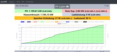

1.9.276 (2022-09-01 09:59:31 +0200 [d9d4c6f1] )
2022-09-05 11:34:12: PID: 23998: **** FATAL ********************************* (LV0) at 61 cleanup /var/www/html/openWB/regel.sh
2022-09-05 11:34:12: PID: 23998: **** FATAL Regulation loop needs 11 seconds (LV0) at 60 cleanup /var/www/html/openWB/regel.sh
2022-09-05 11:34:12: PID: 23998: **** FATAL ********************************* (LV0) at 59 cleanup /var/www/html/openWB/regel.sh
2022-09-05 11:34:12: PID: 23998: Phasen Umschaltung noch aktiv... beende (LV1) at 181 main /var/www/html/openWB/regel.sh
2022-09-05 11:34:12: PID: 23998: Zeit zum abfragen aller Werte 9 Sekunden (LV1) at 176 main /var/www/html/openWB/regel.sh
2022-09-05 11:34:12: PID: 25474: **** Regulation loop start **** (LV1) at 70 main /var/www/html/openWB/regel.sh
2022-09-05 11:34:11: PID: 23998: chargestatlp1 0 chargestatlp2 0 chargestatlp3 0 (LV1) at 1303 loadvars loadvars.sh
2022-09-05 11:34:11: PID: 23998: plugstatlp1 0 plugstatlp2 0 plugstatlp3 0 (LV1) at 1302 loadvars loadvars.sh
2022-09-05 11:34:11: PID: 23998: lp1enabled 1 lp2enabled 1 lp3enabled 1 (LV1) at 1301 loadvars loadvars.sh
2022-09-05 11:34:11: PID: 23998: EVU 1:V/-12A 2: V/6A 3: V/-7A (LV1) at 1300 loadvars loadvars.sh
2022-09-05 11:34:11: PID: 23998: lla3 0 llv3 234.9 llas13 0 llas23  soclp1 89 soclp2 89 (LV1) at 1299 loadvars loadvars.sh
2022-09-05 11:34:11: PID: 23998: lla2 0 llv2 235.2 llas12 0 llas22  sofortll 16 hausverbrauch 1198319 wattbezug -3264 uberschuss 3264 (LV1) at 1298 loadvars loadvars.sh
2022-09-05 11:34:11: PID: 23998: lla1 0 llv1 232.4 llas11 0 llas21  mindestuberschuss 1300 abschaltuberschuss 5 lademodus 2 (LV1) at 1297 loadvars loadvars.sh
2022-09-05 11:34:11: PID: 23998: pv1watt -1202840 pv2watt -1593 pvwatt -1204433 ladeleistung 0 llalt 0 nachtladen 0 nachtladen 0 minimalA 6 maximalA 16 (LV1) at 1296 loadvars loadvars.sh
2022-09-05 11:34:11: PID: 23998: speicherleistung 0 speichersoc 99 (LV1) at 1291 loadvars loadvars.sh

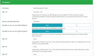

2022-09-05 11:34:04: PID: 2521: modules.sma_sunny_boy.device: SMA Modbus Hybrid: 0
2022-09-05 11:34:04: PID: 2521: modules.sma_sunny_boy.device: SMA Modbus Version: 0
2022-09-05 11:34:04: PID: 2521: modules.sma_sunny_boy.device: SMA Modbus weitere IPs: none, none, none
2022-09-05 11:34:04: PID: 2521: modules.sma_sunny_boy.device: SMA Modbus Webbox: 0
2022-09-05 11:34:04: PID: 2521: modules.sma_sunny_boy.device: SMA Modbus Ip-Adresse: 192.168.1.118
2022-09-05 11:34:04: PID: 2521: legacy run server: Received command ["modules.sma_sunny_boy.device","inverter","192.168.1.118","0","none","none","none","0","0","0","1"]

2022-09-05 11:33:57: PID: 2521: soc.modules.common.fault_state: Sma Sunny Boy/Tripower Wechselrichter: FaultState FaultStateLevel.ERROR, FaultStr TCP-Client konnte keine Verbindung zu 192.168.1.118:502 aufbauen. Bitte Einstellungen (IP-Adresse, ..) und Hardware-Anschluss prüfen., Traceback:
2022-09-05 11:33:57: PID: 2521: pymodbus.client.sync: Connection to (192.168.1.118, 502) failed: timed out
2022-09-05 11:33:54: PID: 2521: soc.modules.common.component_context: Update Komponente ['Sma Sunny Boy/Tripower Wechselrichter']
2022-09-05 11:33:54: PID: 2521: modules.sma_sunny_boy.device: SMA Modbus Hybrid: 0
2022-09-05 11:33:54: PID: 2521: modules.sma_sunny_boy.device: SMA Modbus Version: 0
2022-09-05 11:33:54: PID: 2521: modules.sma_sunny_boy.device: SMA Modbus weitere IPs: none, none, none
2022-09-05 11:33:54: PID: 2521: modules.sma_sunny_boy.device: SMA Modbus Webbox: 0
2022-09-05 11:33:54: PID: 2521: modules.sma_sunny_boy.device: SMA Modbus Ip-Adresse: 192.168.1.118
2022-09-05 11:33:54: PID: 2521: legacy run server: Received command ["modules.sma_sunny_boy.device","inverter","192.168.1.118","0","none","none","none","0","0","0","1"]
2022-09-05 11:33:52: PID: 21673: **** FATAL ********************************* (LV0) at 61 cleanup /var/www/html/openWB/regel.sh
2022-09-05 11:33:52: PID: 21673: **** FATAL Regulation loop needs 11 seconds (LV0) at 60 cleanup /var/www/html/openWB/regel.sh
2022-09-05 11:33:52: PID: 21673: **** FATAL ********************************* (LV0) at 59 cleanup /var/www/html/openWB/regel.sh
2022-09-05 11:33:52: PID: 21673: Phasen Umschaltung noch aktiv... beende (LV1) at 181 main /var/www/html/openWB/regel.sh
2022-09-05 11:33:52: PID: 21673: Zeit zum abfragen aller Werte 9 Sekunden (LV1) at 176 main /var/www/html/openWB/regel.sh
2022-09-05 11:33:51: PID: 22702: **** Regulation loop start **** (LV1) at 70 main /var/www/html/openWB/regel.sh
2022-09-05 11:33:51: PID: 21673: chargestatlp1 0 chargestatlp2 0 chargestatlp3 0 (LV1) at 1303 loadvars loadvars.sh
2022-09-05 11:33:51: PID: 21673: plugstatlp1 0 plugstatlp2 0 plugstatlp3 0 (LV1) at 1302 loadvars loadvars.sh
2022-09-05 11:33:51: PID: 21673: lp1enabled 1 lp2enabled 1 lp3enabled 1 (LV1) at 1301 loadvars loadvars.sh
2022-09-05 11:33:51: PID: 21673: EVU 1:V/-10A 2: V/7A 3: V/-5A (LV1) at 1300 loadvars loadvars.sh
2022-09-05 11:33:51: PID: 21673: lla3 0 llv3 234.4 llas13 0 llas23  soclp1 89 soclp2 89 (LV1) at 1299 loadvars loadvars.sh
2022-09-05 11:33:51: PID: 21673: lla2 0 llv2 234.8 llas12 0 llas22  sofortll 16 hausverbrauch 1196299 wattbezug -2177 uberschuss 2177 (LV1) at 1298 loadvars loadvars.sh
2022-09-05 11:33:51: PID: 21673: lla1 0 llv1 232.2 llas11 0 llas21  mindestuberschuss 1300 abschaltuberschuss 5 lademodus 2 (LV1) at 1297 loadvars loadvars.sh
2022-09-05 11:33:51: PID: 21673: pv1watt -1199811 pv2watt -1507 pvwatt -1201318 ladeleistung 0 llalt 0 nachtladen 0 nachtladen 0 minimalA 6 maximalA 16 (LV1) at 1296 loadvars loadvars.sh
2022-09-05 11:33:51: PID: 21673: speicherleistung 0 speichersoc 99 (LV1) at 1291 loadvars loadvars.sh
2022-09-05 11:33:51: PID: 22646: EVU RET: 0 (LV2) at 15 main modules/bezug_smashm/main.sh
2022-09-05 11:33:51: PID: 2521: legacy run server: Completed running command in 0.91s: ["modules.sma_shm.device","counter","1901703733"]
2022-09-05 11:33:51: PID: 2521: modules.sma_shm.device: Update complete
2022-09-05 11:33:51: PID: 2521: modules.sma_shm.device: All components updated
2022-09-05 11:33:51: PID: 2521: soc.modules.common.store._api: Saving CounterState(power=-2177.3, imported=6907435.2, exported=46022217.8, currents=[-10.896, 7.311, -5.786], power_factors=[0.997, 1.0, 0.996], powers=[-2521.7, 1698.3, -1353.9], voltages=[234.864, 233.172, 235.537], frequency=49.984)
2022-09-05 11:33:51: PID: 2521: soc.modules.common.component_context: Update Komponente ['SMA Home Manager Zähler']
2022-09-05 11:33:50: PID: 2521: soc.modules.common.component_context: Update Komponenten ['SMA Home Manager Zähler']
2022-09-05 11:33:50: PID: 2521: modules.sma_shm.device: Beginning update
2022-09-05 11:33:50: PID: 2521: legacy run server: Received command ["modules.sma_shm.device","counter","1901703733"]
2022-09-05 11:33:48: PID: 21673: Calling SoC-Module: modules/soc_http/main.sh for chargepoint 2 (LV2) at 23 run_soc_module loadvars.sh
2022-09-05 11:33:48: PID: 21673: Request to run SoC-Module: soc_httplp2 (LV2) at 4 run_soc_module loadvars.sh
2022-09-05 11:33:47: PID: 22444: RET: 0 (LV2) at 12 main modules/wr_tripower9000/main.sh
2022-09-05 11:33:47: PID: 2521: legacy run server: Completed running command in 3.03s: ["modules.sma_sunny_boy.device","inverter","192.168.1.118","0","none","none","none","0","0","0","1"]
modules.common.fault_state.FaultState: ('TCP-Client konnte keine Verbindung zu 192.168.1.118:502 aufbauen. Bitte Einstellungen (IP-Adresse, ..) und Hardware-Anschluss prüfen.', <FaultStateLevel.ERROR: 2>)
" aufbauen. Bitte Einstellungen (IP-Adresse, ..) und " + "Hardware-Anschluss prüfen.") from e
File "/var/www/html/openWB/packages/modules/common/modbus.py", line 93, in __read_registers
power_total = self.__tcp_client.read_holding_registers(30775, ModbusDataType.INT_32, unit=3)
File "/var/www/html/openWB/packages/modules/sma_sunny_boy/inverter.py", line 37, in read
state, produces_dc_power = inverter1.read()
File "/var/www/html/openWB/packages/modules/sma_sunny_boy/device.py", line 169, in read_inverter
