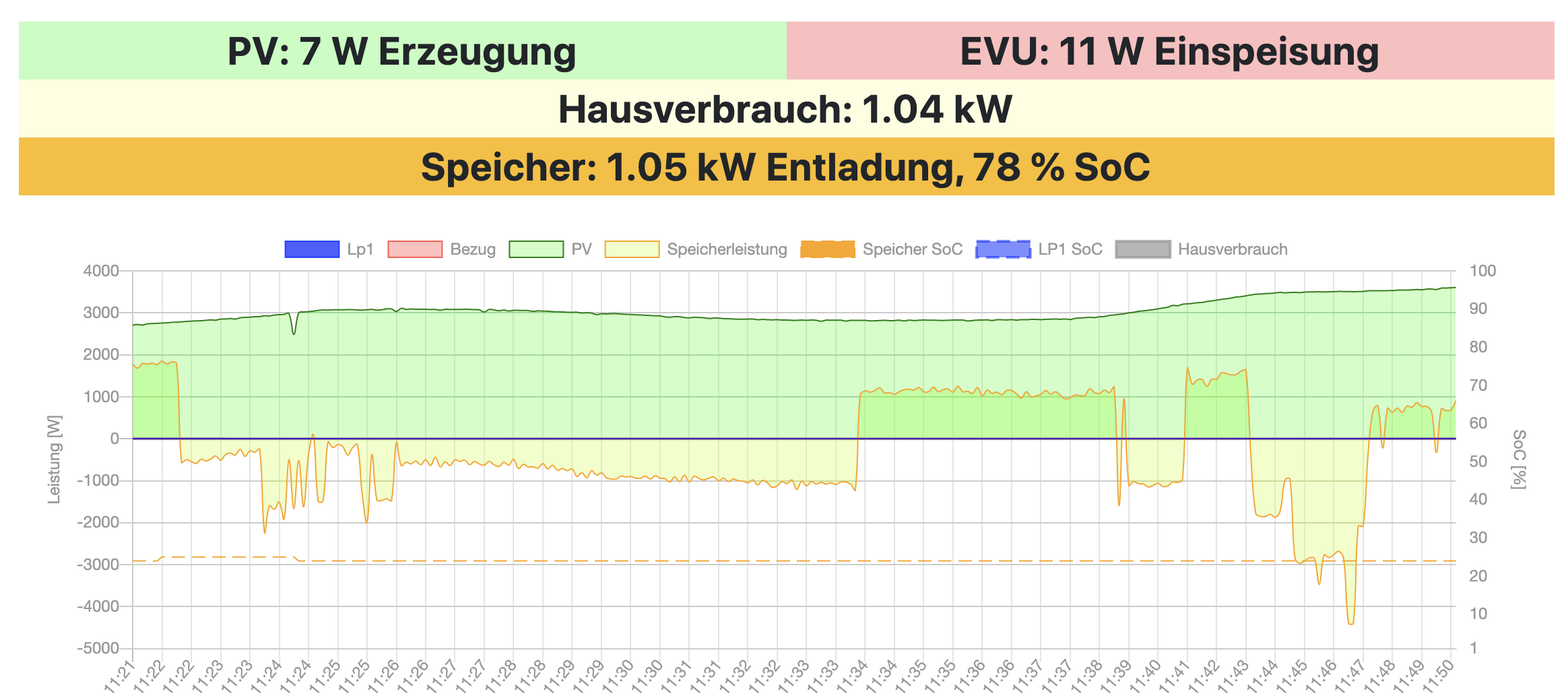

Einfach erklärt. Oben in der Titelleiste steht 78% SoC für meine Powerwalls. Unten im Graphen sieht man eher sowas um die 25%. Tesla Gateway LAN meldet 24%.
Der Speicher scheint generell komisch. Endlädt konstant mit 1.05 kW egal was der Graph macht.
Ideen? Ist auf zwei Browsern so.
Stelle auch gerade fest dass ich den Graphen nicht mehr ändern kann?
Cache löschen hab ich auch schon probiert.

Was ergibt der Aufruf im Browser:
https://IPDERPOWERWALL/api/meters/aggregates
bzw.
https://IPDERPOWERWALL/api/system_status/soe

Re: SoC Powerwall falsch in der Titelleiste
{"site":{"last_communication_time":"2020-03-26T11:34:38.991560794+01:00","instant_power":-22,"instant_reactive_power":-881,"instant_apparent_power":881.2746450454591,"frequency":0,"energy_exported":80975,"energy_imported":103839,"instant_average_voltage":394.1743492838332,"instant_total_current":0,"i_a_current":0,"i_b_current":0,"i_c_current":0,"timeout":1500000000},"battery":{"last_communication_time":"2020-03-26T11:34:38.99092258+01:00","instant_power":-1160,"instant_reactive_power":0,"instant_apparent_power":1160,"frequency":50.032,"energy_exported":592790,"energy_imported":756760,"instant_average_voltage":226.65,"instant_total_current":24.8,"i_a_current":0,"i_b_current":0,"i_c_current":0,"timeout":1500000000},"load":{"last_communication_time":"2020-03-26T11:34:38.990110627+01:00","instant_power":1650.2775622055274,"instant_reactive_power":-702.2002005328013,"instant_apparent_power":1793.4606641761966,"frequency":0,"energy_exported":0,"energy_imported":766913.6452777777,"instant_average_voltage":394.1743492838332,"instant_total_current":4.18666908489576,"i_a_current":0,"i_b_current":0,"i_c_current":0,"timeout":1500000000},"solar":{"last_communication_time":"2020-03-26T11:34:38.990110627+01:00","instant_power":2825.2081604003906,"instant_reactive_power":145.04804611206055,"instant_apparent_power":2828.929141083934,"frequency":50.049781799316406,"energy_exported":908307.4005567343,"energy_imported":287.75527895664254,"instant_average_voltage":311.1787924399875,"instant_total_current":0,"i_a_current":0,"i_b_current":0,"i_c_current":0,"timeout":1500000000}}
bzw.
{"percentage":23.89302615649877}
Anzeige im openWB immernoch unverändert 1.05 kW und 78% SoC
bzw.

Stimmt die Anzeige im Standard Theme?
nein
ich sehe auch keinen Hausverbrauch fällt mir gerade auf ...

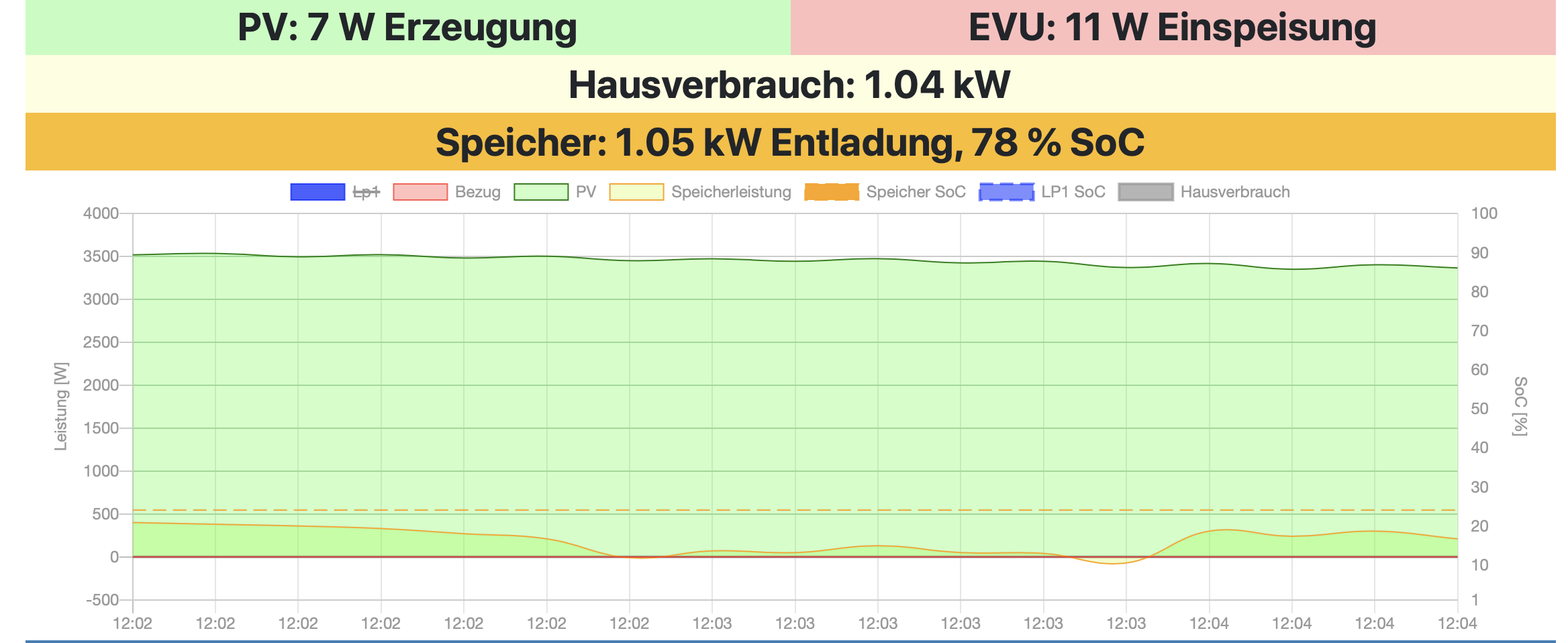

Update mal bitte auf die Nightly und mache einen Neustart.
Nightly läuft. reboot gemacht. Cache geleert.
selbes Problem :
Powerwall 1.05 kW Entladung / 78% SoC
Kein Hausverbrauch
selbes Problem :
Kein Hausverbrauch
Bitte mal Debug Daten senden und in der Fehlerbeschreibung auf diesen Thread verlinken.
Welcher Debug Modus?
Egal, der wird automatisch gesetzt
