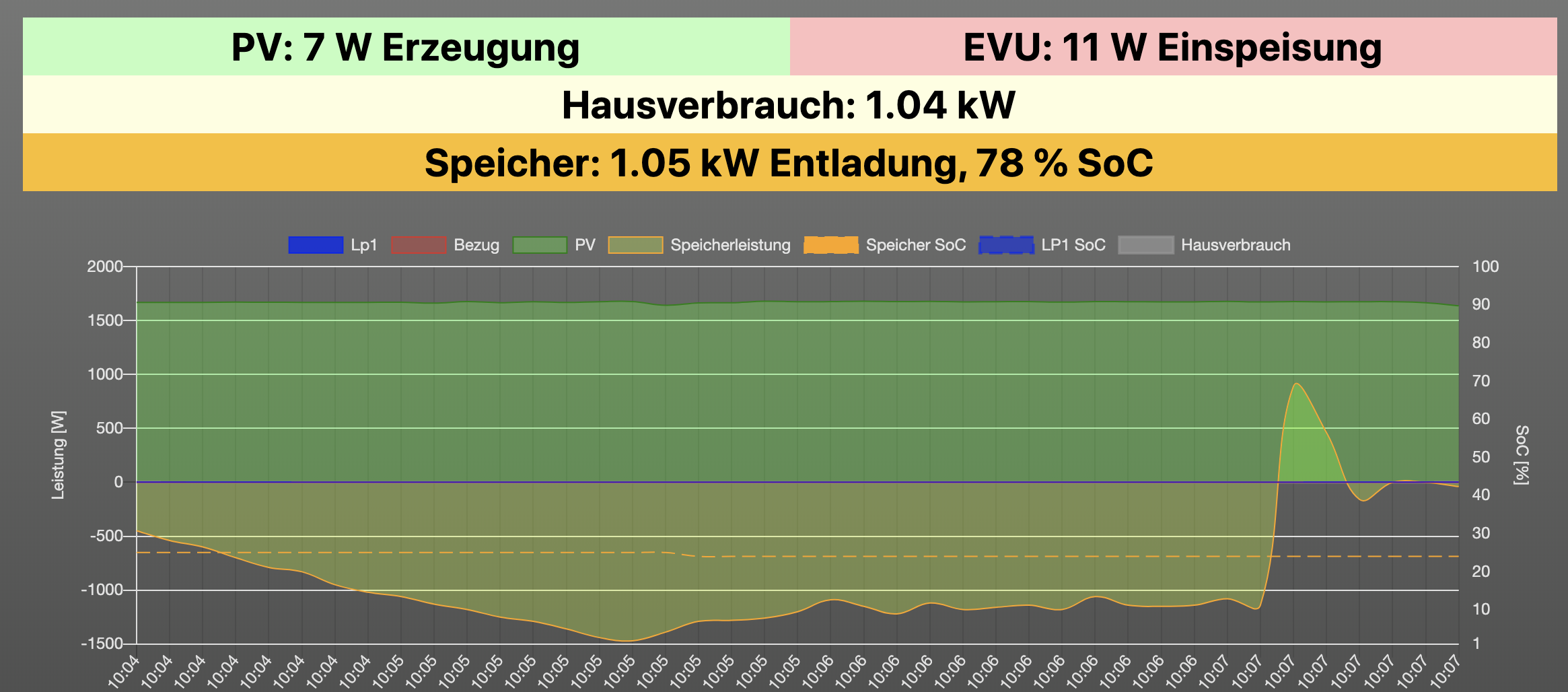

SoC Powerwall falsch in der Titelleiste
Beitrag von bergler82 »
(316.92 KiB) 324-mal heruntergeladen
Einfach erklärt. Oben in der Titelleiste steht 78% SoC für meine Powerwalls. Unten im Graphen sieht man eher sowas um die 25%. Tesla Gateway LAN meldet 24%.
Der Speicher scheint generell komisch. Endlädt konstant mit 1.05 kW egal was der Graph macht.
Ideen? Ist auf zwei Browsern so.
Stelle auch gerade fest dass ich den Graphen nicht mehr ändern kann?
Cache löschen hab ich auch schon probiert.
OpenWB Standalone

{"site":{"last_communication_time":"2020-03-26T11:34:38.991560794+01:00","instant_power":-22,"instant_reactive_power":-881,"instant_apparent_power":881.2746450454591,"frequency":0,"energy_exported":80975,"energy_imported":103839,"instant_average_voltage":394.1743492838332,"instant_total_current":0,"i_a_current":0,"i_b_current":0,"i_c_current":0,"timeout":1500000000},"battery":{"last_communication_time":"2020-03-26T11:34:38.99092258+01:00","instant_power":-1160,"instant_reactive_power":0,"instant_apparent_power":1160,"frequency":50.032,"energy_exported":592790,"energy_imported":756760,"instant_average_voltage":226.65,"instant_total_current":24.8,"i_a_current":0,"i_b_current":0,"i_c_current":0,"timeout":1500000000},"load":{"last_communication_time":"2020-03-26T11:34:38.990110627+01:00","instant_power":1650.2775622055274,"instant_reactive_power":-702.2002005328013,"instant_apparent_power":1793.4606641761966,"frequency":0,"energy_exported":0,"energy_imported":766913.6452777777,"instant_average_voltage":394.1743492838332,"instant_total_current":4.18666908489576,"i_a_current":0,"i_b_current":0,"i_c_current":0,"timeout":1500000000},"solar":{"last_communication_time":"2020-03-26T11:34:38.990110627+01:00","instant_power":2825.2081604003906,"instant_reactive_power":145.04804611206055,"instant_apparent_power":2828.929141083934,"frequency":50.049781799316406,"energy_exported":908307.4005567343,"energy_imported":287.75527895664254,"instant_average_voltage":311.1787924399875,"instant_total_current":0,"i_a_current":0,"i_b_current":0,"i_c_current":0,"timeout":1500000000}}
bzw.
{"percentage":23.89302615649877}
Anzeige im openWB immernoch unverändert 1.05 kW und 78% SoC
