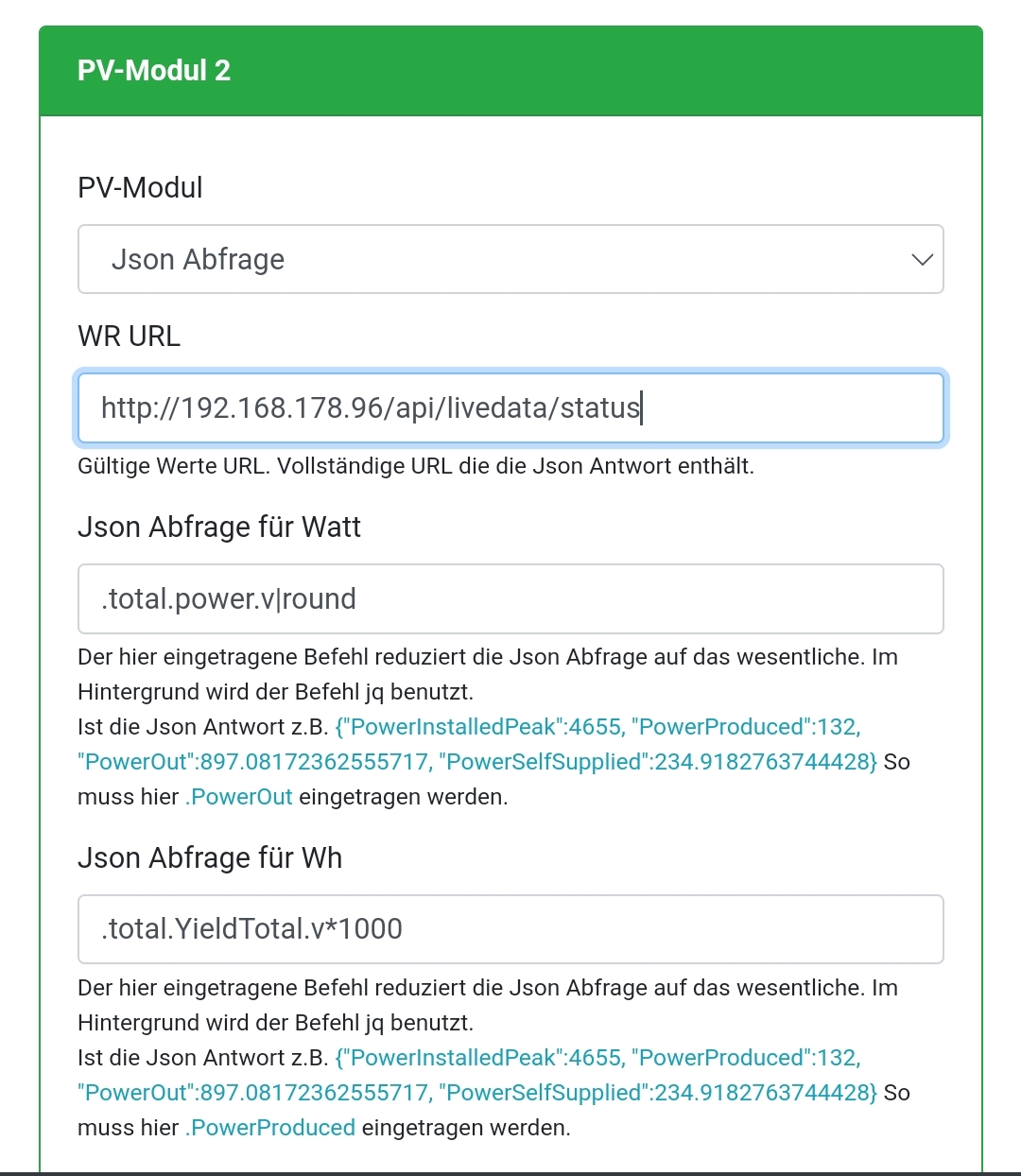

Du hast recht.35 kWh sind es mittlerweile. Ich hatte den Tagesertag dahinter vermutet, aber es ist ja der Gesamtertrag. Die 0.652 kann ich mir auch nicht erklären.
Ich frage mit dem String
http://192.168.178.96/api/livedata/status
ab. Vielleicht liegt da der Fehler. Damit werden mir aber die Werte aus der . txt angezeigt.
Json abfrage PV

Dann ruf das noch mal ab, was hinter der URL kommt und schreib es hier rein. Besser aber als Code Block oben das </> Icon

{"inverters":[{"serial":"116484422211","name":"BKW Gartenhaus","order":0,"data_age":0,"poll_enabled":true,"reachable":true,"producing":true,"limit_relative":37.5,"limit_absolute":600,"AC":{"0":{"Power":{"v":29.39999962,"u":"W","d":1},"Voltage":{"v":230.1999969,"u":"V","d":1},"Current":{"v":0.119999997,"u":"A","d":2},"Power DC":{"v":30.80000114,"u":"W","d":1},"YieldDay":{"v":4108,"u":"Wh","d":0},"YieldTotal":{"v":36.10100174,"u":"kWh","d":3},"Frequency":{"v":50,"u":"Hz","d":2},"PowerFactor":{"v":0.999000013,"u":"","d":3},"ReactivePower":{"v":0,"u":"var","d":1},"Efficiency":{"v":95.45453644,"u":"%","d":3}}},"DC":{"0":{"name":{"u":""},"Power":{"v":7.800000191,"u":"W","d":1},"Voltage":{"v":38.90000153,"u":"V","d":1},"Current":{"v":0.200000003,"u":"A","d":2},"YieldDay":{"v":1018,"u":"Wh","d":0},"YieldTotal":{"v":8.272000313,"u":"kWh","d":3},"Irradiation":{"v":1.793103456,"u":"%","d":3}},"1":{"name":{"u":""},"Power":{"v":7.900000095,"u":"W","d":1},"Voltage":{"v":38.40000153,"u":"V","d":1},"Current":{"v":0.200000003,"u":"A","d":2},"YieldDay":{"v":1036,"u":"Wh","d":0},"YieldTotal":{"v":8.734000206,"u":"kWh","d":3},"Irradiation":{"v":1.816092014,"u":"%","d":3}},"2":{"name":{"u":""},"Power":{"v":7.5,"u":"W","d":1},"Voltage":{"v":38.79999924,"u":"V","d":1},"Current":{"v":0.189999998,"u":"A","d":2},"YieldDay":{"v":1020,"u":"Wh","d":0},"YieldTotal":{"v":9.232000351,"u":"kWh","d":3},"Irradiation":{"v":1.724137902,"u":"%","d":3}},"3":{"name":{"u":""},"Power":{"v":7.599999905,"u":"W","d":1},"Voltage":{"v":38.70000076,"u":"V","d":1},"Current":{"v":0.189999998,"u":"A","d":2},"YieldDay":{"v":1034,"u":"Wh","d":0},"YieldTotal":{"v":9.862999916,"u":"kWh","d":3},"Irradiation":{"v":1.74712646,"u":"%","d":3}}},"INV":{"0":{"Temperature":{"v":21.20000076,"u":"°C","d":1}}},"events":1}],"total":{"Power":{"v":29.39999962,"u":"W","d":1},"YieldDay":{"v":4108,"u":"Wh","d":0},"YieldTotal":{"v":36.10100174,"u":"kWh","d":3}},"hints":{"time_sync":false,"radio_problem":false,"default_password":false}}

Ich habe es hinbekommen, Dank deiner Unterstützung.
Vielen Dank dafür.
