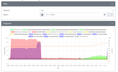

Der SoC des Victron Hausspeichers wird nach dem Update von Beta2 auf Beta 3 falsch angezeigt. Statt 36% werden 54% angegeben.
Nach dem Neustart der openWB wurden die Daten korrekt dargestellt. Main Log wurde gesichert.

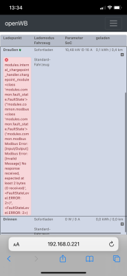

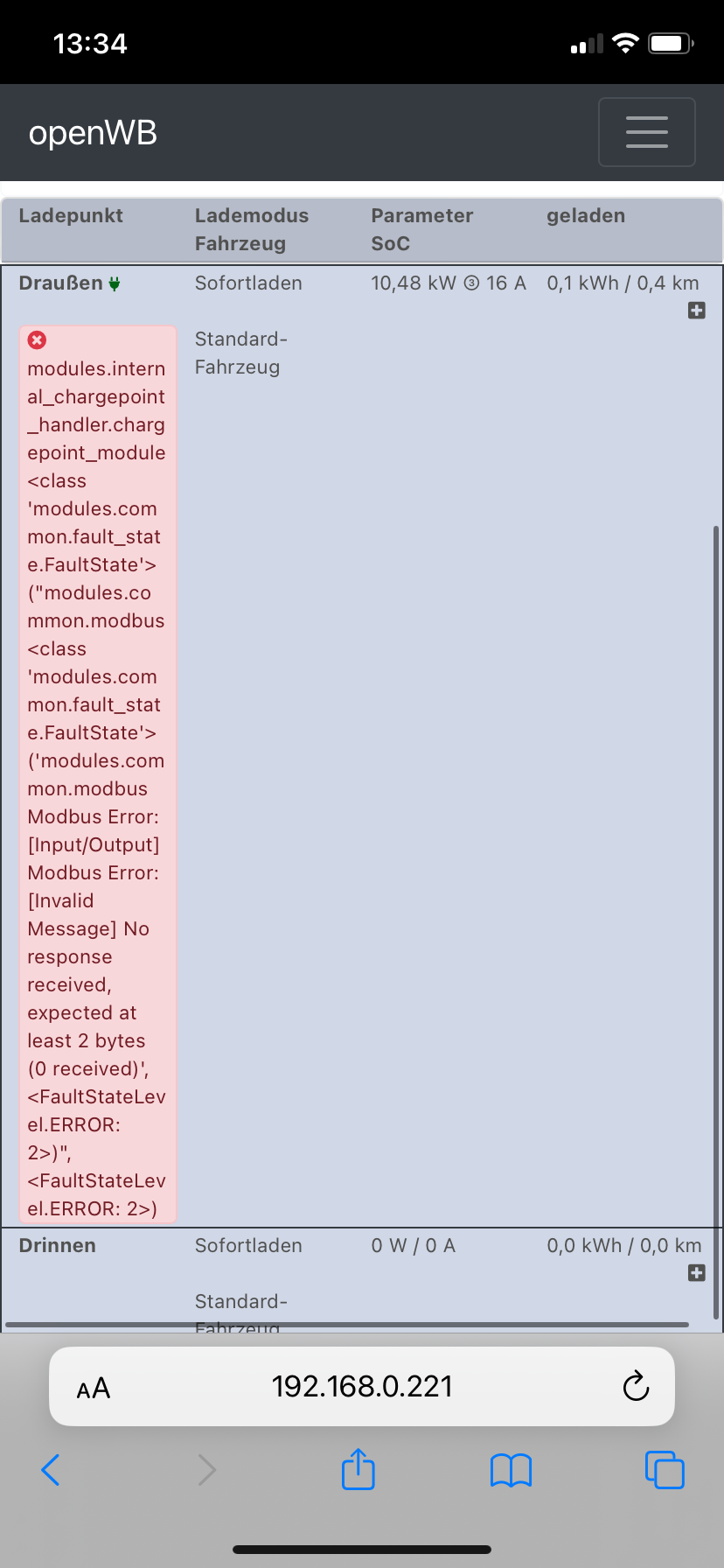

diese Meldung erscheint beim Laden von Zeit zu Zeit für 2-5 Sekunden und verschwindet wieder.
2023-11-18 14:18:13,758 - {modules.internal_chargepoint_handler.internal_chargepoint_handler:183} - {DEBUG:Internal Chargepoint} - ***Start***
2023-11-18 14:18:13,761 - {modules.internal_chargepoint_handler.internal_chargepoint_handler:185} - {DEBUG:Internal Chargepoint} - {'cp0': InternalChargepoint(data=InternalChargepointData(cp_interruption_duration=0, parent_cp='5', phases_to_use=3, set_current=0, trigger_phase_switch=False), get=Get(charge_state=False, currents=[0.0, 0.0, 0.0], evse_current=0, exported=0, fault_str='Kein Fehler.', fault_state=0, imported=2678980.96, phases_in_use=0, plug_state=False, power=0, rfid_timestamp=None, rfid=None, voltages=[235.41, 235.85, 238.01])), 'cp1': InternalChargepoint(data=InternalChargepointData(cp_interruption_duration=0, parent_cp='6', phases_to_use=3, set_current=0, trigger_phase_switch=False), get=Get(charge_state=False, currents=[0.0, 0.0, 0.0], evse_current=0, exported=0, fault_str='Kein Fehler.', fault_state=0, imported=7027228.52, phases_in_use=0, plug_state=False, power=0, rfid_timestamp=None, rfid=None, voltages=[238.09, 235.3, 235.47])), 'global_data': GlobalHandlerData(heartbeat=1700313490, parent_ip='localhost', configured=True), 'rfid_data': RfidData(last_tag='')}
2023-11-18 14:18:13,766 - {modules.common.component_context:24} - {DEBUG:Internal Chargepoint} - Update Komponente ['Ladepunkt 0']
2023-11-18 14:18:14,315 - {modules.common.evse:43} - {DEBUG:Internal Chargepoint} - Gesetzte Stromstärke EVSE: 0, Status: 1, Modbus-ID: 1

2023-11-18 14:29:56,875 - {modules.common.evse:57} - {DEBUG:Internal Chargepoint} - FW-Version: 12
2023-11-18 14:29:56,933 - {modules.common.fault_state:55} - {ERROR:Internal Chargepoint} - Ladepunkt 0: FaultState FaultStateLevel.ERROR, FaultStr modules.internal_chargepoint_handler.chargepoint_module <class 'modules.common.fault_state.FaultState'> ("modules.common.modbus <class 'modules.common.fault_state.FaultState'> ('modules.common.modbus Modbus Error: [Input/Output] Modbus Error: [Invalid Message] No response received, expected at least 2 bytes (0 received)', <FaultStateLevel.ERROR: 2>)", <FaultStateLevel.ERROR: 2>), Traceback:
File "/var/www/html/openWB/packages/modules/common/modbus.py", line 90, in __read_registers
modules.common.fault_state.FaultState: ('modules.common.modbus Modbus Error: [Input/Output] Modbus Error: [Invalid Message] No response received, expected at least 2 bytes (0 received)', <FaultStateLevel.ERROR: 2>)
File "/var/www/html/openWB/packages/modules/internal_chargepoint_handler/chargepoint_module.py", line 80, in get_values
plug_state, charge_state, self.set_current_evse = self.__client.evse_client.get_plug_charge_state()
File "/var/www/html/openWB/packages/modules/common/evse.py", line 39, in get_plug_charge_state
set_current, _, state_number = self.client.read_holding_registers(
File "/var/www/html/openWB/packages/modules/common/modbus.py", line 123, in read_holding_registers
return self.__read_registers(
File "/var/www/html/openWB/packages/modules/common/modbus.py", line 105, in __read_registers
modules.common.fault_state.FaultState: ("modules.common.modbus <class 'modules.common.fault_state.FaultState'> ('modules.common.modbus Modbus Error: [Input/Output] Modbus Error: [Invalid Message] No response received, expected at least 2 bytes (0 received)', <FaultStateLevel.ERROR: 2>)", <FaultStateLevel.ERROR: 2>)
File "/var/www/html/openWB/packages/modules/internal_chargepoint_handler/internal_chargepoint_handler.py", line 240, in update
state = self.module.get_values(phase_switch_cp_active, rfid_data.last_tag)[0]
File "/var/www/html/openWB/packages/modules/internal_chargepoint_handler/chargepoint_module.py", line 125, in get_values
raise FaultState.error(__name__ + " " + str(type(e)) + " " + str(e)) from e
modules.common.fault_state.FaultState: ('modules.internal_chargepoint_handler.chargepoint_module <class \'modules.common.fault_state.FaultState\'> ("modules.common.modbus <class \'modules.common.fault_state.FaultState\'> (\'modules.common.modbus Modbus Error: [Input/Output] Modbus Error: [Invalid Message] No response received, expected at least 2 bytes (0 received)\', <FaultStateLevel.ERROR: 2>)", <FaultStateLevel.ERROR: 2>)', <FaultStateLevel.ERROR: 2>)
2023-11-18 14:37:19,691 - {modules.common.evse:57} - {DEBUG:Internal Chargepoint} - FW-Version: 12
2023-11-18 14:37:19,739 - {modules.common.fault_state:55} - {ERROR:Internal Chargepoint} - Ladepunkt 0: FaultState FaultStateLevel.ERROR, FaultStr modules.internal_chargepoint_handler.chargepoint_module <class 'modules.common.fault_state.FaultState'> ("modules.common.modbus <class 'modules.common.fault_state.FaultState'> ('modules.common.modbus Modbus Error: [Input/Output] Modbus Error: [Invalid Message] No response received, expected at least 2 bytes (0 received)', <FaultStateLevel.ERROR: 2>)", <FaultStateLevel.ERROR: 2>), Traceback:
2023-11-18 14:43:32,856 - {modules.common.evse:57} - {DEBUG:Internal Chargepoint} - FW-Version: 12
2023-11-18 14:43:32,905 - {modules.common.fault_state:55} - {ERROR:Internal Chargepoint} - Ladepunkt 1: FaultState FaultStateLevel.ERROR, FaultStr modules.internal_chargepoint_handler.chargepoint_module <class 'modules.common.fault_state.FaultState'> ("modules.common.modbus <class 'modules.common.fault_state.FaultState'> ('modules.common.modbus Modbus Error: [Input/Output] Modbus Error: [Invalid Message] No response received, expected at least 2 bytes (0 received)', <FaultStateLevel.ERROR: 2>)", <FaultStateLevel.ERROR: 2>), Traceback:

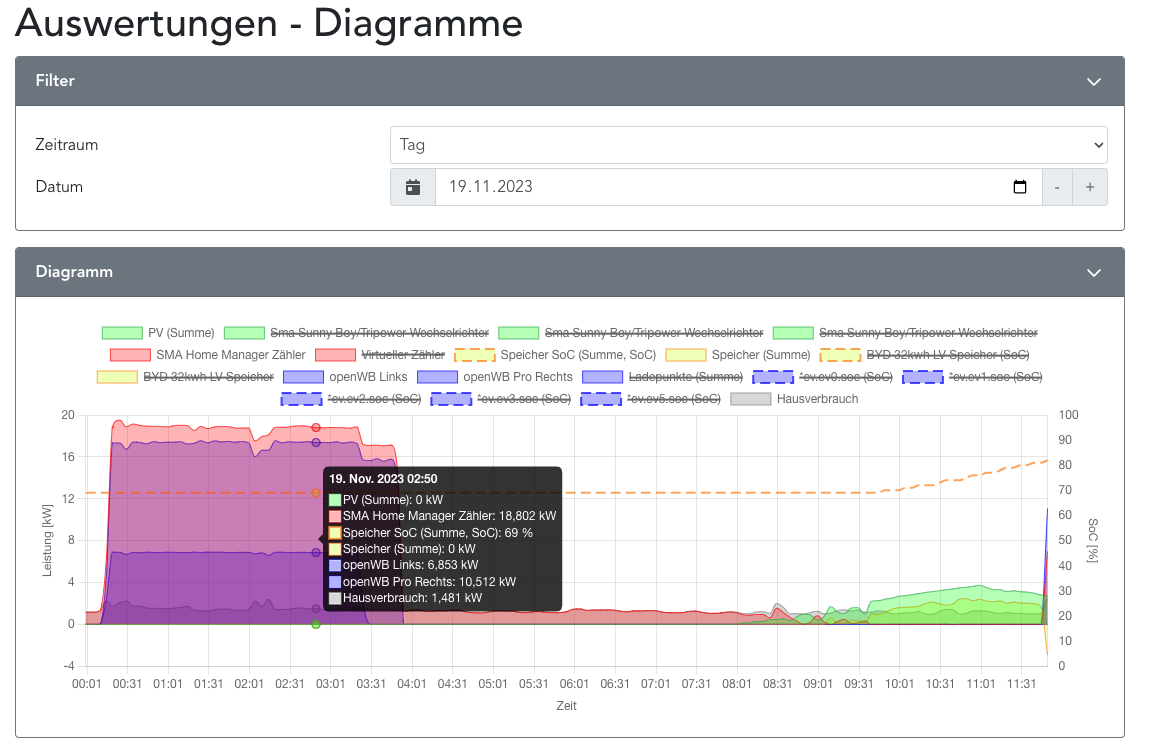

wenn ich bei Auswertungen-Diagramme beide Wallboxen auswähle aber nicht die Summe der Ladepunkte, zeigt das Diagram für die Zweite Wallbox (bei mir "OpenWB Pro Rechts") die Summe aus der ersten und zweiten Wallbox an. Wenn ich mit dem Cursor über den Zeitpunkt gehe, zeigt er aber die richtigen Werte in der kleinen Tabelle an. Wenn ich die erste Wallbox ausblende, zeigt er die richtige Linie für die zweite Wallbox an. Siehe auch die zwei Screenshots im Anhang.
Beste Grüße
Philipp
Beste Grüße
Philipp

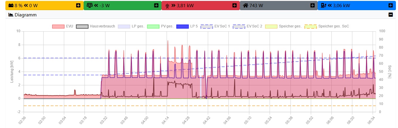

Soll das so? Zielladen war aktiv.
- 20231120_main.txt
- (92 KiB) 122-mal heruntergeladen
Re: Rückmeldungen 2.1.2 Beta 3
Das Diagramm sieht bei mir auch so aus, allerdings treten die Spitzen nur zu den Zeiten auf, in denen der SoC auf 0% steht (anderes Thema hier im Thread).Nasdero hat geschrieben: Mo Nov 20, 2023 5:44 am Soll das so? Zielladen war aktiv.
Eine Frage: stoppt bei Dir das Zielladen zur konfigurierten Uhrzeit? Bei mir nicht, aber das könnte auch an den sporadischen 0% SoC Werten liegen...
