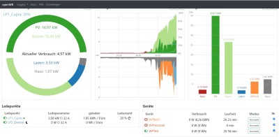

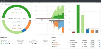

Kein plan, zeigt er immer an wenn die WP nicht läuft.
Wenn sie läuft passt alles, siehe
Ich kann kein CMD mit der Adresse absetzen, nur Im Chrome, passt das?
{"wifi_sta":{"connected":true,"ssid":"FRANZ-HOME","ip":"192.168.188.230","rssi":-63},"cloud":{"enabled":true,"connected":true},"mqtt":{"connected":false},"time":"14:23","unixtime":1650371009,"serial":251,"has_update":false,"mac":"C45BBE78FC52","cfg_changed_cnt":0,"actions_stats":{"skipped":0},"relays":[{"ison":true,"has_timer":false,"timer_started":0,"timer_duration":0,"timer_remaining":0,"overpower":false,"is_valid":true,"source":"http"}],"emeters":[{"power":1220.88,"pf":0.71,"current":7.27,"voltage":237.96,"is_valid":true,"total":95645.0,"total_returned":1360.9},{"power":1207.50,"pf":0.67,"current":7.48,"voltage":242.39,"is_valid":true,"total":85822.2,"total_returned":0.0},{"power":1118.68,"pf":0.63,"current":7.30,"voltage":241.81,"is_valid":true,"total":84025.7,"total_returned":0.0}],"total_power":3547.06,"fs_mounted":true,"update":{"status":"idle","has_update":false,"new_version":"20220324-123835/v1.11.8-3EM-fix-g0014dcb","old_version":"20220324-123835/v1.11.8-3EM-fix-g0014dcb"},"ram_total":49440,"ram_free":29796,"fs_size":233681,"fs_free":156875,"uptime":5002}
