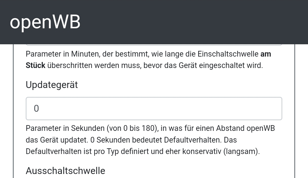

Aber siehe Hier
2025-07-14 09:42:29,671 - Mq pub openWB/LegacySmartHome/Devices/1/Watt=2115 old 903
2025-07-14 09:42:29,685 - Mq pub openWB/LegacySmartHome/Devices/1/Wh=12840086 old 12840063
2025-07-14 09:42:29,700 - Mq pub openWB/LegacySmartHome/Devices/1/WHImported_temp=46224309600 old 46224226800
2025-07-14 09:42:29,702 - Mq pub openWB/LegacySmartHome/Devices/2/RunningTimeToday=4221 old 4161
2025-07-14 09:42:29,702 - Mq pub openWB/LegacySmartHome/Devices/3/RunningTimeToday=3981 old 3921
2025-07-14 09:42:29,703 - Mq pub openWB/LegacySmartHome/Devices/4/TemperatureSensor0=21.0 old 22.0
2025-07-14 09:42:29,704 - Mq pub openWB/LegacySmartHome/Devices/4/Watt=572 old 634
2025-07-14 09:42:29,707 - Mq pub openWB/LegacySmartHome/Devices/4/Wh=964507 old 964495
2025-07-14 09:42:29,708 - Mq pub openWB/LegacySmartHome/Devices/4/WHImported_temp=3472225200 old 3472182000
2025-07-14 09:42:29,709 - Mq pub openWB/LegacySmartHome/Devices/5/TemperatureSensor0=22.6 old 22.7
2025-07-14 09:42:29,710 - Mq pub openWB/LegacySmartHome/Devices/5/Wh=1077640 old 1077639
2025-07-14 09:42:29,711 - Mq pub openWB/LegacySmartHome/Devices/5/WHImported_temp=3879504000 old 3879500400
2025-07-14 09:42:29,712 - Mq pub openWB/LegacySmartHome/Devices/6/TemperatureSensor0=25.5 old 25.4
2025-07-14 09:42:29,713 - Mq pub openWB/LegacySmartHome/Devices/6/Watt=6 old 7
2025-07-14 09:42:29,714 - Mq pub openWB/LegacySmartHome/Devices/8/RunningTimeToday=2621 old 2562
2025-07-14 09:42:29,715 - Mq pub openWB/LegacySmartHome/Status/wattnichtschalt=2835 old 1686
2025-07-14 09:42:29,716 - Mq pub openWB/LegacySmartHome/Status/wattnichtHaus=2835 old 1686
2025-07-14 09:42:29,717 - Mq pub openWB/LegacySmartHome/Status/uberschuss=4315 old 3563
2025-07-14 09:42:29,718 - Mq pub openWB/LegacySmartHome/Status/uberschussoffset=-10685 old -11437
2025-07-14 09:43:23,698 - Mq pub openWB/LegacySmartHome/Devices/1/Watt=2826 old 2115
2025-07-14 09:43:23,728 - Mq pub openWB/LegacySmartHome/Devices/1/Wh=12840119 old 12840086
2025-07-14 09:43:23,736 - Mq pub openWB/LegacySmartHome/Devices/1/WHImported_temp=46224428400 old 46224309600
2025-07-14 09:43:23,760 - Mq pub openWB/LegacySmartHome/Devices/2/RunningTimeToday=4275 old 4221
2025-07-14 09:43:23,762 - Mq pub openWB/LegacySmartHome/Devices/3/RunningTimeToday=4034 old 3981
2025-07-14 09:43:23,790 - Mq pub openWB/LegacySmartHome/Devices/4/TemperatureSensor0=22.0 old 21.0
2025-07-14 09:43:23,792 - Mq pub openWB/LegacySmartHome/Devices/4/Watt=471 old 572
2025-07-14 09:43:23,798 - Mq pub openWB/LegacySmartHome/Devices/4/Wh=964513 old 964507
2025-07-14 09:43:23,812 - Mq pub openWB/LegacySmartHome/Devices/4/WHImported_temp=3472246800 old 3472225200
2025-07-14 09:43:23,820 - Mq pub openWB/LegacySmartHome/Devices/5/TemperatureSensor0=22.8 old 22.6
2025-07-14 09:43:23,828 - Mq pub openWB/LegacySmartHome/Devices/5/TemperatureSensor2=23.9 old 23.8
2025-07-14 09:43:23,834 - Mq pub openWB/LegacySmartHome/Devices/6/TemperatureSensor0=25.4 old 25.5
2025-07-14 09:43:23,840 - Mq pub openWB/LegacySmartHome/Devices/8/RunningTimeToday=2675 old 2621
2025-07-14 09:43:23,848 - Mq pub openWB/LegacySmartHome/Devices/9/TemperatureSensor0=39.9 old 40.1
2025-07-14 09:43:23,858 - Mq pub openWB/LegacySmartHome/Devices/9/TemperatureSensor1=37.6 old 37.8
2025-07-14 09:43:23,877 - Mq pub openWB/LegacySmartHome/Devices/9/Watt=55 old 46
2025-07-14 09:43:23,884 - Mq pub openWB/LegacySmartHome/Devices/9/Wh=8730048 old 8730047
2025-07-14 09:43:23,888 - Mq pub openWB/LegacySmartHome/Devices/9/WHImported_temp=31428172800 old 31428169200
2025-07-14 09:43:23,894 - Mq pub openWB/LegacySmartHome/Status/wattnichtschalt=3454 old 2835
2025-07-14 09:43:23,896 - Mq pub openWB/LegacySmartHome/Status/wattnichtHaus=3454 old 2835
2025-07-14 09:43:23,922 - Mq pub openWB/LegacySmartHome/Status/uberschuss=4611 old 4315
2025-07-14 09:43:23,933 - Mq pub openWB/LegacySmartHome/Status/uberschussoffset=-10389 old -10685
Das ist eine Minute später
Gero weist du das ob man das mit Update gerät ändern kann?

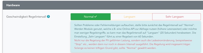

Meth hat geschrieben: Mo Jul 14, 2025 7:45 am Gero weist du das ob man das mit Update gerät ändern kann?
Der Takt kommt aus dieser Einstellung hier (Einstellungen - Allgemein) - "Normal" sind 10s, bei den anderen kenne ich die Intervalllänge nicht:
Updategerät ist es vermutlich nicht, da ja der smarthomehandler im openWB-Regeltakt aufgerufen wird.

Gero hat geschrieben: Mo Jul 14, 2025 9:09 am
Das ganze log ist voll mit Watt Aktualisierungen im Abstand von einer Minute
Siehe
https://paste.openwb.de/vdvCfXB0cBEoQi8
Die Regelgeschwindigkeit ist auf normal.
Sind alles sdm zähler an pe11 / ee11 über separate Leistungsmessung.
Ein abfrage intervall von einer Minute ist halt
Konträr zu den regelintervall von 10 Sekunden.
Ich test mal wenn man das ändert ?
