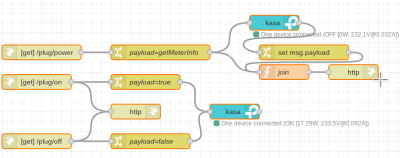

Eigentlich macht das mit NodeRED richtig Laune. Es gibt natürlich auch für NodeRED fertige Plugins um die Steckdosen anzusteuern. Um das ganze mit der openWB zu verheiraten geht es mit diesem Flow:
[{"id":"bb4a131e.edd938","type":"kasa","z":"6205088.b1c0ef8","name":"","device":"YOUR_HOST","interval":"0","eventInterval":"0","payload":"getInfo","payloadType":"info","debug":false,"x":610,"y":300,"wires":[["c40c17f0.bb8708"]]},{"id":"45d9f9b8.b347c","type":"http in","z":"6205088.b1c0ef8","name":"","url":"/plug/power","method":"get","upload":false,"swaggerDoc":"","x":140,"y":360,"wires":[["995a6ff.a9ba71"]]},{"id":"995a6ff.a9ba71","type":"change","z":"6205088.b1c0ef8","name":"payload=getMeterInfo","rules":[{"t":"set","p":"payload","pt":"msg","to":"getMeterInfo","tot":"str"}],"action":"","property":"","from":"","to":"","reg":false,"x":380,"y":360,"wires":[["bb4a131e.edd938","8f845e5a.fcf62"]]},{"id":"7178e7dc.822088","type":"http response","z":"6205088.b1c0ef8","name":"","statusCode":"","headers":{},"x":770,"y":400,"wires":[]},{"id":"c40c17f0.bb8708","type":"change","z":"6205088.b1c0ef8","name":"","rules":[{"t":"set","p":"payload","pt":"msg","to":"$round(payload.power)\t","tot":"jsonata"}],"action":"","property":"","from":"","to":"","reg":false,"x":670,"y":360,"wires":[["8f845e5a.fcf62"]]},{"id":"e63507c8.c8b258","type":"kasa","z":"6205088.b1c0ef8","name":"","device":"YOUR_HOST","interval":"0","eventInterval":"0","payload":"getInfo","payloadType":"info","debug":false,"x":530,"y":480,"wires":[[]]},{"id":"5e38151e.74e184","type":"http in","z":"6205088.b1c0ef8","name":"","url":"/plug/on","method":"get","upload":false,"swaggerDoc":"","x":130,"y":420,"wires":[["547155be.fff284","c48540f0.2181e8"]]},{"id":"547155be.fff284","type":"change","z":"6205088.b1c0ef8","name":"payload=true","rules":[{"t":"set","p":"payload","pt":"msg","to":"true","tot":"bool"}],"action":"","property":"","from":"","to":"","reg":false,"x":350,"y":420,"wires":[["e63507c8.c8b258"]]},{"id":"c48540f0.2181e8","type":"http response","z":"6205088.b1c0ef8","name":"","statusCode":"","headers":{},"x":330,"y":480,"wires":[]},{"id":"a681e120.825a5","type":"http in","z":"6205088.b1c0ef8","name":"","url":"/plug/off","method":"get","upload":false,"swaggerDoc":"","x":130,"y":540,"wires":[["a2554af.13257b8","c48540f0.2181e8"]]},{"id":"a2554af.13257b8","type":"change","z":"6205088.b1c0ef8","name":"payload=false","rules":[{"t":"set","p":"payload","pt":"msg","to":"false","tot":"bool"}],"action":"","property":"","from":"","to":"","reg":false,"x":360,"y":540,"wires":[["e63507c8.c8b258"]]},{"id":"8f845e5a.fcf62","type":"function","z":"6205088.b1c0ef8","name":"join","func":"if (msg.topic) {\n    context.get('httpMessages').forEach(http => {\n        http.payload = msg.payload;\n        node.send(http);\n    });\n    context.set('httpMessages', []);\n} else {\n    context.get('httpMessages').push(msg);\n}","outputs":1,"noerr":0,"initialize":"// Code added here will be run once\n// whenever the node is started.\ncontext.set('httpMessages', []);","finalize":"","libs":[],"x":630,"y":400,"wires":[["7178e7dc.822088"]]}]
Wenn man den drin hat, dann kann man einfach in der openWB den Plug als "Http" konfigurieren mit:
- Leistungs-URL = http://nodeRed:1880/plug/power (natürlich nur bei dem HS110 mit Leistungsmessung)
- Einschalt-URL = http://nodeRed:1880/plug/on
- Ausschalt-URL = http://nodeRed:1880/plug/on
So sieht es dann aus:
Habe ich schon erwähnt, dass nodeRED Spaß macht?
Gut, es tut irgendwelche Dinge. Ob es das richtige tut bin ich mir noch nicht so sicher. Da blicke ich bei dem Smart-Home-Modul der openWB noch nicht ganz durch.
