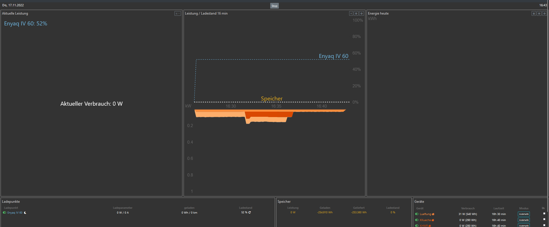

Seit dem neuesten Update 1.9.282 (2022-11-17 08:19:06 +0100 [092ba5de] ) kommen keine Daten mehr. (PR2499 / 2500)
Vorher i.O.
Ein reboot hilft nicht.

self.__callback(read_all_bytes(connection))
File "/var/www/html/openWB/packages/legacy_run_server.py", line 87, in handle_connection
yield
File "/var/www/html/openWB/packages/legacy_run_server.py", line 48, in redirect_stdout_stderr_exceptions_to_log
2022-11-17 16:37:04: PID: 2511: legacy run server: Unhandled exception
2022-11-17 16:37:04: PID: 2511: legacy run server: Received command ["modules.e3dc.device","counter","192.168.178.36","1"]
2022-11-17 16:37:03: PID: 19491: BAT RET: 0 (LV2) at 16 main modules/speicher_e3dc/main.sh
ImportError: No module named 'modules.e3dc.device'
File "<frozen importlib._bootstrap>", line 956, in _find_and_load_unlocked
File "<frozen importlib._bootstrap>", line 969, in _find_and_load
"Direkt" nach reboot:
yield
2022-11-17 16:25:34: PID: 2511: legacy run server: Unhandled exception
Trying to read meter serial number once from meter at address /dev/ttyUSB0, ID 105
File "<frozen importlib._bootstrap>", line 986, in _gcd_import
return _bootstrap._gcd_import(name[level:], package, level)
File "/usr/lib/python3.5/importlib/__init__.py", line 126, in import_module
importlib.import_module(parsed[0]).main(parsed[1:])
File "/var/www/html/openWB/packages/legacy_run_server.py", line 109, in handle_message
yield
2022-11-17 16:25:31: PID: 2511: legacy run server: Unhandled exception
2022-11-17 16:25:24: at_reboot: 2022-11-17 16:25:24: boot done :-)
Zuletzt geändert von Jens am Do Nov 17, 2022 4:52 pm, insgesamt 1-mal geändert.
