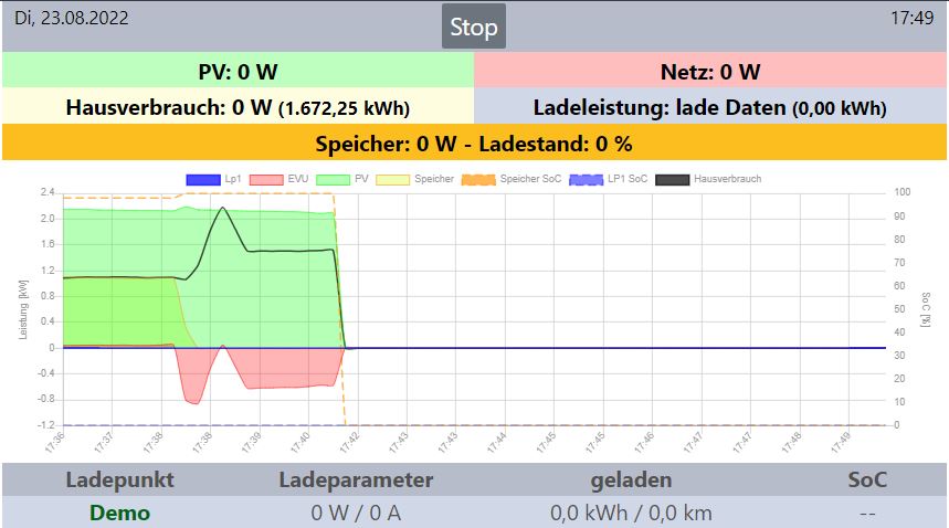

Seit dem Update kommen keine Daten mehr:
Debug:
2022-08-23 17:46:44: PID: 31465: EVU RET: 0 (LV2) at 16 main modules/bezug_sungrow/main.sh
KeyError: 'port'
type = arg_spec.annotations[argument_name]
File "/var/www/html/openWB/packages/helpermodules/cli/_run_using_positional_cli_args.py", line 11, in _add_positional_parser_args
_add_positional_parser_args(sub_parsers.add_parser(command_name), function)
File "/var/www/html/openWB/packages/helpermodules/cli/_run_using_positional_cli_args.py", line 29, in run_using_positional_cli_args
{"bat": read_legacy_bat, "counter": read_legacy_counter, "inverter": read_legacy_inverter}, argv
File "/var/www/html/openWB/packages/modules/sungrow/device.py", line 103, in main
importlib.import_module(parsed[0]).main(parsed[1:])
File "/var/www/html/openWB/packages/legacy_run_server.py", line 109, in handle_message
self.__callback(read_all_bytes(connection))
File "/var/www/html/openWB/packages/legacy_run_server.py", line 87, in handle_connection
yield
File "/var/www/html/openWB/packages/legacy_run_server.py", line 48, in redirect_stdout_stderr_exceptions_to_log
2022-08-23 17:46:44: PID: 31257: legacy run server: Unhandled exception
2022-08-23 17:46:44: PID: 31257: legacy run server: Received command ["modules.sungrow.device","counter","192.168.111.71","502","1","0"]
2022-08-23 17:46:43: PID: 31435: BAT RET: 0 (LV2) at 16 main modules/speicher_sungrow/main.sh
KeyError: 'port'
yield
2022-08-23 17:46:43: PID: 31257: legacy run server: Unhandled exception
2022-08-23 17:46:43: PID: 31257: legacy run server: Received command ["modules.sungrow.device","bat","192.168.111.71","502","1"]

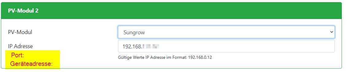

Zusätzlich bräuchte ich beim 2. Wechselrichter noch Port und Adresse:
Vielen Dank!
PV: 22,5 kVp, 2x Sungrow SH10RT, 1x BYD HVM 11.0
Wallboxen: 1x openWB standard+, 1x JUICE CHARGER easy
Auto: VW ID.3 Pro Performance
SmartHome: demnächst 1x AC Thor mit tuxhorn eTherm C
Test: 1x Raspi: Nightly 1.9.291, 1x Raspi: 2.0 alpha 3
yield
KeyError: 'port'
yield
Vielen Dank!
Reboote Deine Box mal. Sieht für mich so aus, als ob der Legacy run server nicht neu gestartet wurde und noch die alten Python Dateien genutzt werden.
Kannst Du bitte mal weitere Infos zu Deinem Setup posten? Ich war aktuell davon ausgegangen, dass bei Sungrow alles über eine Modbus-Verbindung, also ein physisches Gerät, läuft. In den Einstellungen waren für EVU und PV keine Optionen vorhanden.
Können die Geräteadressen bei EVU, Speicher und PV unterschiedlich sein?
[Nachtrag]
Vom Konzept würde ich es in 1.9 jetzt so umsetzen, dass Speicher, EVU und PV1 die IP und den Port des Speichermoduls nutzen. Geräteadressen können bei allen separat festgelegt werden. Das hat den Vorteil für Standard-Installationen, dass nur eine gemeinsame Verbindung genutzt wird.
PV2 kann komplett eigenständig konfiguriert werden mit IP, Port und ID. Nachteil in der 1.9 ist, dass auch dann eine zweite Verbindung aufgebaut wird, wenn die IPs identisch sind. In 2.0 lässt sich das dann besser konfigurieren und verschiedene Mischsysteme abbilden, da zu einem Gerät (IP und Port) beliebige Komponenten (ID) angelegt werden können.
Passt das zu Deiner Installation?
