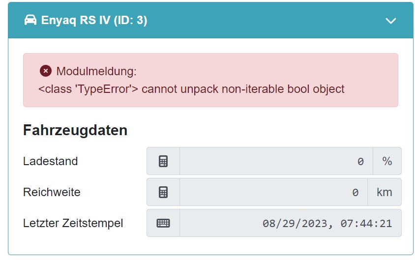

ich habe seit kurzen einen Skoda Enyaq, ich bekomme den SOC nicht zum laufen.
System :2023-08-28 14:46:51 +0200 [d2d79cf23]
Wo könnte ich suchen?
2023-08-29 07:44:21,721 - {modules.common.component_context:24} - {DEBUG:fetch soc_ev3} - Update Komponente ['VWId']
2023-08-29 07:44:21,723 - {asyncio:59} - {DEBUG:fetch soc_ev3} - Using selector: EpollSelector
2023-08-29 07:44:21,730 - {modules.vehicles.vwid.api:58} - {DEBUG:fetch soc_ev3} - set refreshToken to initial value
2023-08-29 07:44:21,730 - {modules.vehicles.vwid.api:72} - {DEBUG:fetch soc_ev3} - set accessToken to initial value
2023-08-29 07:44:21,825 - {modules.vehicles.vwid.libvwid:199} - {DEBUG:fetch soc_ev3} - Refreshing tokens
2023-08-29 07:44:21,857 - {modules.vehicles.vwid.libvwid:205} - {INFO:fetch soc_ev3} - Reconnecting
2023-08-29 07:44:22,385 - {modules.vehicles.vwid.libvwid:72} - {ERROR:fetch soc_ev3} - Missing fields in response from VW API
  File "/var/www/html/openWB/packages/modules/vehicles/vwid/libvwid.py", line 67, in password_form
    % (json_model['clientLegalEntityModel']['clientId'], json_model['postAction'])
KeyError: 'postAction'
2023-08-29 07:44:22,389 - {modules.common.fault_state:52} - {ERROR:fetch soc_ev3} - VWId: FaultState FaultStateLevel.ERROR, FaultStr <class 'TypeError'> cannot unpack non-iterable bool object, Traceback:
  File "/var/www/html/openWB/packages/modules/common/configurable_vehicle.py", line 37, in update
    self.store.set(self.__component_updater(soc_update_data))
  File "/var/www/html/openWB/packages/modules/vehicles/vwid/soc.py", line 26, in updater
    return fetch(soc_update_data, vehicle_config, vehicle)
  File "/var/www/html/openWB/packages/modules/vehicles/vwid/soc.py", line 19, in fetch
    soc, range, soc_ts = api.fetch_soc(config, vehicle)
  File "/var/www/html/openWB/packages/modules/vehicles/vwid/api.py", line 156, in fetch_soc
    soc, range, soc_ts = loop.run_until_complete(a._fetch_soc(conf, vehicle))
  File "/usr/lib/python3.9/asyncio/base_events.py", line 642, in run_until_complete
    return future.result()
  File "/var/www/html/openWB/packages/modules/vehicles/vwid/api.py", line 78, in _fetch_soc
    self.data = await self.w.get_status()
  File "/var/www/html/openWB/packages/modules/vehicles/vwid/libvwid.py", line 206, in get_status
    if await self.reconnect():
  File "/var/www/html/openWB/packages/modules/vehicles/vwid/libvwid.py", line 111, in reconnect
    (form, action) = self.password_form(await response.read())
TypeError: cannot unpack non-iterable bool object

Das vwid Modul unterstützt Skoda nicht.
Ich glaube, in 2.0 gibt es ein Skoda Modul.
